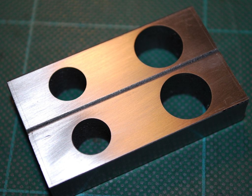

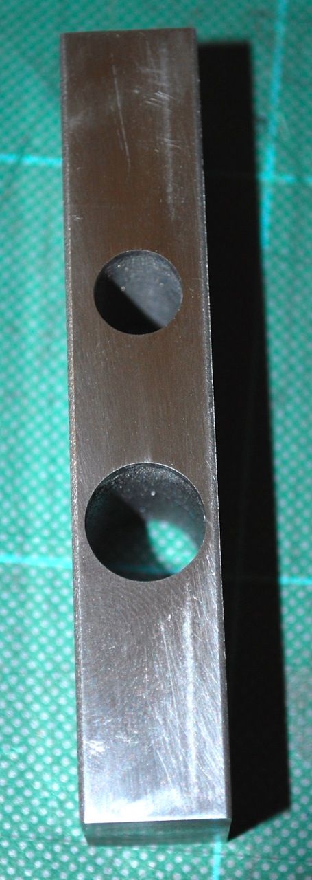

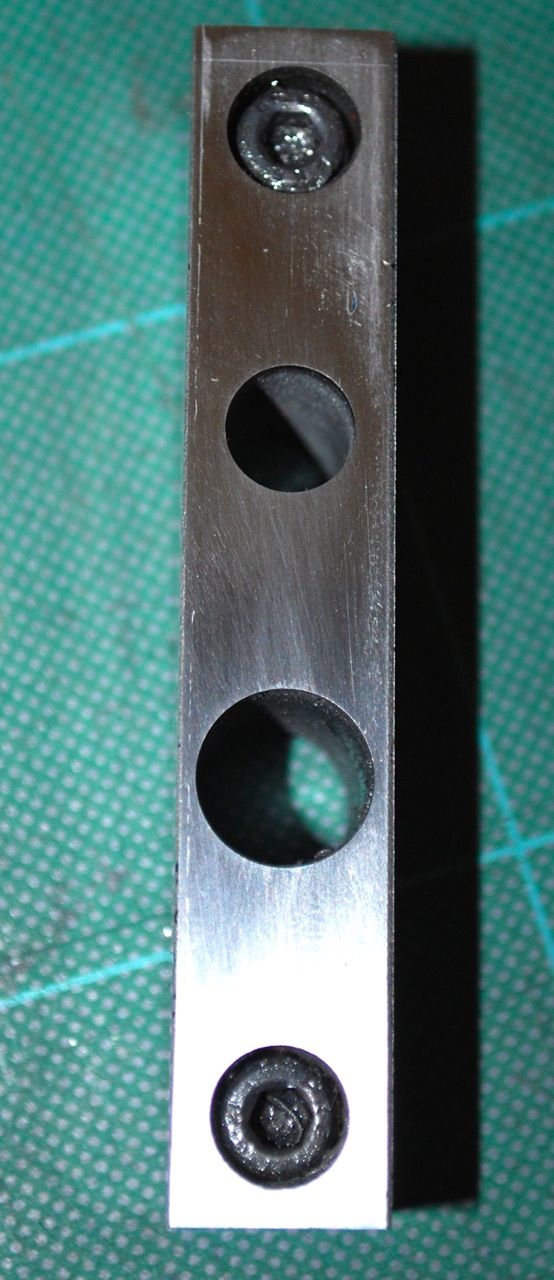

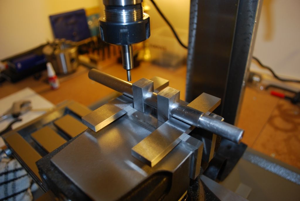

      Just a couple of photos of the Crankshaft Webs after drilling on the lathe earlier, need to turn the shaft next and then get them fixed to it..
      The top and bottom faces showing uppermost in the pics will be machined when between centres on the lathe later and will get rid of the tatty 'chamfers' which can tend to make the holes look out of position at the moment.. The bar for the webs as supplied was actually undersize, something I've noticed a few times now with other parts on this engine and Victoria – would have been nicer I think to have had a bit more metal to machine down to a clean surface from scratch..
      Side 1.
      Side 2.
      Regards
      Allan.
      Edited By Allan. on 17/03/2015 15:08:07

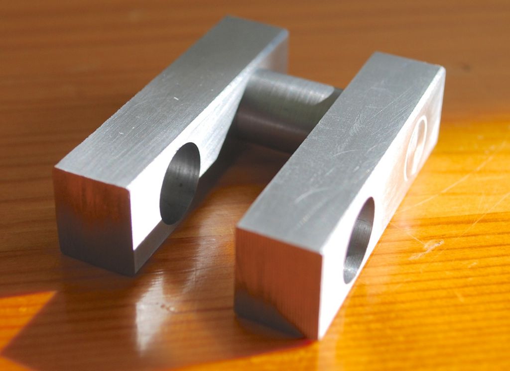

          Thanks for that Harry its good to know there are some following. Your Traction Engine looks superb, I wouldn't know where to start!
          No chance to do much today, but earlier I got the webs ready for the shaft & crank pin. Left far too much on the ends so more work on the lathe but better safe than sorry I thought..
          The two screws just cut away with a hacksaw and tidied a bit with a file. The pins will go in through the sawed ends. I'll radius the ends when I have the crankshaft between centres so they will be at 90 degree to the drawing..
          Next to get the main axle and the crank pin faced to length, centre drilled and onto unboxing the faceplate…

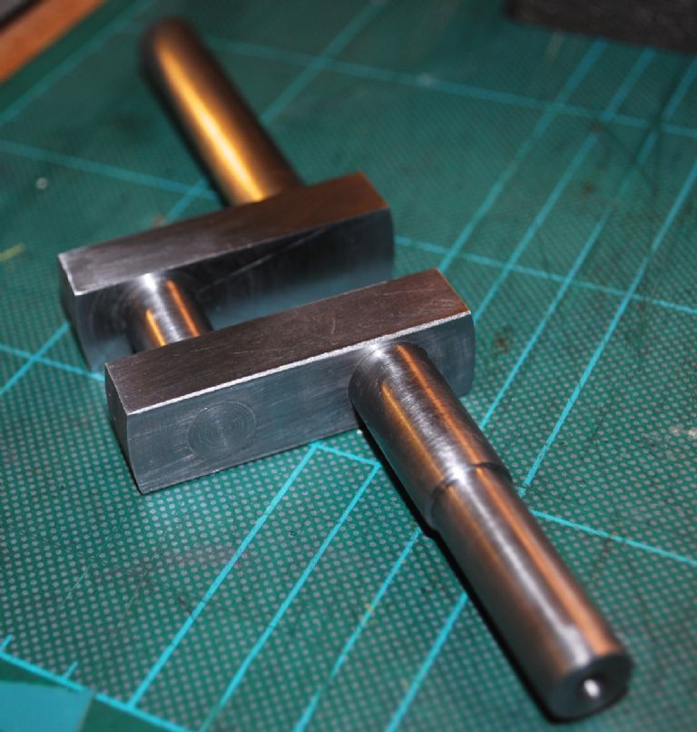

              Just the Crankpin today..
              No problem with this, just the 3 separate diameters to turn & face to length – I did this in the 3 Jaw Chuck, it will get skimmed again between centres when it is all together…
              Finding the new Lathe superb and very accurate, my Mic is a decent one now (M&W), I certainly couldn't do anything inside of 1 thou on the old one (down to me though somehow I'm sure), but I can now…. great.
              Progress with the Crankshaft so far..
              Cheers.
              Allan.

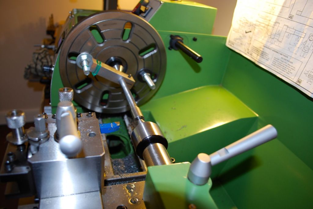

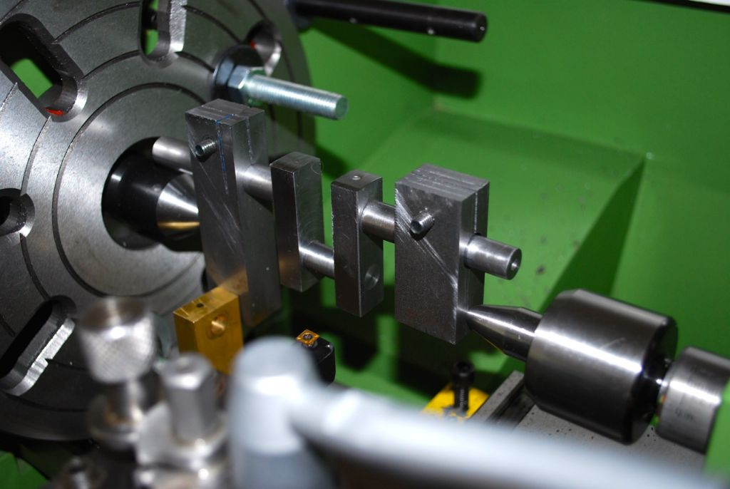

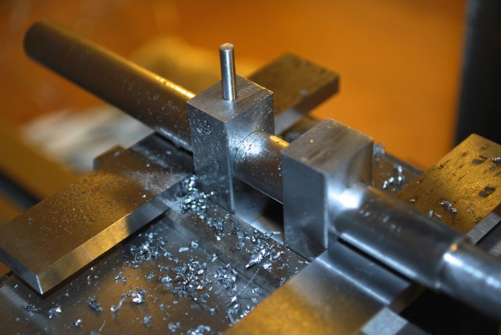

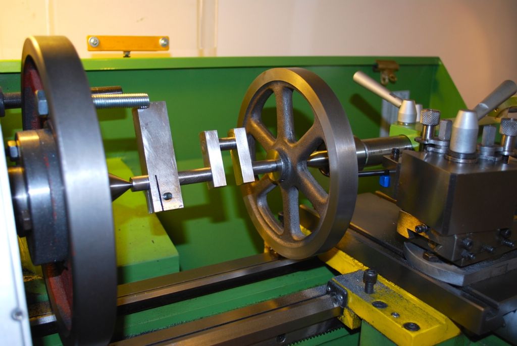

                Been making slow progress with the Crankshaft but finding it very interesting as a first attempt. I've made lots of mistakes that I may as well include here in case its of interest to anyone else first time around.
                First off as I had already used the supplied bar I tried to turn one from my own stock (larger diameter) which turned out to be PGMS – I don't know why but I had problems getting any kind of finish. As soon as I changed to black mild steel I was able to make a start. Next up was on perhaps the easiest bit in cutting away the excess shaft between the webs – I tried to hacksaw off flush with the webs and ended up marking them quite badly. They have ended up slightly undersize between the webs by the time I had cleaned them up. Hopefully I can allow for this later. Next time around I would leave excess to clean up with a file before skimming. I also hadn't realised that the thread in the throw plates only needed to go through halfway to the slit and that the rest of the hole need to be drilled out oversize for the clamping action to work. Last was me leaving too much for the radius cut of the webs – not recognising the significance of the interrupted cut. I have left the webs slightly long to cut down on the number of cuts on the Lathe, means they won't look quite so pretty but I can live with that or if not I can always take them down more later. Guess that all sounds like a disaster!
                I was stumped for a while in how to reach between the webs to skim the Crankpin when assembled between centres – in the end I ground a round nose on a piece of approx 1/8" tool steel and put into the tool holder on top of an existing tool, to my surprise it worked a treat and gave a great finish..
                Anyway some pics of progress along the way..
                Ready to start turning the larger diameter of the main shaft.
                The shaft reversed between centres to turn the smaller diameter.

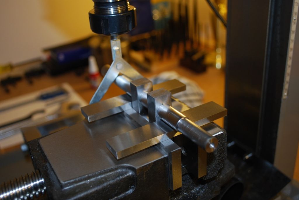

                Setting up to drill the Crankshaft Webs.
                Setting up to drill the Crankshaft Webs 2 with an edge finder. First time for me using this and was great.

                Ready to start turning the Crankshaft Assembly.
                The finished Crankshaft.
                Test fitting the Crankshaft in place. As a first attempt I'm quite pleased with it – and I've learned lots again through all the mistakes.. The fit seems very nice and it spins very nice and smooth..

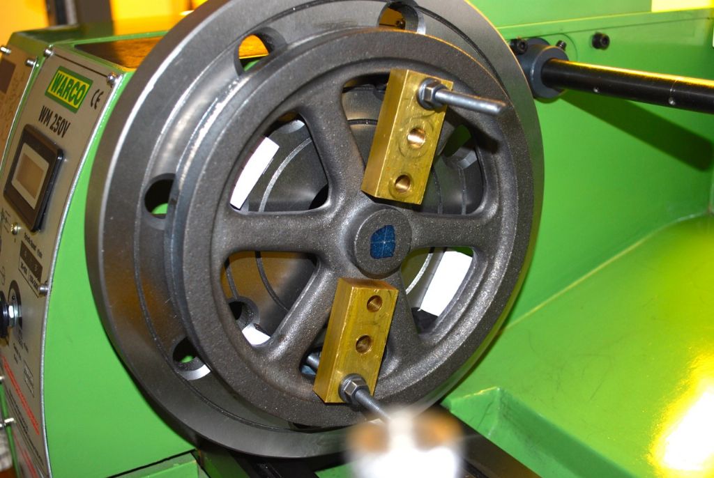

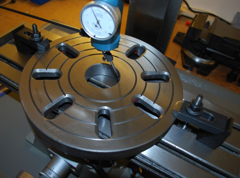

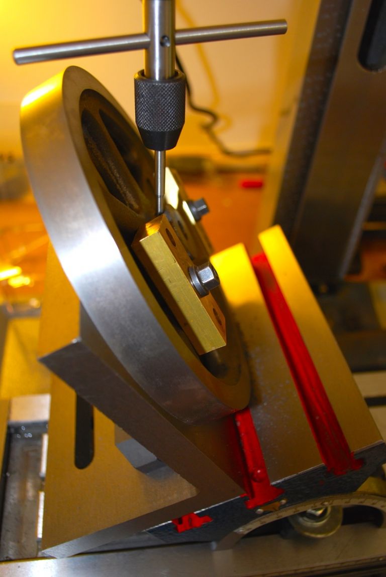

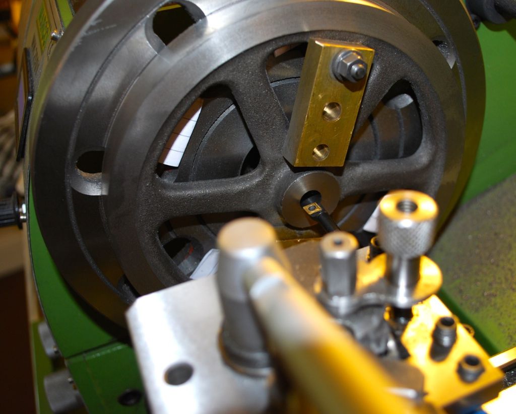

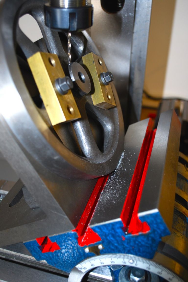

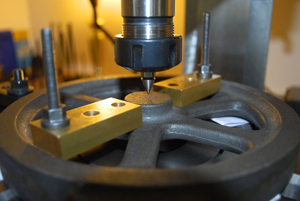

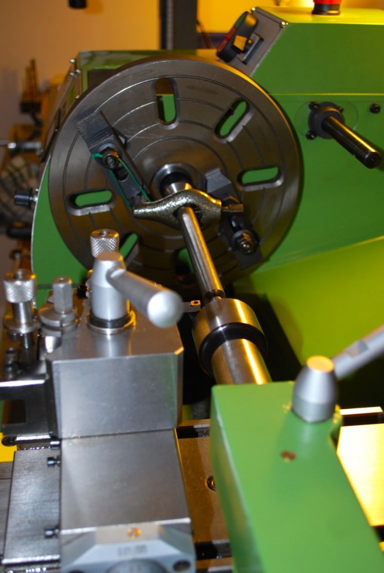

                          Just a quick update of what looks like nothing I suppose but I was a bit stuck for a while…
                          After failing to get the Flywheel centred close enough on the faceplate in the lathe (I just haven't the knack with setting up the faceplate yet) I did manage to get it in the 4 jaw but with really only 2 jaws holding and those not brilliantly so – tried a different approach this morning..
                          Thought I would get the faceplate off the lathe and centred on the Mill which I thought should make it easy to get the Flywheel clamped in place – so I took a few diameter readings of the boss (not machined and a bit rough) and used the average to mark its centre and centre punch.. The faceplate will get skimmed when on the Crankshaft between centres on the Lathe later.
                          Centering the Faceplate on the Mill.
                          The Flywheel finally centred and clamped on the faceplate.
                          The faceplate back on the lathe and flywheel casting spinning as true as poss. This method was just so much easier than trying to clamp when in place on the Lathe. Think I will always try this way first in future now.. I spent ages on and off trying while on the lathe and maybe 10 – 15 minutes to do it this way…..

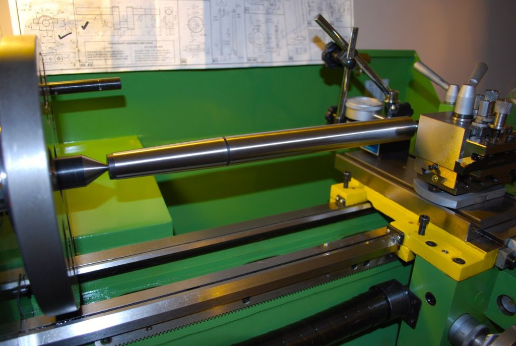

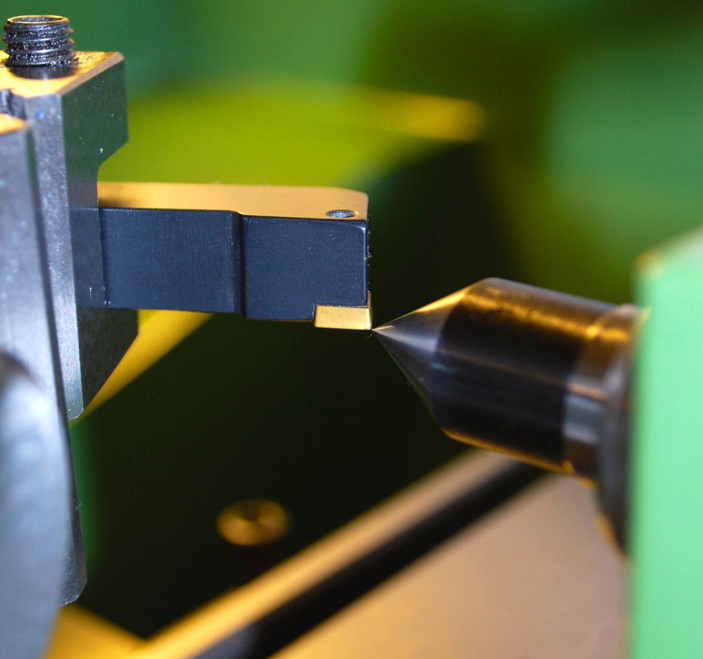

                          Setting the Tailstock with a Test Bar. Following my recent troubles with the tailstock offset it was good to be able to set it correctly. I had previously set it using the ruler between centres method – the test bar (12 inch) showed it to be out by just under 2 thou – I was surprised it was that close as it seemed a bit hit and miss with the ruler at the time.
                          So no real progress on the Engine I guess but I get just as much satisfaction from continuing the learning process..
                          Hope it was of interest.
                          Regards.
                          Allan.

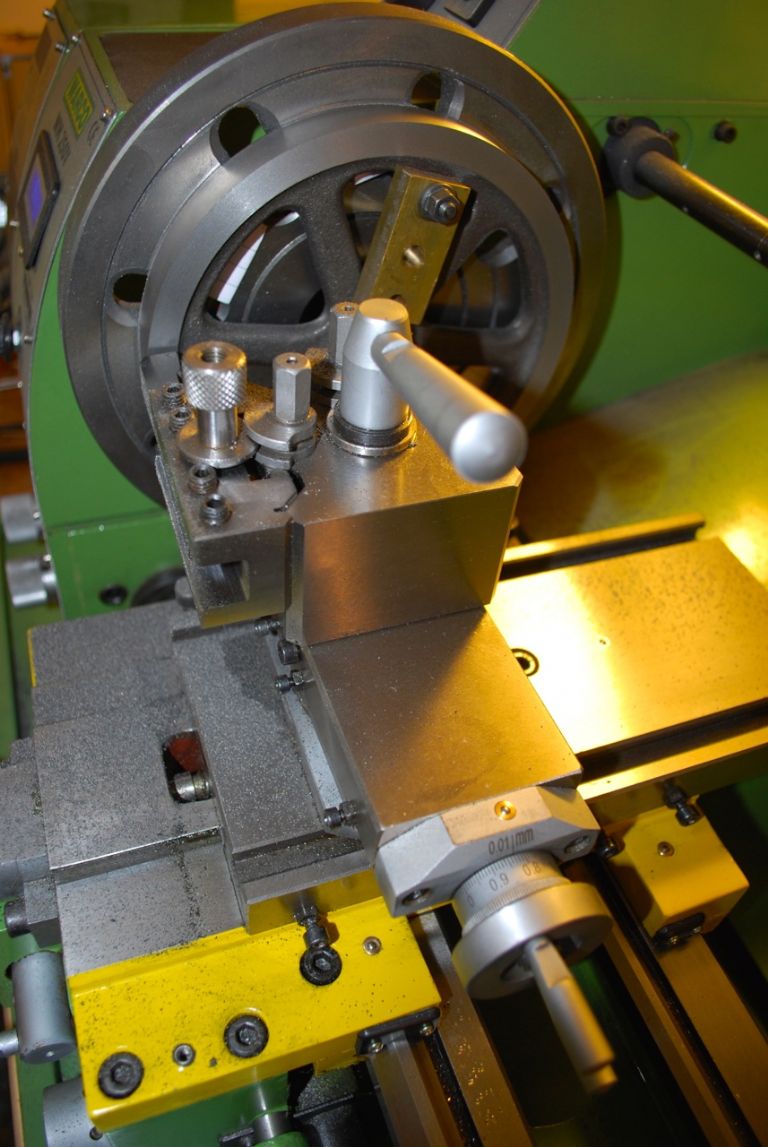

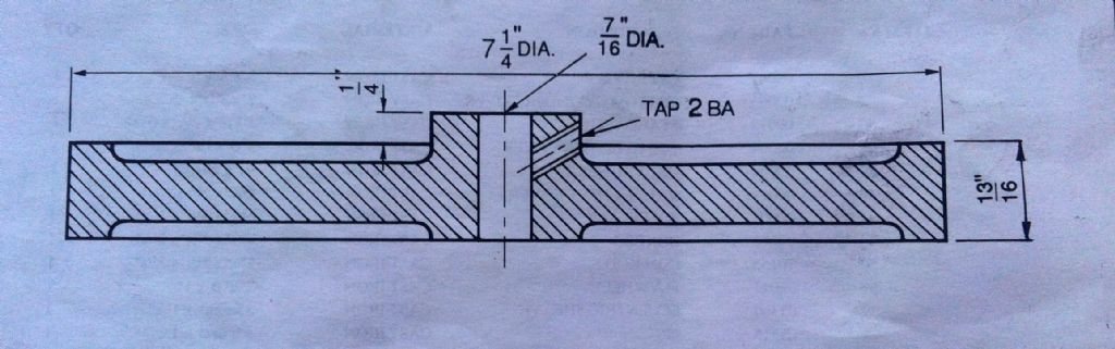

                            Still edging forward very slowly with the flywheel..
                            In order to get the tool to the outside of the flywheel rim I needed to use a right handed tool (hope thats the right way round – point facing the tailstock I mean) but the only one I had was a short 10mm size and with the necessary overhang it was flexing (and I was in trouble again). Then I remembered reading somewhere that it was ok to turn the tool upside down and reverse the lathe – so I did this with an ordinary left hand but larger 12mm tool and it worked perfectly, I used it this way round for the outside of the rim as well. Surprising how much difference the 2mm increase in size made and I had no problems once it was set.
                            The Flywheel Drawing
                            Setting the upside-down tool to centre hight.

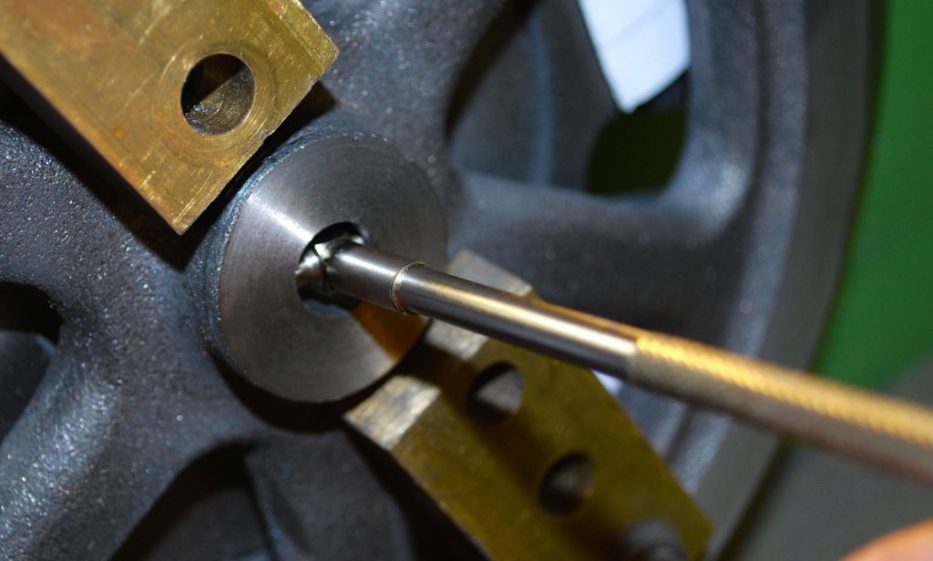

                            I used a small 6mm Boring Tool to do the bore.
                            Checking the Bore Size – gauge then put between the Micrometer. Managed to get a great push fit with the shaft using several passes of the Boring Tool at the same setting when close to size – until it was the nice push fit..
                            I measured the angle for the grubscrew directly off the drawing (made it 29 degrees) and set the angle table the same.
                            Then tapped 2BA.

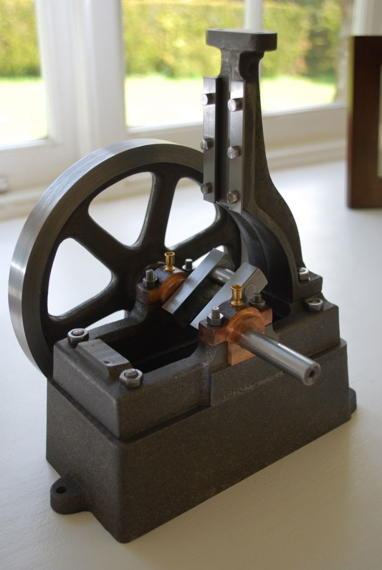

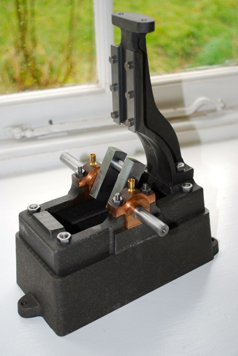

                                Had a great couple of hours this morning finishing the Flywheel. I didn't know what to expect when I tried spinning the crankshaft assembly on the Lathe – and was amazed to see that the outer and side rims were running almost perfectly, had to look hard to see any deflection. Its not perfect though as there is some radial movement of the inside rim (and spokes), down to me not setting it up correctly initially no doubt. It seems like something of a 'dark arts' do in getting it centred to start with. If anyone has any tips I would love to hear them. It's good enough for me though at the moment and I've come away with a better understanding of some useful basic things again, and a lot of enjoyment!
                                Skimming the Crankshaft assembly – it only needed the lightest skim. I put a small flat on the shaft using the Mill for the grubscrew and didn't get any slipping of the Flywheel.( I did tie the throw plate to the driving bolt beforehand).
                                The Flywheel in place. Really chuffed when I spun it by hand, completely smooth and silent. The Webs are a nice snug fit between the bearings..
