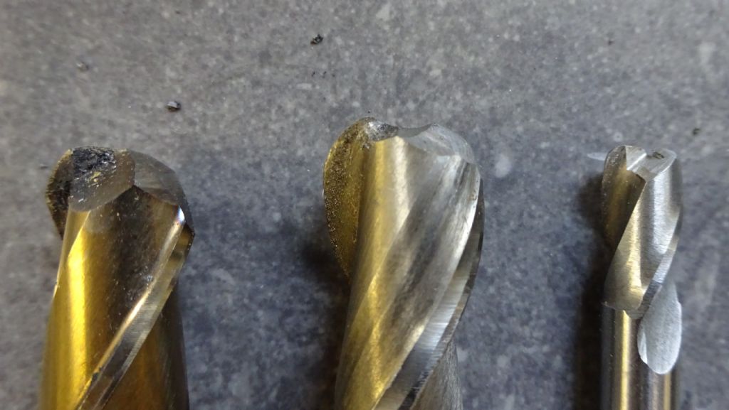

              It could be done with that but its actually a ball nose cutter, at 4mm dia it is likely to flex away from teh work too much and with only 8mm long flutes may come up a bit short.
              Give me a few mins and I'll take a photo of what I use
              #204469
                Just roughly freehand ground on a bench grinder from blunt cutters, A quick look only shows carbide ones for sale in my catalogues which work out a bit pricy. Something like 10mm dia with a 2mm radius would be about right.

                  Thats great thanks a lot Jason – I should have some blunt cutters that I hope I haven't binned so I'll have a go at grinding one, if not then its a good time to order new better quality ones and try and grind one of the old ones….
                  edit: – I swear that I'll never throw anything away again – just looked and can't find any old blunt milling cutters.. So I've ordered this to try before grinding any others (trying to make them last a bit longer before replacing), Hopefully just nibbling away with it will do the job and no great loss if not…. http://www.amazon.co.uk/gp/product/B00EZ78H18?psc=1&redirect=true&ref_=ox_sc_act_title_1&smid=A50DZI580G3JX

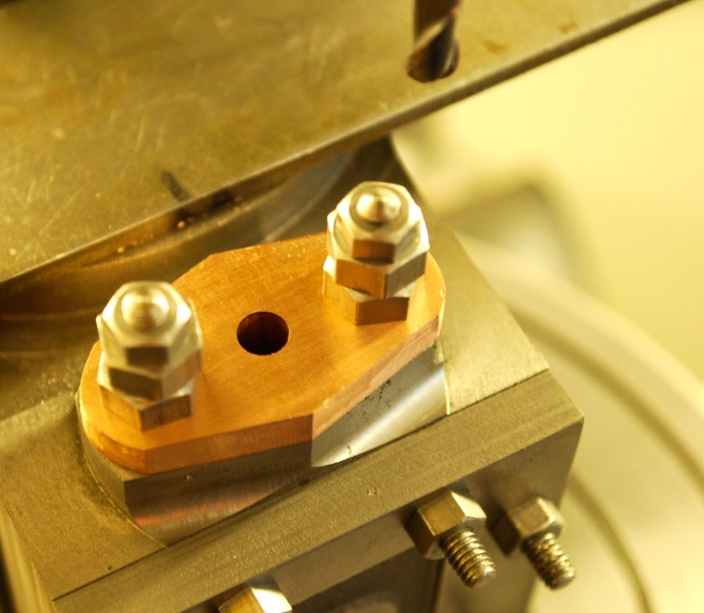

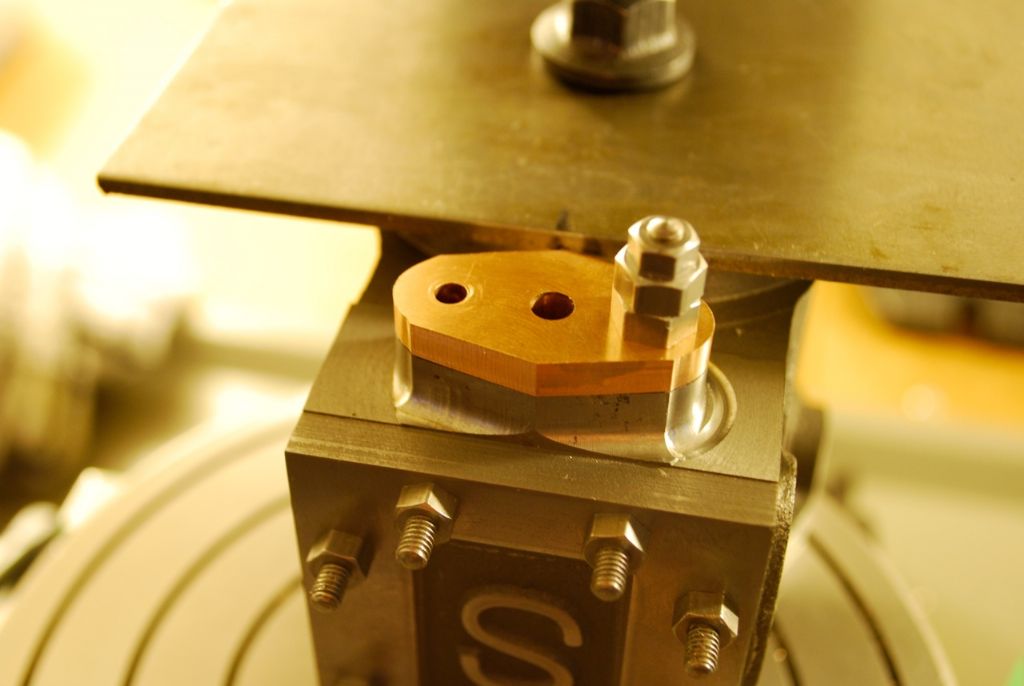

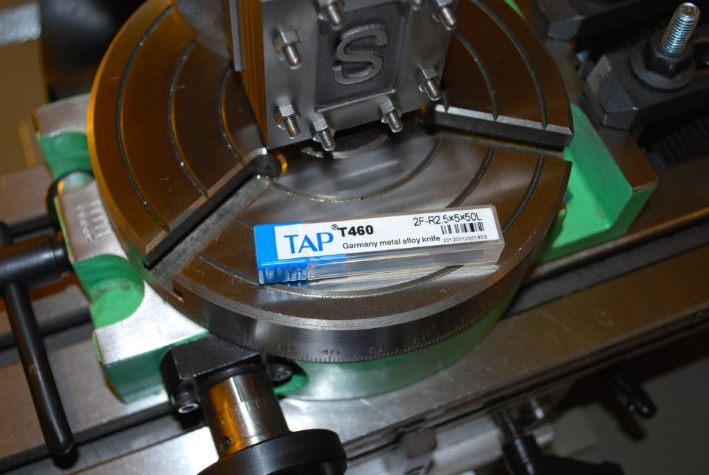

                                          I'm back I'm afraid – I see there have been some changes and i now seem to have my thread in the wrong place, I don't know how to move it and don't really want to split it again so I'll just let it die if its a problem – no worries my fault for taking so long over getting it done..!

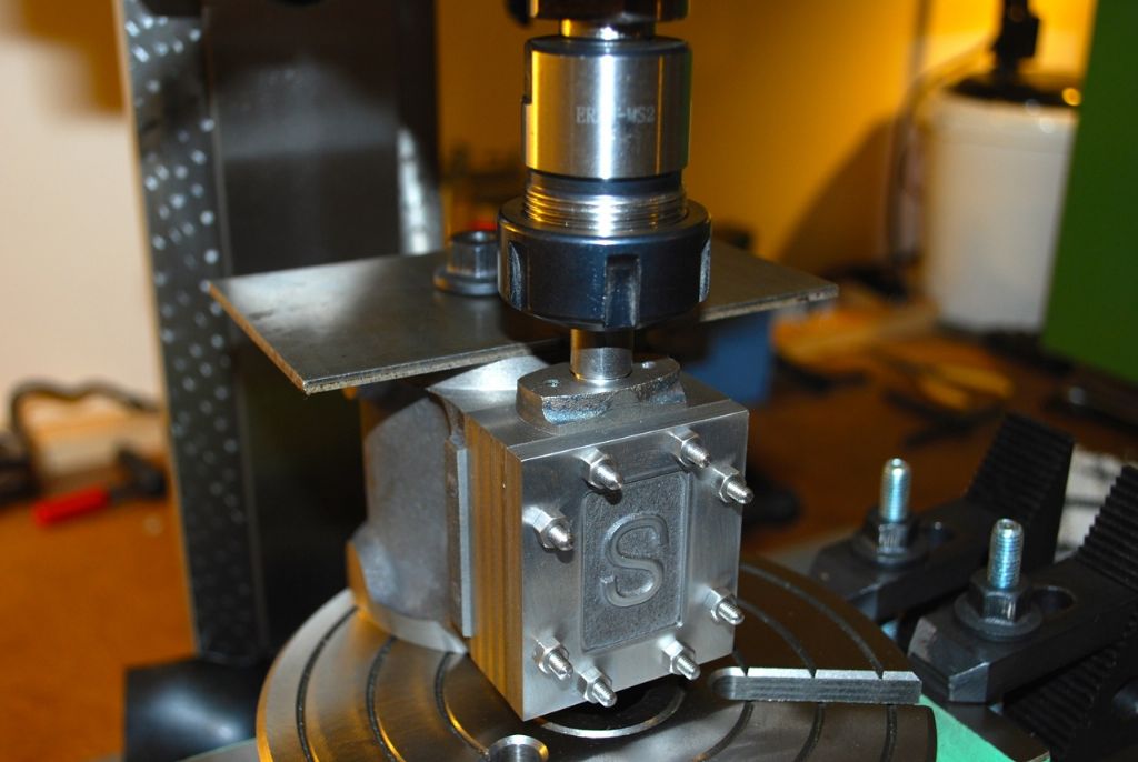

                                          I decided to have a go at milling the Steam Chest Gland and Boss as one. Not made a very good job of it so far as I haven't cut down low enough I think, but its looking better than it was and I have to remember its a first attempt…
                                          Couldn't resist putting up this pic of the photo that greeted us over the main fireplace of the Cornish Cottage we stayed in, felt right at home…
                                          Setting up to Mill the gland..
                                          The new Milling Cutter.
                                          Progress so far.. I haven't touched the rounded ends yet.. (the step looks a lot worse in the photo than the real thing..)

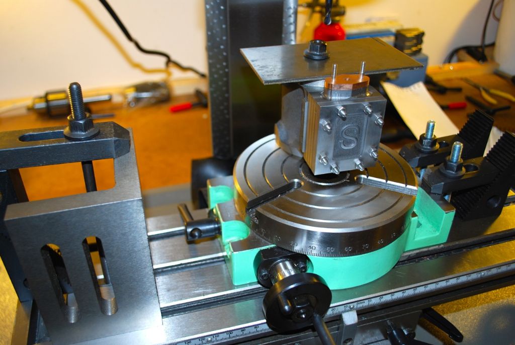

                                                  Have to put today's session down to experience gained – in finishing off milling the gland, and I think it was very good experience although I guess looking at the photo's it won't look like it..
                                                  All going reasonably well rounding off the first end but then after changing tools a few times for centring on the RT I used my first 0 setting for the maximum depth on end two which of course was very silly by then… Thankfully its pretty much out of sight on the bottom of the engine, but that's not the point of course..
                                                  The overall setup used..
                                                  So to get things symmetrical I did the same on the first end – I don't think it will look too bad when it is painted – trying to convince myself it may even look better….maybe not.! It looks worse in the close up photo but the one above looks a bit more real and a lot less noticeable…
                                                  Have to learn somehow.
                                                  I should also say it was great fun doing it and definitely the way to do them in the future – hopefully will get better with them after more practice…

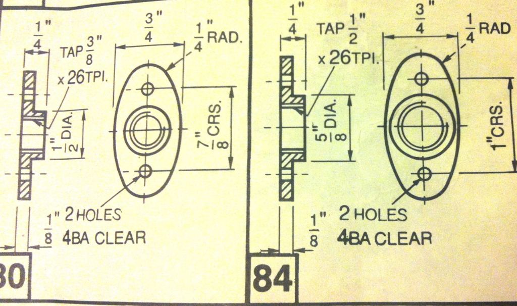

                                                    The Steam Inlet and Exhaust Flanges next, also the fitting hole in the steam Chest for the Displacement Lubricator..
                                                    Inlet on the left and exhaust on the right in the drawings below.
                                                    Just writing thread data here to refer to as I was getting confused…
                                                    3/8" x 26tpi – BSB Thread (British Standard Brass) – Tapping Size 8.5mm
                                                    1/2" x 26tpi – BSB Thread (British Standard Brass) – Tapping Size 11.5mm
                                                    1/4 x 32 – ME Thread (Model Engineer) – Tapping Size 5.5mm (Displacement Lubricator)
                                                    Cheers
                                                    Garry
                                                    Edited By Garry_C on 13/10/2015 05:02:10
