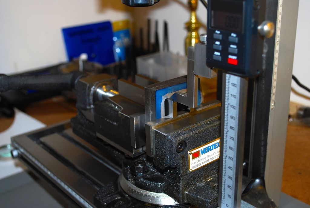

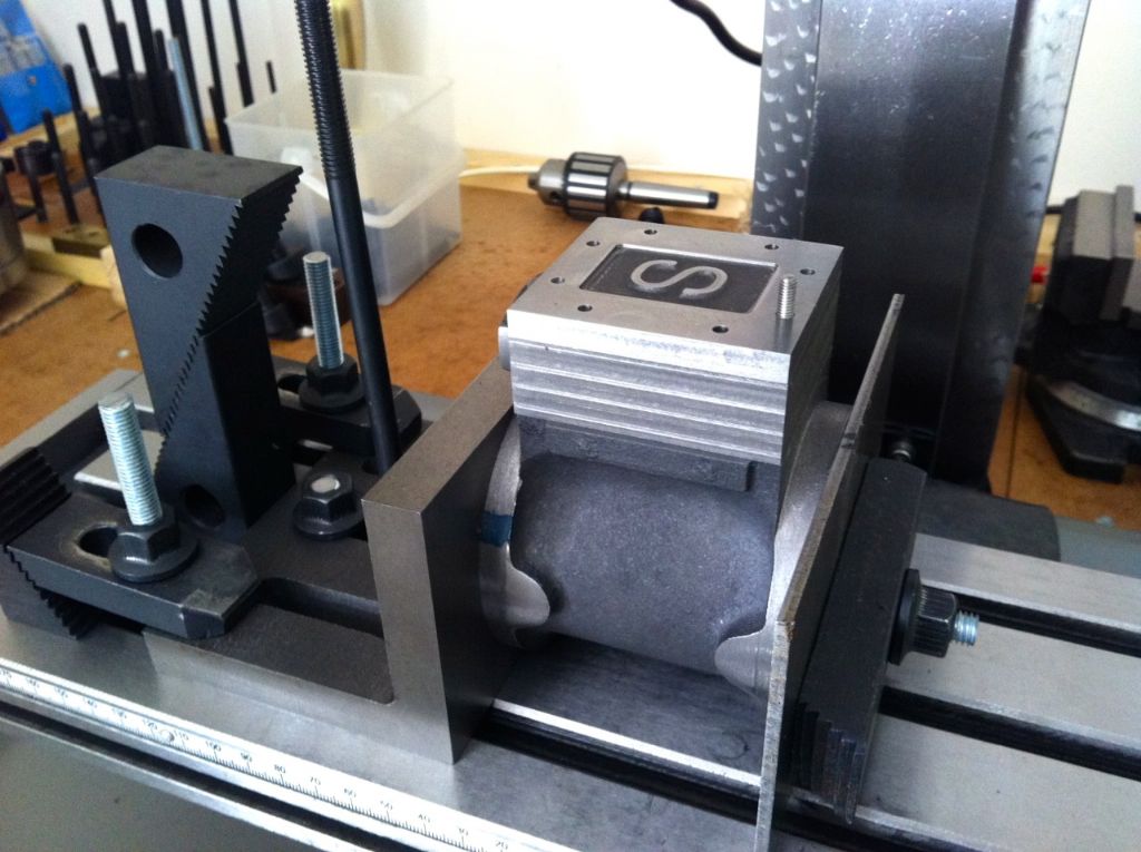

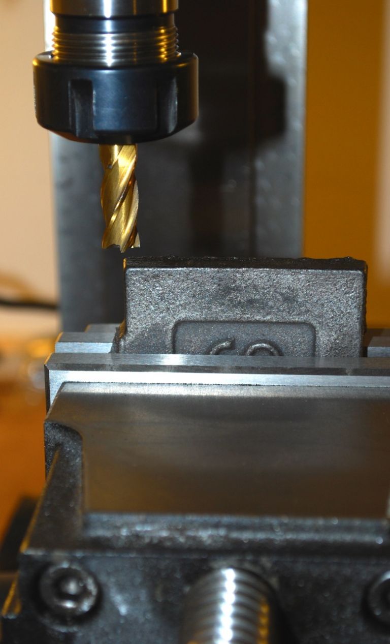

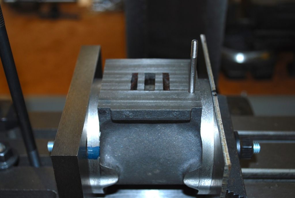

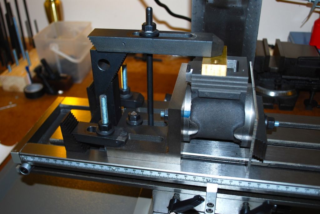

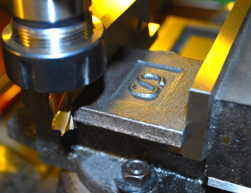

          These are just a couple of photos of getting ready for todays session in starting to machine the Steam Chest to size.
          I'm sure there are much better / more accurate ways of doing this but I'm hoping what I'm doing below will get the outside edges of the Steam Chest Cover, Steam Chest and Cylinder Port face reasonably lined up when they are assembled..

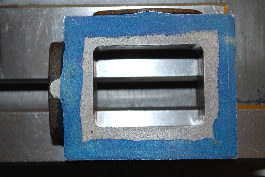

          Marking out from the inside of the Steam Chest the outside dimensions to fit the Steam Cylinder.

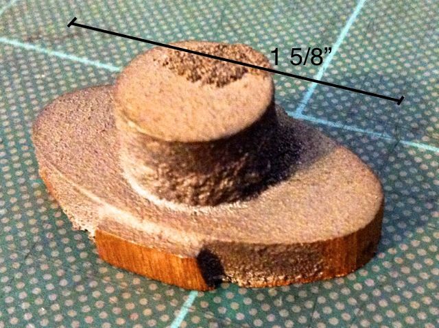

          This is a bit of an ugly photo but it shows how much needs to be removed from the Steam Chest outside edges – the dimensions used are from the actual Steam Cylinder Port face not the drawing..

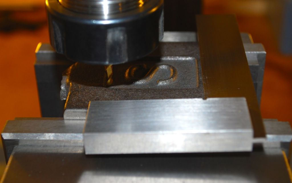

          and now ready to start milling down to size on the two 'blank' edges first – may need to do the other sides on the lathe, but whichever – I need to do the valve gland face and drill and ream through it in the same setting.. and the two holes right next to the gland I will move out slightly as they look a bit close (and the other two the opposite end to keep things symmetrical) – Thanks Jeff!
          Cheers
          Garry

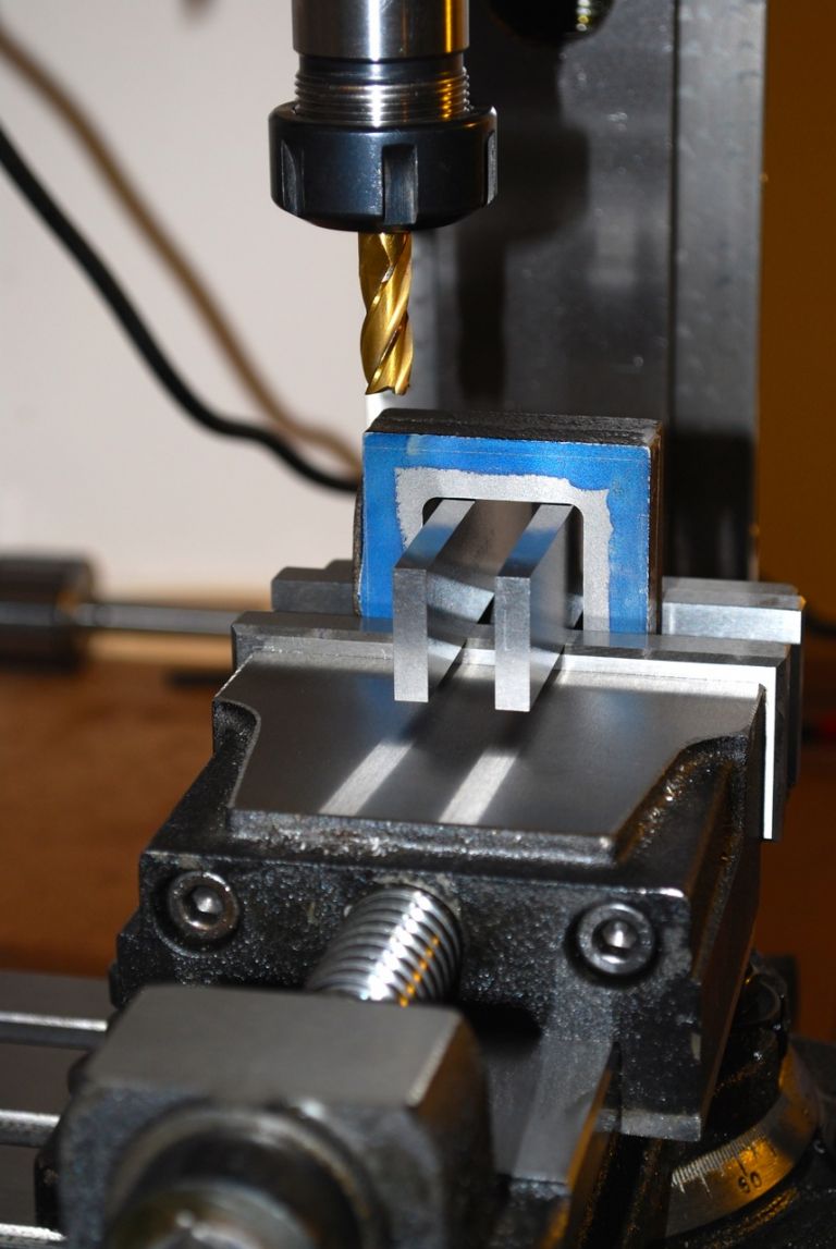

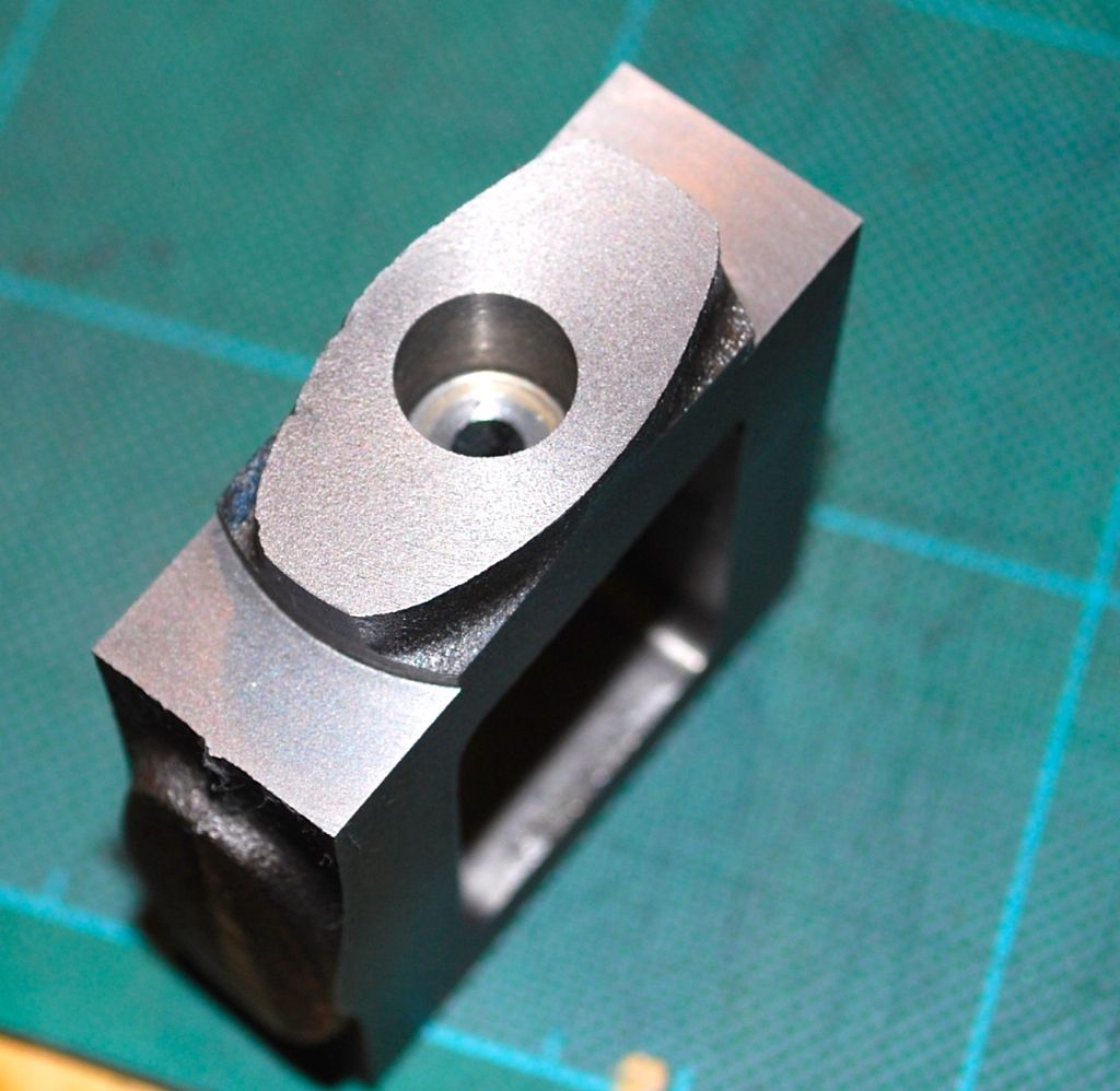

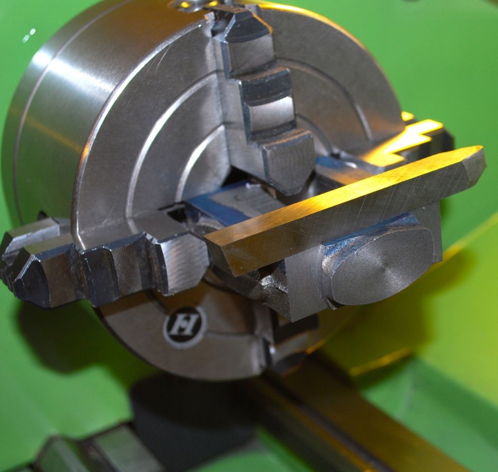

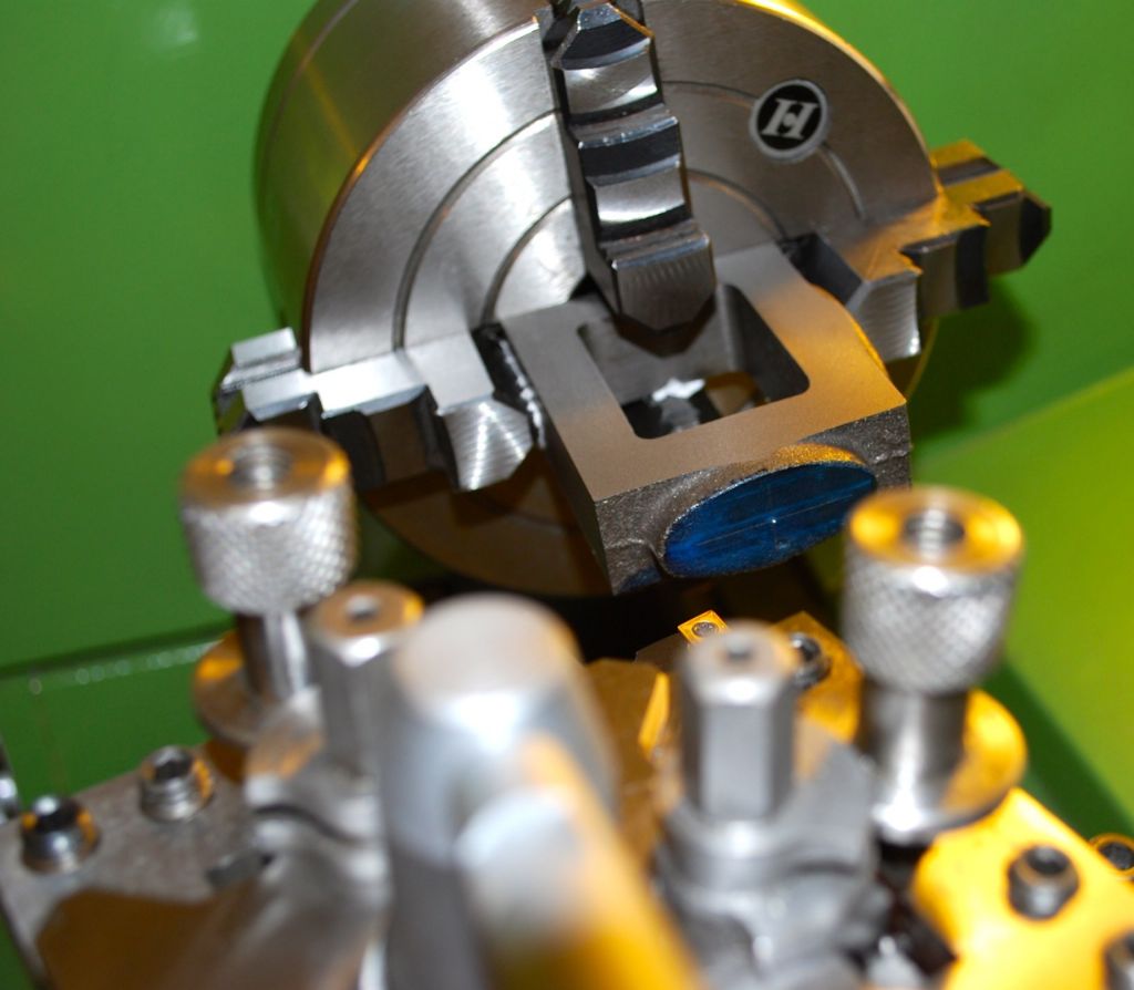

            I've done some more with the Steam Chest today. Its taken a while as there is a lot of checking that everything is square every time it needs to be moved for a new setup – and you can perhaps see from the photos above (last post) that the 'valve Boss'  as cast is well off centre, making things a bit more awkward – so things look a bit off below until I can hopefully tidy around the bosses and glands when they are done – with a file..
            Starting to machine the Valve Boss end with the 'inside centre' of the steam chest running true.
            The 'Valve Boss' now looking a bit more central, but its going to take some careful filing later to get it looking right.
            I'm thinking I'll try and clamp a piece of tool steel across the ends to help with some of the filing when the time comes.. The outside edges of the Steam Chest are being machined to the size of the Steam Cylinder Port face and so I'm getting left with little steps to remove later – I dare say it's not helping because I've taken too much from the Steam Cylinder Port Face when I did that earlier..

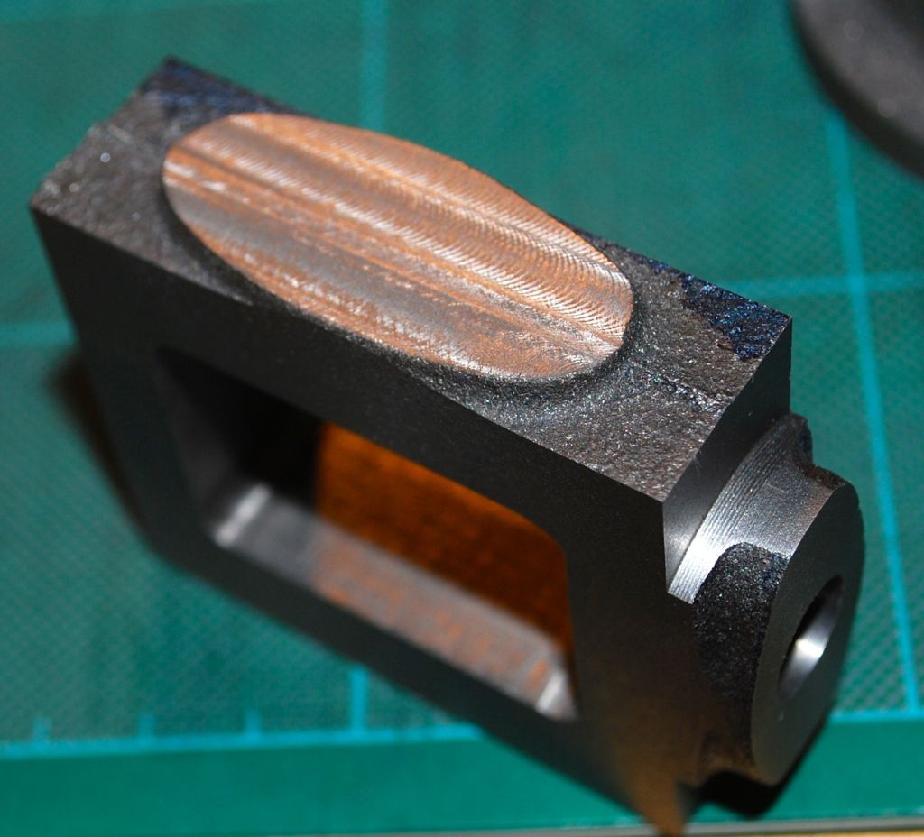

            Next the Steam Inlet boss was then lightly tidied up square on the mill so that it could be marked and a square used on the Lathe to help with checking the setup..
            and then the Steam Inlet marked – again on a centre line of the inside of the Steam Chest. This Boss seemed pretty central as cast – unlike the Valve Boss.
            The Steam Chest so far – ready now to do the Steam Chest Cover so that the fixing holes can be spotted through to the Steam Chest and then on to the steam Cylinder..
            Its far from perfect but should hopefully be ok..

            Bruce Voelkerding
              @brucevoelkerding91659
              Garry – 3 comments:
              1. if I were machining the side of the Steam Chest as your picture shows, I would do it the same with parallels locating the inside surface BUT I would use shorter parallels to allow a better grip in the vice. Check your high-speed tool blanks, they are quite parallel but often one side is different thickness than the other. Mark with felt tip pen.
              2. if I were holding the Steam Chest in the 4-Jaw Chuck to machine the Valve Rod Gland as your picture shows, I would do it the same BUT I would use say 1/4" x 3/4" pieces of steel across the Steam Chest on the two Jaws which are "gripping air". To keep them from dropping out when adjusting the 4-Jaw, I would have used double sided Scotch tape between the Valve Chest and the steel pieces. I had a very similar set-up as yours shift on me once.
              3. when machining an INSIDE rectangle like the start of your Valve Chest machining, I first get a clean sheet of paper and make a very simple sketch of the part as it sits in the Mill. I place it on my workbench next to the Mill. Note I do not have digital readouts on my Mill, I use the hand wheel graduations. I enter the Endmill into the Steam Chest and make a cut all around the interior profile. A light cut – just enough to see how the casting is aligned. The IMPORTANT part – as I do this cut I write down the Hand Wheel numbers. As an example, with a RH Endmill you will cut the side closest to you going from right to left. On my sketch I first would write CW at the bottom of my sketch with the value of the in-out handwheel. The I turn the right-left Handwheel CCW to cut to towards the left side of the Steam Chest. When I stop the cut, on the LH side of the sketch I write CCW .086 (or whatever the number on the Hand Wheel is). I do this all around the part for all the faces.
              Now I can measure how much needs to come off and determine how many passes are required. I write these numbers under the numbers on my sketch and go at it. Notice I do NOT use any stops. I write the CW and CCW down as I once used a machine with a "backwards" thread and I have been ruined for life. By having the CW & CCCW I do not get confused. I just run around the inside of the part keeping an eye on my sketch. Once you understand the system it becomes second nature and takes less time than fiddling with the Stops. You can stop at any time and measure th part and make fine adjustments by tweaking the numbers on the sketch.
              Bruce
              #202539
              GarryC
                @garryc
                Hi Bruce
                Thanks very much, I found that very interesting, particularly your method of working around the inside of the Steam Chest on the Mill.. I have some thin flat steel plate that I should cut some packing strips from – which would have been a much better job as you say in the Lathe chuck. I've yet to try anything with double sided tape so I'll have to do some experimenting with that, I hadn't thought of using tape to help with things slipping during setting up, it does sound like a very useful idea..
                My Mill vice although I think excellent, does have quite shallow jaws – hence the deep parallels with the Steam Chest vertically lengthways, I was able to use thinner ones in the horizontal position to get as much of the jaws in contact as possible….
                Thanks again.

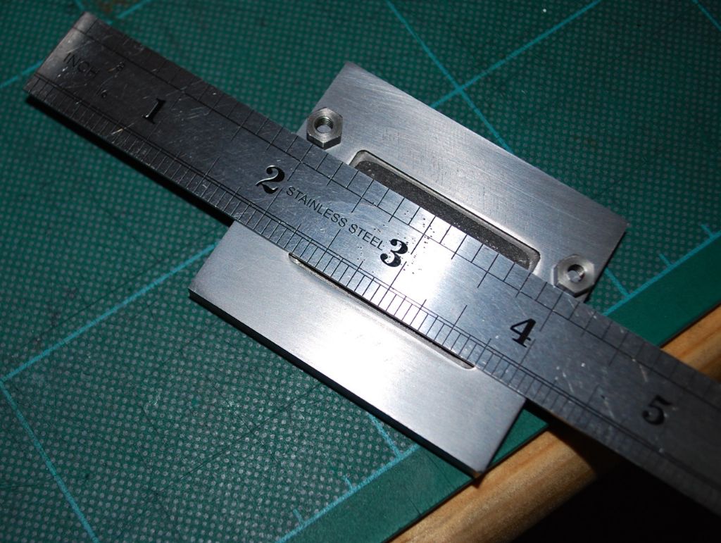

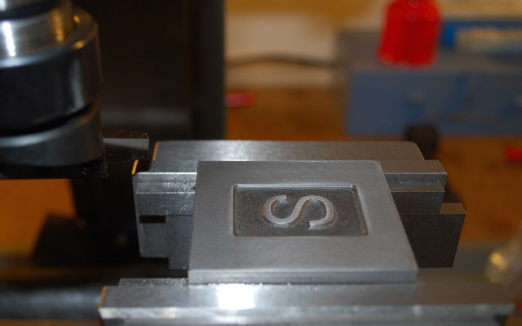

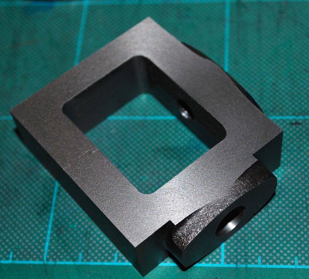

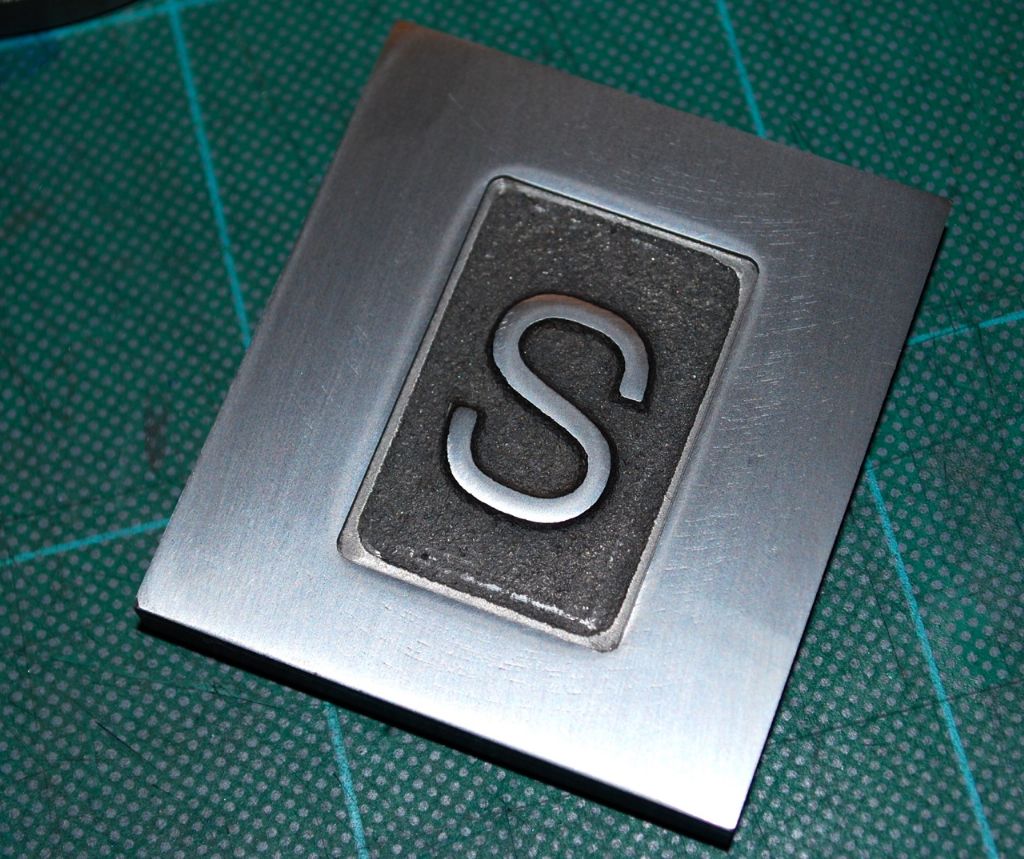

                  Haven't been able to make any progress for a few days, but I've made a start on the Steam Chest cover today..
                  The outside edges of the cover seemed pretty square as cast but not very true to the the inner 'S' rectangle..
                  Showing the out of square inner rectangle – so I tried to tidy around and square it to the outside edges with a small slot mill..
                  Then side milling to avoid the long overhang that I would have if holding lengthways vertically in the vice jaws..
                  Test fitting the Cover over the Steam Chest.
                  Then my best result to date flycutting – I ground a 'left hand' lathe type tool – no measured angles I just went and did it by eye to see what would happen..
                  Next is to machine the bottom surface and then marking out and drilling the holes – I'll give it a good clean up after when they are done.. I'll probably end up painting the cover as I've marked it a bit..
                  Cheers
                  Garry

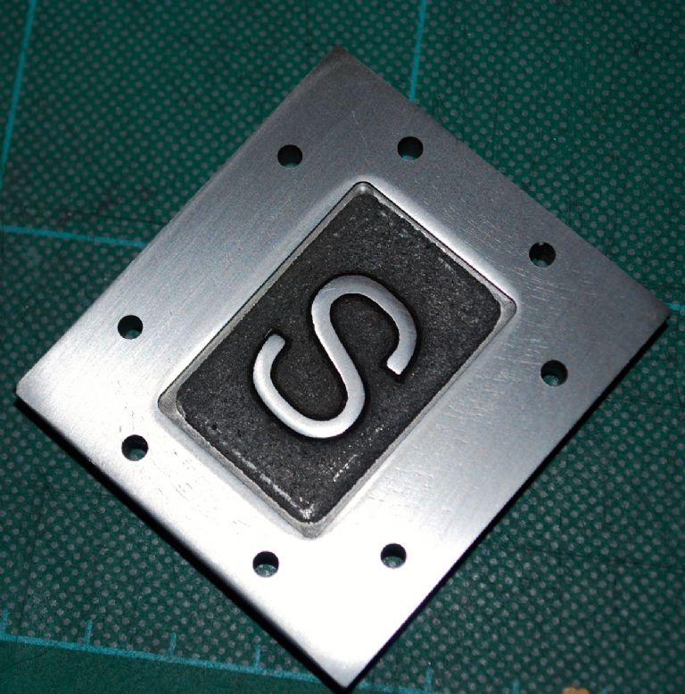

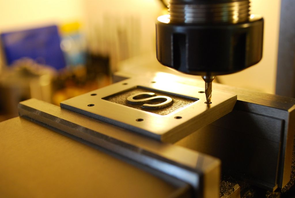

                      Thanks Jeff – I've just been drilling the Cover and took your advice about widening the measurement between the two stud holes close to the valve gland..
                      Also as I came up a bit short in the Steam Cylinder port face lengthways dimension the 2" ctrs between the stud holes were a bit close to the Cover edge so I've shortened by 1/16".. The dimension between the two holes on the shorter edges were also increased by 1/16" to be safe with the closeness of the Valve Gland..
                      Rather than risk marking out the holes and spoiling the Cover face I used an edge finder and just had to locate two of the holes – using the Mill to find the others..
                      The Steam Chest Cover with holes to 4BA tapping size for spotting through to the Steam Chest and then onto the Steam Cylinder, opening out to clearance size later.. (The cover will need polishing up come final assembly..)

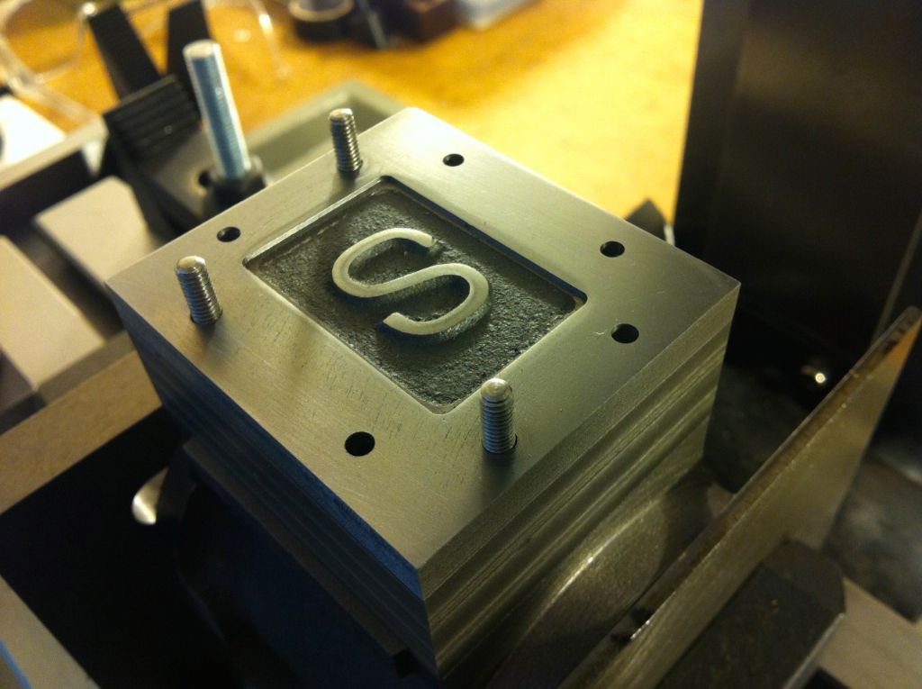

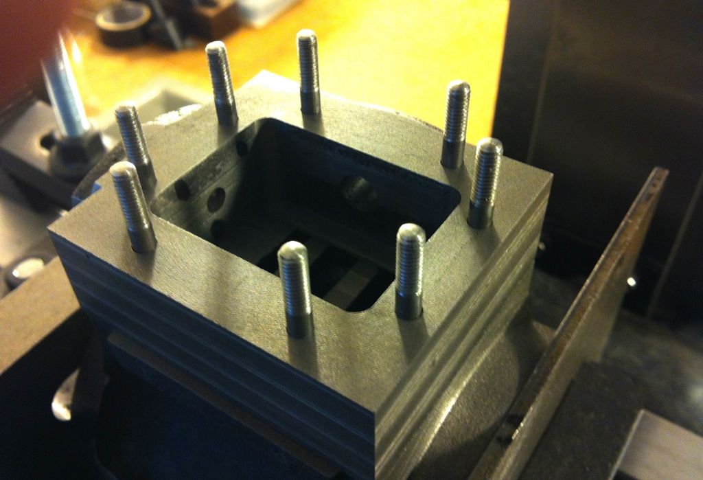

                        Just a quick couple of photo's of this mornings progress in starting to fit the Steam Chest studs..
                        Setting up to spot through the 1st of the holes – the chest was removed before drilling..
                        The first of the 8 4BA studs in..
                        Progress so far..
                        Cheers
                        Garry

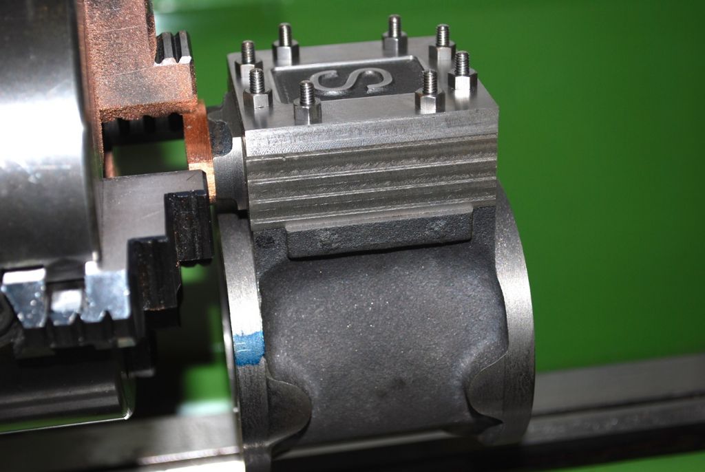

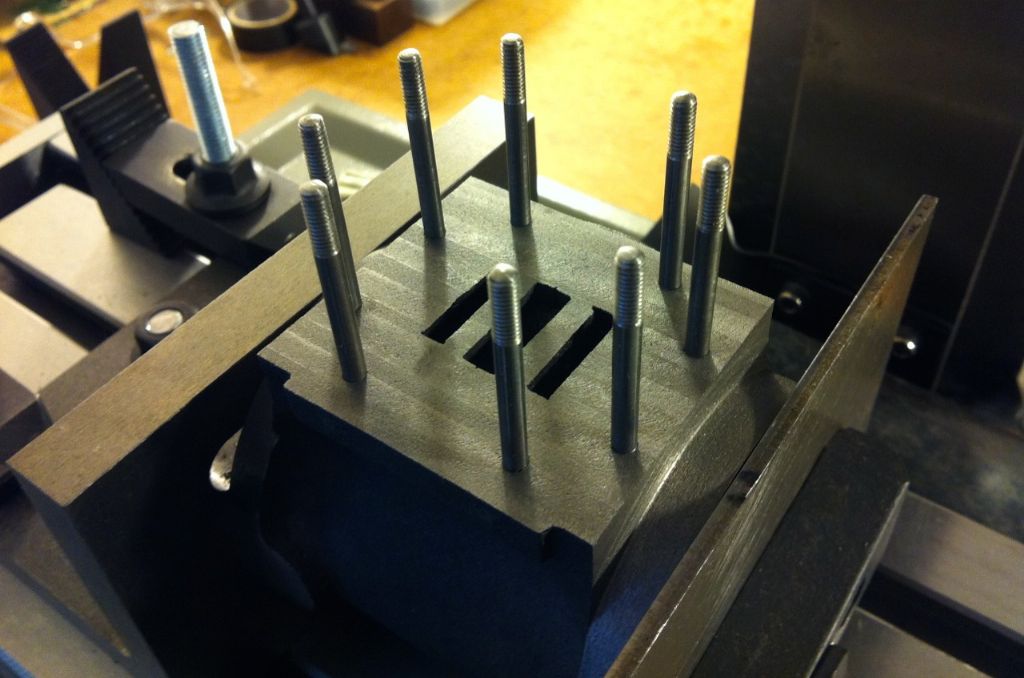

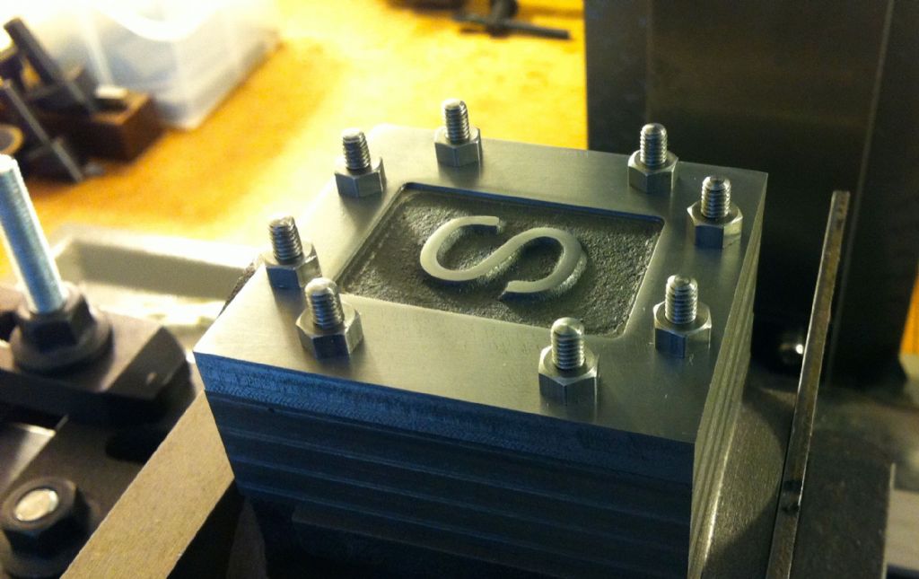

                            A couple more photos of finishing fitting the Steam Chest Studs..
                            All 8 4BA Studs fitted.
                            Test fitting the Steam Chest. Just one of the holes had to be opened out from 4BA Clearance Size to 3.8mm – something happened when I had to stop on that particular hole to extend the drill bit, bit of a mystery to me, the Steam Chest Cover was ok and all holes at 3.7mm..
                            Test fitting the Steam Chest Cover.
                            Cheers

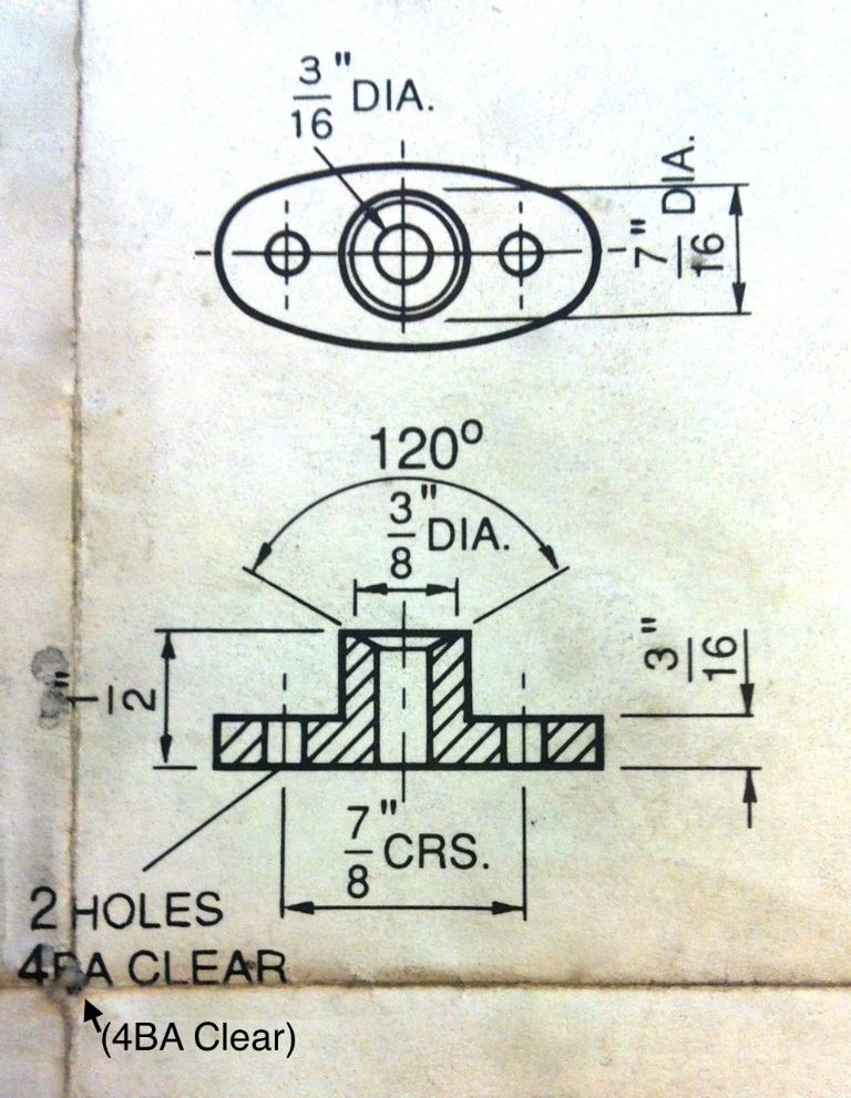

                              Next to do is the Valve Rod Gland.
                              The Valve Rod Gland Drawing.
                              The Glands for the No.1 should be a bit less work than having to cut individually from an oval bar as was supplied with Victoria – but the No'1's are much bigger..)

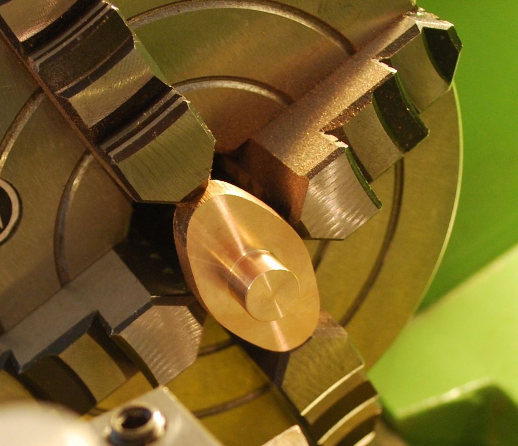

                                Making a start with the Valve Rod Gland – after some tidying of the casting with a file, setting up the boss to run true as poss in the lathe – time for the pencil again. I did try using some tape to try and make it a bit easier to adjust the jaws but I managed better without I think.. (Tape and parallels removed before turning of course.).
                                Checking the fitting of the gland in the Steam Chest – it was a close fit, no play but not really the 'easy' push fit I was aiming for – I tried to remove a half thou with the hand wheel scale and should have just run the last pass on the same setting at the end I think.. But hopefully ok.
                                Most of my lathe time I've been mainly using carbide inserts but this time I sharpened my HSS knife tool and its made a cleaner job of the corners and I've noticed that in checking the reducing diameters the cuts are more accurate than I was getting with the inserts – first time i've noticed this but the checks were all coming pretty much spot on and the tool was cutting very cleanly in comparison as well, different feel altogether..
                                Ready for drilling and reaming etc – I hope to be able to use the lathe centre height to mark out the fixing holes before removing from the chuck.. and later I should be able to use the 1/2" filing buttons I've already made..

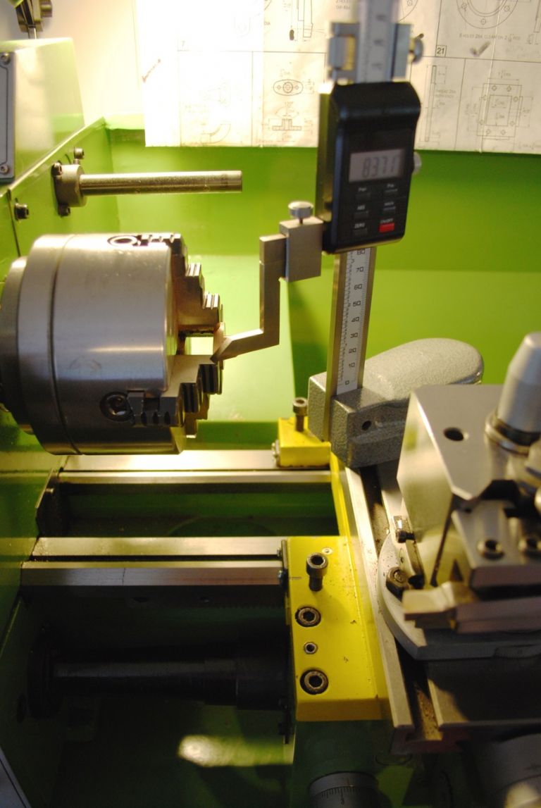

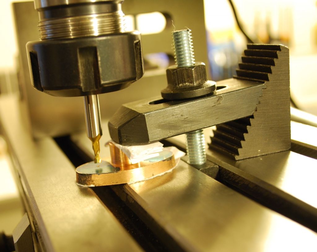

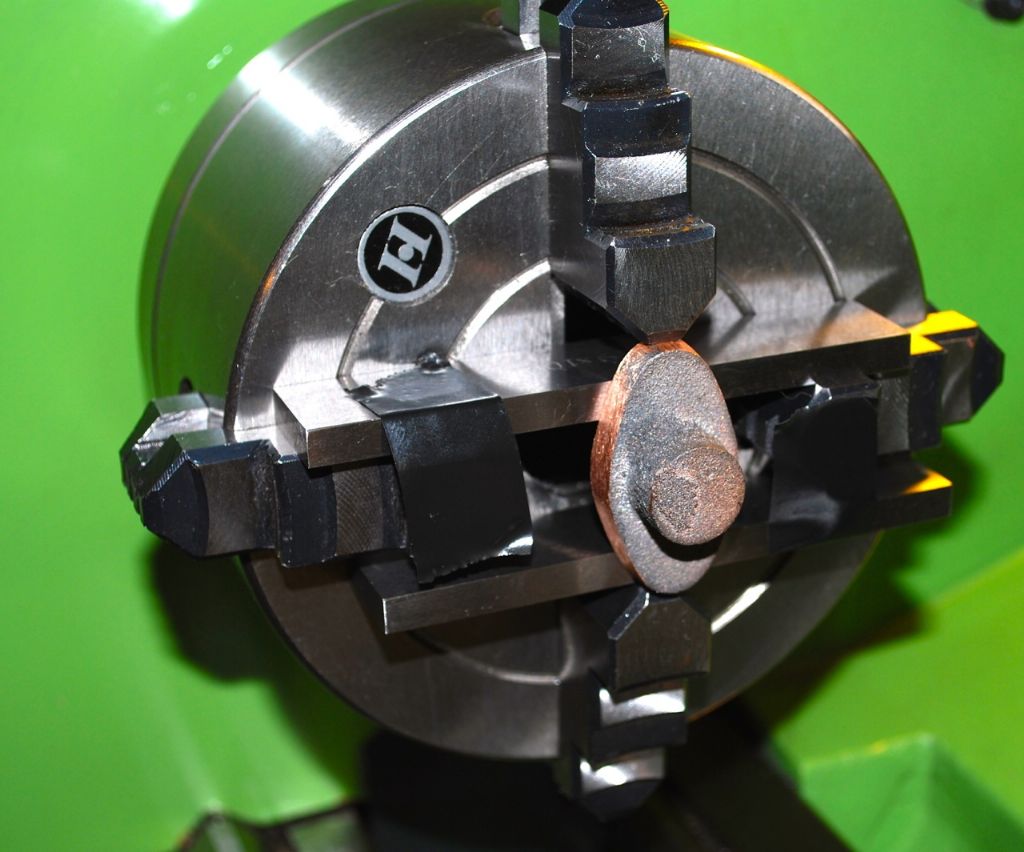

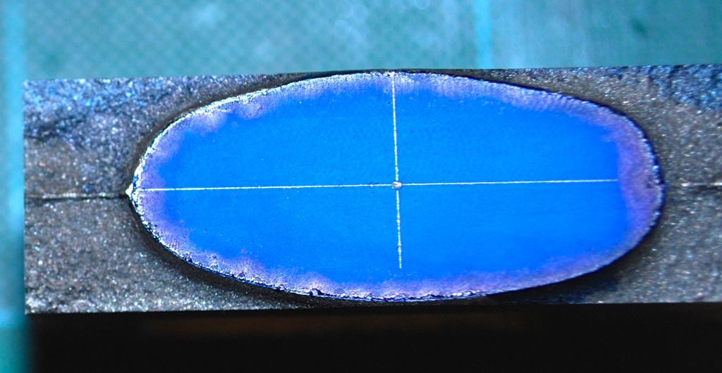

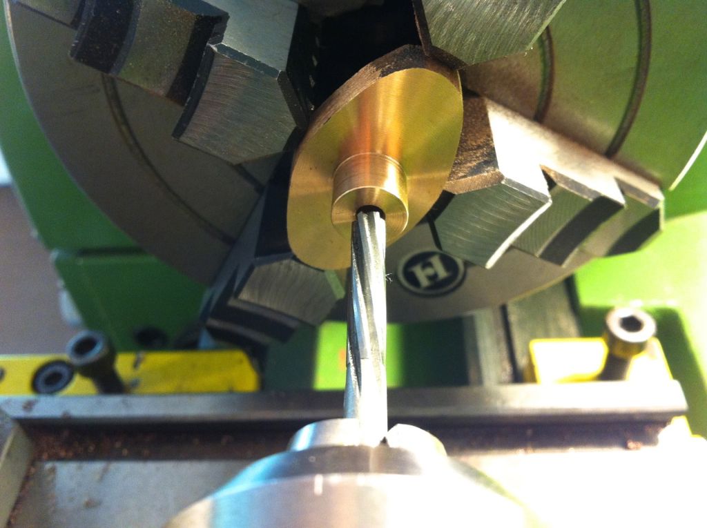

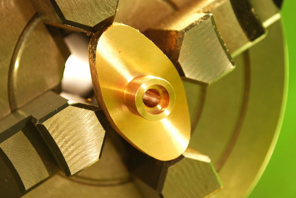

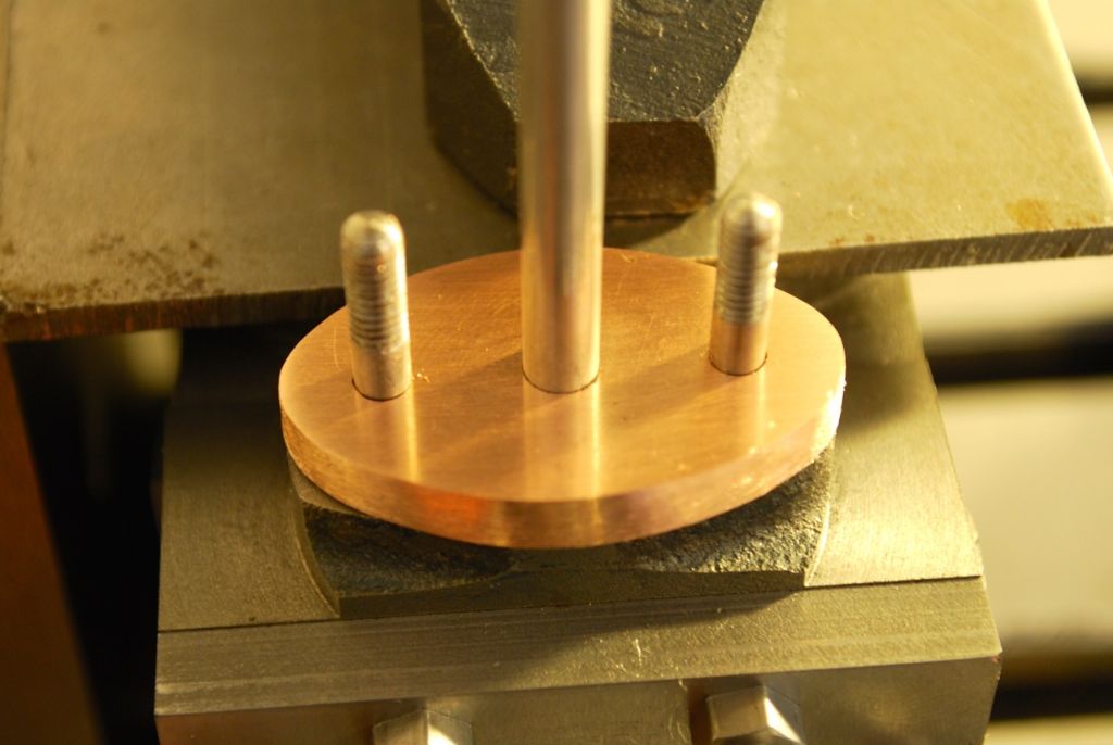

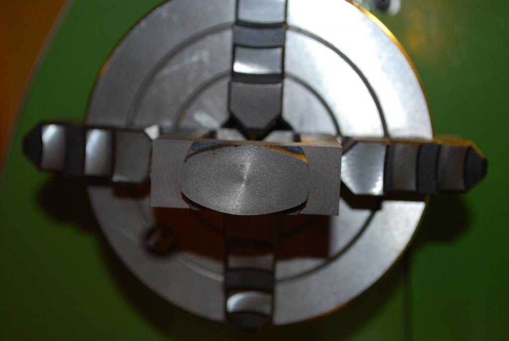

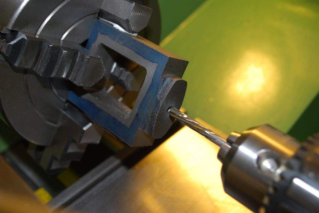

                                      Drilling, reaming and marking out the valve Rod Gland..
                                      Reaming the 3/16" hole for the Valve Rod.
                                      I wasn't sure how to bore such a small hole out to the 120 degrees angle, so I opened out the mouth using a slot mill to 8mm and 2.75mm depth (approximated depth from the drawing measurements) and left square (leaving square was an option in the notes I have so hoping that will be ok). The slot mill caused a bit of a burr so I had to pass the reamer through again.

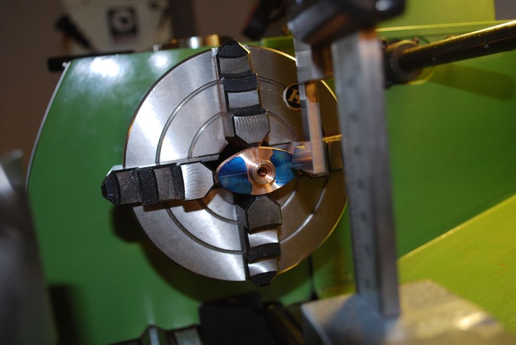

                                      Then using my lathes centre height 74.96mm and marking the gland slightly each side of the chuck to get horizontal the centre line was lightly marked..
                                      then the height gauge used to rotate the jaws 90 degrees..
                                      and the fixing holes marked from centre height ready for drilling on the mill.. I have struggled big time to mark these out in the past because of the shape and never was able to achieve any accuracy really – this method is quick, easy and accurate..
                                      (another great technique learned from Jason)
                                      The ends will be shaped with filing buttons from the fixing holes – and I've yet to face the bottom to thickness..
                                      Cheers
                                      Garry

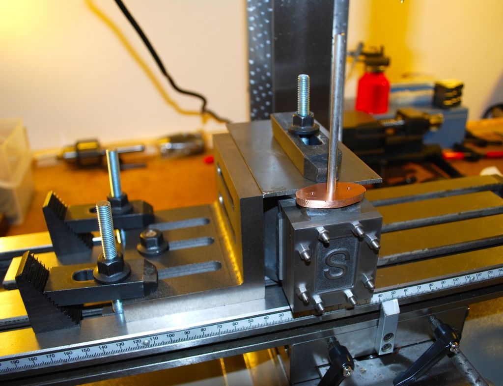

                                        Couple of quick photos of this mornings efforts – may be in with a chance of an hour this afternoon as well…
                                        Drilling the Valve Rod Gland fixing holes.
                                        The fixing holes drilled tapping size for spotting through to the Steam Chest – not shaped at all yet..
                                        Checking the Valve Rod alignment before drilling the Steam Chest – fit feels great and slides with no play.
                                        One of the Valve Gland Studs in.
                                        May be more later today..
                                        Cheers
                                        Garry
                                        Edited By Garry_C on 14/09/2015 12:15:10

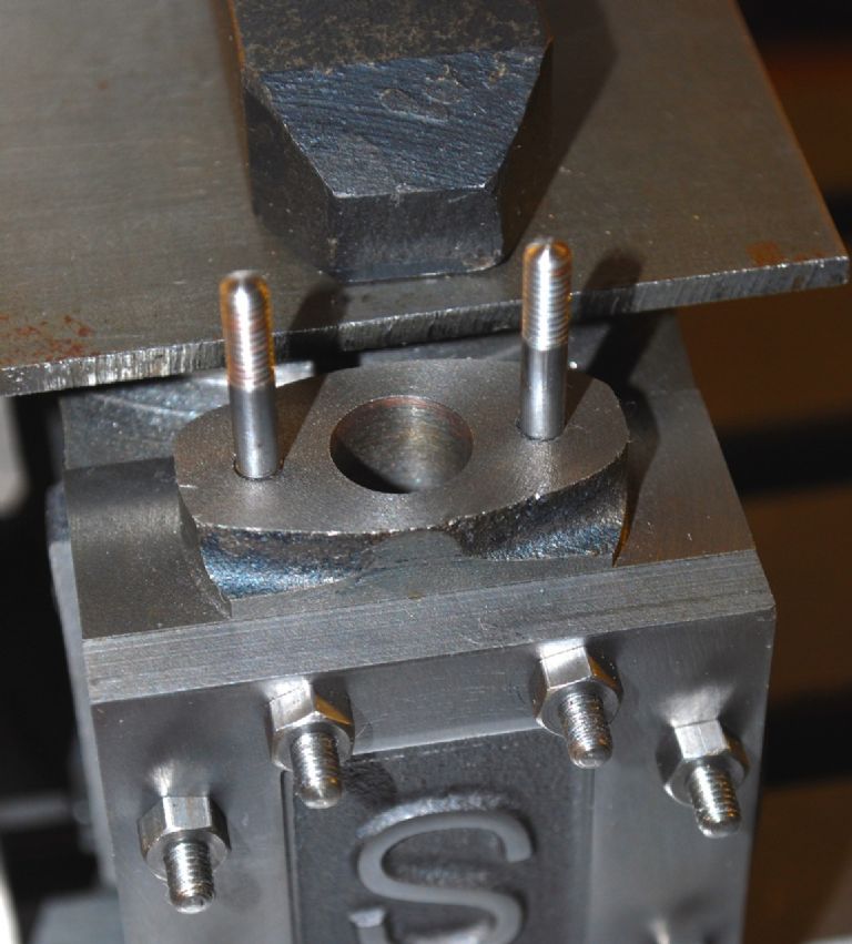

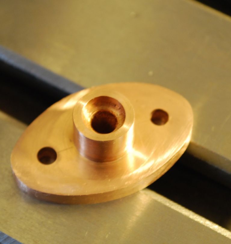

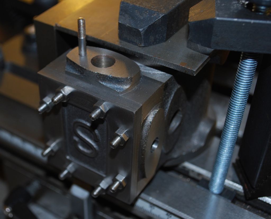

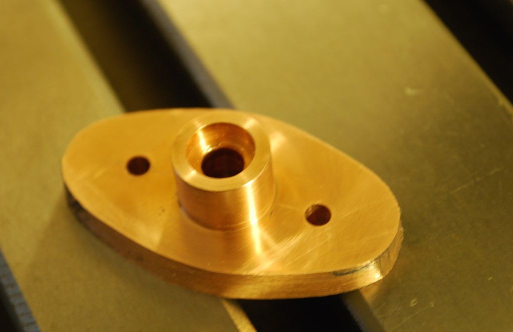

                                                After some time with the filing buttons the finished Valve Rod Gland – just needs some cleaning up before assembly..
                                                Its not a perfect shape as just done by eye..
                                                I've yet to file the Steam Chest Boss – thats going to be awkward I think..
                                                Cheers all..
                                                Garry

                                                #204389
                                                Jeff Dayman
                                                  @jeffdayman43397
                                                  Looking great Garry, well done.
                                                  For filing the steam chest boss, you might try a "protector sheet". This is just a piece of thin sheet steel with a cutout to closely fit the boss protrusion, to keep your file and Dremel wheels off your nice machined steam chest surface. If you make it out of shim steel .005 to .010 thick it will be durable enough to protect the surface but thin enough to not be in the way, even if taped in place at the chest edges and over the chest cover which could be left in place.
                                                  Enjoy the Cornwall trip. JD
                                                  #204393
                                                    Or you could just mill it with a radius corner cutter, set it a thou or two above your finished chest
                                                    #204394
                                                    GarryC
                                                      @garryc
                                                      Thanks Jeff, I've been wondering how best to go about that – just ordered some .006" steel shim roll (6" x 12" ) which seems cheap on Amazon – will have a go when we get back.. I've got some old but sharp scissors which I hope will do the job…
                                                      Cheers
                                                      Garry
                                                      Edited By Garry_C on 15/09/2015 15:07:57
