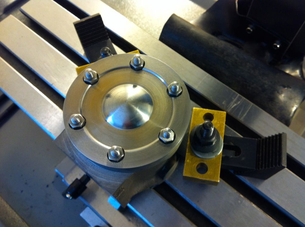

      Have the Cylinder Top Cover fixed in place this morning (the cylinder studs done the same way as the bottom one). I'm quite chuffed as all 6 holes in the cover were able to stay at 2BA clearance size 4.8mm, I must be getting better…
      Last photo of the covers, promise..

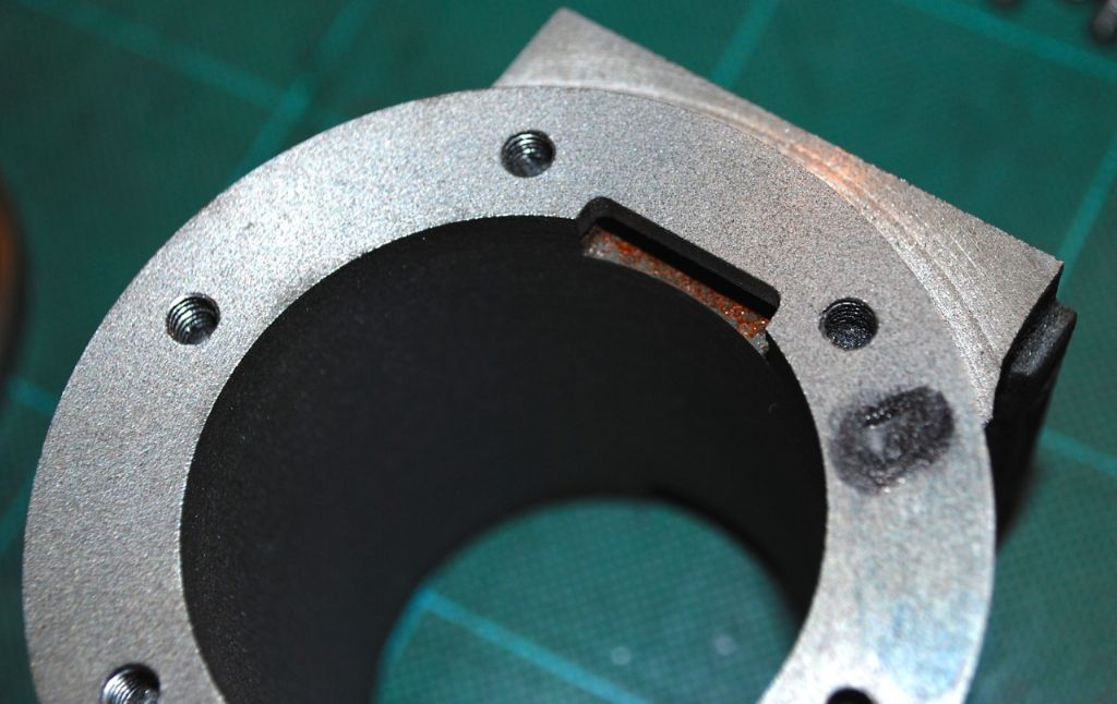

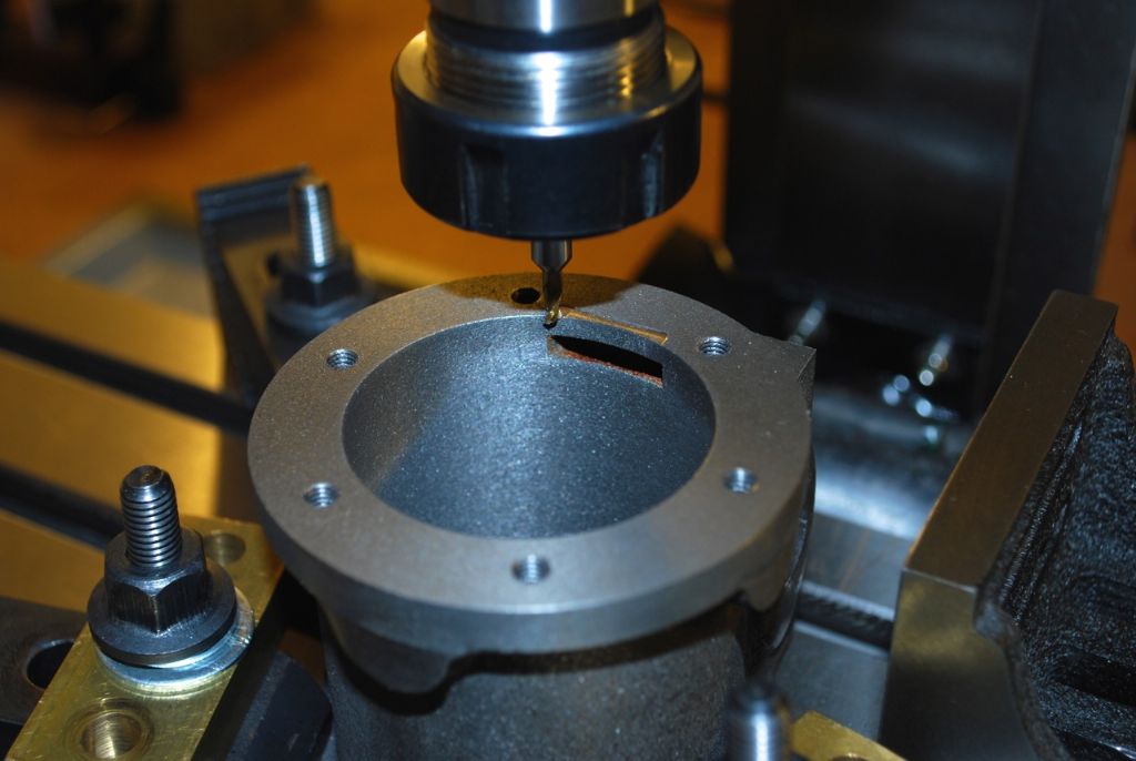

        Just a quick couple of photo's of making a start this morning on aiding the steam to reach the end of the Cylinder..
        Starting using a 4mm slot drill.. I didn't make all the cuts that fine, I think I went down 0.5 mm at a time..
        One side done, but I may have been a bit heavy handed and taken away too much..
        The other end after breakfast then having a go fitting the Drain Cocks and a 'groove' from their holes to the end of the cylinder – to aid water to get away from the ends of the cylinder.. At least I hope I'm understanding that correctly..

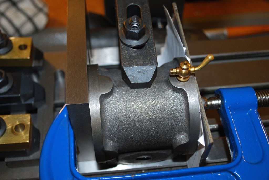

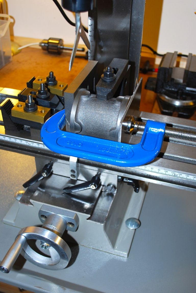

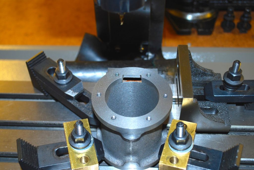

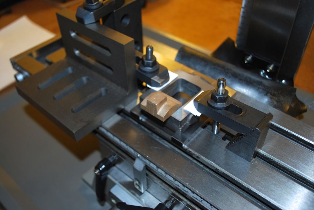

          and while the kettle's boiling..
          The other end of the Cylinder and that steam inlet opened out to the end of the wall.
          then lining up to drill for the Drain Cocks.. That (wedge) clamp on the Cylinder wall is only very lightly tightened..
          almost ready to start drilling and tapping..
          Cheers
          Garry

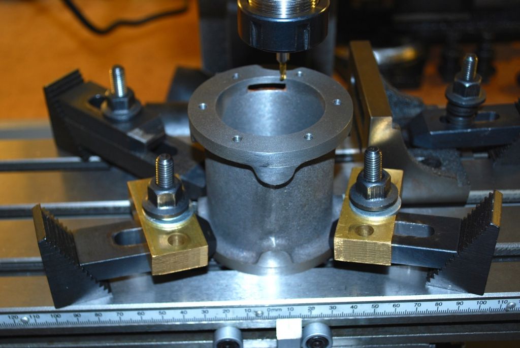

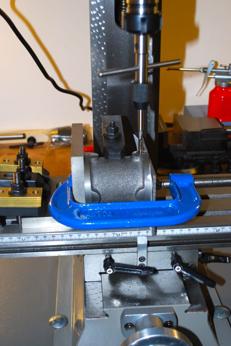

            Tapping the Drain Cock Hole..
            One Drain Cock fitted – one to go..

              Ports and drain valve fitting look great Garry, well done. JD

                  Gary, why is your machine so clean? I am beginning to suspect you may be more experienced than it appears?
                  The quality of your work is excellent and it has been well thought out, It just makes me think.
                  Clivelaugh
                  #201140
                    More experienced at cleaning maybe.smile p
                    Its comming on well Garry, the size of the notches for the steam passages looks fine you still have plenty of surface area for the end covers to seal against and are not too close to the stud holes.
                    J

                        Gary, Did you need to have those notches for the steam ports ?, my thinking is that the steam port is cast into the cylinder wall and the steam has free passage into the cylinder, if the steam ports were in the cylinder bolting face then yes you would need the notches to form a steam way when the covers are bolted in place, I stand to be corrected.
                        Mike.
                        #201152
                          Mike if you have a look at the sketches that I posted at 8.39 on 24th July you can see that at the end of its stroke the piston covers these cast in passages. To get a better running engine and allow the steam into the small space between piston and end cover its common to notch out the material as Garry has done.
                          J
                          #201164
                          MichaelR
                            @michaelr
                            Jason, Your sketch makes it clear, I am now corrected.
                            Mike

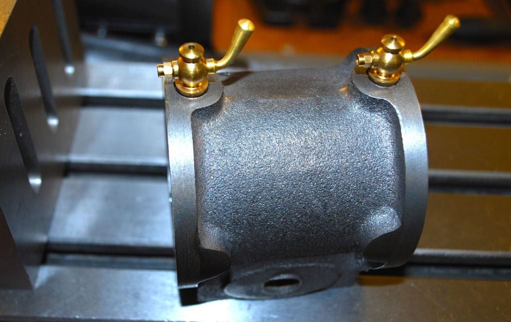

                              Not much done today, just the second Drain Cock (It needs bit of deburring by the looks of it). Its not quite tightening in the right position at the moment – so I hope maybe a bit of 'PTFE tape on the thread will allow me to align it when it comes to final assembly.
                              The Cylinder lagging should hopefully pretty much align with the depth of the shoulders, so they are a sitting a bit 'proud' at the moment….

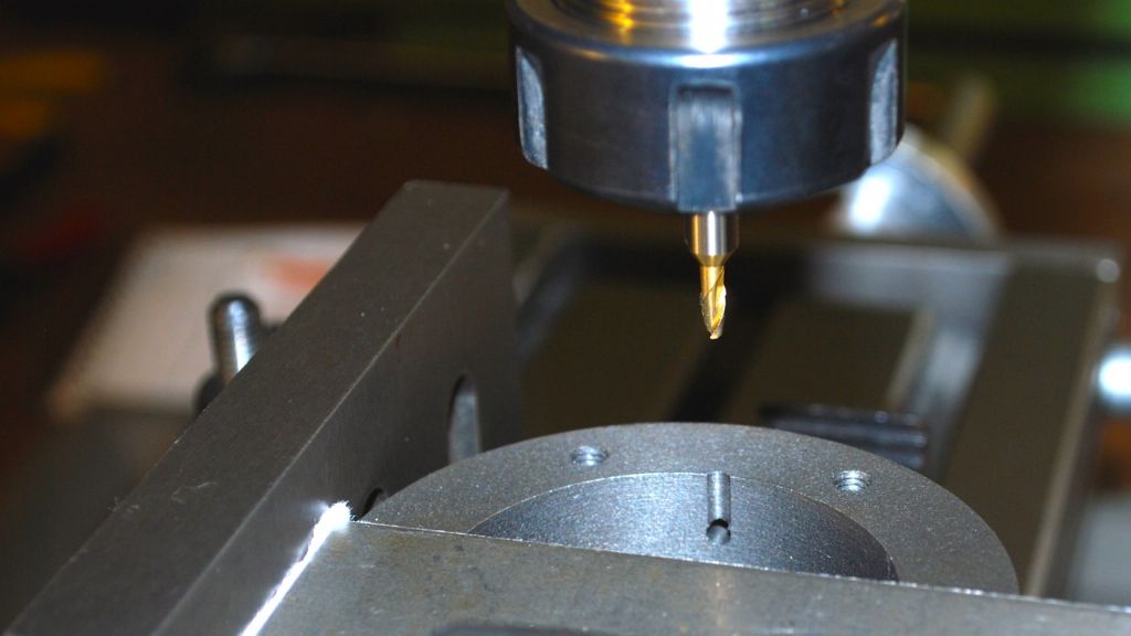

                                        I did get the two grooves to the Drain Cock holes done earlier. They are 1/32" deep and will hopefully aid water in getting out when the piston is at the end of its stroke.. (The cylinder was lined up on the 'through' hole from above and then flipped through 90 degrees each time…..) Not much but its all progress..

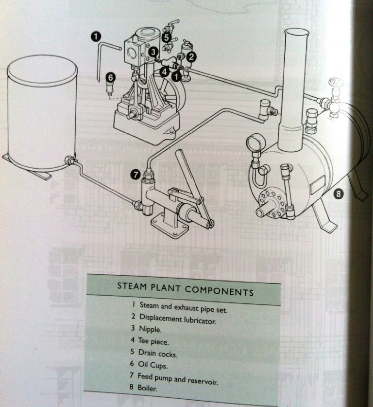

                                              I'm going to have a look at doing the Valve Chest next..
                                              Could anyone please tell me if the Displacement Lubricator should be fitted off (or close to) the steam inlet pipe as per the photo below or as Andrew Smiths guide book suggests on the opposite side of the valve chest to the steam inlet (maybe it doesn't matter?).. I should say that I may not have a permanent connection to the boiler so would likely need to connect to it as and when I want to use it (so I can use the boiler for other engines) – and also can I still run the engine on air with the lubricator fitted?428. displacement lubricator position.jpg
                                              Thanks for any advice and hope that makes sense – and apologies if its a silly question, I have a feeling I may have the wrong idea about how it works..
                                              Garry
                                              #201551
                                                They can be mounted either way on the steam chest or via a tee in the steam line so really upto you want you wish to do. The lubricator won't work on air but would not cause a problem if left on the side of the chest or it could be removed and a blanking plug/plate used
                                                #201553
                                                GarryC
                                                  @garryc
                                                  Thanks Jason, I'll mount directly on the steam chest opposite side to the inlet then…

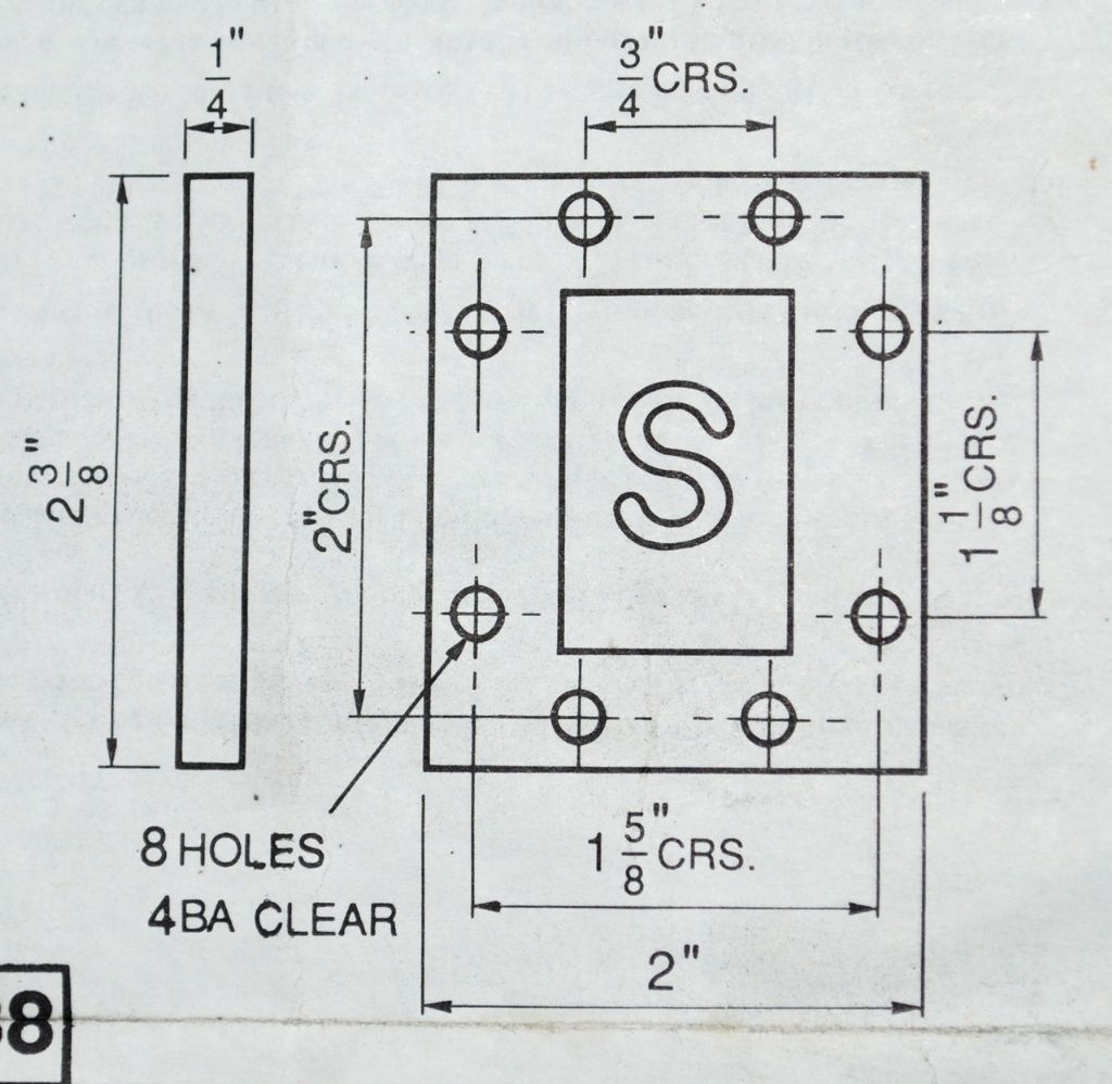

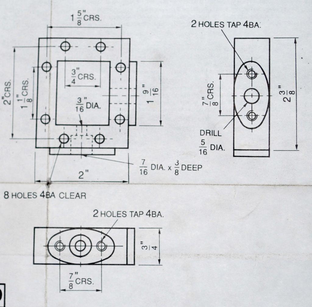

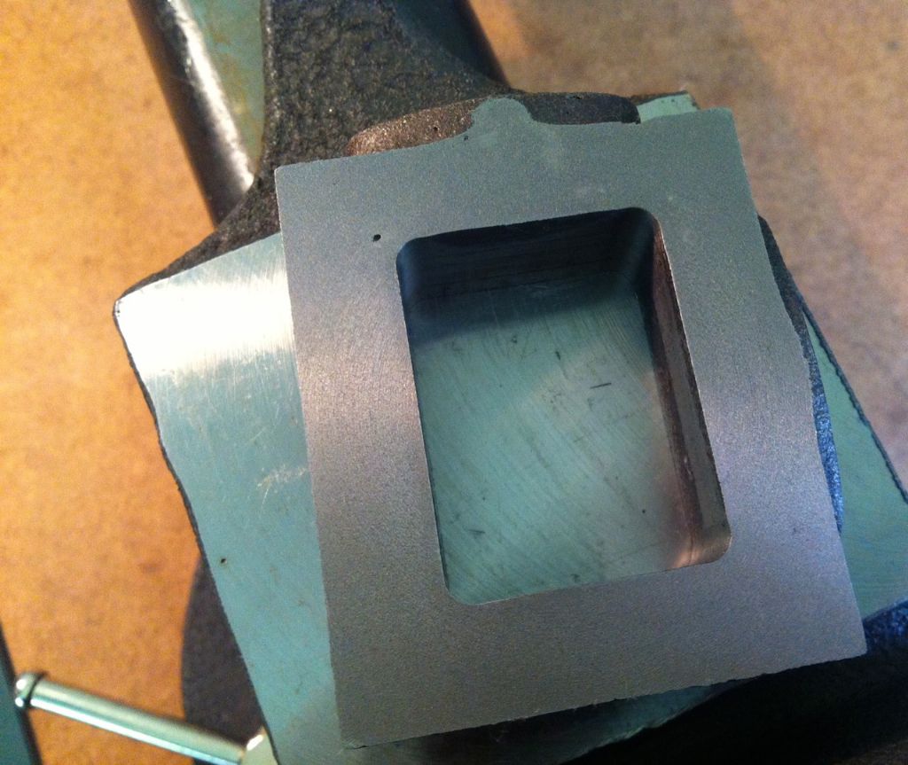

                                                    Just a little update to start work on the Steam Chest and Cover..
                                                    The Steam Chest Drawing.
                                                    The Steam Chest Cover Drawing.
                                                    The Steam Chest & Cover castings.

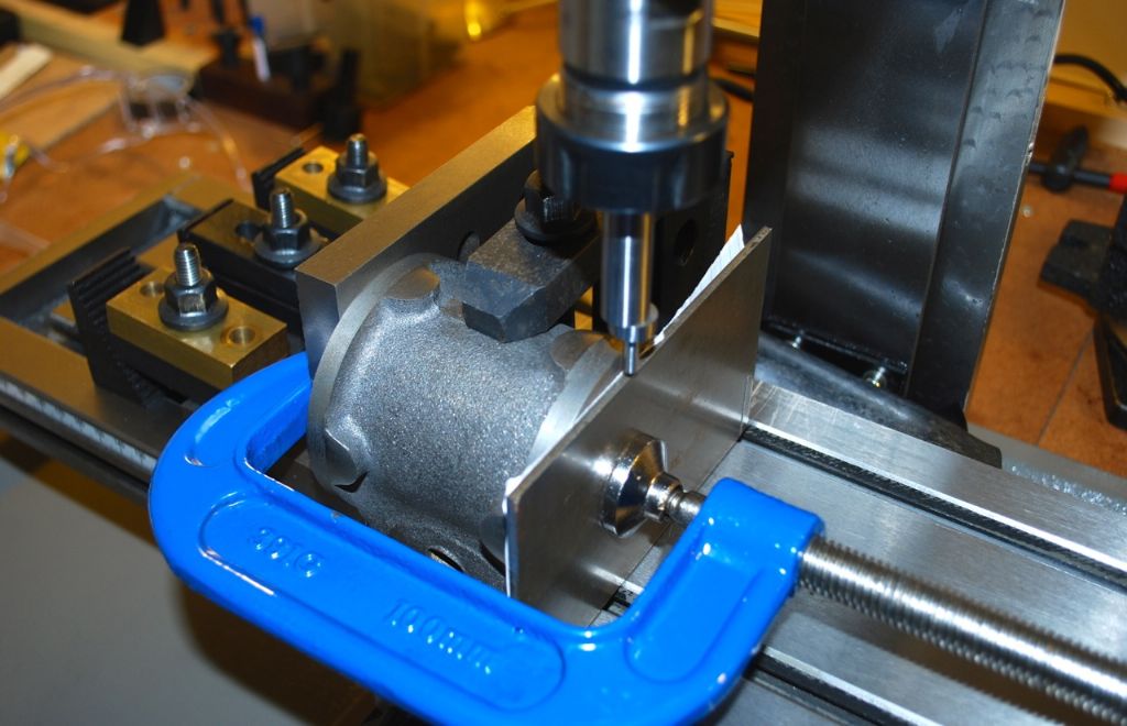

                                                    Starting to face both sides to the 3/4" thickness.. You can better see here I think the sides of the centre of the casting are quite 'bowed' and rough..
                                                    Sorry this one is a bit blurry – I wasn't quite sure what to about the inside, I seem to remember from Victoria that it was important not to take away too much material to clean and square it up..
                                                    This photo showing the setup used – 6mm End Mill as the cutter.
                                                    [also showing the Slide Valve casting – thats to come as I've not done anything with that yet.]
                                                    So I've really only just barely taken away the skin and not all of that – 0.05 cut around each length – but its nice and square now and I can always do more to it later if need be – although I was a little bit out in one corner. I only have 'stops' on one axis on my Mill – maybe that's normal I don't know. I went out I think from 'once' not locking the table when going 'down' to start a new cut around the rectangle – sorry thats not very well explained..
                                                    But I now have clean lines around the rectangle to be able to measure outwards from to mark the sides to size..
