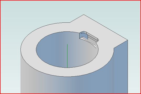

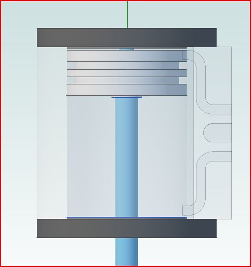

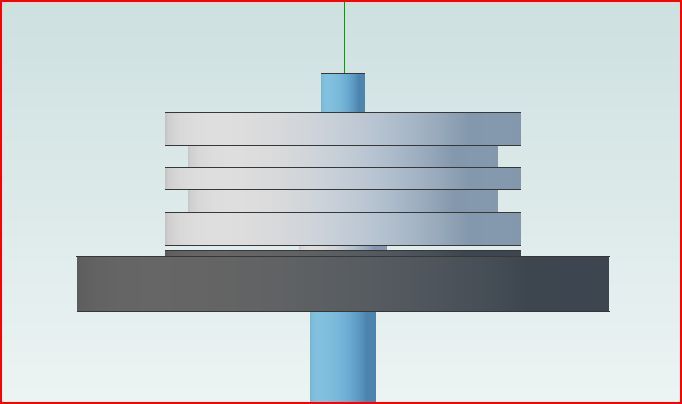

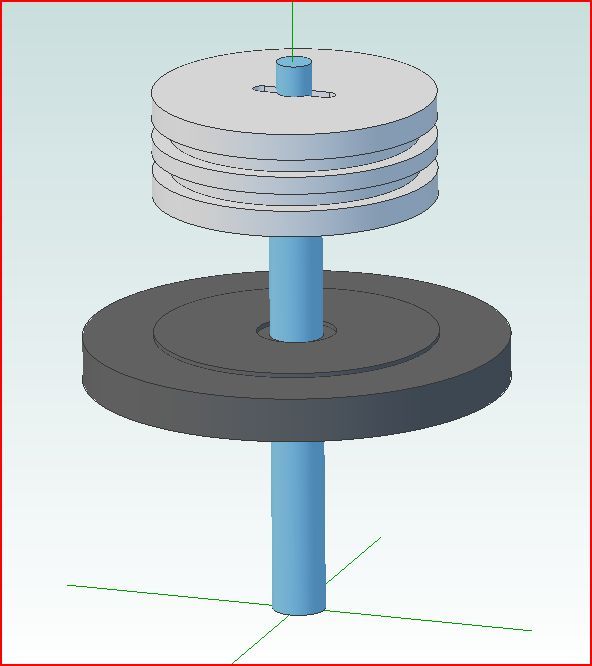

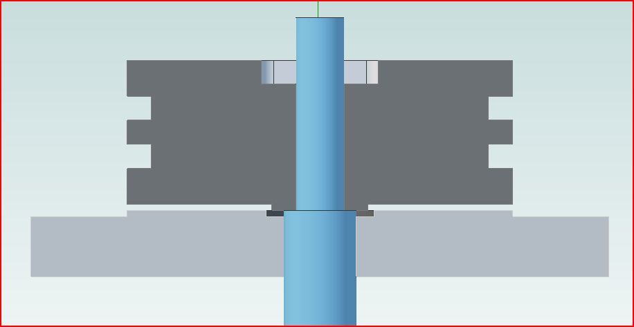

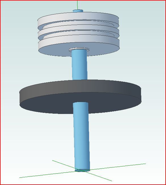

                                        #197834
                                          Oh no you don'tsmile p
                                          You say that the shoulder on the piston rod is 0.001" above the spigot on the cylinder bottom cover so all we need to do is modify the piston so the majority is another 0.030" above the cover. To be safe its also worth adding a bit of clearance where the piston touches the rod shoulder.
                                          This shows a 1/2" dia boss on the bottom of the piston that is 0.030" long.
                                          And to clear that boss a 9/16" dia recess in the top of the cylinder cover that is also 0.030" deep
                                          Looking from the side you can now see that there is 1/32" clearance between cylinder cover and piston
                                          Same view but in section, the recess has come out a bit dark as the program is adding shadow but you should get the idea
                                          I'll do a dimensioned drawing later but Le Tour becons
                                          Edited By JasonB on 24/07/2015 16:28:30

                                              #197861

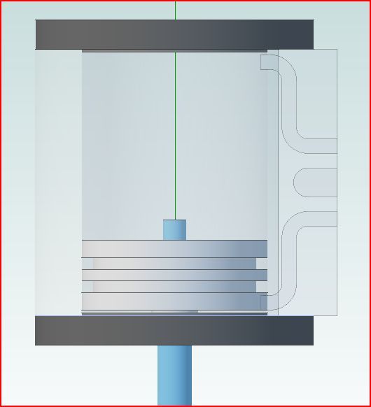

                                                Roy as drawn the top of the piston is exactly the right distance from the crosshead pivot as per the Stuart drawing so can't see how it would affect the unswept volume.
                                                The 0.030" boss is in effect extending the piston rod by the amount it is too short, the piston is still 3/4" thick excluding the boss as plans. Or look at it anotherway the piston has been unscrewed from the rod shoulder by 0.030" and a washer in teh form of teh boss added.
                                                J
                                                #197867
                                                  For those that like looking at pictures here are a few more. I don't see the point in drawing the crank and crosshead but will assume the crank is to drawing and has a 2" throw. Garry has previously stated that teh shoulder on teh piston rod stands 0.001" above the top of the lower cylinder cover so here it is with my modified piston screwed onto the end.
                                                  No if I alter the position of the shoulder from 0.001" to 2.001" above the lower cover this is what we get
                                                  Looks spot on for equal gap at each end of the stroke to me. Ideally it would be nice if Garry could confirm the height of the shoulder at TDC then it would be possible to make allowances if the stroke is not quite 2" dead.
                                                  Garry regarding your other point about where the passages exit teh side of teh cylinder, it will depend on where they are cast to some extent, try to take metal off each end of teh cylinder to leave an equal amount of wall each end, I have shown 1/16". As you can see this covers the port at TDC and BDC so what is often done is to mill out a small amount of cylinder wall so the steam can get right to the end, something like this
                                                  J
                                                  Edited By JasonB on 24/07/2015 20:40:04

                                                      Jason that is absolutely superb.
                                                      [the height to the piston rod shoulder from the surface of the bottom cylinder spigot at TDC is 51.25mm.]
                                                      I have learnt so much today and its been brilliant, thank you very much indeed.
                                                      I've taken up far too much of peoples time – I can get stuck in and sort it out now…
