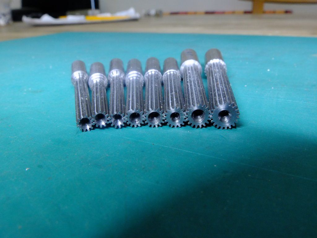

      I spent the weekend cutting gears.
      There are 3X12, a 14, 15, 16, 18 and a 20 tooth, all Mod 0.3.
      More sizes than I really need but setting up for pinion cutting is a bit of a pain so I thought I would "future proof" my parts box. You never know when you might feel a five-speed gearbox coming on.
      Steve

              Thanks Brian, I will be using some for a 1/12 scale V8 for the cam gear train and some more for a tumbler reverse gear in the matching gearbox.
              Also I may use some for motion work in a clock project and to make a spur gear differential.

                May I make a suggestion applicable to any divided and parted-off batch-work, such as hexagons, not only gear-cutting, in that style?
                I found it better, if possible, to make initial parting-tool grooves in the appropriate places first, to very slightly below the roots of the features (spanner flats, I think I was making).
                Then perform the milling, which does not mind working across grooves provided you go steady with the break-throughs if using a slot-drill.
                In this way the parting-off is never on 'orrible interrupted cuts.

                  Thanks Nigel, I did initially consider pre-parting them and I now wish I did for a few of them.
                  My problem is, apart from half a dozen gears, I don't know how thick I might want any other pinions to be.
                  I hate parting off gears. The teeth act like a musical box with a loud high pitched whine.

                      Parting off with a circular saw in a mill should avoid the “musical box” effect.
