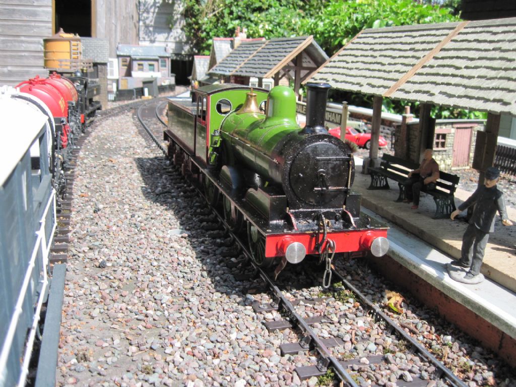

                            If you are thinking "Scenic" (e.g. a Garden Railway) Derek – then (again) I would not really recommned 3.5" Gauge – there is not too much 'stuff' available outside of the engines…
                            It really does depend on what interests you but if it's British Standard Gauge (and live steam) then as Baz says, it's going to be Gauge 1 or Gauge 3 and as you may have already gathered, I choose the later.
                            If you want to model American or European Railways then it's probably going to be some form of 'G' Scale (there are various scales that all run on 45mm track)
                            If you are interested in Narrow Gauge railways, then it will be '16mm' on either 32 or 45mm track.
                            However, given that you are interested in scenic, then I would suggest again that the G3 book would be very useful to you. It has a lot of useful info for anyone thinking about building a Garden Railway, whatever scale or gauge you eventually choose.
                            Gauge '3' Society
                            Regards,
                            IanT

                                          I thought about two of our G3 GTG venues. This one is set very nicely in the garden and is ground level at the back and raised a little at the front. What may not be so obvious however, is the chest-level steaming bay at the side of the house which makes engine preparation much easier. Tenterden – Ground Level
                                          Then there is the raised track approach as seen here Thurnby – Raised Track Note the engine prep that's going on and (as these are engines are mostly not R/C controlled) the 'interventions' going on too. Just because you don't get pulled around the track, doesn't mean you don't drive the loco. We do have R/C of course but many members prefer the 'hands-on' approach.
                                          Btw – One of the guys talking on this video is Alan (one of our founding members from 1990) who has very sadly passed away since the video was made. A lovely bloke and very skilled model engineer, he's much missed by all of us.
                                          Finally, just watch that opening shot in the second video again. I have to say that it doesn't make me think that G3 is "a bit small" – it's very far from that!
