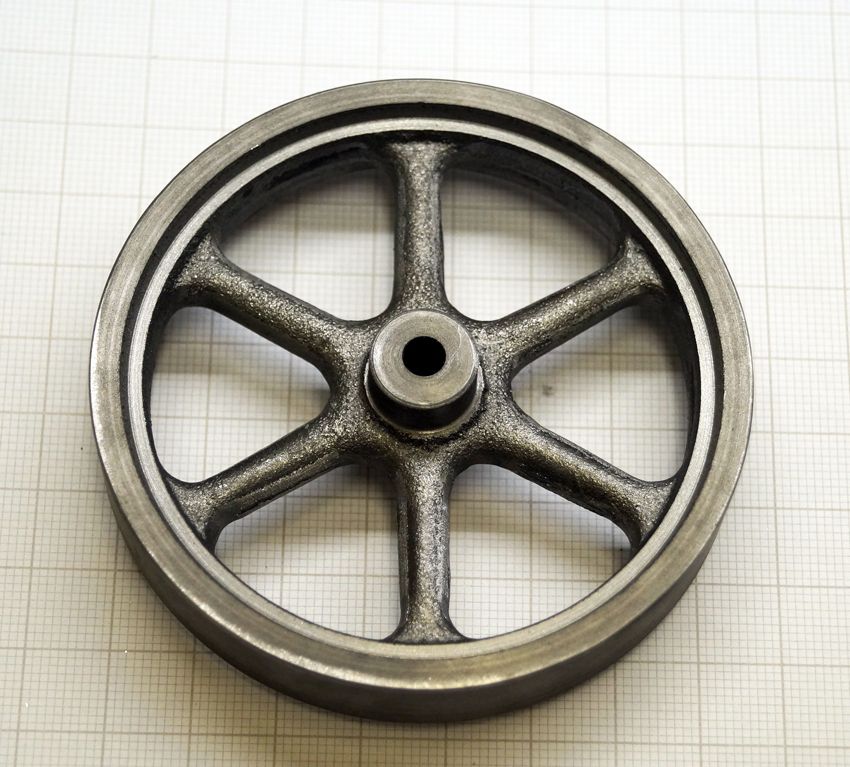

          Ron Laden
            @ronladen17547
            I just purchased my first ever casting, I think on the quiet I must be a make it from bar stock man..lol
            I thought an iron flywheel would do the little engine justice and look more the part rather than knock something up so I got a 3" x 1/2" wheel from Stuarts. I was hoping the casting would look like the one pictured on their website, well I wasnt disappointed in fact I was surprised at how good it is.
            Set it up on the 3 jaw and just 0.6mm skimmed and trued the rim, 0.3mm cleaned the rim edges and 0.5mm faced and turned the boss. Ten minutes with the dremel cleaned off the spoke flashing which was very slight.
            I dont know if Stuart flywheel castings are always as true and clean as this but I am certainly impressed.

            geoff walker 1
              @geoffwalker1
              Hi Ron
              Well occasionally they are defective but the great thing about stuart castings is that they would rarely supply you with one. Even if they did and you found it to have flaws when machining they would send you an instant replacement. Excellent company.
              Unfortunately for me I bought one second hand on *bay and it was full of air holes revealed after machining. Lesson learned always buy from stuart models. The old adage, "buy cheap buy twice" applies
              Geoff

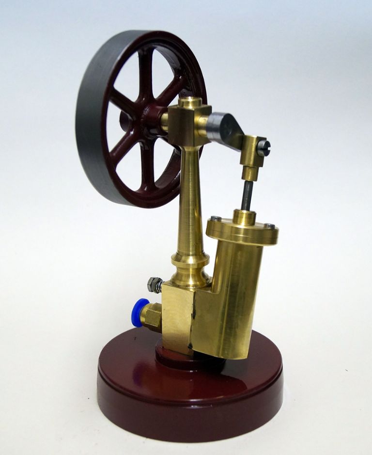

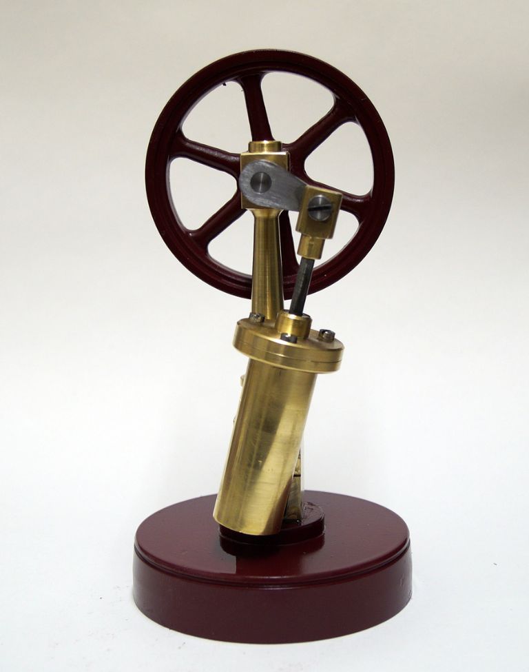

                      Ron Laden
                        @ronladen17547
                        Finished, maybe not perfect but I am reasonably happy with it for my first engine, even happier that it runs ok. I have learnt quite a few things in making it so thats good.
                        I turned a steel plinth to offer some stability when running, seems to help up to mid speed.
                        A couple of pics and a short bit of video of it running.

                        #453447
                          Looks good with a splash of colour Ron.

                            Well the wife likes the look of the little engine, she even suggested finding a place for it on a shelf indoors, now that was a surprise. smiley
