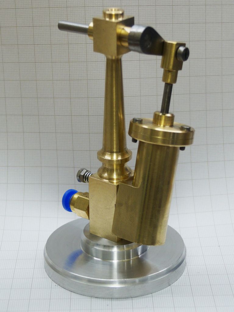

      Thanks Geoff/Jason, up early this morning and I lapped in the faces.
      Something that has surprised me is the recommended compression spring, its quite a strong little spring 4.3mm i/d 0.7mm wire with 10 coils in 12.7mm length. Anyway I dont have one to that spec but I have one which matches the diameter and the wire but is more open with 7 coils per 12.7mm, I will give that a go it is adjustable of course.

        A lot will depend on what you do with the engine, if just running for display on a few psi than a light spring will be OK. Once you start to put the engine under load which required a higher pressure there is a greater risk of the air taking the easy option and lifting the cylinder off the portface rather than pushing on the end of the piston so a stronger spring will keep it held in place.

          Thanks Jason, it will only be running for display so I think the spring I am using should be ok.
          I turned up a temporary plinth/work stand to save it lying around or having to prop it up on the bench.

            Impatient as I am and having not yet received the steel for the flywheel as well as being mad keen to see if the engine would run, I searched the shop for something to fashion a temporary test wheel. The only thing I had was a short piece of 3 inch diameter 6082 so I used that, its not very true but as it turned out it served its purpose.
            The good news is the engine ran straight away with no problems and I have made no adjustments to it, as it is in the video is how it ran from the start. I havnt shown it at its top end speed as it would take a walk across the bench with out it been held down. This is all new to me but I was surprised at the bottom end speed which I thought quite slow for a aluminium flywheel, it will be interesting to see if that changes with a steel wheel.
            Anyway it goes without saying I am really pleased with it.

                Runs well Ron though next time put the sound on so we can hear the chuff, chuff noise.Another option to stop the engine jumping about would be to add some counter balance to the crank of flywheel, maybe something to consider for your second engine now you have got the bugwink

                  I am really chuffed with it I imagined a lot of fiddling and adjusting so it was a surprise when I turned on the air, gave it a flick and off it went..smiley
                  I would like to build in some counter balance to the steel flywheel if possible but how do you calculate how much or is there an element of guesstimation..?

                      It is possible to weigh the various moving parts and work out what the balance weight should be but on something like this trial and hopefully not too much error will do. If you are making the flywheel as per drawing then I would think about leaving one of the holes smaller and then testing the engine gradually opening it up until you get the balance. This may not suit the eye so the other option would be to add some weight to the rim much like you do a car wheel and then blend it in with filler and paint over the top.

                          The flywheel needs to be as balanced as possible but without a balanced crank as well I can't see how you will ever have a good static balance and without that never have a good dynamic balance.
                          To aid balance the crank is better with a crank web such that when you rotate the engine by hand it will NOT settle in the same place every time. The web can be adjusted for size by making it larger or smaller or adding weights to the web
                          Three of the simpler muncaster engines have no balanced crank.?

                            Geoff, thinking about the balance I dont think I will worry too much about it, I will get a bit of weight into the plinth and I wont be running the engine flat out. I think it better run at just below mid speed or slower and the engine is quite stable at those speeds even on the temporary lightweight plinth.

                                        I was thinking about the question of balance and having just watched the video again that has confirmed what I was thinking. The movement is not so much caused by the piston going up and down but by the cylinder moving from side to side, you can see the base of the engine moving in one plane when it speeds up about half way through the video.
                                        More weight in the bottom would help such as changing the aluminium base to steel or iron and then punch out a couple of thin rubber discs and glue to the underside so it is less likely to slide about and also saves marking the shelf/table/display case.

                                          Yes watching the video I see what you mean, I am thinking of a 100mm base probably round in shape and a reasonable thickness to elevate the engine so steel I guess should be heavy enough.

                                                    Most if not all of the hit and miss engines that I have made don't have any form of balance to the crank and even my 2" Fowler does not all as per full size but they do have balance weight or hollowed out parts to the flywheel to provide the counter balance.
                                                    The above paragraph, interesting, what I would describe as lateral thinking.
                                                    Are you saying that if one component is out of balance, the crank, you also make the flywheel out of balance to counteract? Would the weights/hollows on the flywheel be at roughly 180 degrees to the crank pin and big end.
                                                    I can see the logic and how it would work, but like I say lateral thinking and very interesting.
                                                    Geoff
                                                    #451895
                                                      That's it. The hollow is on the crank pin side of teh flywheel and the weight on the opposite side, couple of examples
