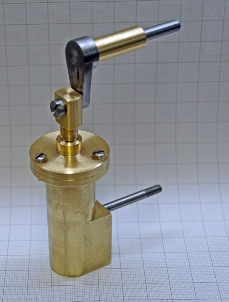

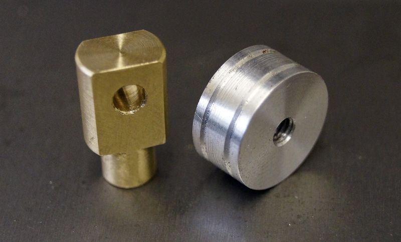

        Only had time for two small parts today, the big end and the piston. The piston is 0.004" oversize, hopefully that is enough for adjusting its size ready for lapping in once the cylinder is honed.
        Should have some brass bar on Monday so I can make a start on the column.

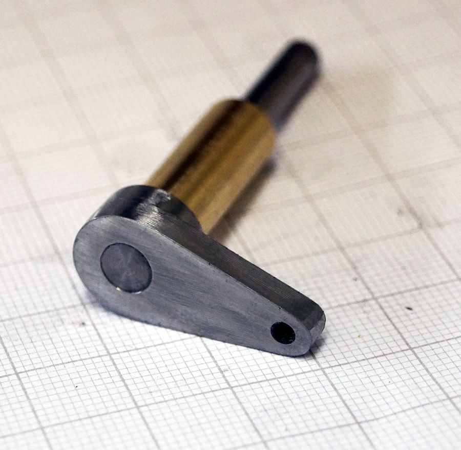

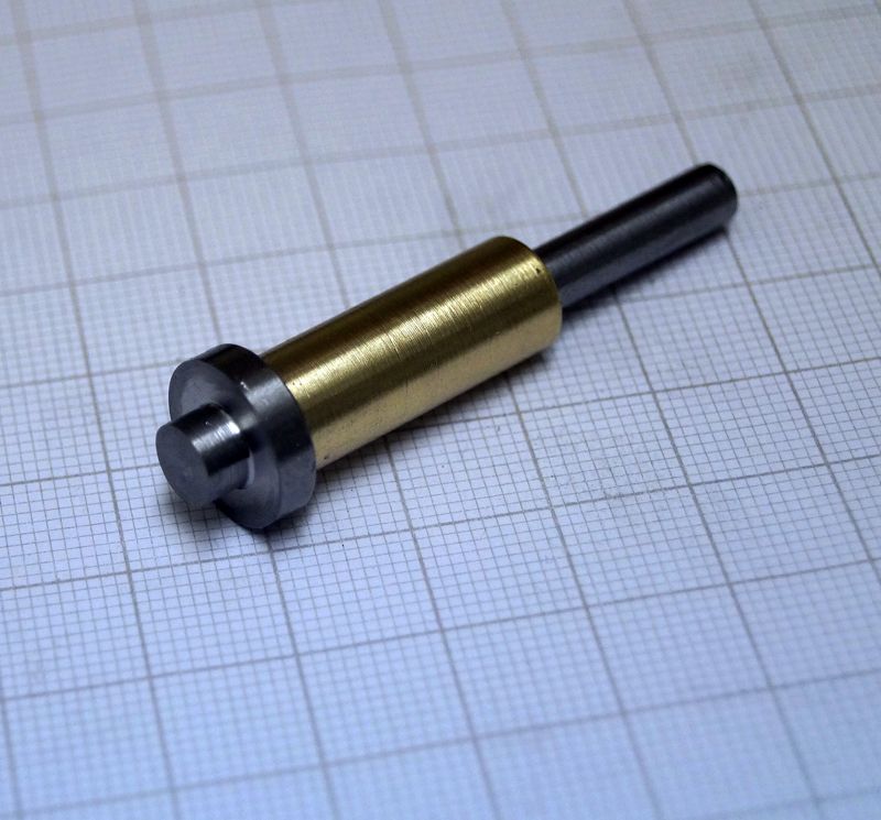

            Turned up the crankshaft and its bearing this morning, went with a different approach to the drawing. The drawing shows the crankshaft as a plain shaft with the crank arm added (close fit) then pinned, also the same fixing for the flywheel.
            I have turned up the shaft with a stepped boss as a one piece to which I will lightly press on the 4mm thick connecting arm plus a dab of retainer. The end result will look the same, I thought it just bit easier then machining up the one piece arm and boss.

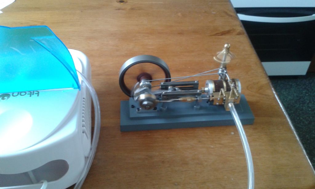

              20180619_162014 (1).jpgRon, I have found a nebuliser has enough air pressure to run these small engines, then you can see for tight spots and then adjust the parts for free running. Also the nebuliser will be handy when old age sets in, the best quality ones that my father has seems to have more pressure than my £40 one, but works a treat.
              Bob

                Hi Bob, I would never have thought of a nebuliser but I needed a new airbrush compressor anyway so I have killed two birds with one stone (hopefully)
                The engine looks nice which model is it..?

                            Crank arm made and fitted, its not perfect but the best I can do by hand with a couple of files. Its reasonably tidy and the hole centres are good so I think it will do.

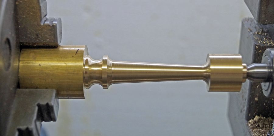

                                      Turned the column this morning, it looks a tad different to the drawing mainly because I used a 4mm radius form tool I had ground up for another job and I used that for the shaping.
                                      To the mill next, hope to get it finished in the morning.
                                      Excuse the poor quality picture.

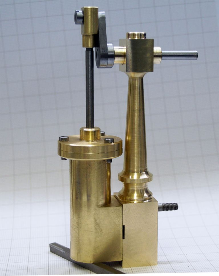

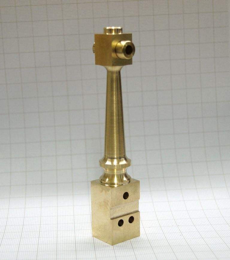

                                          Finished the column this morning, well apart from going around it with the needle files. A couple of changes I have taken the inlet and exhaust straight through to the back of the column, I just thought it neater than on the sides. Also the brass bar I used wasnt big enough to include the column base fixing lugs/brackets as a one piece part but I will machine those in the base plate for the same effect.
                                          A couple of pics, one showing that the parts actually fit together..smiley
