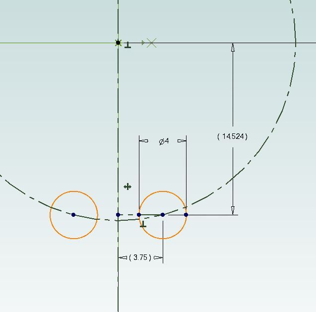

      Ron, if you wanted to try the alternative valve ports then give this a go. 4.0mm holes instead of 3.5mm and I have shown the X & Y positions which should make it easier setting them out rather than using the angled line and PCD that Julius has on his drawing.

        Thanks Jason for doing this its appreciated I think I will go with it on the engine.

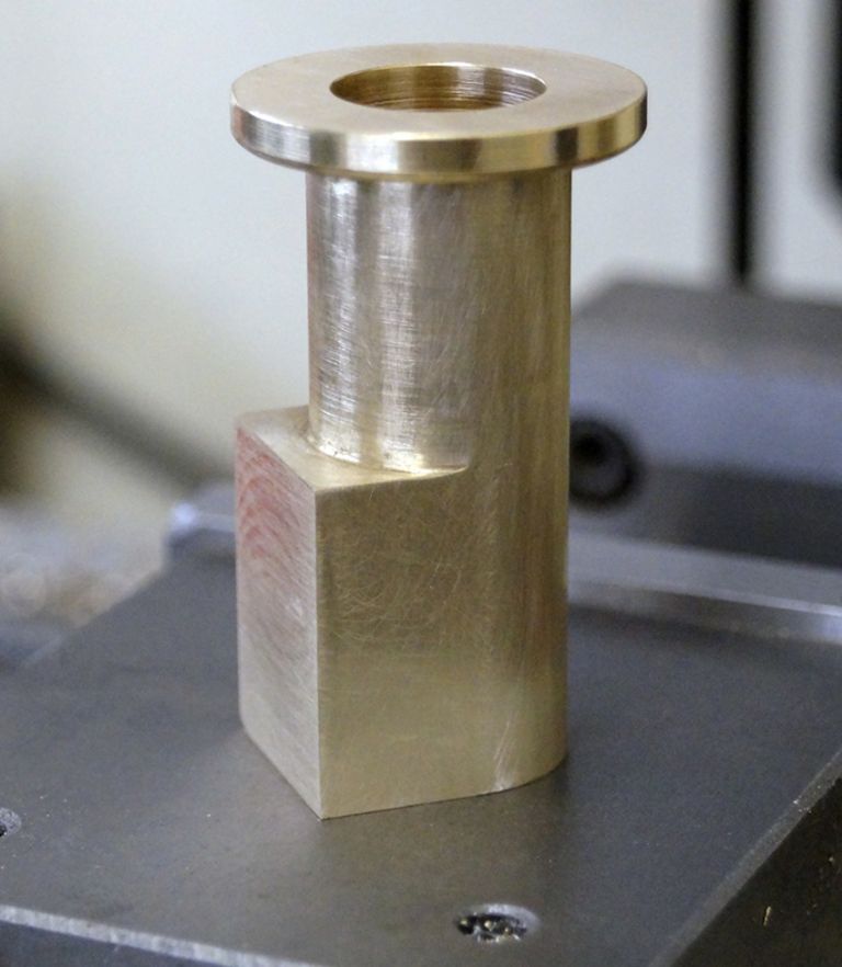

              Made a start this morning with the cylinder, its one piece having the valve block and top flange but the cylinder is open ended which I went for in ease of boring so needs an end cap which I will Loctite in.
              Quite pleased with it and certainly enjoyed making it.

                Looks good in brass Ron.
                I enjoyed making the cylinder as well and like you I left it open and turned a cap to fit
                You'll have fun making the standard as well.

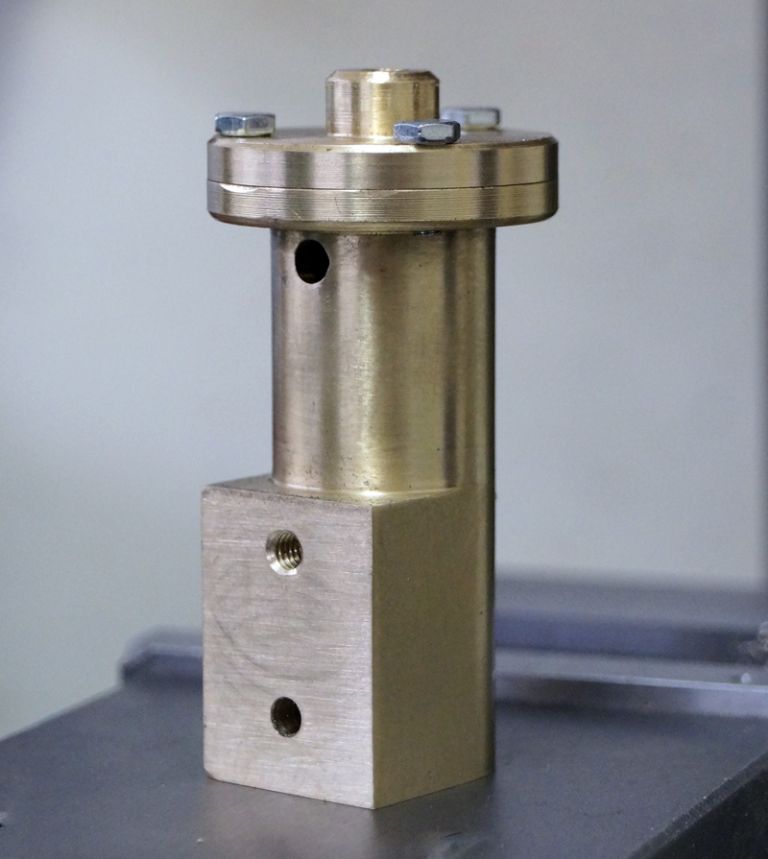

                    I got some more done today, the cylinder is not far from completion. I have the piston to lap in and an end cap to make and fit to the bottom of the cylinder, I also want to change the screws for a smaller head they are some standard M3 hex at the moment which I had on the shelf.

                              I need to buy/make some parts for when I connect the engine to the compressor. The drawing shows the in/outlet nipples as having a central hex for fitting with M6 either side and a 3.5mm through hole. I am thinking the M6 for the tube connection is there to provide some grip for a push on fit, is that the norm for the tube connection..?

                                Bearing in mind that they are metric fine I would say he intends the adaptor to take a female threaded hose.
                                However you have a few options
                                1. Tap M6 x 1 or M6 x 0.75 and make a barbed connector to have a bit of hose pushed onto it.
                                2. Tap as above and make an adaptor with the other end threaded to suit the airbrush hose fitting
                                3. Tap M6 x 1 and then buy a push fit connector for say 6mm OD PVC tube and get a similar connector to fit the 1/8" or 1/4" BSP outlet of your compressor to go on the other end. If you do this I would suggest you use a screw down regulator at the compressor end as they are simple, cheap and easy to control speed with. You can see I have several on my manifold.
                                4. None of the above and bodge something with a heated tube and gaffer tapesmile p

                                            One other thing that I have considered, unless I am missing something is there any reason why the inlet/exhaust holes cant be run straight through to the back of the column instead of through 90 degrees and out of the sides. I was thinking it would be a tidier option for the airline connector than out of the sides…just a thought.
                                            Thanks
                                            Ron
                                            #450124
                                              You could take them through to the opposite side but if using M6 threaded unions they would be too close unless you offset the threaded holes so they were further apart.
                                              Alternative would be to drill right through 3mm then open the ports to 3.5mm for half depth. You could then simply Loctite in a couple of bits of 3mm tube and just push a hose onto whichever one you wanted.

                                                Thanks Jason, I was thinking of just one M6 push in type connector and leaving the exhaust hole with no fitting..?
