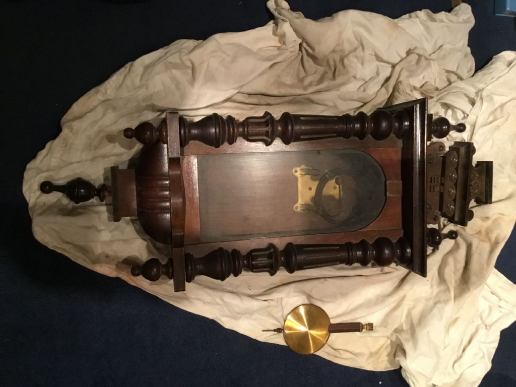

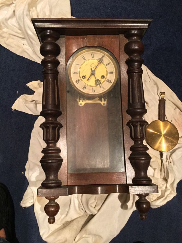

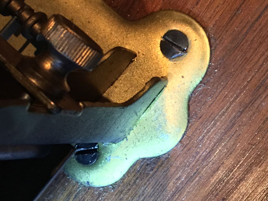

      I recently ‘re-discovered’ a clock in my loft that I had been given by my father many years ago. I know nothing about it apart from the fact that it hasn’t run for probably 30 years or so. I’d like to get it going properly again (currently it goes for a couple of minutes before coming to a halt) but having no practical experience of clock maintenance or repair, I’m going to need a lot of help.
      I have many questions but to start with :-
      Can anybody identify it from the photo? There is a pediment to the case which has been broken off, as well as a lower equivalent. I’m assuming it’s mass produced but even a rough date/age would be nice.
      How is the movement held in the case? There are 4 screws holding the backplate to the case, two of which are accessible but the other two are not. There are 2 knurled ‘thumbscrews’ (not sure that’s the right term) at the lower edge of the face which when loosened allow the movement to pivot backwards slightly. I haven’t undone them totally yet but am I right in assuming that is the way it’s done?

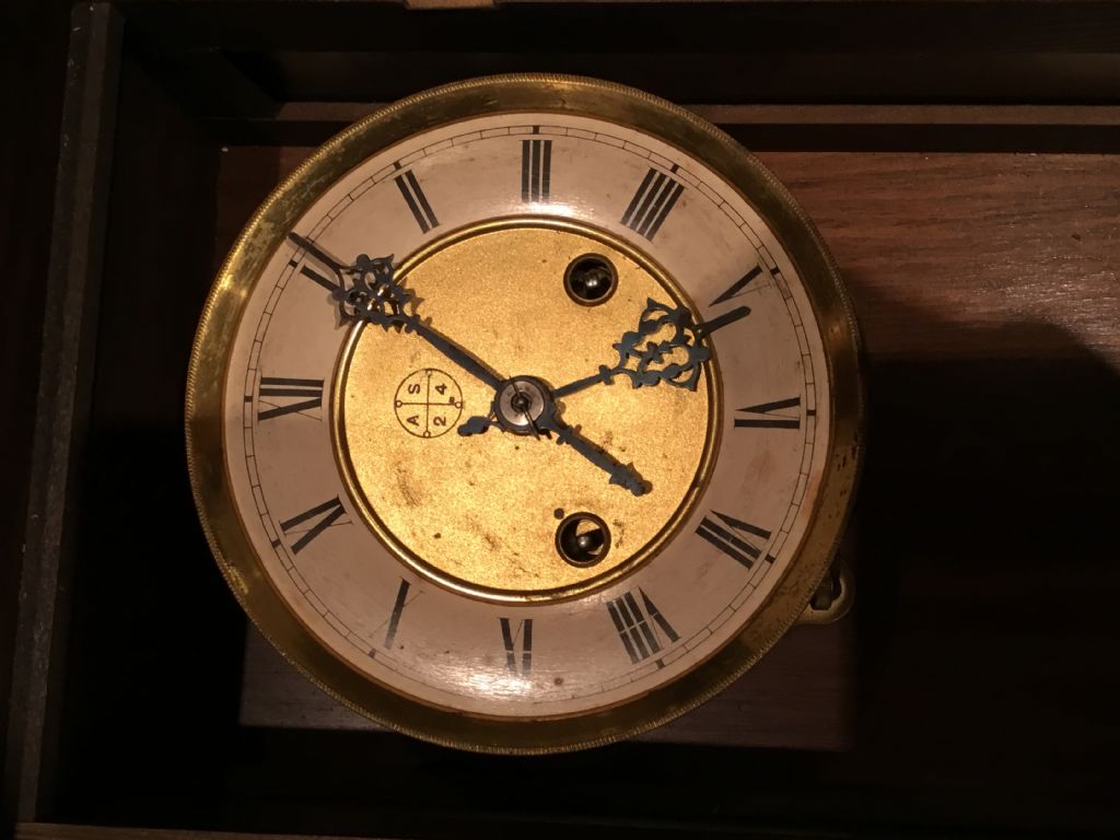

      Both the outer white ring & the inner part of the face, which seems to have a sort of ‘sparkle’ finish, are quite tarnished. How easy would it be to clean these?
      Any advice / helpful words would be much appreciated.

            The clock was made in germany mid to late 19th c .the two knurled screws will release the movement from the backplate.Their production declined after the american mass produced clocks flooded the market.They were often refered to as regulators which they are not.

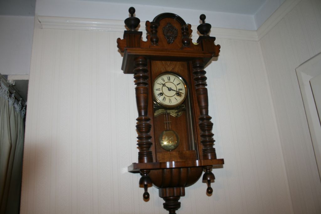

                  I have on our sitting room wall a very similar clock which was my father's. He had it from the 1920.s when it was in my Grandmother;s house.
                  It runs perfectly since it was serviced by a clockmaker in Kent about 20 years ago. As in the example in the OPs pictures the very decorative (?) pieces on the top and bottom are missing. But they modern re-makes are available, we never got them as they are very Victorian, or perhaps Black Forest in character.
                  Our old time local clockmaker in Notts showed us the German makers original catalogue which had photographs of our clock and all the similar ones available at that time. Although I would not want to let go of my clock he estimated the current value around £350 in working condition. I had only taken it to him for him to show me the correct way to synchronise the striking with the time.
                  It strikes the number of hours with a single strike at the halves. I regard it as something to remember my father by. He kept it working and I remember it was always 5 (or was it 10) minutes fast.
                  Both the strikes are loud enough to hear throughout the house, especially when I'm trying to get to sleep.

                        At first glance it ooks like a Vienna regulatoror Vienna wall clock as far as I can see. Should have 2 weights. Many of them had Eagles on the top of the case when new but most of these were removed when the war broke out for obvious reasons and were subsequently lost. However it is somewhat 'crude' as there is no seconds dial, degree plate on in back panel for the pendulum and the case looks a little plain. It's still a nice clock though.
                        Have a google for Vienna regulator for more information.

                                    Please see my note above from this morning. I am pretty sure your clock is almost identical to mine.
                                    Tomorrow I will hope to put up a picture of mine. It would seem sensible to suggest that you first determine whether your clock has the necessary components to support weights. Please see one of the clock parts suppliers such as HS Walsh or Cousins for some pictures of the various types of movements. I do not think I have seen a Vienna Regulator clock without weights On the matter of price, I think it unlikely your father would have given you his without an accompanying suggestion of its value if it is a Vienna. You might also have 3 winding holes on the dial.
                                    The clock I have is totally driven by springs, for the time and for the striker.
                                    I have done my homework on my clock to establish its provenance. That does not have the same meaning as you might hear used on 'Antiques Roadshow'.
                                    The clock came from a house in East London, in either Bethnal Green or Shoreditch. Unfortunately as the East End was heavily bombed in WWII my father was unable whilst he was alive to show me where it came from. I think it unlikely anyone whose home was in that area in the 1920s could have afforded an expensive clock, but there were many small clock & watch retailers who may have carried these in their stock.
                                    These clocks were mass produced in Germany and are known in the trade as Black Forest clocks. The movement is very simple and, although it has a compensating pendulum, it takes some patience over the changing seasons to keep it running to time. As you have already discovered the clock needs to be hung absolutely upright in the X, Y and Z planes. Our house has flat walls against which it is happy to live, but eventually I marked the wall to ensure the side-to-side level. As you have seen on yours the movement is adjustable in the fore&aft direction
                                    The pendulum on your clock, whilst unlike mine in appearance has the same adjusting screw ( very sensitive) and an identical 3-hook hanger. I found it impossible to engage the hook other than in its correct position.
                                    I hope this will help you to decide what sort of clock you own.

                                          If I can add a thought … ? I would leave any attempt at cleaning the dial itself until you have been able to get advice from an expert who has seen your clock. Otherwise you risk destroying a finish which is difficult to repair or renew. Old clocks, like old bronze sculpture, become coated in a patina, (which may look to novice eyes like corrosion) and sooner or later someone will ask why you haven't got it all nice and shiny. Resist the temptation.
                                          In any event there may be plenty to do with the working parts, and no point in going further until it runs well.

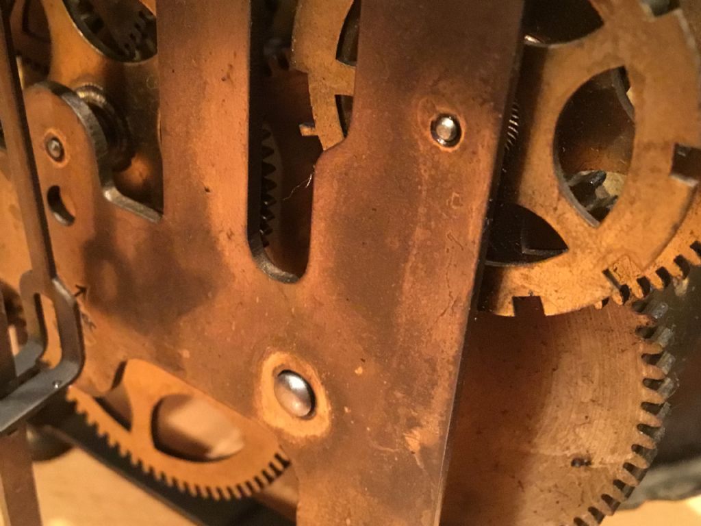

                                              I took the movement out of the case and sat it on a stool while I closed the case. Lo & behold, it started ticking away all by itself. Admittedly it was going too fast but I suppose that's only to be expected when there's no pendulum attached!
                                              Looking at the back of the movement, there appears to my inexperienced eye to be no significant gunk in the pivots, so my thought process now is that a little oiling may be all that is required. (The brighter metal finish around the pivots is not my work).
                                              I've also laid out the broken-off case parts to remind me what it should look like.
                                              Tim – I appreciate your comment about cleaning the dial. Is the earlier suggestion of cotton buds & saliva too risky in your opinion?
                                              On a similar note, there is a bit of a ding in the rear edge of the face bezel, which isn't visible when the movement is in the case. I think I'll let that be & not try to straighten it.

                                                No, cotton buds and good ole fashioned spit should do no harm, but keep the cotton away from the inner workings. Fluff is not going to improve things.
                                                The shiny bits around the pivots are where the oil has spread and kept the surface free of corrosion. A good sign, as it proves there was some oil in there. What there is now is likely to be a mix of old oil, oxidized oil (gum, varnish) and dust. The case will have kept much of the dust away (much better than long-case clocks), but the gritty dust is still there, waiting to have oil added to turn it into fine grinding paste. That is why it is recommended, at this stage, to separate the parts and clean away all residues. You could do worse than getting a pack of cocktail cherry picks, if the complication of getting the proper horological cleaning kit is a step too far. it shouldn't be – the clock won't need attention for 20 years if you do the job right. And if you want to do it the 'best' way, try 'pegwood' on the web. Remember that all you are hoping to do is to clean off the gunge. A search on 'clock oiler' should bring up a source for the step after assembly.

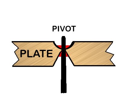

                                                      Brian, firstly apologies the awful diagram below but I musn't disregard copyright by reproducing one from a book.
                                                      Furthermore, this will probably incite others' condemnation but with respect to "I dismantle the movement prior to cleaning? " and "I might create more problems than I'm solving. On the other hand, if I don't, it looks like I could be doing damage in the long term if I run it uncleaned". It's perhaps worthwhile offering how pivots are supposed to be installed in a good clock. There should be a concave cut in the outer face where the pivot end emerges. This is to retain clock oil. A broach should then have been used from the other side to produce an tapered hole. The result is that the (hardened) pivot is supported only by a thin plane of the the brass plate..Accordingly there ought to be no "long parallel hole" through which the pivot turns and thus brushing some solvent onto both sides of the plate should (might?) remove any old oxidised oil – shown in red below. Clock mechanisms are pretty robust and "…doing damage in the long term if I run it uncleaned" is very unlikely especially one encased. I would suggest you try the easy way first. As before. you've nothing to lose but half an hour's work.
                                                      If you've not completely dismantled and reassembled a clock before, the lengthy process is quite a challenge though rewarding if the clock could not otherwise be made to run.
