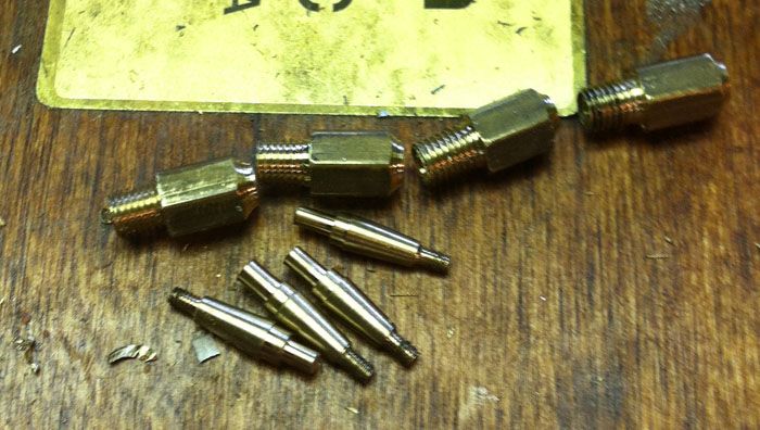

    HobbyNut
      @hobbynut
      #31017
      HobbyNut
        @hobbynut
        I intend to add pics of my progress.

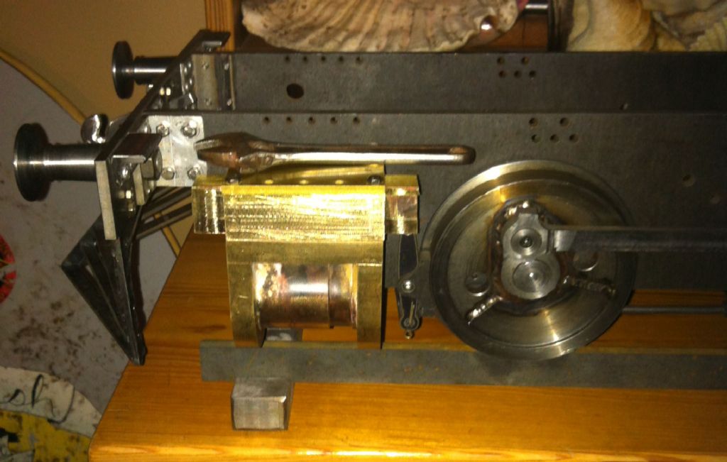

        HobbyNut
          @hobbynut

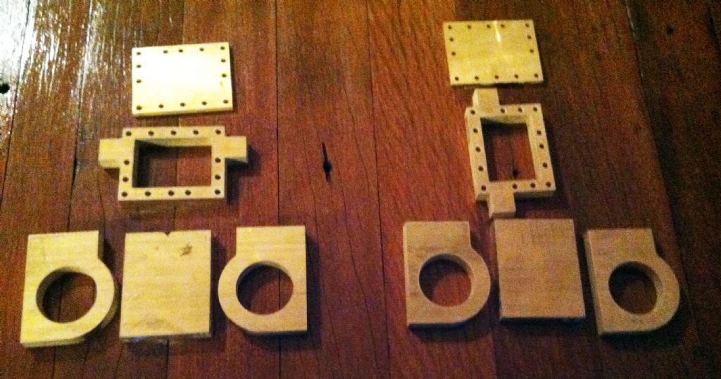

          #114315
          HobbyNut
            @hobbynut
            I am going to machine the guides onto the valve chest.
            I messed up with the cylider barrels, and I now have 1 3/16" bore and not 1 1/4". i doubt it will make much difference to me.

            Ian S C
              @iansc
              When you said you'd messed up, I thought perhaps you'd gone over, now that might have been a problem, but under all OK, done that myself. Nice work so far. Ian S C
              #114421
              HobbyNut
                @hobbynut
                Thank You. I made the OD of the barrel too small. the wall would have been less than 1/16" at 1.25 bore.

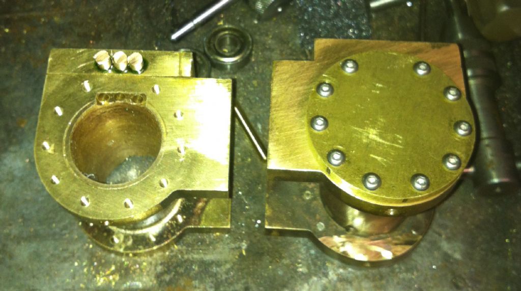

                HobbyNut
                  @hobbynut
                  The cylinders are coming along.

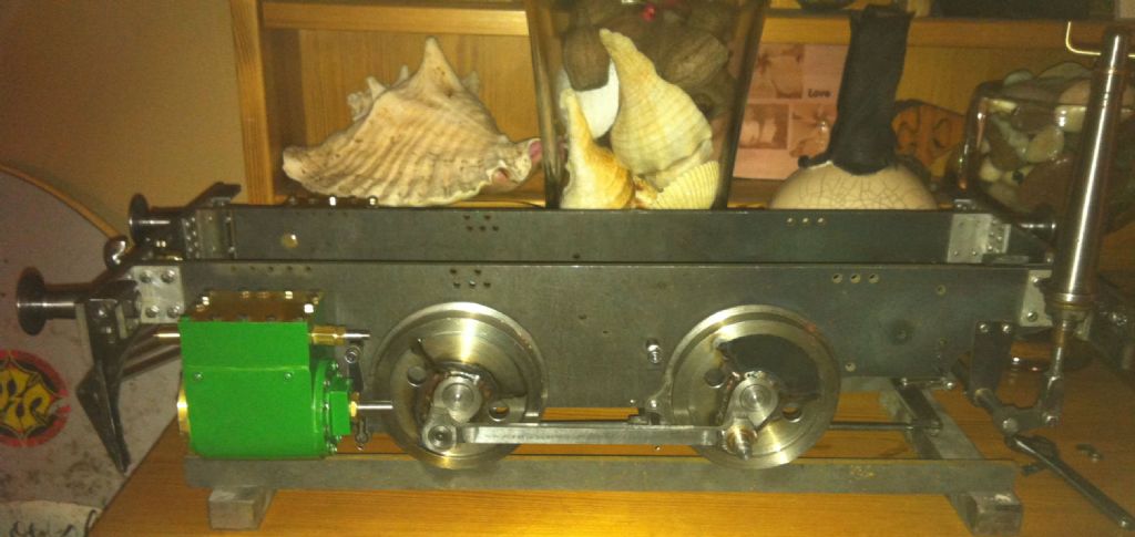

                  HobbyNut
                    @hobbynut
                    Last night I made up all the rod guides and fitted them. I thought that I may paint it green, so I tried out a bit. I don't like it much, it is too light, needs a darker shade I think.

                    john kennedy 1
                      @johnkennedy1
                      You're really pulling trees up now.Looks like you're level with the series.
                      I'm chewing the cylinders out of some cast iron weights,given to me by a farmer.
                      Does anybody know if the insulation recesses are necessary,or will they be ok left solid.Most people will use insulation but I wonder if that is because the recesses are already cast in,so they do it ?
                      I understand that the cols cylinders will take longer to warm up,but is that a big problem???
                      Hope someone can advise please. John

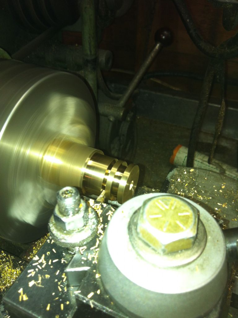

                        HobbyNut
                          @hobbynut
                          I did make 2 pistons last night. I was only able to fit the rod to 1, and fit it to the cylinder. lots of lapping etc. More than I imagined.

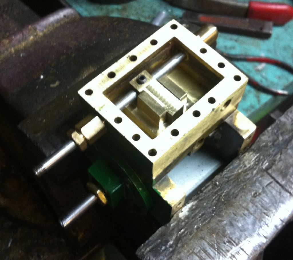

                          HobbyNut
                            @hobbynut

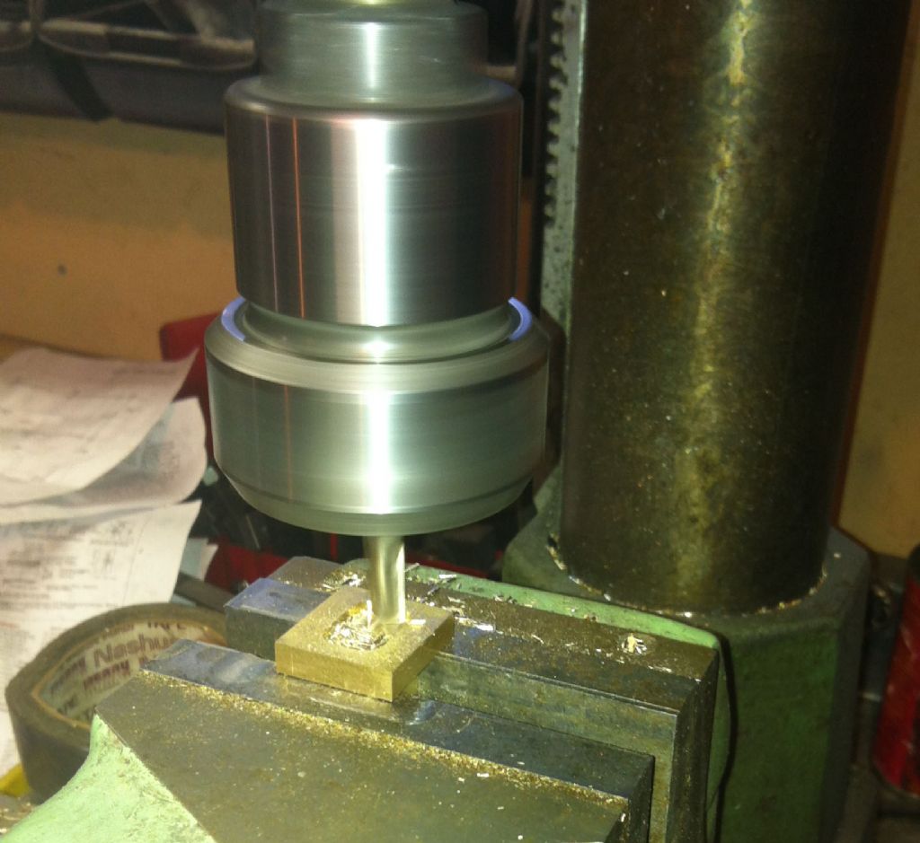

                            Made the slide valves and fitted them. The pistons and seals are also fitted.

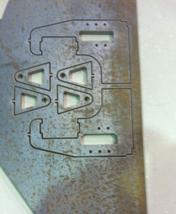

                                HobbyNut
                                  @hobbynut
                                  I am still working away. I used the 65000psi drill and file to make the motion pieces from the last installment.
                                  #125200
                                  James Sutton
                                    @jamessutton25895
                                    Wish I had access to a water jet cutter like that. Would certainly speed up the plate work. I found a local machine shop with one but haven't made any contacts there to see if I can get some small run items done.
                                    #126389
                                    HobbyNut
                                      @hobbynut
                                      James, it is easier on them if you can give them a digital file of the pieces that you want. either a .dwg or .dxf.
