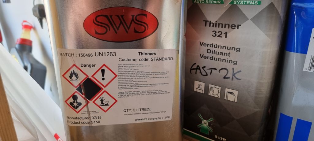

                  I always use gun wash, which is a cheap cellulose thinner. Around a fiver for a gallon. Used for cleaning spray guns.
                  Steve.
                  #537006
                  bernard towers
                    @bernardtowers37738
                    Let me know where you get it for a fiver a gallon

                              Steviegtr
                                @steviegtr
                                Posted by bernard towers on 29/03/2021 23:45:41:
                                Steve Monie paint supplies. Whitehall road . Leeds.
                                Can on the left.
                                Steve.
