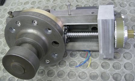

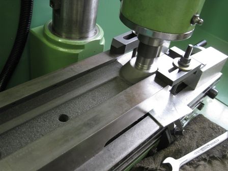

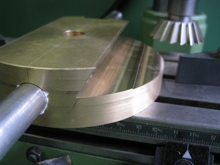

      Most of the mechanical work, wiring and software for the Shaper, now reborn as an NC shaper, is done. Z axis stepper wiring still to complete, and then software tests start. All the software functions have been tested 'on the bench' and the next step is to get the actual axes moving ( auto-feed) so that stepper accelerations with the associated inertial mass of the axis table and slide can be calibrated.
      The broken vertical axis dovetail has been replaced, new dovetails cut, and thank goodness that worked out very well indeed. The vertical slide itself was undamaged, but I opened up the dovetail from 55deg to 60deg, as that was the cutter I could obtain..The mating dovetail was then made from a disc of PhBronze and a 16mm ballscrew fitted in place of the old, very damaged and worn acme leadscrew..
      Hope to make chips in a week or so!
      Most of the work leading to this stage has been covered in a number of my posts, so here goes maybe one last one..
      Opening the 'tails to 60degrees.

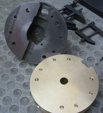

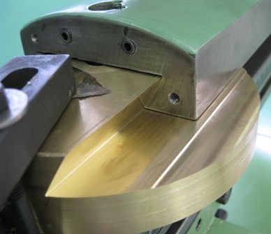

      Machining the Male Dovetails in the bronze add-on. The cutter is 65mm OD..

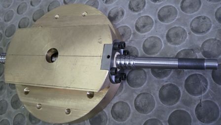

      test fit of the two halves
      Drilling and tapping the fixings for the ball nut

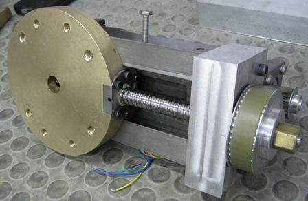

      Ball nut and screww fitted

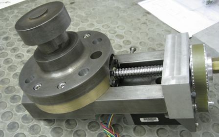

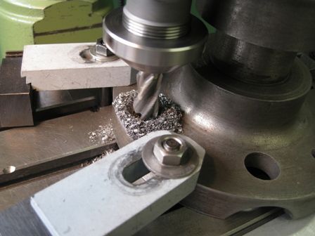

      Holes to bolt two parts together all drilled – counterboring for Capscrew heads next:
      Locating pin in Mill T slot base to locate holes for counter boring:

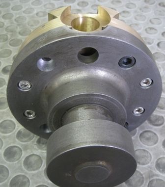

      Test bolting:

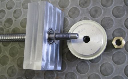

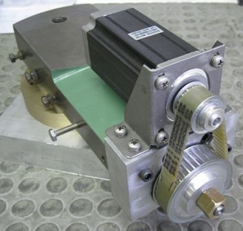

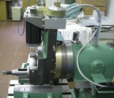

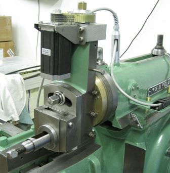

      Thrust Bearing block for Leadscrew Bearings and Drive pulleys.
      Start of assembly of complete vertical slide:
