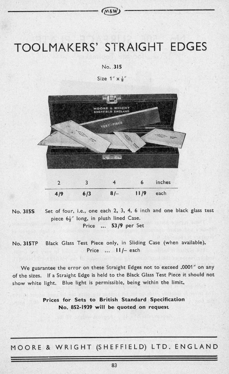

                    Nicholas Farr
                      @nicholasfarr14254
                      Hi, this says it all.
                      Regards Nick.
                      P.S. I have the 6" one, which cost 11/9 = 58.75p in todays money.

                      Clive Brown 1
                        @clivebrown1
                        Thanks for all the comments. Another minor mystery solved. My piece of glass isn't marked "test-piece" as the catalogue illustration seems to suggest.
                        Clive

                        Clive Foster
                          @clivefoster55965
                          Clive
                          Its the case that is marked test piece not the glass itself. Pretty sure my personal set just has the naked glass but at least one of the guys at work had the glass in a separate case which, I think, was so marked.
                          Hafta say that I use mine so little that I haven't actually seen them for around 3 or 4 years! Box got moved around during a tidy up.
                          Clive

                            Posted by Plasma on 22/04/2019 19:33:08:
                            I suggest the same as when using the straight edge to check a machined surface, but the glass is as near perfect as possible I.e. stable at variable temperatures etc. Black glass so its opaque when holding it up to the light. ?
                            That makes sense yes
                            … and Nick's image confirms it.
