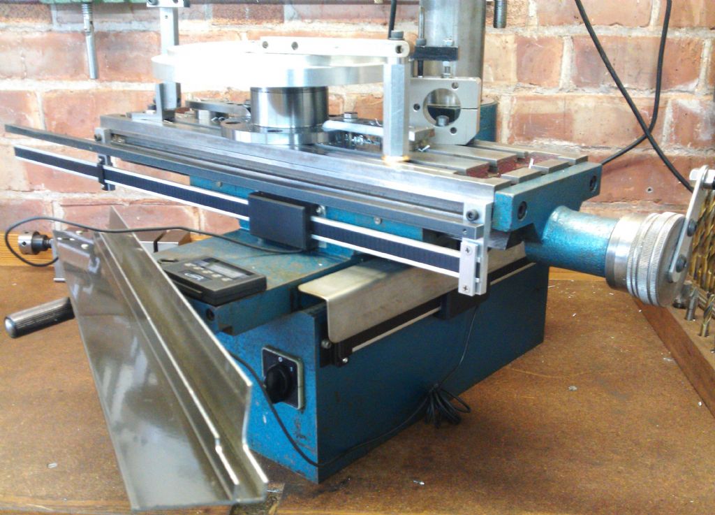

      I recently fitted economy DRO scales (igaging) to my Emco milling machine. These work on the same system as the cheap Chinese calipers but have the digital display at the end of a 1m cable.
      I have only done the X and Y axis (mounting both took about 2 hours) and I then mounted the displays on the head of the machine. facing the front.
      Whilst the DRO works as expected, when I used them in ernest on the first job I found the machining less instinctive and slightly more 'stressfull' than normal. When I analysed the problem I realised that when turning a handwheel to approach a particular reading my gaze was at the display and I had no sight of the job, or probably more especially, my hand on the handwheel.
      I think visual feedback from the graduated collars and being able to see my own hand movement combine to made the non electronic process ergonomic. With the DRO display well away from the table the procedure feels far from natural.
      My solution was simply to position the individual diplays adjacent to the X and Y handwheels. Now when working I can see the job, the digital display and what my hands are doing.

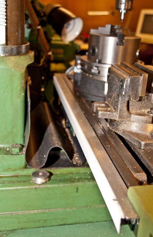

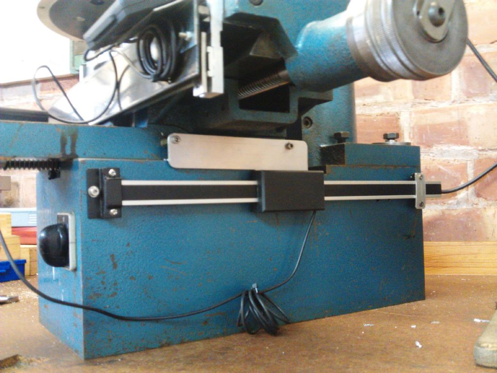

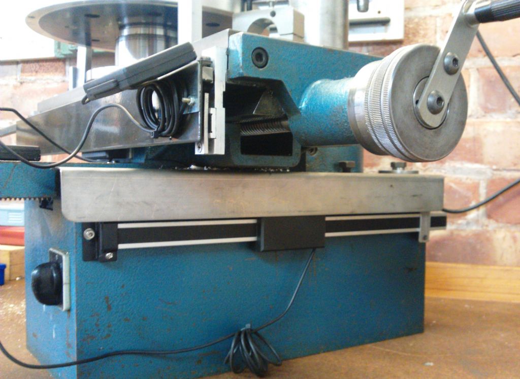

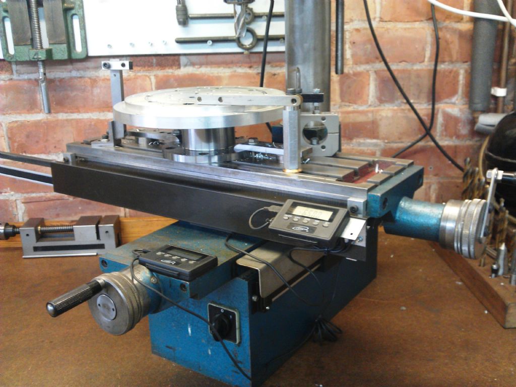

                        The front of the table has a T slot that carried the travel stops (that I never used) so I used it to mount two aluminium blocks to carry the igaging beam and the 10mm square steel bar (B&Q Plasticene). I had a length of 'F' section aluminium extrusion left over from a polycarbonate roof carport which I modified slightly so that the fins of the 'F' gripped the steel bar. I fixed a steel angle plate at the RH end for the igaging display magnet.
                        The Y axis umbrella is just a length of angle clamped at the back of the machine.
                        The pictures show the scales with and without the covers
                        Ian P
                        X Axis uncoveredX Axis with cover fittedY Axis scale, uncoveredY Axis scale, cover fitted

                          Interesting arrangement, Ian (and nice pics!). I used the table slot in similar fashion for my (Chinese) scale but was able to attach them directly to the slot (not suspended below them). I made a simlar cover to the one you show on your Y-axis to fit over my X-axis scale and mounted it to the same slot.
                          Like you, it meant dispensing with the travel stops. Then I bought a power feed that had a box containing limit switches to be mounted in that same slot and using the travel stops to operate it. Since the X-axis scale was taking up the room, I'm using the power feed without limit swiches (gulp!).
                          I've recently bought a set of glass scales so I have to go through the mounting exercise again. Perhaps I could use a similar method to yours (and possibly get back the use of the slot for the PF limit switches……although I don't think I have as much height over the base as you do.

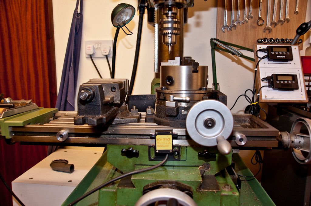

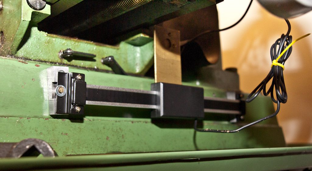

                            I decided to mount the "X" axis scale on the back of the table.
                            X Axis on back of table
                            I don't like drilling holes in my machines but in this case it seemed the best option. You will see that I clamped a piece of "L" section Al behind it for protection then was able to squeeze a piece of "L" section plastic to complete some protection on 3 sides
                            The sides of the mill base slope so I made a couple of Al blocks to provide perpendicular mounts and again drilled and tapped the base for these. The "Y" scale is fixed to these by its end caps. I arranged for the moveable sensor to be driven via a (sturdy!) arrangement of levers from the rear of the table – fixed via a bolt where the cross feed screw screening curtain attaches.
                            Y Axis under table

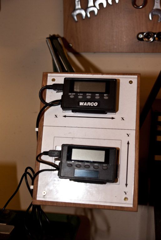

                            The readouts I fixed to a bit of ply covered with paper then with perspex. Two strips of steel were arranged for the magnetic mounts to grab onto. This assembly is mounted on the arm of an old "Anglepoise" lamp so can be moved around to a good position.
                            Mounting for readouts
                            New PF stops
                            This final image gives the "Operators eye" view. Note the new table stops made, mostly, to avoid any disasters with the power feed!
                            I guess it's not as good as glass scales but I find it works pretty well and I'm able to justify the costs ( to myself anyway!)
