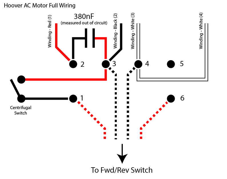

            Posted by Xed on 02/04/2022 11:58:53:

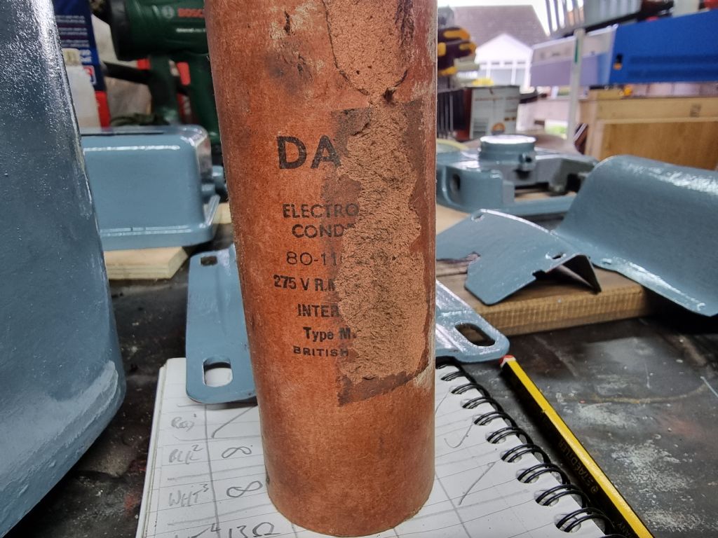

            … first up puzzling out the motor:
            Full Motor Wiring
            The measured value of the capacitor (380 nanofarads) is probably wrong, so either a mistook or the capacitor is faulty.
            The circuit looks like a Capacitor-Start, Induction Run motor, and I'd expect the capacitor to be much larger, perhaps 150-ish microfarads.
            Did the motor start OK before being stripped down? If so, likely 380nF is an irrelevant mistake. However, if 380nF was measured correctly and the motor didn't start, then time to find a replacement. Hopefully the capacitor is labelled with the correct value – it varies depending on the design of a particular motor.
            Buying a replacement capacitor shouldn't be a problem once the value is known. Common spare, because they're the least reliable part of a single-phase motors.
            The motor's internals look very mucky. Although appearances are deceptive and it might be fine, I recommend an insulation test – damp dirt murders windings! Apart from paying for it, replacing the motor shouldn't be difficult, but if it's necessary installing a 3-phase motor with VFD is a worthwhile improvement: less vibration, more torque, and speed-control.
            Would a motor expert comment please?

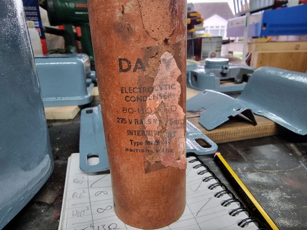

                    I did some more poking around and the capacitor which I initially thought was unmarked turned out to have a label. I also decided to stick a coat of paint on as it was already disassembled so might as well.
                    Murphy Strikes
                    Naturally, it was glued to the motor label side down. It had also stubbornly bonded to it's little foam bumper.
                    By the power of Photoshop
                    A lot of patience with a scalpel and a bit of photoshop lead to this – would I be right in thinking that's a rating of 80-110uF?
                    I also spent some time with the multimeter checking the cables – the centrifugal switch opens and closes as it should when pressed. The only resistance readings I could get were the following:
                    Red(1) to White(4) – 13Ω
                    Black(2) to White(3) – 4Ω
                    No other combination seemed to be connected.

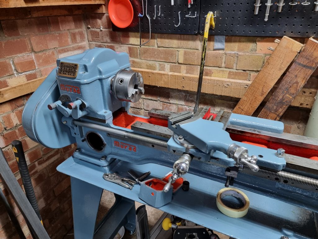

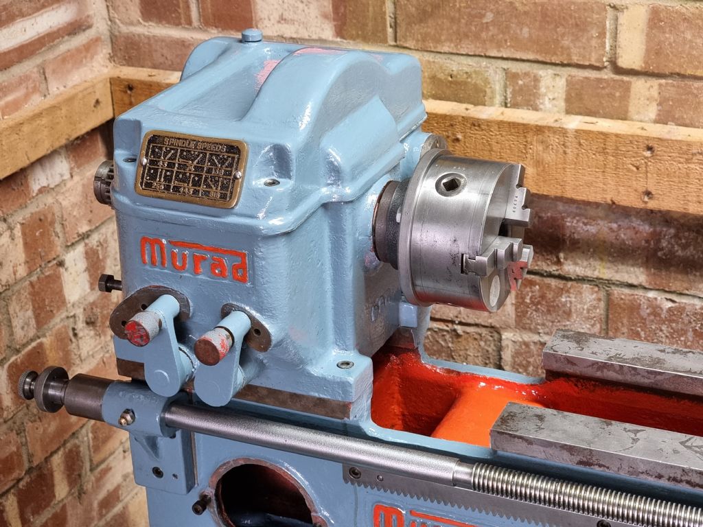

                              Just a brief update – the headstock is painted and back on the lathe (the selector arms I'll revisit when I get the other parts done). I drained the old oil and refilled with some ISO32 to pretty much the same level.
                              Headstock Reattatched
                              Lovely and shiny. A little work on the information plate with some brasso followed by some black paint and clearcoat really brought it up.
                              That's the biggest and heaviest bits largely done now, currently on the bench I have the covers, guards and the saddle, cross-slide and compound for painting which should be done in the next few days. At which point it'll start looking more and more like a lathe again!

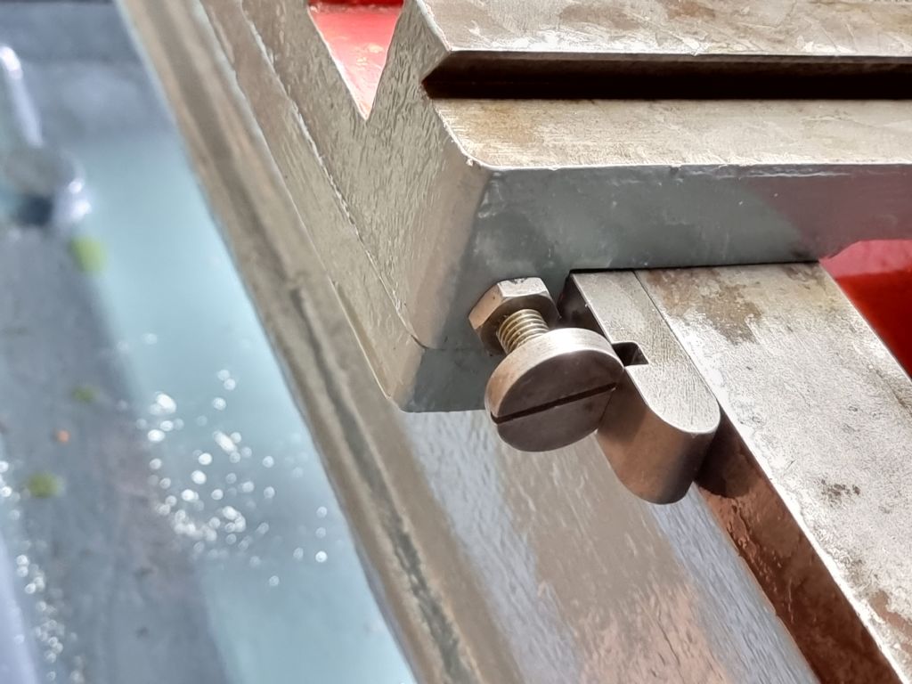

                                Adjustment to the saddle is made by a tapered block that sits on the far side of the saddle to remove any play. Coming from the minilathe, and it's system of jack screws this is a revelation.

                                Painted parts assembled and it's starting to really look like a lathe again. Different chucks will be an option for the future, but I'll have to make the plates for them – as near as I can tell the spindle nose thread is 1 7/8" *TPI Whitworth, so doubtful there's anything off the shelf if I'm feeling lazy.

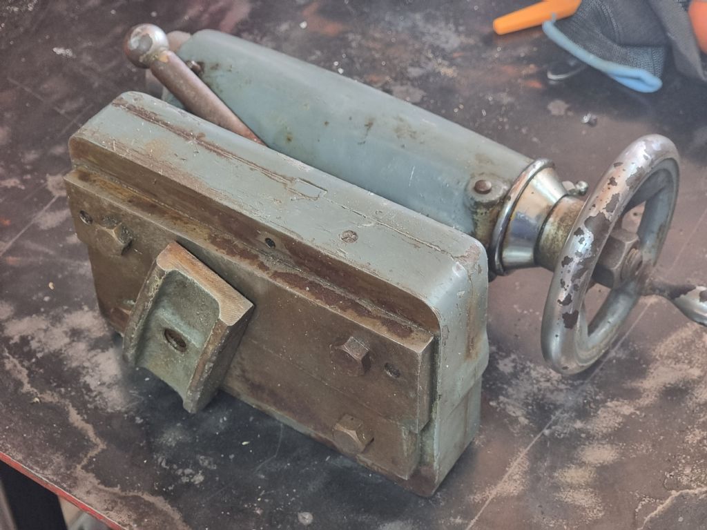

                                  I've also been tackling the tailstock disassembly today:
                                  Tailstock

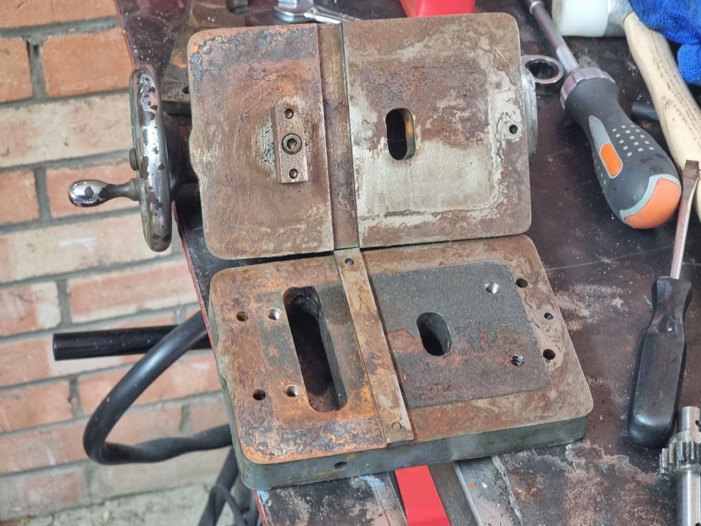

                                  Thought I could get away with a good rub down and paint. Sadly not!
                                  Tailstock Underside
                                  There are two tapered blocks on the bottom of the tailstock that fit it snugly to the ways, a fixed block and an adjustable.
                                  Tailstock oh dear
                                  Cracking the bottom plate off and yeah… the rust has got in.
                                  Tailstock Soup

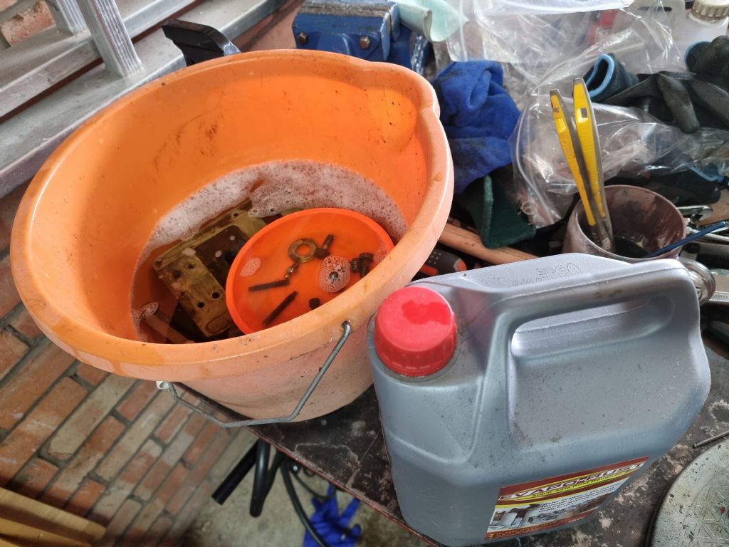

                                  A full disassembly later and all the parts are gently marinating in a soup of Evaporust for 24 hours. It can damage paintwork but as I'm repainting anyway I might as well.
                                  And that's pretty much where I'm up to!

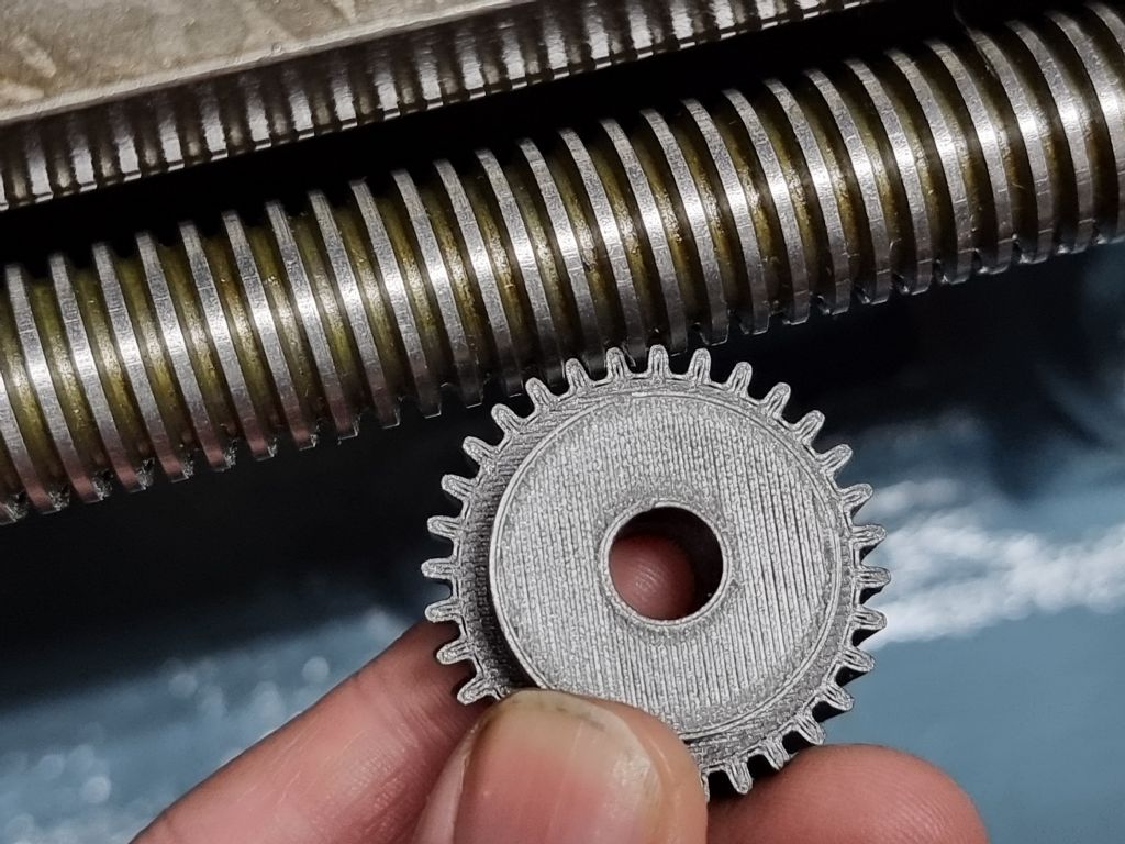

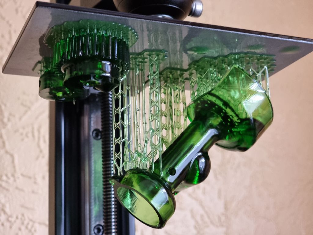

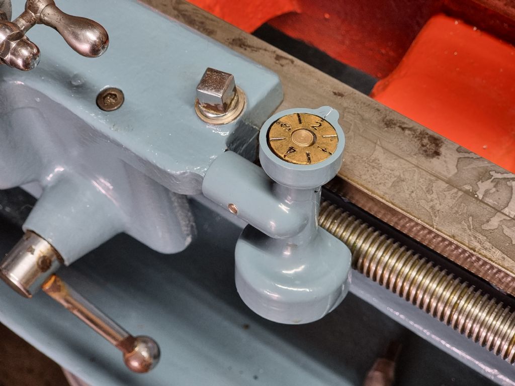

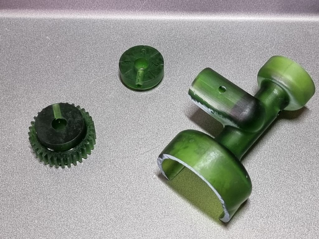

                                    As my lathe didn't come with a threading dial, I thought that would make an interesting side project – luckily it turns out someone has modelled a functioning 3D printed version for a South Bend that turns out to be compatible!
                                    South Bend 9C Threading Dial
                                    Dial Test
                                    I printed out the gear just to make sure it would mesh with the leadscrew properly and checked the measurements to the mounting hole on the saddle.
                                    Dial 1
                                    Decided to go with a resin print to get a nice finish on the body, in hindsight this might have been an error as I think it warped slightly in curing. If I was doing another I'd probably stick with a filament based process, or at least only resin print the body.
                                    Dial 2
                                    Supports removed and print cured, ready to be primed and painted.
                                    Dial 3
                                    And everything installed around an 8mm brass rod to mount the dial and gear through the body! Everything meshes and moves as it should. I went with my initial FDM printed gear in the end as it seemed to mesh a bit better. Whether it lasts the long haul is anyone's guess but it'll definitely do for now.

                                      And this is where things stand today – the mechanical side of things is largely there. There are a few nice-to-haves that I can work on slowly like replacing the slide handles that are flaking sharp pieces of chrome into your fingers and getting the slides adjusted.

                                        Nice job. A useful solid looking lathe yes
                                        Rod
                                        #594119
                                        Dave Wootton
                                          @davewootton
                                          Excellent job, a really worthwhile project with a very useful end result. Thanks for posting I've followed this with great interest, as a result I gave evaporust a try and am most impressed with it, always something new to learn.
                                          #594124
                                          Hopper
                                            @hopper
                                            Useful looking indeed. With those looong carriage extensions behind the saddle, and the tapered gibs, if the bed is in good nick it should be dead steady in use.
                                            Nice work with the thread chaser dial too. Very innovative. A whole new way of restoration.

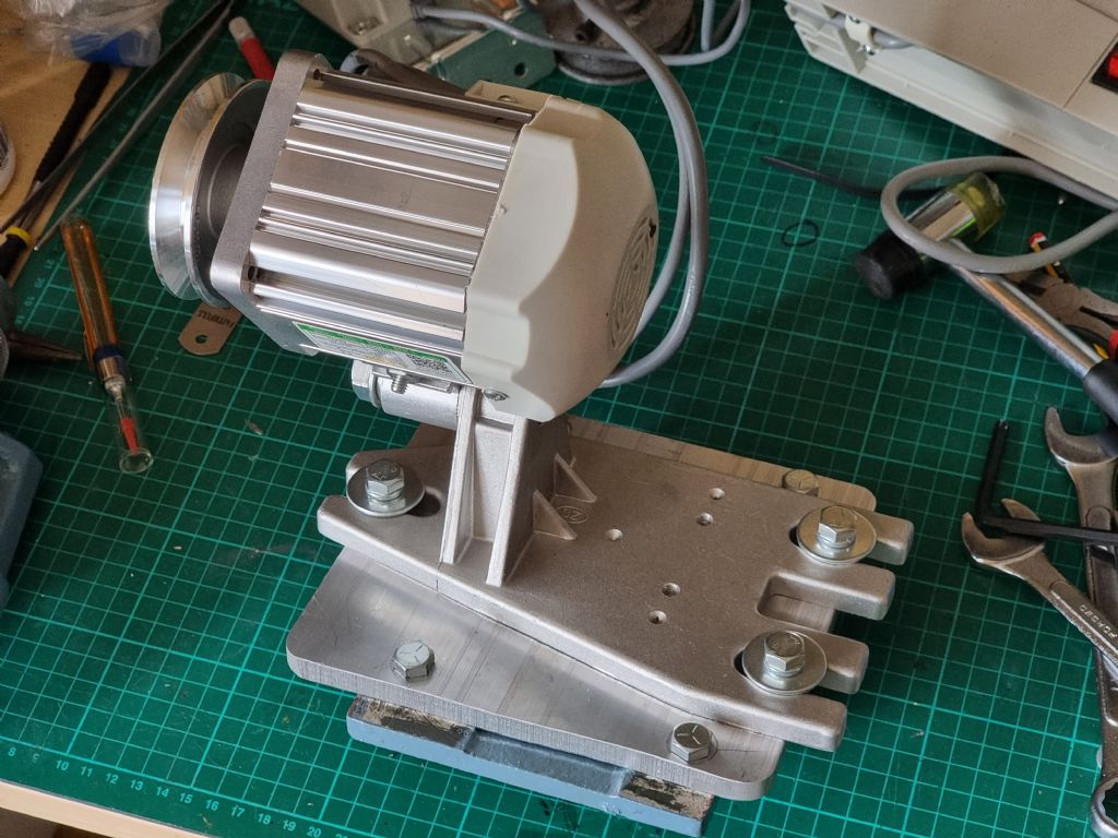

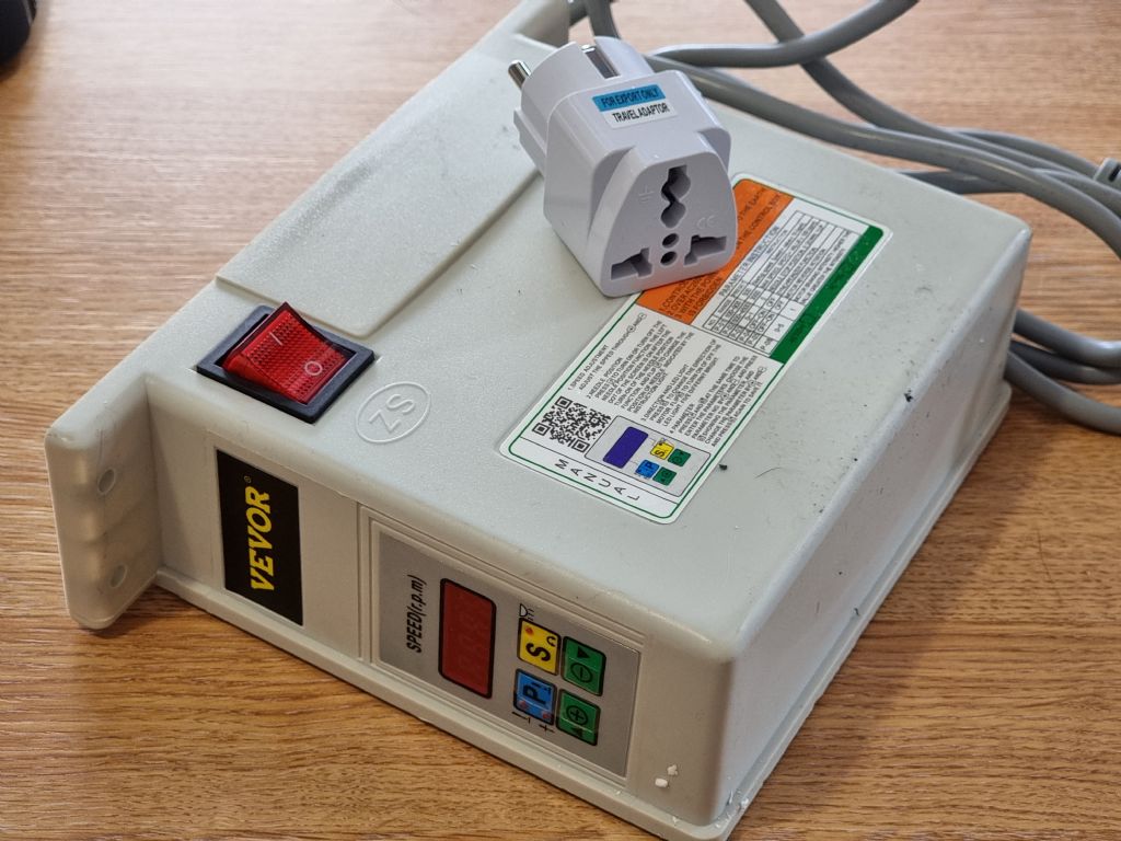

                                              With the mechanicals mostly done, it was on to the electrics and there was a Decision:
                                              Motor Unit

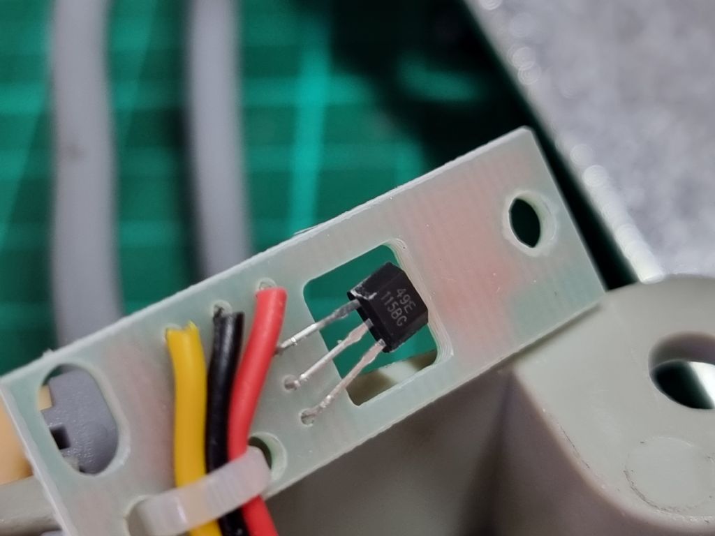

                                              The bang for buck on the brushless sewing machine motor kits just seemed to good to pass up, so I've shelved the old Hoover motor for a rainy day. The deathdapter was naturally binned immediately.
                                              Hall Effect Sensor
                                              The pedal lever the kit comes with operates by a hall effect sensor that looks to be powered by 5V from the control box. I think the eventual plan will be to replace the pedal lever with a little board the wires up to the original switch – even if it can't reverse the motor by itself it would be fun to have the controls back on there.
                                              Hall Effect Part Number
                                              And the part number for the sensor itself.

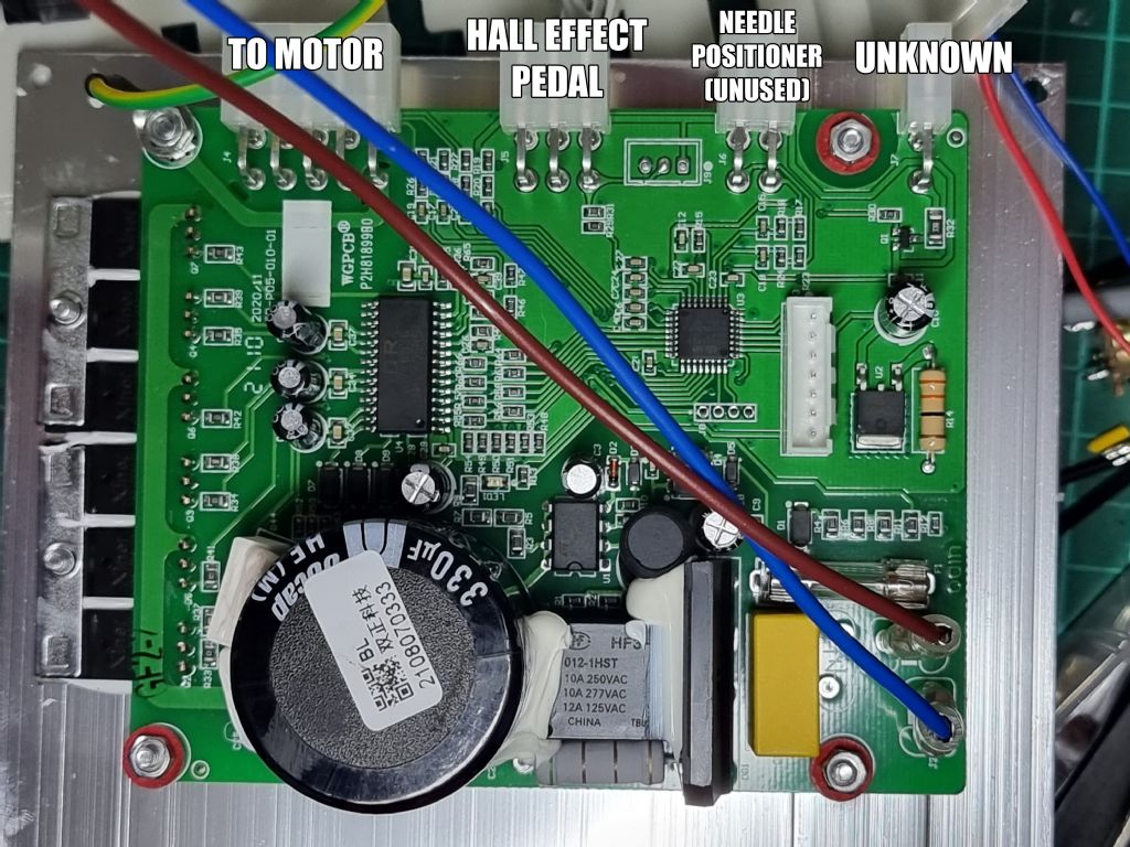

                                              Control Board
                                              While I was at it, I had a look in the control unit and documented the board.

                                                Aluminium Plate

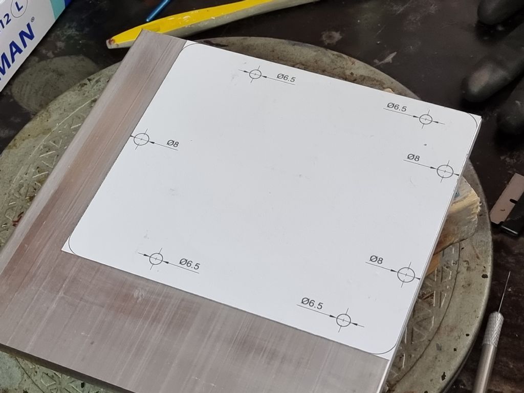

                                                Of course now I needed to physically mount the motor, so ordered in a big chunk of 10mm thick aluminium to make an adapter plate. After double checking with the original mount, I found I'd screwed up by assuming the mounting holes would be in a uniform position – definitely not! I ended up transfer punching through the old plate and drilling everything out to 8mm to get a little extra clearance.
                                                Motor on Mount
                                                And there it is, a 1HP brushless DC sewing machine motor that is surprisingly grunty.
                                                Mounted Motor!
                                                Mounted in position – I was very surprised that the 50mm pulley it came with fit the original belt pretty well. I do have to keep the guard off with where the positioning of the motor has landed, but I'm thinking of going for a linked belt and adjusting to fit the guard that way. The other thing on the list is making a busing for the original 45mm(ish) pulley from the Hoover motor to make sure it's properly matched to the headstock pulley.

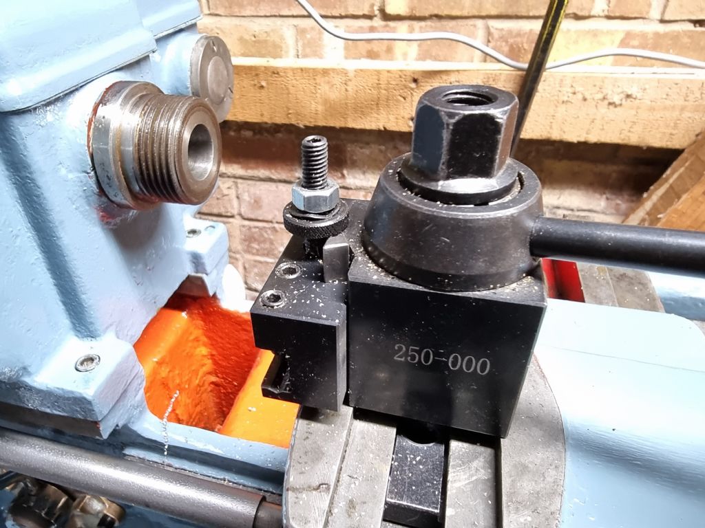

                                                Toolpost
                                                Now we come to the most annoying part – I bought a nice 250-100 toolpost from Warco to go on the Murad and… it didn't fit. The tools would bottom out before reaching the centreline, so I raided the minilathe for its smaller 250-000 cousin and that's working like a champ.
                                                As a little bonus, I did tweet a little video tour before I got the toolpost on:
                                                **LINK**
                                                It's already done it's first actual task as well – I turned down the end of the halfnut lever and threaded it M8, then matched that in the boss attached to the shaft. I swear that thing has fallen out for the last time.

                                                  I made a new plate to mount the toolpost to, as the original solution was sitting lower than the lip of the slot causing the toolpost to foul the cast iron.

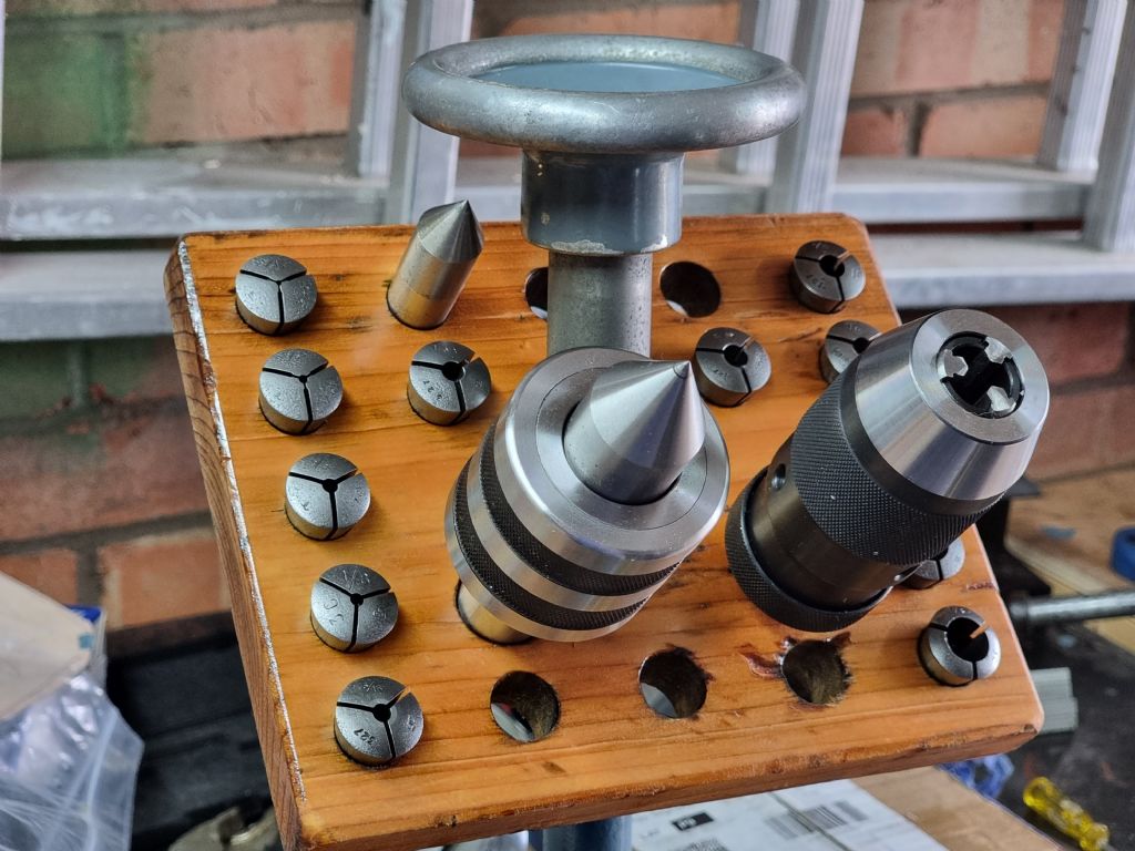

                                                  I also sanded, varnished and painted the tool rack that came with the lathe, and gave the set of collets that came with it a good derusting. Now I just need to work out where to put it.

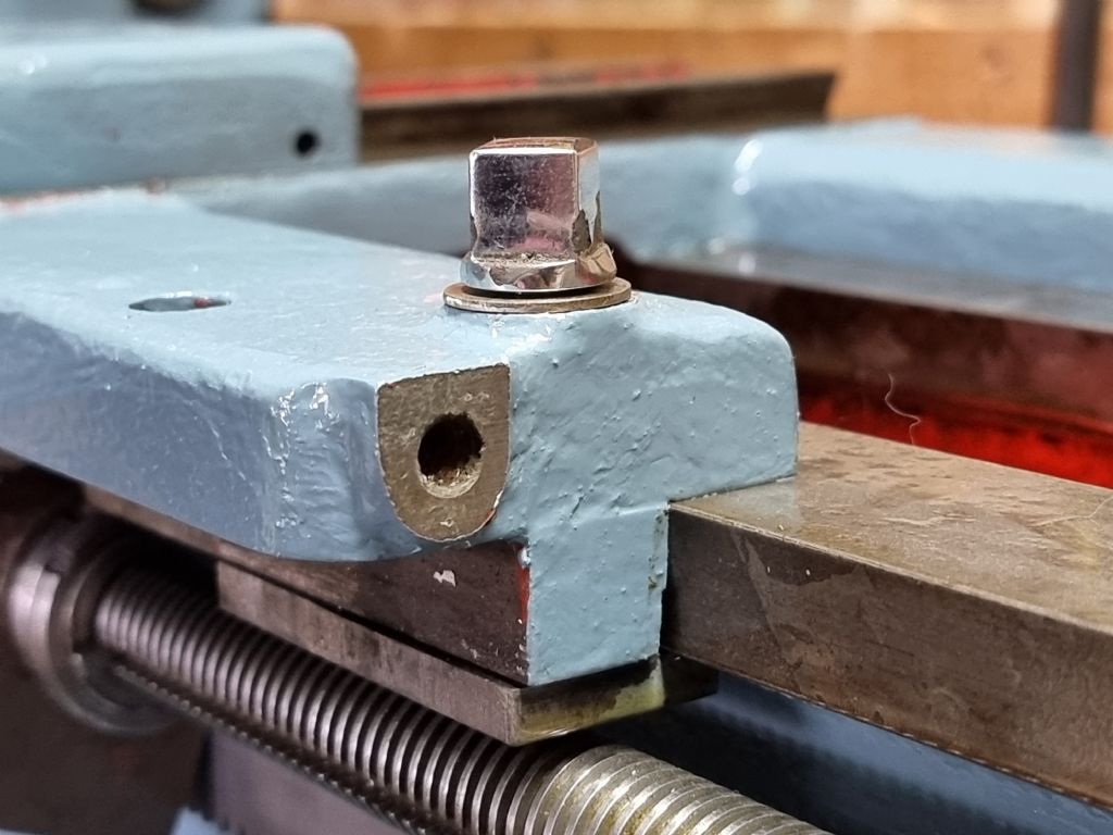

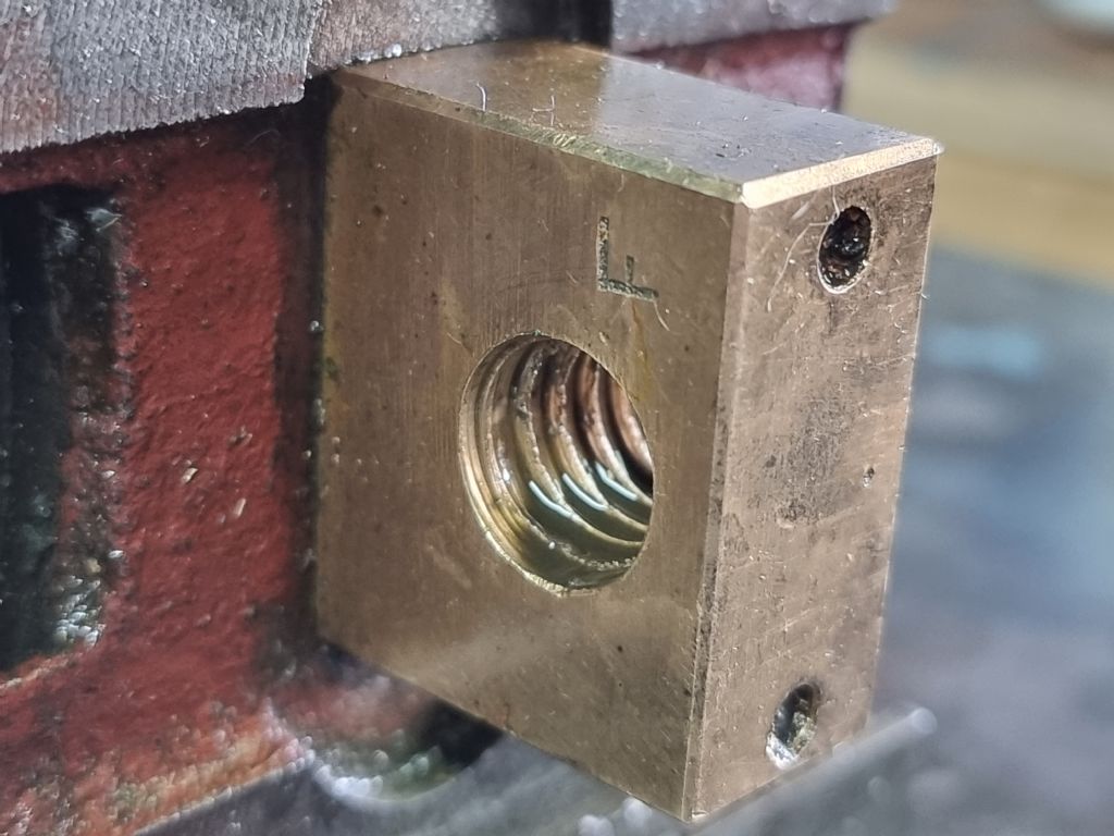

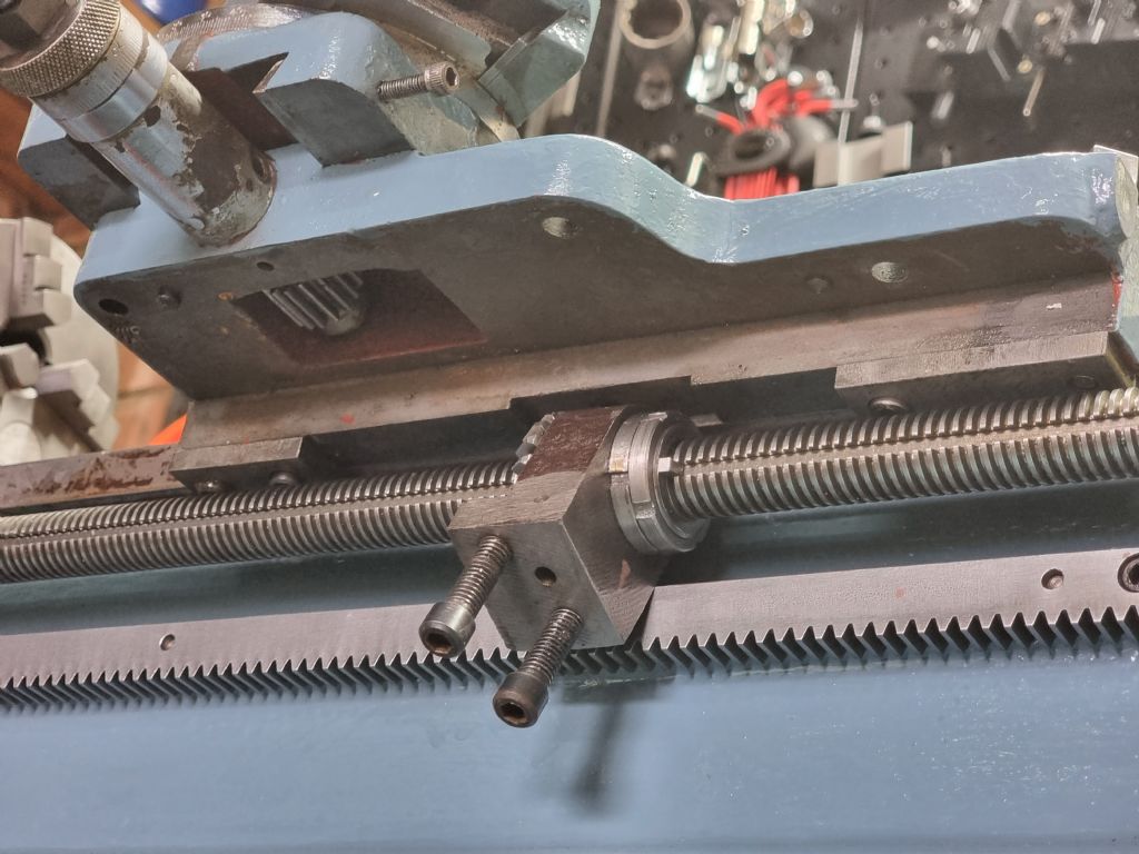

                                                  I also went hunting for the 0.9mm of backlash in the cross slide, so thought I might as well do an exploded view of the cross slide and compound components. (If a kind mod could turn this portrait, that would be lovely )
                                                  Cross Feed Nut
                                                  I'm not sure if it's 60 years of wear, or people trying to force the cross slide when everything was rusted up, but I'm pretty sure the nut is the source of the problem.
                                                  Cross Feed Nut - worn
                                                  I can't tell if it's screwed or pinned – there are no obvious screw heads on the top of the slide, and I didn't want to start using precision violence on it as I've only just got the thing back together. Another issue to dive into some other time.

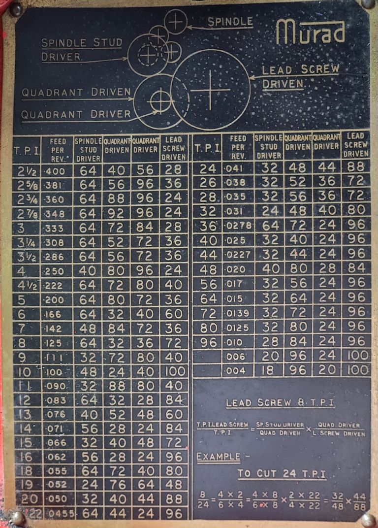

                                                  Threading Chart
                                                  Also forgot that I hadn't documented the threading chart in this thread, so here you go
                                                  #595006
                                                  Baz
                                                    @baz89810
                                                    Wow what an excellent range of threads 2.5 tpi to 96 tpi.
