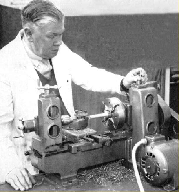

                    Rare to see pics of ETW in action. Shows how (a) he was a big lad and (b) the Bormilathe wasn't – only 10" between centres is an odd choice for a maximum a 7" centre height.
                    I imagine anyone wanting to turn things up to 17" diameter would probably need to turn long things as well, unless they saw its market as complementing a second lathe of perhaps 4-5" centre height.

                                              Hopper
                                                @hopper
                                                ETW
                                                They can’t have been too bad. Here is Edgar T Westbury himself using a Bormilathe. No idea of the story behind the pic. Randomly found it when looking up about his Phoenix model engine.
                                                #735045
                                                Steve Garnett
                                                  @stevegarnett62550
                                                  Hopper, I think that Edgar T Westbury was demonstrating it at an exhibition – I’ve seen the picture before. But you’re right – they can’t be that bad, otherwise I’m sure he wouldn’t have put his name to it.
