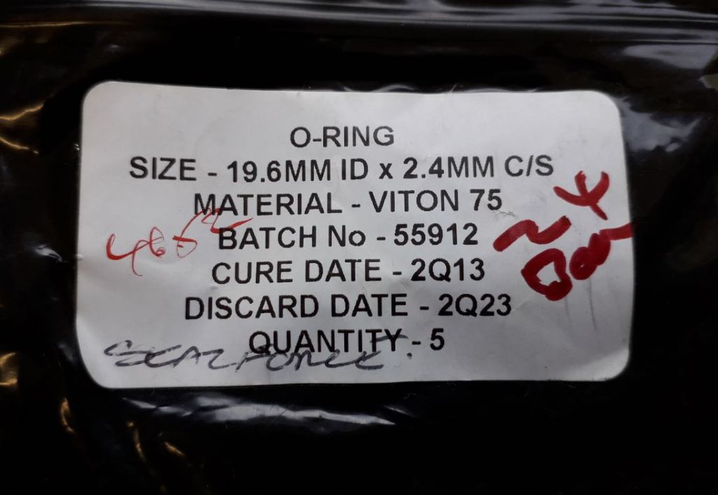

            I'm confused about the vitron o ring.
            I can't find any metric ones, or am I looking in the wrong place.
            the usual model engineering suppliers use imperial, which the sizes in the magazine equate to 3/32 or 0.09375 section and 49/64 or 0.76563 id . they are nowhere near what I have seen online
            (ps sizes rounded and taken from model engineers handbook)
            can anybody point me in the right direction for these "elusive" o rings
            thankyou

              They are not elusive Paul I got mine from Simply Bearings £4.29 for a pack of 2, maybe cheaper elsewhere I don't know, Jason will know. I have seen them on Ebay but went with Simply as I trust what they supply is the genuine item.

                    With most of the ME suppliers still living in an imperial world you are best buying from somewhere else in the modern world. As has been said any seal supplier or e-bay will have them. Just put "19.6 x 2.4 viton" into google.
                    A 3/32" nominal O ring is actually 0.103" section (2.62mm) not 2.4. though with changes to the groove an imperial BS116 ring would do as 15/16" is close to our 24mm bore.
                    Good listing of metric sizes here

                      Jason that explains the 0.103 I thought about the 15/16" but that is a tad under 24mm wouldn't that not be any good?

                        You would have to play about with the groove dimensions a bit to get the 15/16" to work bit it could be done if nothing else was available but as there are plenty of the metrics about hardly worth the hassle.
                        These are the ones.

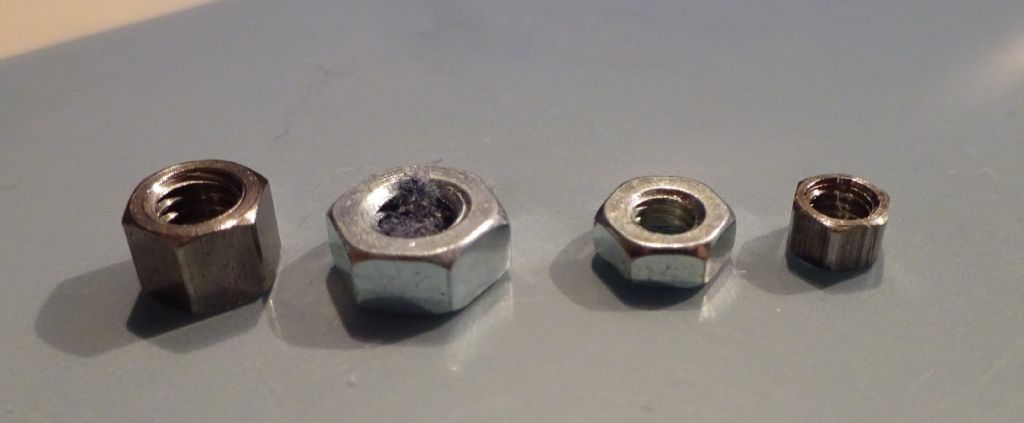

                                while we are on the topic where do you get your nuts from?
                                m2.5 self Colour seem to be very expensive from model engineer suppliers.
                                yet from other firms they only seem to supply them in stainless or bzp

                                  It's not just the colour but the size as well, I think I mention that the ones I use are smaller hex and a bit taller and look better on a period engine. Like good BA fixings these are fully machined not forged mass produced ones so nice and crisp too but obviously you pay for the more involved making.
                                  Polly Engineering do them though I usually buy from the people they get them from who are GHW in Germany.
                                  Mass produced M4 and M3 in the middle and the GHW ones on the outside

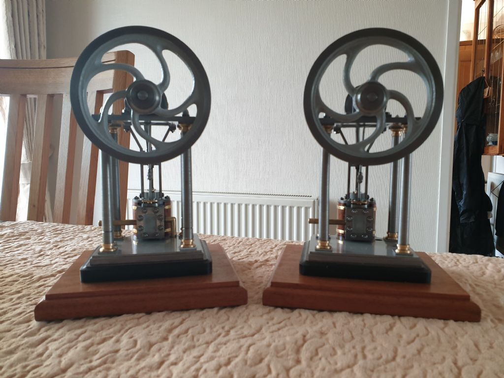

                                                  a brace of muncasters finally finished.
                                                  sorry Jason but ended up Sourcing some normal nuts from a local supplier as Polly were waiting to put an order in so had no stock. and the german firm wanted 40 Euros for the few I wanted inc postage which i thought was excessive. It's been a learning curve for me so don't look too close, I need to make another exhaust as on re assembly I broke one, and I definitely need to read how not to paint a locomotive. For any that are interested I think it has cost me around £90 to £100 to make these 2 engines that includes the fly wheels, fastners, paint, a couple of reamers I didn't have all the rest is what I already had lying around. may I take this opportunity to thank you publicly Jason and all the others with the help and advice along my journey.

                                                    They look to have turned out well Paul, good to know you enjoyed making them.
                                                    #483644
                                                    Baz
                                                      @baz89810
                                                      Beautiful job many congratulations, lovely wooden bases as well.
