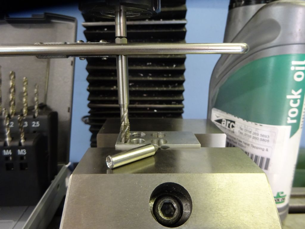

      Oh dear, broken tap Paul.
      Sorry have to agree with Jason, you're fault.
      I'm making this engine and I also made the bearing housings from steel, I largely avoid aluminium, much prefer working with steel, just a personal choice.
      What I would say is that I drilled the tapping hole right through the housing, so no possibility of the tap bottoming in the blind hole and just the taper tap will give you enough threads for the cap screw or stud.
      Also with small taps don't hold the work in a vice, hold the work in one hand and the tap and holder in the other. This will give you much more feel, you can sense more easily when the tap is tightening up so you can relieve the cut. Use a small amount of cutting paste, trefolex or similar. Also agree with Jason a slghtly bigger tapping hole helps

        I will take it on board to go up 0.1 next time.
        I called at the local suppliers on my travels today and picked up an Osbourn 1st tap and did the rest of the holes a treet.
        Geoff. it was a blind hole but, I like you on small stuff hold it in my hand, but this is, to be honest, is where I think I went wrong, I used a small tap wrench instead of one of those pin chuck types.
        lesson learned

          My preferred method is to tap the part while it is still in the machine from maving been drilled. The spindle is directly above the hole so a simple guide can be held in a chuck or collet and used to guide the tap thus keeping it perfectly vertical. I tend to use a small 4" long tap wrench on the round shank of the tap which will slip if you push things too hard.
          The guide can simply be a piece of 1/4" or 6mm steel with a 60deg point turned on one end and ctr drilled at the other so you can use it with taps that have a ctr hole or male end, apply light quill pressure as you rotate it with the other hand.

          I have said before that I generally specify a deep hole where the material allows so there is no problem with swarf or need to go through three types of tap though a spiral flute also does away with that need. You do not gain much more holding capacity once you get to 1.5 times the thread diameter in depth. So 5mm of actual thread on an M3 hole will be more than enough.

            Jason I'm not brave enough to do it that way on the mill with such small taps. I do however with bigger ones M6 +
            as a matter of interest I thought I would "have a go" at removing that broken tap. I drilled through from the other side and to my surprise when the drill met the tap I measured it and the tap was only 3.5mm in the work. I then got a small punch? drift? one of them round bar things with a flat end on lightly tapped a few times each side and bugger me it came out! So I need not have made another bearing blockfrown

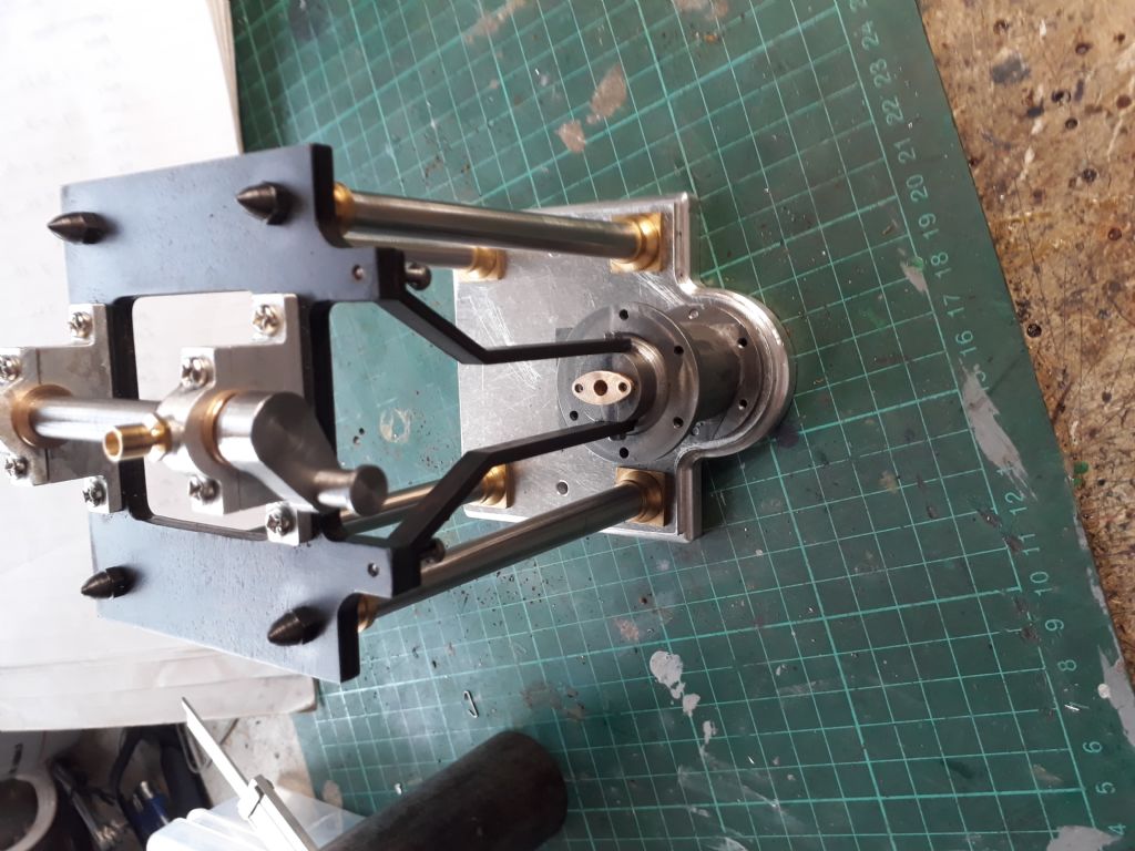

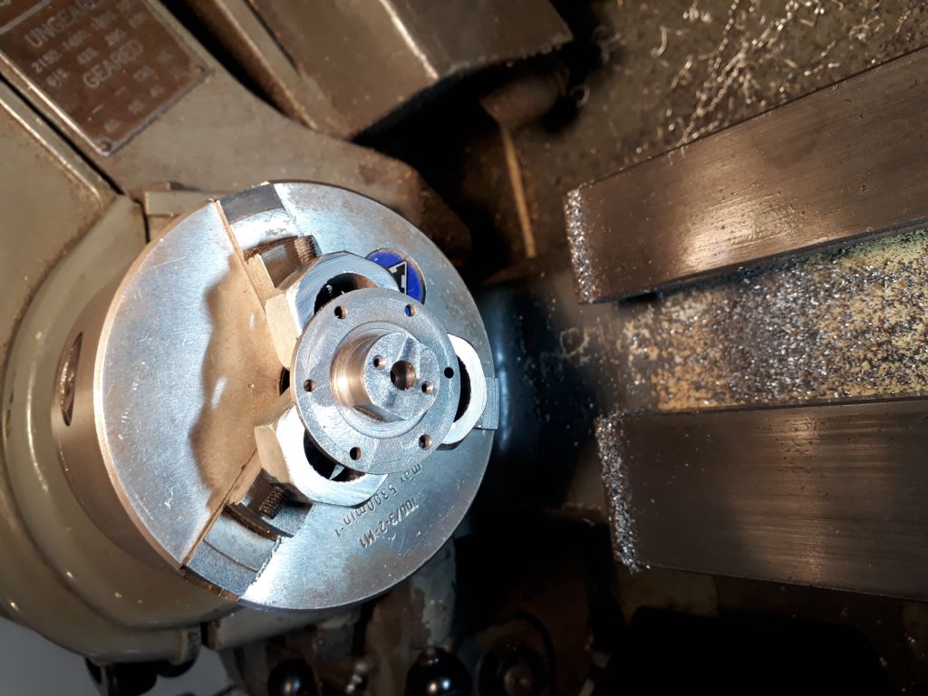

                    Hi Jason,

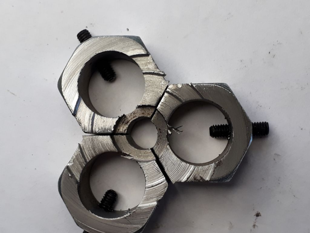

                    Attached photos of my build so far. By the way I used your method to make the cross head guides, Thanks.
                    It may be of interest to others how I made a poor mans "soft jaws." for machining the cylinder cover. I bored out 3 large nuts to fit over the chuck jaws and added grub screws to hold them on the jaws. In this case I tightened up jaws on the nuts and then bored out a recess slightly smaller than the OD of the cover.

                          Posted by john Chappell 1 on 28/10/2019 22:03:40:
                          Regards,
                          That's neat – even though I've got soft jaws I sometimes come across diameters I want to hold that don't fit my existing machining, and I know I'm unlikely to come across a similar diameter requirement anytime soon, and don't want to machine away what I've already got. This provides a workable solution for the 'one time' oddball job. Thanks.

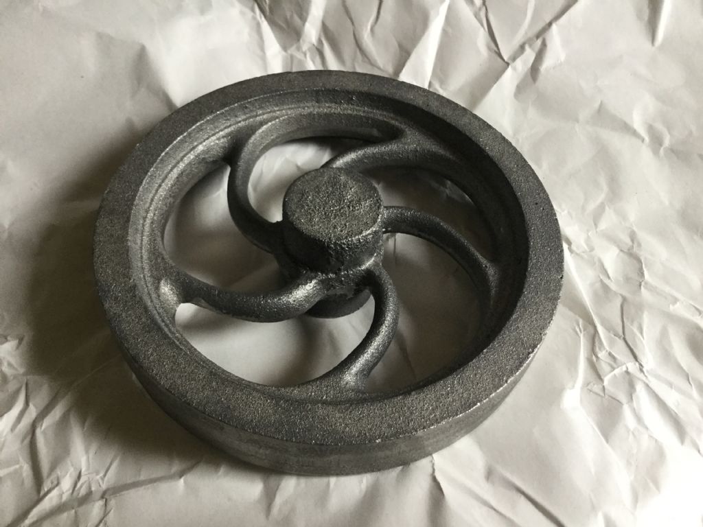

                            Don't all rush but Lee has the Muncaster flywheel castings back in stock here get them while there hot!
                            Edited By JasonB on 10/11/2019 20:25:58
                            #436773
                            john Chappell 1
                              @johnchappell1
                              Thanks Jason. Very good news… but he doesn't post to Australia! so how is one to buy? I wanted to buy 2 or more if others in Australia would like them
                              Regards,
                              #437083
                              Stuart Smith 5
                                @stuartsmith5
                                I ordered a flywheel casting from Lee on eBay on Sunday and it arrived today. Looks good. Flywheel

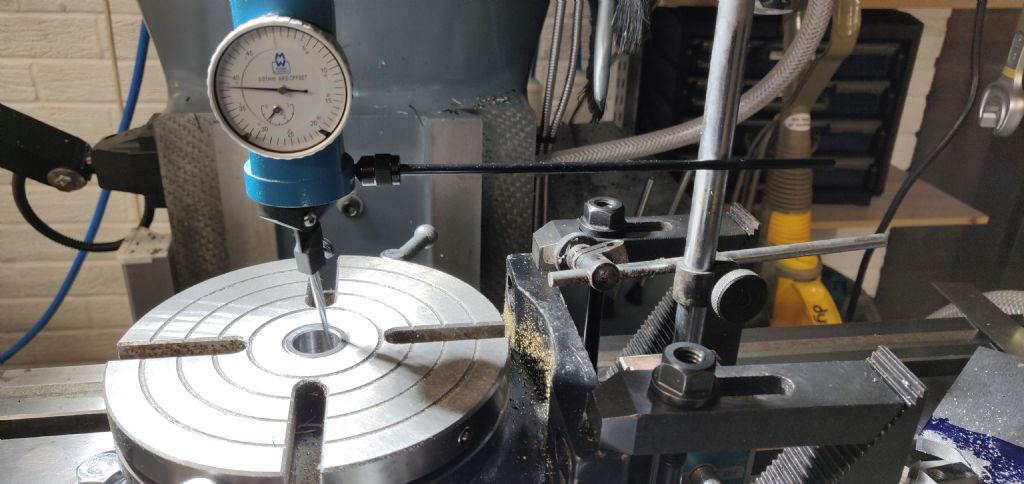

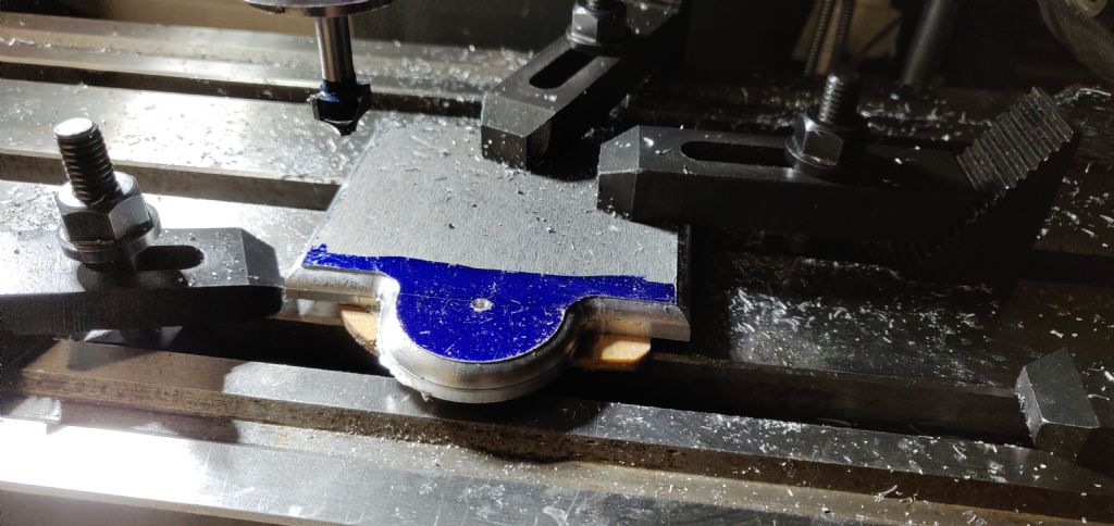

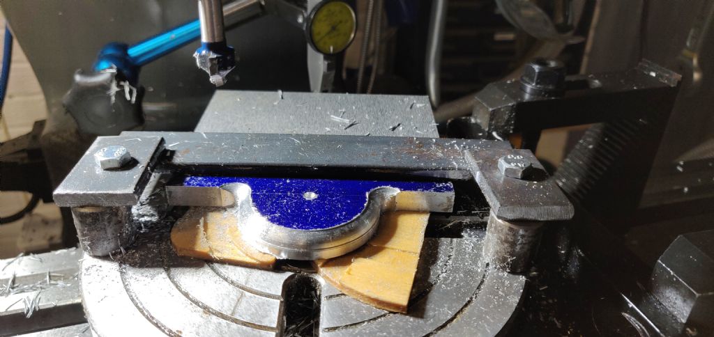

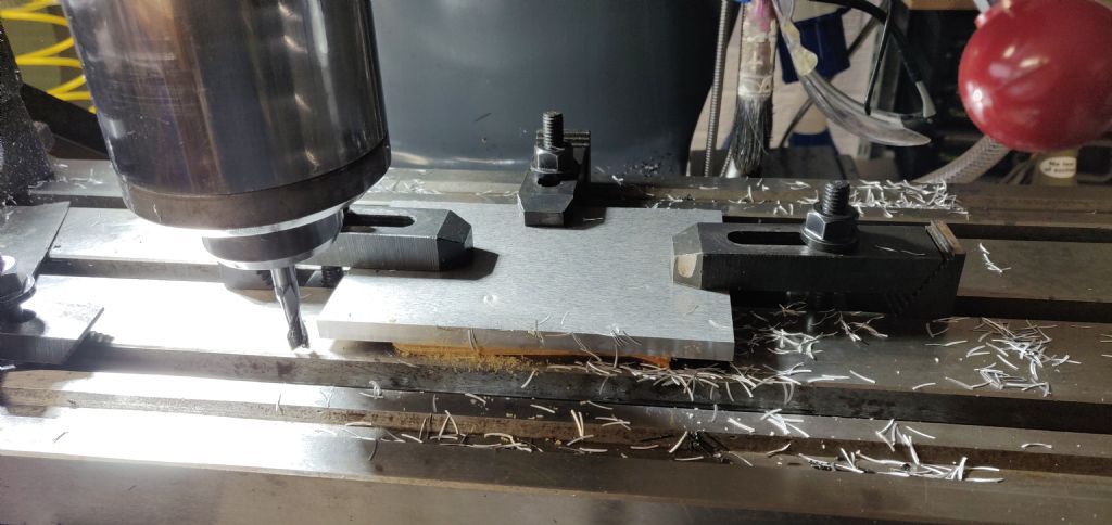

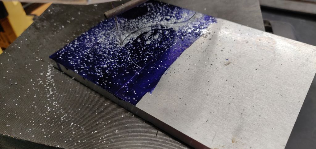

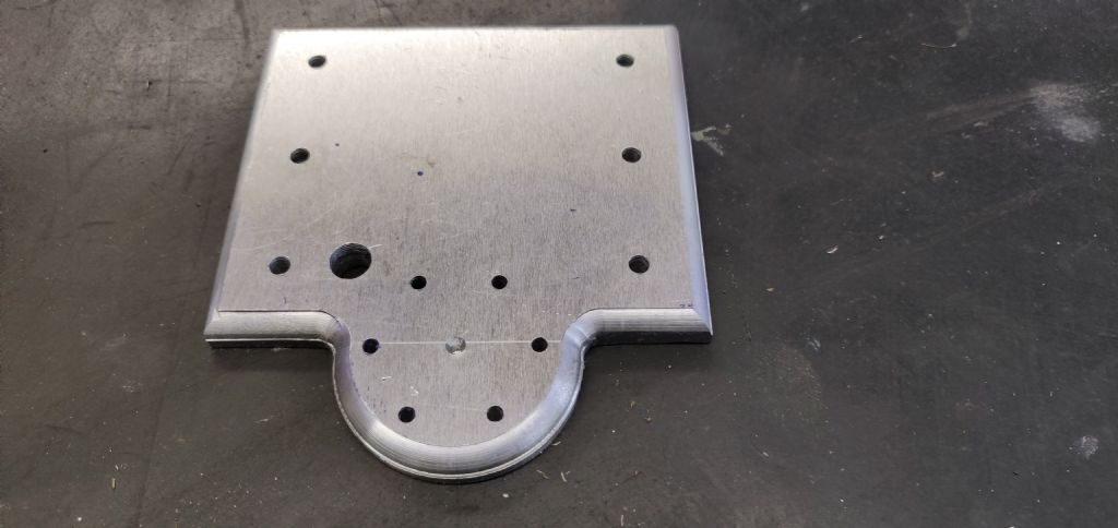

                                              Thought I'd share my build.
                                              Squaring the stock
                                              Cutting out the excess using a scroll saw – saw this on clickspring (youtube) and it works really well.
                                              Centering the rotary table with my new toy -works great
                                              Struggled with clamping this on my small roatary table. I used a woodworking router bit for the roundover and it worked well
                                              Working my way round the edges
                                              PCD was easy with the DRO
                                              Looks good!

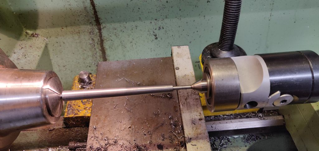

                                              I built a live centre for my boring head. 2 quid bearing from ebay, then made an insert to hold the centres from my tailstock live centre. Used a dti to give me 1mm of offset at the tail end.
                                              #438495
                                              Paul Lousick
                                                @paullousick59116
                                                The bottom photo shows the job supported at the tailstock by your live centre (I assume in the offset position) but the headstock end in a collet instead of a centre. Did the work piece just flex as it was rotated ?
                                                Paul.
                                                #438496
                                                Philip Borland
                                                  @philipborland84291
                                                  Paul,
                                                  yes just flexed – as per the advice in the magazine articles.

                                                      Off to a very good start Phillip.
                                                      Paul on this job with a 4mm spigot at both ends the job flexes quite easily so the setup with chuck or collet is a lot easier than between ctrs and driving with a dog. It can also be used where there is no spigot on the work if ample is left to hold, this will cause bending within the "tapered" part of the column and actually result in a slightly convex cut which replicated the classic column shape which is also not a straight taper. A good method for conrods on steam engines where the od tapers and has a similar result to blending tapers to get the "fish belly" look.
