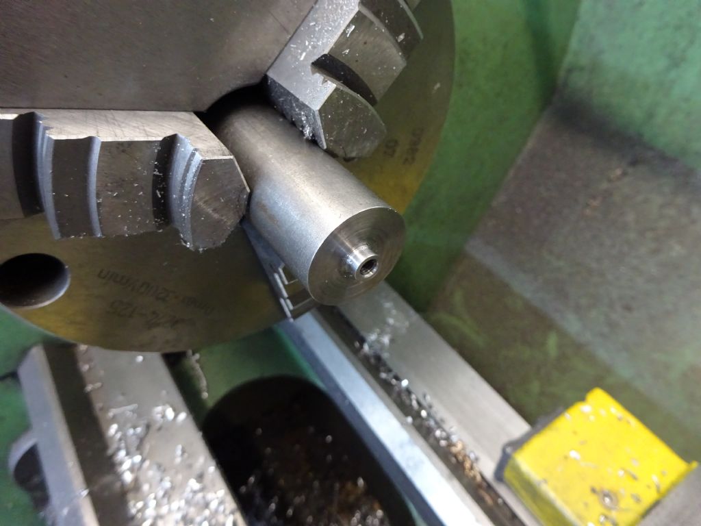

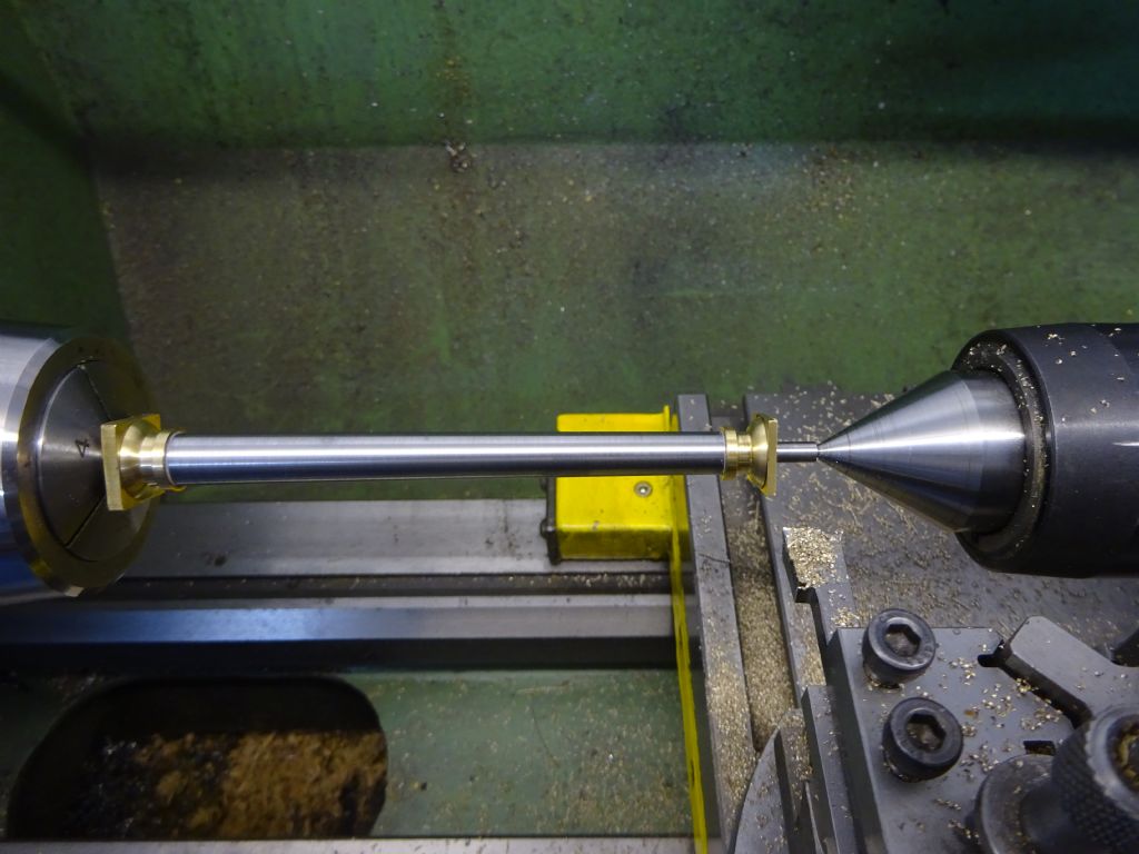

        Cont'd
        Once the adhesive has set on the assembled columns they can be held in the chuck or a collet by the bottom spigot and using tailstock support the top square can be turned to it's finished thickness of 1.5mm.
        Then reverse in the lathe so that the columns can be brought down to a final length of 119.5mm ensuring that all are the same length. After which the ends can be threaded.
        You now have enough bit put together and get an idea of how the engine will look, cylinder still to be covered.
        A shot of the feet being cut on the bearing pedestals which also brings the top block to length.
        Edited By JasonB on 09/08/2019 08:03:13

          Jason, I have not turned any long tapers so was interested in the method you used on the columns, especially using the boring head for the offset. Unless I,m missing something the method must rely on flex in the spigot which is held in the collet..? I see the tapers are shallow at 2mm over the column length but there must obviously be a limit to how much offset can be applied relative to the spigot diameter..?
          #423441
            Yes Ron, The actual article says that there is enough flex to use this method. If the part was more rigid it would deed to be done between ctrs.
            The limit is probably dependent of the rigidity of your machine and how far you are willing to bend the column.

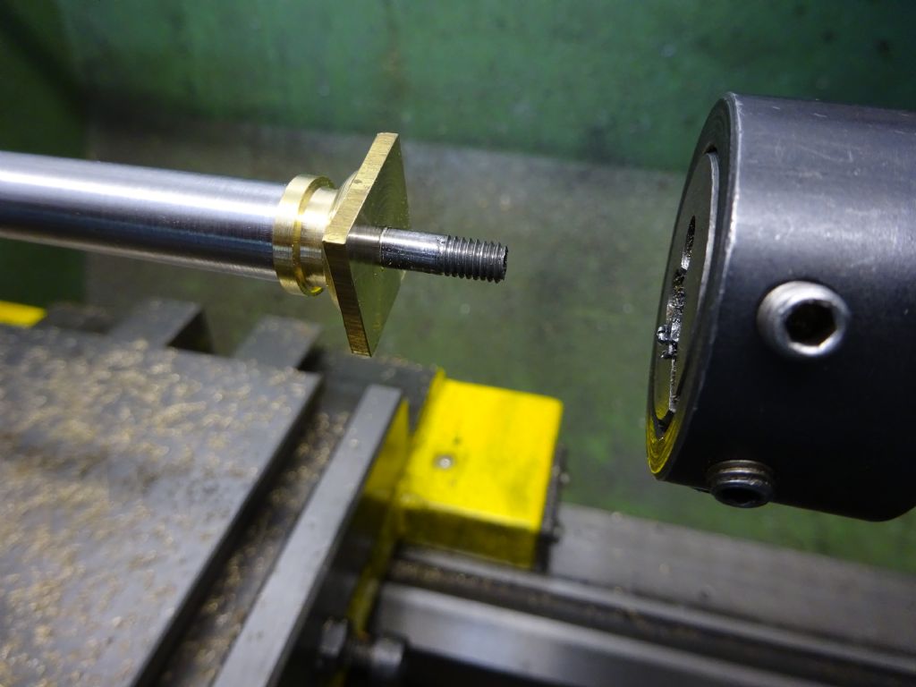

                  #425620

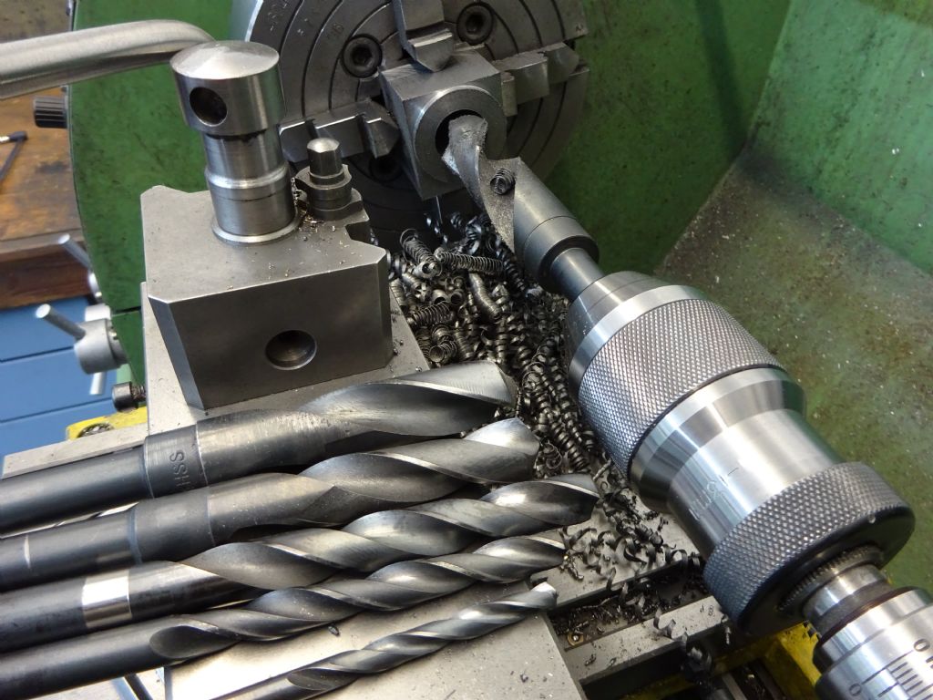

                    Extra content to go with part 3
                    No so much to add this time round

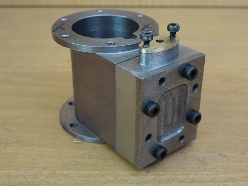

                    This photo shows how most of the waste was removed by working up through a series of ever increasing drills to 22mm before the final boring to 24mm.
                    This shot shows the port face of the cylinder being machined flat, I find that multiple passes with a small stepover using a sharp cutter gives a flatter finish than a couple of passes with a wide cutter particularly if there is any question about the tram of the machine. Here I used a 10mm cutter stepping over 2.5mm per pass.
                    The drawing for the cylinder having been reduced down to approx A5 for the mag may be a bit hard to read as it has quite a lot going on. You can download the A4 pdf from here which will print it out actual size and it will also blow up clearer on the screen than zooming into the mag image.
                    Any questions just ask.

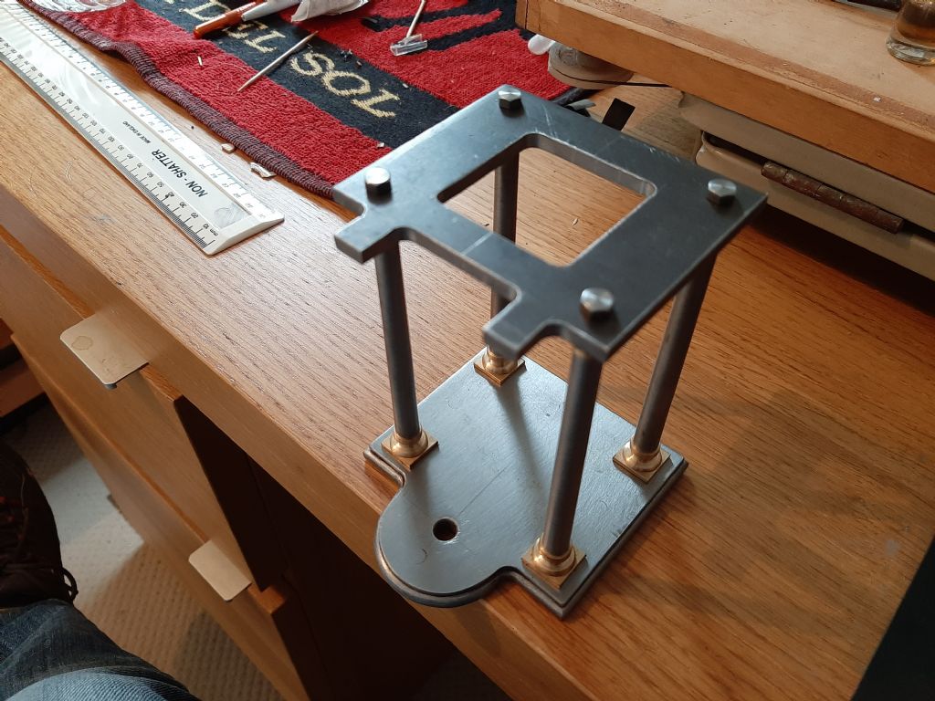

                                      I've had my eye on this engine for for quite some time so when I heard you had a series of articles in M.E. magazine I was naturally interested to see what building and machining methods you would use.
                                      As far as the size was concerned I always favoured making the engine close to the original dimensions in Muncasters book. As you will know this was a 3/4" stroke and bore engine and is around 3/4 of the size of your 24mm bore design. I just prefer the smaller scale, something you can place on the palm of your hand.
                                      The photo below is of the completed framework. I will be making the top end parts next, bearing pedestals, bearings crankshaft, crank etc., all to your building design but more or less 3/4 of all the sizes. I shall retain the original throw 9.5mm and probably the original bore 19mm (3/4&quot.
                                      I have to say I was very sceptical of your "flexed" taper turning method, did you get that from a textbook? Not a problem, works fine but I left the spigot off the top and drilled and tapped for a 4 BA screw.
                                      The base is laminated from M.S. as you suggested the parts being rivetted together with 1/8" csk. head rivets, just like we used in school metalwork lessons all those years ago.
                                      Photo in the next post, not uploaded yet.
                                      Geoff

                                        My muncaster frame 3/4 size20190902_165426.jpg
                                        geoff
                                        #427303
                                          Looking good Geoff, should not be too hard to scale my sizes back down as 1mm will equal 1/32" an dI tried to keep to whole units in most cases.
                                          You will have to plug the hole under the cylinder as I did not include a cylinder bottom, alternative would be to add a thin cover and reduce the conrod and guide bar length to suit.

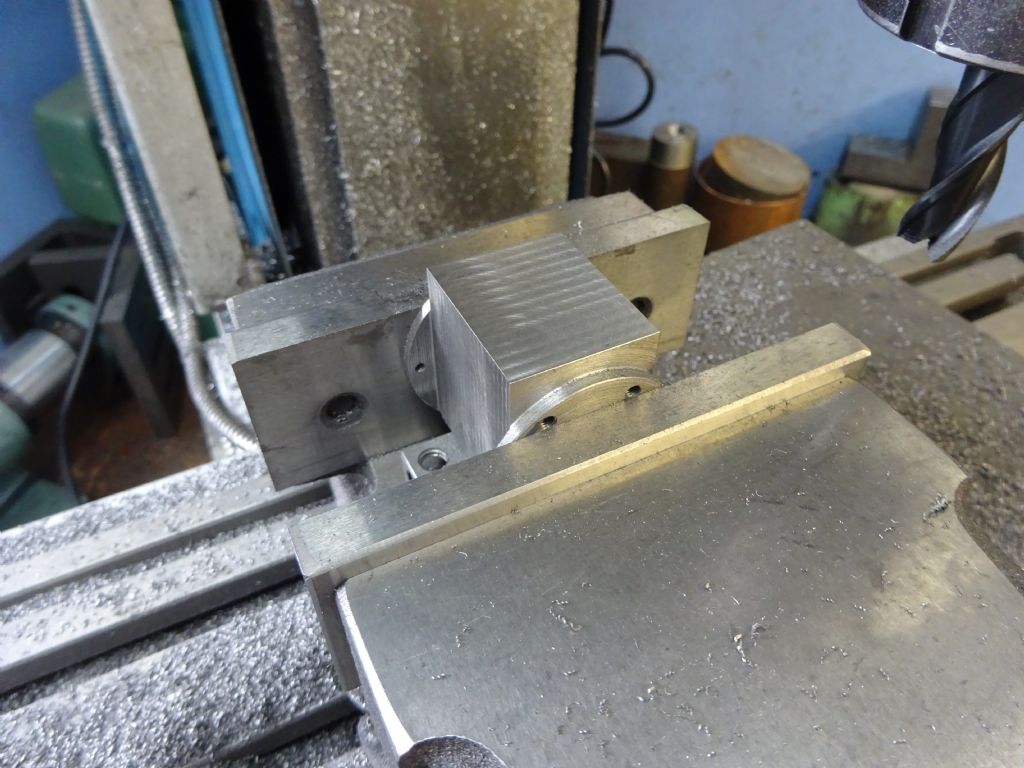

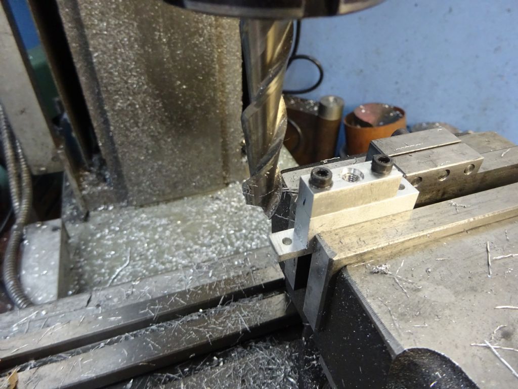

                                            I notice that you have again used the boring head in a very creative manner. This time to shape the exterior of the stuffing box bosses on the valve chest. clever stuff, I really must get a boring head for my sx2, looks to be a really useful piece of kit.
                                            I wiil be interested to see how you made the cross head guides and then aligned them accurately. I have a idea how to do it but will wait and see how you have it done before I order some stock.
                                            Enjoying the articles J, thank you
                                            Geoff
                                            #429226
                                              Got to know you ar eenjoying the build and learning a few new methods along the way.

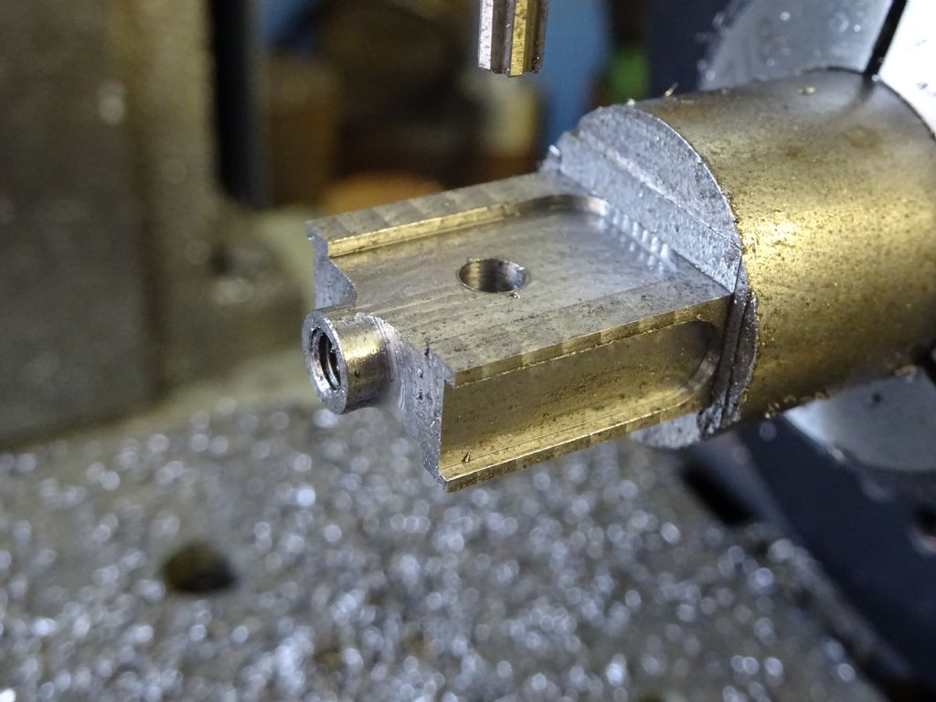

                                              Hopefully the text will explain my methods with the guides and highlight where the critical items are, if not just ask away.
                                              I did not post any extra photos to go with the last part as most were used in the mag but this one shows the finished chest and cover in place (temporary screws)

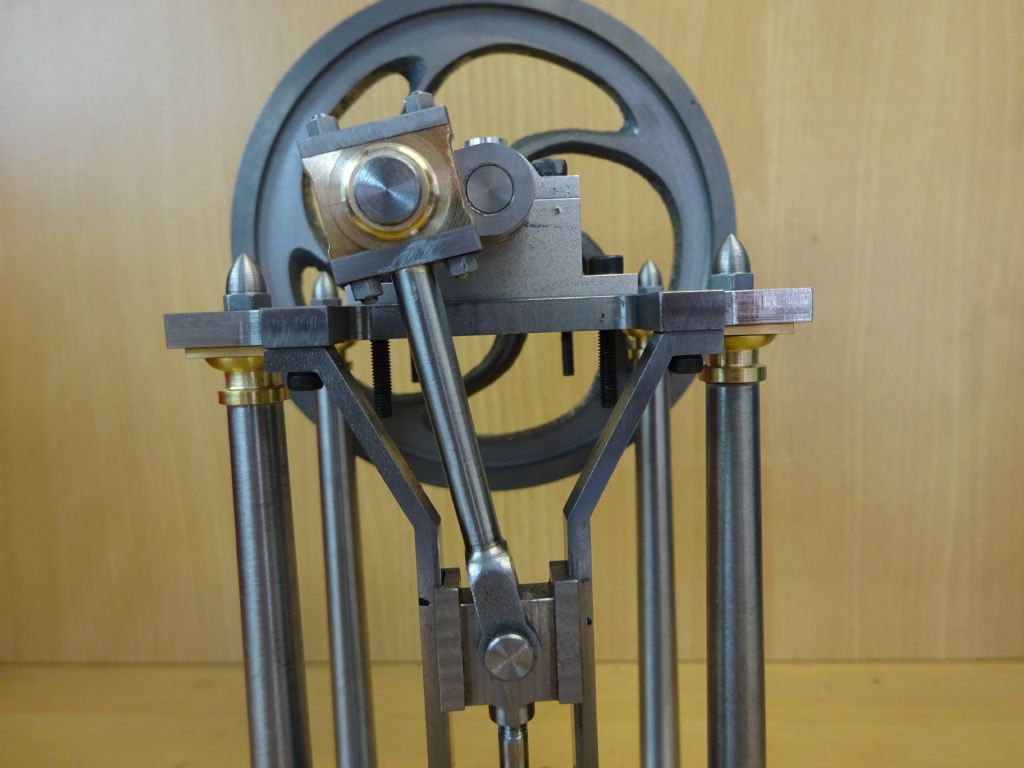

                                              #429908
                                                Additional content to go with part 5
                                                Initial turning and threading of the cross head before transferring to the mill
                                                Another shot of the crosshead being reamed for the pin
                                                Asembled crosshead, conrod and big end bearings
