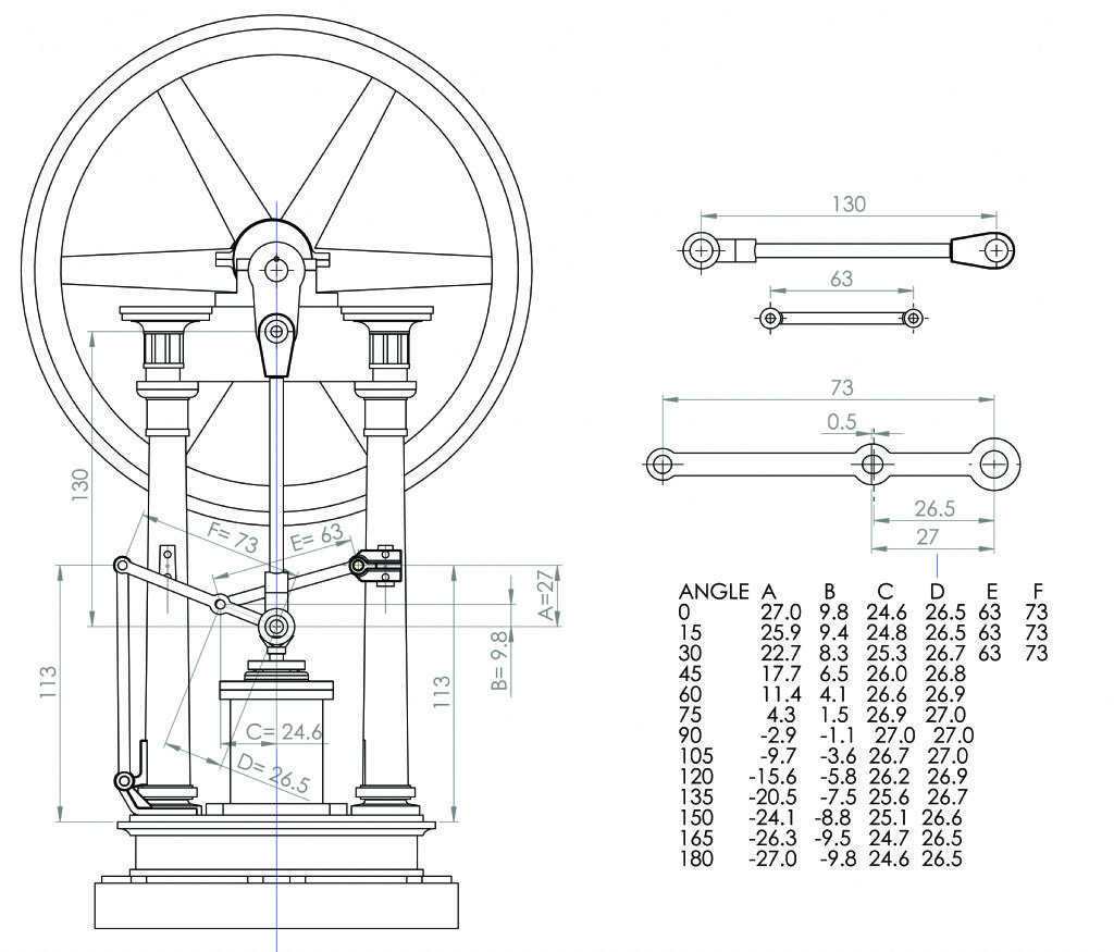

      After a bit of searching on the net, I am a little wiser. The Watts linkage and Peaucelliar -Lipkin linkage has 6 levers to accurately aligns and supports the piston rod with the cylinder axis. **LINK**
      The Muncaster engine has a simpler system, although not perfect, should work for my model engine. This is the result of my investigation so far. I have plotted the offset of the linkage arms in relation the axis of the cylinder and found that the slot in the left arm only needs to be 0.5mm long to compensate for the difference in length as the arms rotate.
      When the piston rod is fully down , the rod end is guided by the cylinder bush and cannot move sideways. The length D=26.5mm. When the crank is at 90 degrees, D=27.0mm. At 180 degrees D=26.5mm but the rod end can move to the left because of the 0.5mm slot in linkage arm .
      My thoughts are that If I lengthen the vertical (113mm) link on the left side slightly, I can get plus/minus 0.25mm offset at the top position.

        It’s a tad much to take in without drawing it myself – but did you allow for hinging at the bottom of the 113 rod in your work?

          Beautifully illustrated, and tabulated, Paul
          But, [along with pgk, I presume] I am concerned by the 113mm dimension on the left
          113 defines position of that link when it is vertical, but I can see nothing to describe the distance between its pivots.
          Please correct me if I am ‘barking up the wrong tree’
          #618599
            And the rod is not 113mm long, thats the height above base

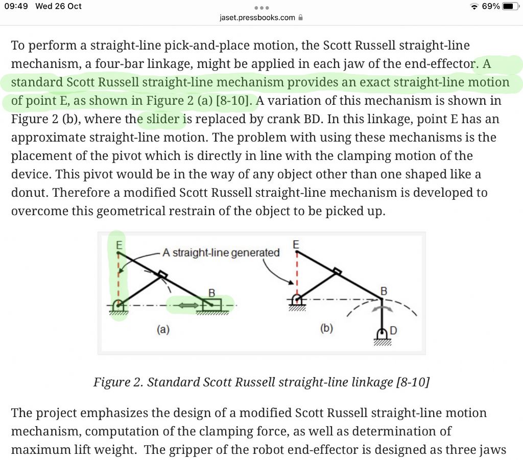

              Please forgive me if I am being delusional, but I think I may have sussed the underlying problem here
              In this model, the block on the right-hand pillar appears to be used simply as a bracket and pivot point for the duplicated arms [E]
              In the classic Scott Russell mechanism, however, it provides for a sliding motion:
              **LINK** [as provided earlier]
              Ref. https://jaset.pressbooks.com/chapter/design-and-analysis-of-a-modified-scott-russell-straight-line-mechanism-for-a-robot-end-effector/
              So; the model is avoiding that fundamental complication by enlarging another pivot into a slot
              Thus missing the basic concept of the mechanism dont know
              [ rather like putting a dummy governor on a model engine ? ]
              Waiting to be shot-down in flames

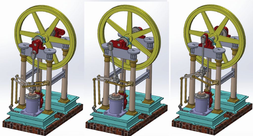

                Hi pgk, The CAD model is fully constrained and pivots as it would in a real model.
                Michael, It is a different type of mechanism and also simpler than the one I put in the link above. No sliding surfaces are used to guide the piston rod, just linkage arms. (not as good as trunk guides as used on other engines)
                The flywheel in the 3D model can be rotated and set at any angle (shown below at 0, 90 and 180 deg,) which moves all of the associated parts which can be dimensioned in a 2D drawing.
                I tried raising the vertical link slightly to see if this improved the offset at the top pivot but was not successful. Now will try varying the lengths of the other arms to see what happens.

                #618618
                  Posted by Paul Lousick on 26/10/2022 10:30:06:
                  Sorry, Paul … I think we might be at slightly crossed purposes
                  What I was trying to say was that I think either Muncaster’s original, or the subsequent CAD interpretation, gives the appearance of being a Scott Russell mechanism, but isn’t actually.

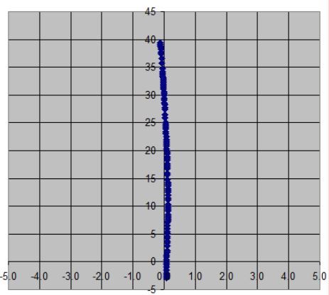

                      I asked about the linkage over on MEM forum and although no one has come up with a perfect solution yet, this recent reply uses software to plot the path of the big end from this simulation,
                      This is the plot for those that can't see it on MEM
