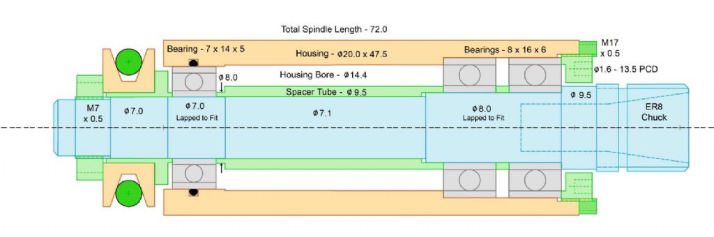

                #654001
                Steve Crow
                  @stevecrow46066
                  Here is version 8.
                  I've gone for a single nut at the rear. I know I could make the whole assembly in one piece but I lke the idea of a "pulley carrier" so I can swap for different sizes.
                  Not immediately apparent but I've put flats on the nose just behind the nut for collet tightening. This increase the front overhang but only by 2.5mm.
                  I want to go for different size bearing as I think I'll stand a better chance of getting the diameters optimal on two separate shorter journals rather than one long one.
                  When it comes to the spacer, I'm going to retain the stepped ends. Again, I stand a better chance of getting a nice snug fit if I've only got the ends to worry about. It will only take a few minutes extra work to bore out so It's hardly complicating things.
                  Same with the tail end of the spacer. I'l stick with the 8mm step as that is the SKF recommended abutment. Again, a few minutes extra work. I don't want to over simplify for the sake of it!
                  I'll describe how I plan to machine the parts later.
                  Steve
                  #654023
                  Steve Crow
                    @stevecrow46066
                    How I plan to make the spindle-
                    Cut a piece of 10mm EN8 to slightly over total length. Face and centre drill one end.
                    Hold the last 10mm of the unfaced end in centred 4-jaw with live centre at the other end.
                    Turn the plain shank at tail end of the spindle. I will make it a bit longer than the drawing as it has to be held in a collet later.
                    Turn the 7mm pulley section to 6.98 then the bearing journal to 7.01. Continue along the spindle, one diameter at a time (leaving the journals 0.01 oversize), until the 9.5mm section is done.
                    The idea is to leave as much meat and stiffness in the spindle as possible while turning. A fixed steady might help but I think I'll get away with it.
                    When the turning is done, single point the thread and do any chamfering. Then lap journals to suit bearings.
                    Remove from chuck, reverse and hold 9.5mm diameter in a collet. Then drill, bore, taper bore, thread etc. Basically complete the ER8 chuck.
                    Before the next stage, you will have needed to make the spacers and rear lock nut assembly.
                    Assemble spindle, bearings, spacers nuts etc. and nip everything up.
                    Hold the tail end plain shank in a good collet or well centred 4-jaw. Support front bearings in a fixed steady and adjust so the 9.5mm diameter is as true as you can get.
                    Move clock to the collet taper bore and check run-out. Its only going to be as good as your 9.5mm collet during the last process.
                    If its good enough, your done! If not, take a light skim along the taper until it is.
                    This last idea was adapted from the Swindles Spindles book that started the thread.
                    I'll describe the housing machining later.
                    Steve

                              #654094
                              Ian P
                                @ianp
                                I would say the Kiwi bloke has pretty much summed up the important bits to consider when making the spindle parts.
                                If I were to make one to the highest precision I could, I would machine the spindle between centres to an almost completed state except for the female cone. Leaving the ER end solid allows machining all the external surfaces, threading and bearing registers being lapped whilst the spindle can be taken can be taken on and off the lathe to check fits etc.
                                The conical bore can then be rough machined just using the three jaw chuck. I would finish grind the ER taper later with the spindle running in its own bearings.
                                I would avoid making a spacer between the (front) bearings (version 8) just because if we are talking high precision, its just another item that has to have absolutely parallel faces to avoid tilting a bearing.
                                The tubular spacer in version 8 has machined features at both ends which are not really needed. The outer annulus area of a flat face at the tail end will be in fresh air and shortening the shaft (front) bearing register will allow the spacer flat front face to sit against the inner race.
                                Maybe I have missed it earlier in this thread but I am not sure what type of ballraces are being used. As the over length of the whole assembly is quite short and as its intended use should not require it to take excessive side loads then I would just have front and back only as that would eliminate the need for the thread and but arrangement in the outer body. A thin close fitting (to the shaft) 'washer' could be pressed into the front bore to keep swarf out freeing up a bit more axial length for flats etc.
                                Ian P

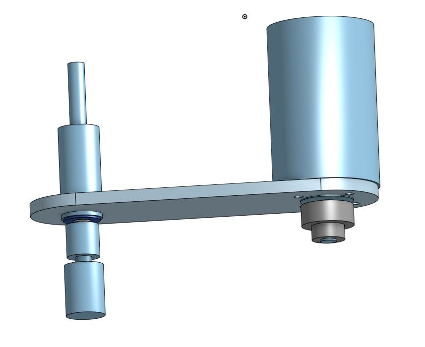

                                      Iain Downs
                                        @iaindowns78295
                                        Just wanted to say thankyou for the useful comments.
                                        My own use case is to put the spindle cartridge in the spindle of my mill and drive the (high speed) spindle from a motor hanging off the cartridge.
                                        The drawing below my give an idea.
                                        Left is the spindle (cheap Chinese ER11 'extension rod&#39 which runs in a 'cartridge' (some imagination is required to see the bottom part as an ER11 collet and above that a timing pulley). Attached to the bottom of the cartridge is a bracket that holds the motor (in my case a 200W Chinese thing). Again imagine the timing belt between the two,
                                        The spindle is supported on bearings at the top and bottom of the cartridge, loctited in. I've also made a version with preload applied by nut with a thread on the top of the HS spindle (cuts fine with single point threading) though that performed somewhat worse than the one which was just glued.
                                        The specific thing I wanted to achieve is to be able to mount the high speed spindle in the mill and have it be correctly registered. I could, for example rough something out with a 10mm end mill and tidy up with a 1mm mill.
                                        This kind of works ( drilling with sub 1mm drills is entirely possible now), but the run out is bigger than I'd like. I'm not sure if all the complications of Steve's spindle is really required for what I want. In particular, going mad for rigidity may make little sense if I have a bit sticking out with a drive on it!
                                        I'd be interested in any suggestions or comments before I build my next prototype.
                                        Iain
                                        #654147
                                        Andy_G
                                          @andy_g
                                          Posted by Iain Downs on 28/07/2023 16:46:38:
                                          Have you checked the runout of the taper on the ER11 collet extension with respect to its own shaft? I have had a couple of shockingly bad ones and one very good one (roughly similar prices). Similarly, 'cheap' ER11 collets vary widely in their ability to run true.
                                          Could you put the drive pulley on the rear of the bearing arrangement so that there was less overhang at the front bearing? IMHO, it's well worth trying to minimise tool overhang, to minimise the effect of spindle runout / lack of straightness. The smaller the tool diameter, the better the runout needs to be.
                                          This is the arrangement for a toolpost spindle I made using the good ER11 collet extension. It is driven from the rear by a timing belt pulley:
                                          The motor is mounted piggy-back:
                                          I wouldn't use the double row A/C bearing again (it still needs to be preloaded to remove slop – I didn't realise until after I'd made it). If I were to make one using an ER collet extension holder again, I'd probably use a similar configuration, but with a single bearing at each end (maybe A/C or maybe plain ball bearing, depending on likely loads & budget at the time). I think it would be a compromise compared to machining a spindle to one of the designs above, though.
                                          (Sorry, I didn't intend to monopolise this thread – it's just a topic that I have given quite a bit of thought to over the last few years!)
                                          Edited By Andy_G on 28/07/2023 18:36:00
                                          #654148
                                          Steve Crow
                                            @stevecrow46066
                                            I've only just read the latest postings as I've been in the workshop all day. Those boring bar holders don't make themselves! And I've got a feeling I might need them.
                                            A word about collets and workholding regarding the spindle machining.
                                            A couple of comments mentioned concentricity of collets. I've recently made an ER16 chuck for my headstock. Machined in place, it has no measurable run out. I bought a set of ultra-high precision collets (5 micron) and they are excellent, on an other level to any I've had before. Checking them with a test bar of nominal diameter (so there is hardly any compression) I get a run out of 2 to 3 um and I can half that by careful tightening (final 2 nips at 180 to each other) so I have confidence in my collets.
                                            Saying that, Duncan Webster was right, that 9.5mm diameter is far too short (4mm) to be gripped accurately. ER collets should grip on their full length for best accuracy. That's 27mm for a ER16.
                                            I could hold on the 8mm journal length instead which is 16mm long. As its being held in a 8mm collet, all should be good. After all, I'll be checking and skimming the taper in the final stage, when held true by the front bearings.
                                            When I do the final stage, I'll hold the tail end in a watchmakers collet which grips on a shorter length.
                                            The only time I'll be using a 4-jaw is the first stage, supported by a centre. As all diameters are turned in the same set up, everything should be concentric. I could even do it in the 3-jaw with oversize stock and turn down to 10mm for the collet when I reverse it.
                                            I will get round to describing how I plan the make the housing eventually but it's beer o'clock.
                                            Steve
                                            #654162
                                            Iain Downs
                                              @iaindowns78295
                                              Andy – the runouts do seem to vary quite a bit, though I found the worst part is generally the collet nut (some of which are unusable. Some are quite good and I have collets which claim to be decent.
                                              the point of my design is to put it in a collet in a (locked) mill spindle -not much chance of driving that from behind!
                                              Iain
                                              #654193
                                              Andy_G
                                                @andy_g
                                                Posted by Iain Downs on 28/07/2023 19:39:59:
                                                Sorry, I misunderstood – I read it that you had a separate high speed spindle, offset from the mill spindle, with some sort of mounting bracket held in the mill collet – my apologies.

                                                  I do want to make a longer quill version of this. That will have to have the housing trued on a mandrel as mentioned by Kiwi Bloke. However, I'm going to concentrate on the short version first to prove the concept, so to speak.
                                                  The housing will be steel, probably EN1A. Much as I would like to bore everything from the front, I have zero confidence in getting the rear bearing diameter right. And as for cutting the O-ring groove? Forget about it.
                                                  I'm going to cut and face to size then centre in a 4-jaw. A few minutes with a little nylon hammer on the tail end and careful tightening and in my experience you can get both ends near true. The whole housing is less than 48mm long and a third of that is in the chuck jaws so I'm not sure a steady is needed.
                                                  Drill and bore to suit rear bearing all the way through. Cut O-ring groove.
                                                  Reverse in chuck and clock both ends but this time on the chuck end and the bore. Bore for clearance, nose bearings and nose inner nut. Have said nose inner nut ready (that you made earlier) for testing the fit and cut internal threads.
                                                  I don't know the first thing about O-rings by the way. If anyone can enlighten me to what I need for this application?
                                                  Steve
                                                  #654328
                                                  Andy_G
                                                    @andy_g
                                                    Posted by Steve Crow on 29/07/2023 18:22:07:
                                                    The O-ring isn't particularly critical – find one with an ID that matches the bearing OD (within a few %) and has a section diameter that is less than ~25% of the bearing width.
                                                    Cut the groove in the housing to ~90% of the O-ring section deep by somewhere between ~125% and ~150% of the O-ring section wide (not critical). The groove is roughly centered on the bearing location.
                                                    (The groove could be machined in a different setup to machining the bore because any sight lack of concentricity doesn't matter.)
                                                    #654352
                                                    Steve Crow
                                                      @stevecrow46066
                                                      Posted by Andy_G on 29/07/2023 21:14:41:
                                                      Thanks for that, In that case, I've seen O-rings that will fit.
                                                      I'd rather cut the groove when boring rather than go through the whole faff of setting up again though.
