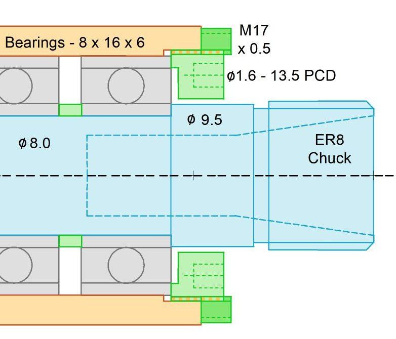

      Thank you for all the input.
      I will do some revised drawings with a simpler spacer. When it comes to abutment sizes etc. I've found this information for the bearings i intend to use so I can incorporate it into my drawings (which are to scale, by the way)
      I know what you mean about the stiffness. I had a look at the SKF link. This spindle has bearing spacing of 6x diameter which is nearly twice recommended.
      I need the length as this particular one will need to be able to slide at least 20mm in a 50mm long bush/sleeve. It will only be used in the vertical position for light drilling so I think I'll get away with it.
      I intend to make a shorter one as well for my lathe cross slide. That one will have to do some light milling so will be stiffer. I will watch your linked video later.
      Steve

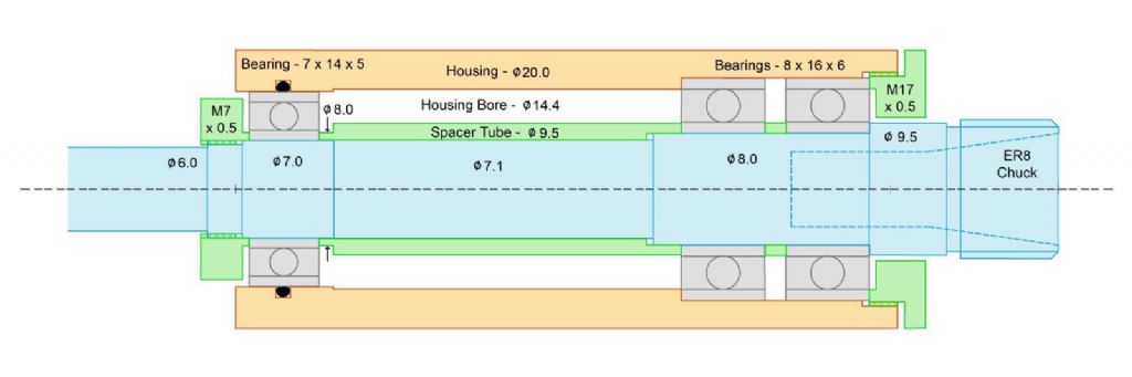

      Steve Crow
        @stevecrow46066
        This time I've drawn the shorter version, it's easier to see the whole thing. Bearings are 3.23 x diameter apart.
        I've taken on board suggestions for simplifying the spacer tube and the dimensions have been adjusted so all abutments are to the SKF spec. for those particular bearings.
        There were also dimensions (0.2mm) for the fillet radius for abutments. I have inserts with that tip radius so that should work.
        Not sure how to lock the adustment nut. I can't find any wavy washers that fit such narrow confines. Suggestions welcome.
        Steve

          OK, more simplification. Probably.
          Make the 'nose nut' without the flange you've drawn, so that, when tightened, it sticks out say 3mm beyond the end of the housing. The nut's OD is threaded along its entire length (easier to machine), and it has a couple of axial holes on its exposed face, for a pin spanner. When boring and screw-cutting the housing, make the threaded section longer, then part off say 3 mm. This parted-off section then screws onto the exposed threads of the 'nose nut' (taking the place of your flange), locking it. You'll need to make a couple of pin spanners (or a C spanner for the locking nut, if its face is too skinny for spanner holes) to tighten the nuts. (Sorry for that complication). I can think of other locking strategies, but this one seems the most elegant – so far…

                Posted by Nick Wheeler on 25/07/2023 09:45:12:
                I'd be more concerned about the M7 nut on the other end.
                That nut can be done up tight, but it should be left hand thread for a clockwise spindle by rights (or backed up by a locknut).
                I think that the concern for the front clamp ring is because it will be used to set the bearing preload, so will need to be locked at the chosen position, rather than being done up tight.
                Edited By Andy_G on 25/07/2023 10:01:17

                    I may well be incorporating the rear nut into the pulley yet. That way won't the torque keep the nut locked?
                    Once I'm happy with the rest of the spindle design, I'm going to look at the drive etc.
                    I like the nose nut lock suggestion and will do a drawing but I've also found a wave washer that fits so will draw one for that as well.
                    I would rather not use loctite on this. No objection to it, I use it all the time, bu I'd rather not on this spindle.
                    Steve

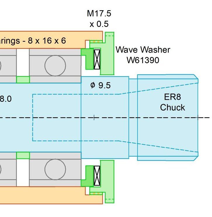

                        Two more drawings. The first is the nose lock nut suggested by Kiwi Bloke.20mm spindle 06 nose.jpg
                        The second one has a wave washer in the nose. It's shown loaded on the drawing dimension wise.20mm spindle 07 nose.jpg
                        This one looks kind of complicated. I'm sure it can be simplified.

                            I would consider a spacer for the outer races, then the nose nut can be locked up tight.
                            To create the right preload is a case of making the inner race and outer race spacers different lengths.
                            if you have access to a surface grinder then you can make them initially at the same time – this creating a
                            paired length, and then selectively lap the inner one shorter.
                            On the back nut a pair of lock nuts should do.

                              Nah, don't like the wave washer. You'd still need to lock the nut. The wave washer does provide spring pre-load to the bearing pair, but it also destroys axial stiffness.
                              I'd rather forgotten about the other end… If you're driving this with a pulley, it can be screwed on (I'd assumed that, much earlier), and a plain locknut added. Don't rely on just a thread for accurate location of the pulley, though; it should be a snug fit on the plain section of the shaft, to ensure it runs true, and have a boss, outboard, which is threaded. This has the added advantage of getting the pulley as close to the tail bearing as possible.
                              Clive's comments above, about (partially) isolating the pulley from the shaft, is good stuff, and also applies to drilling machine quills, of course. But we're chasing simplicity, aren't we?

                                  Steve
                                  The elegance of the tube system is you make the tubes and spacers all the same length at first and then shave a thou or two off one to get the correct pre-load. The thin spacers between the front two bearings are a bit more tricky to do but you can super glue them to a face plate and skim. Final gapping can be done by "stoning" on say a diamond lap. The pre-load is determined by the difference in length rather than the absolute length so much easier to measure accurately with feeler gauges. The tubes can have fairly thick walls which improves the cartridge and spindle rigidity. Also their inner and outer diameters don't have to be that accurate. You can make one long tube and then part off the thinner spacers and only the face that the parting tool created needs to be trued up.
                                  I'm not sure that given the ER 8 collets and the small cutter/drill you are expecting to use whether you need two bearings at the front.
                                  I've just upgrade a sensitive vertical drill by using a bought spindle with ER11 collets. The spindle is a straight 12mm diameter X 150 mm long and in my case runs in oilite bushes. I don't know if similar spindle are available for ER8 but it would save a lot of work.
                                  The Leinen system used special bearings which had to be assembled in the correct orientation so on reflection the spacing tubes were probably equal length.

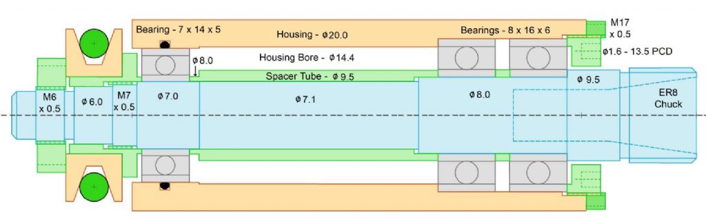

                                  Steve Crow
                                    @stevecrow46066
                                    Here is the complete shorter spindle for my lathe cross slide.-
                                    The pulley is an arbitrary diameter for now but will use a 3mm drive belt. I forgot to dimension it but the pulley inner/boss outer diameter is 8mm.
                                    The longer spindle will be acting as a quill in a sensitive drill so I'm going to devise an isolated pulley system. I've not even started on the design of all that, I wanted to make sure I could make an effective spindle first.
                                    Steve

                                    Andy_G
                                      @andy_g
                                      Posted by Steve Crow on 25/07/2023 10:03:00:
                                      Yes – my comments would only apply to the case where you have a nut retaining the bearing only (the design in the post on 24/7 15:02).
                                      For the latest iteration, I don't see much point in threading the pulley *and* fitting locknut. As you say, the drive torque will keep things done up.

                                        Steve Crow
                                          @stevecrow46066
                                          My reasoning behind the locking arrangment is twofold.
                                          Firstly, ease of assembly. The spindle and bearings can all be assembled and locked up then loaded into the housing from the front. Then the pulley and locknut can be nipped up.
                                          Secondly, the pulley can be changed for other sizes without disturbing the spindle.
                                          I need to make the rear inner nut a bit thicker so I can access the flats with a spanner. This will push back the pulley by a couple of mil.
                                          Steve

                                          Kiwi Bloke
                                            @kiwibloke62605
                                            I think you may be over-emphasising the ease of assembly. The tail bearing will look after itself as the assembly is pushed together. You're right, and others have pointed out, that a threaded-on pulley will self-tighten, and so doesn't really need a locknut. It's analagous to a screwed-on lathe chuck. But, should you wish to run the spindle in reverse, a locknut becomes necessary.
                                            So, to simplify further, delete the green pulley hub, and thread the pulley directly onto the shaft. As I suggested before (or meant to, it was getting late), the pulley should, in addition to a threaded bore section, also have a plain bore, for best location, and I think this should be adjacent to the bearing. Thus, on your latest drawing, the 7 mm dia becomes plain, and the 6 mm diameter is threaded. The pulley itself is positioned as far to the right as possible, (over the plain bore section) to reduce the effects of belt tension. It will be easy enough to swap pulleys, and it won't disturb the shaft.
                                            I think the spacer tube could be simplified, with plain, not stepped ends. Its right hand end can remain 7.1 mm ID, if the spindle's 7.1 mm OD extends just a tad under the inner bearing's inner track. I'd think that its left end could also remain 9.5 mm OD. It doesn't matter if it's a larger diameter than the bearing's inner track's OD.
                                            One complication you might consider is a lightly pressed-on flange, on the 9.5 mm Diameter of the shaft, acting as a flinger or muck shield.
                                            It's looking pretty well done – time to cut metal soon!
