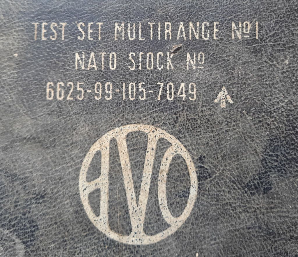

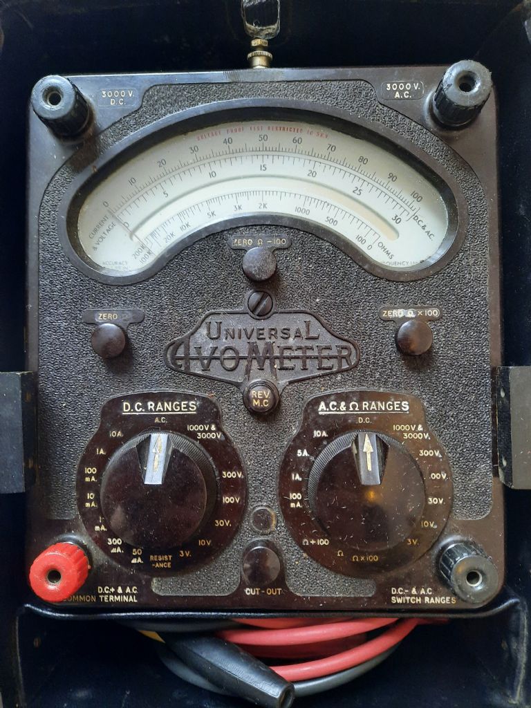

                    #564101
                      Rather sadly, the Aldi one is probably going to be easier to use and far more accurate than this…
                      #564102
                        and it has a ruggedised case !
                        The Avo does have more ‘class’ though.

                            Ah, but you don't get an Earth terminal on the Aldi meter. Some thing very special about an Avo, that special smell when you open the box and then see the quality workman ship or should I say Ladies work. Should any one be really interested in AVOs and all the they made and their repairs. I suggest you go to "Vintage Radio" where there are some experts and collectors. Not me i have only got eight. John

                                I agree with you John, there is something special about an AVO. It's just a nice thing to pick up and hold. Mine has been through the wars a bit but it works well enough for me.
                                Where it really scores is looking at things like motor start and running currents. The initial start current can be quite high but of such short duration that it gets missed by a digital meter. The large scale of the AVO shows it up nicely, not neccessarily in absolute values but you can pick up trends quite easily.

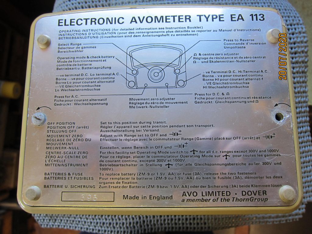

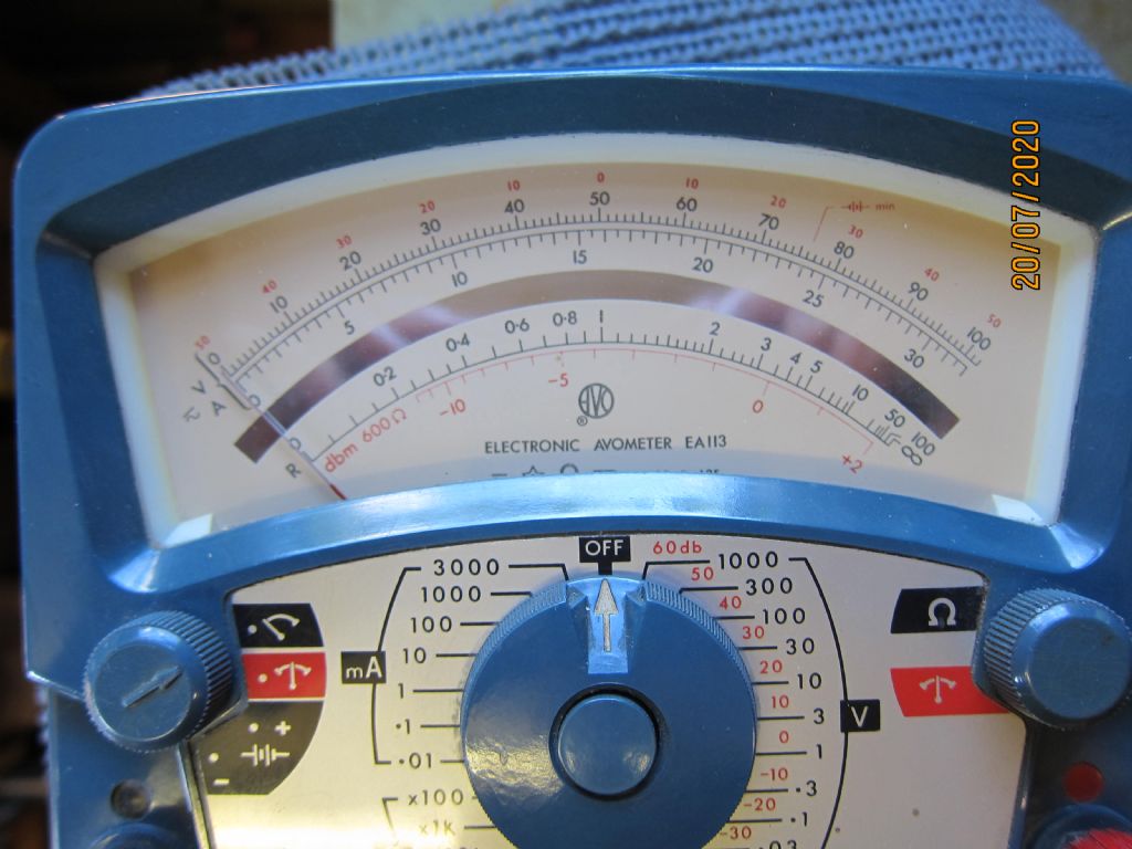

                                  I had one of these at one time but although a later model it never felt like a proper Mk.7/8 AVO
