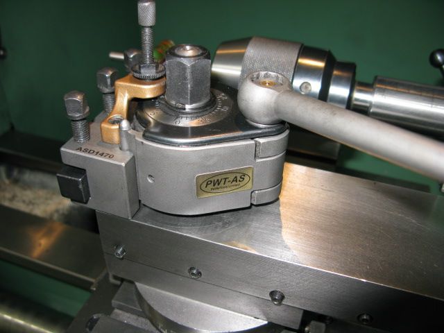

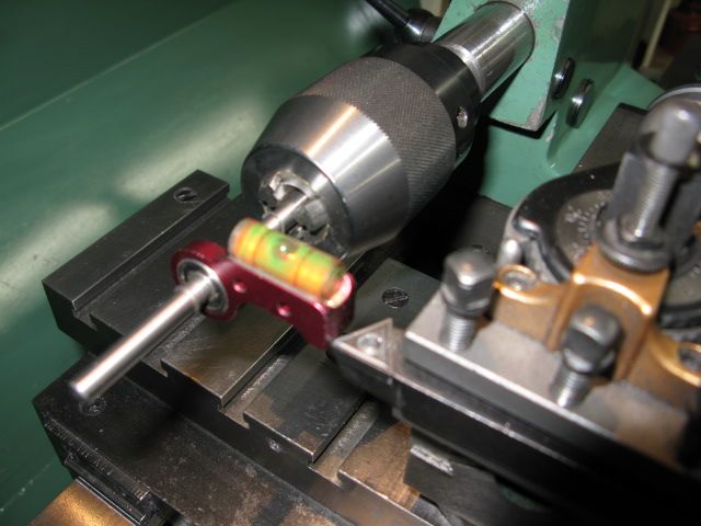

                                                Dave Wootton
                                                  @davewootton
                                                  img_0214.jpgHi Dave
                                                  The size I have is size AS, as far as I know PE-WE are the only suppliers for this size which suits my 254+ perfectly, I cannot remember the price I ordered the basic set and some extra toolholders, making a total of six and it was in the region of £350 ish I think, I did not have to pay any extra tax or import duty.
                                                  I've added a couple of pictures of the post fitted to my lathe, the toolholder in the pictures is 1/2" square, I added this because someone got very excercised on another forum saying only 10mm max tools could be used on one of these fitted to a 254, so the pic shows this is not the case. The set has had quite hard use over the past year with no problems, very satisfied with it.
                                                  A friend bought one of the Aliexpress sets for his Warco, not sure what model but larger than a mini lathe and not rusty, and although not as well finished as the PE-WE one it works well and he is very happy with it.img_0213.jpg

                                                    Bit of a sidetrack but … I'm intrigued to see that spirit level device for finding centre height. Is it really better/easier/faster than trapping a 6" rule and making it vertical?
