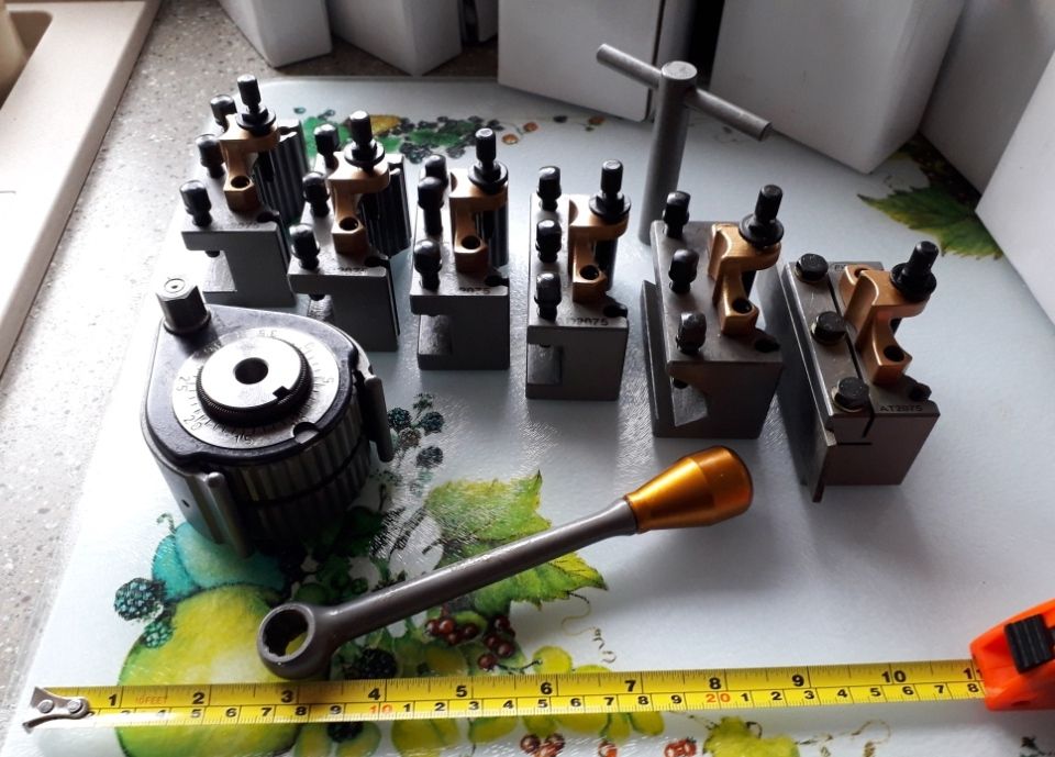

                              My A set plus a parting blade holder, arrived today, it need de-greasing but first impressions are excellent. I'll need to make a new tool post stud to suit my lathe before I can make any swarf…

                                  Seeing it there with something for reference, it's definitely a pretty substantial lump of metal, given the speed in which they sorted you out, as soon as I get confirmation back from Peter on the arrival of the 1675 tool holders, I'll be placing an order.

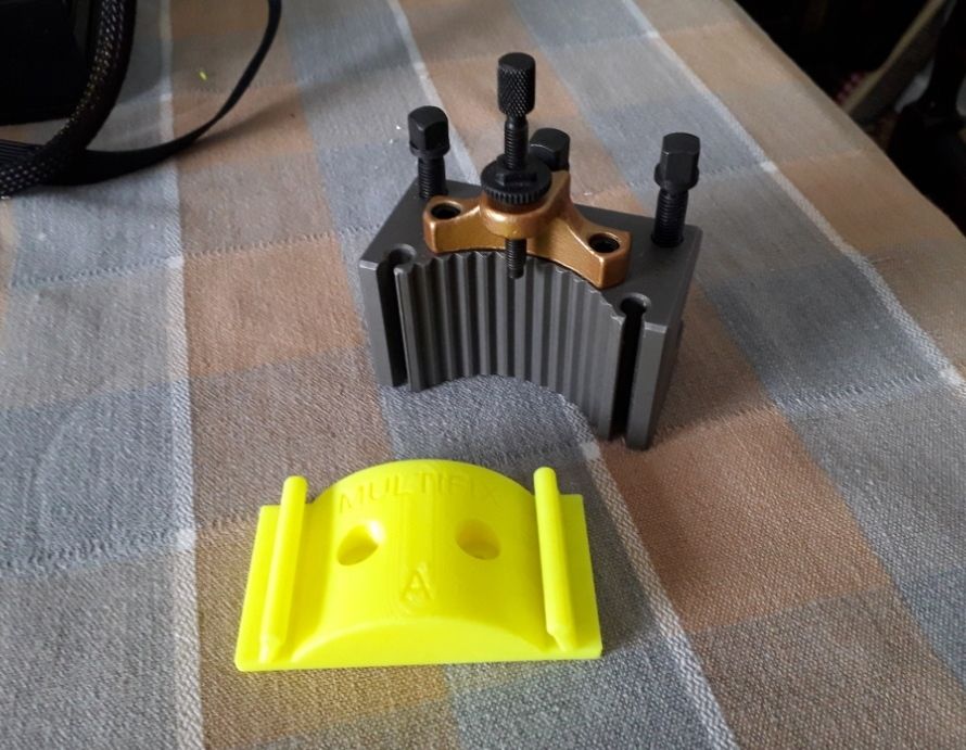

                                        My order from PeWe tools arrived earlier, along with 2 holders I hadn't ordered, but had enquired about but told him I'd make another order in the future, and he put them in free of charge, 2 blank holders to machine into custom holders, what an incredibly nice thing to do.

                                          Nice one Pete, good to hear they have arrived. Now that yours have come I'm hoping mine will turn up soon! You'll need some of these now…

                                            Hi Henry, they look very useful, is this on thingiverse? I've not ventured in to 3d printing yet, I'd have to get my brother in law to do it
                                            #519397
                                            Henry Brown
                                              @henrybrown95529
                                              Aye, it was this one: Link
                                              Surprisingly there are a few things on there DTI holders etc…
