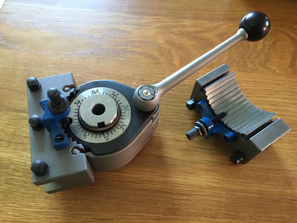

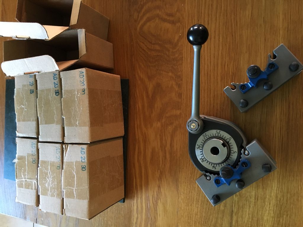

                                      See what you've done now. I finally ordered my A sized set (Bantam etc) from Create on Tuesday last week and they arrived yesterday – 6 days door to door via DHL (from Hong Kong). The price had gone up slightly but the carriage had gone down almost by the same amount, so price was almost unchanged at $468 / £339 plus £21 duty.
                                      I have no means of actually trying them out in my armchair workshop but they certainly look well made. For now I'll have to make do with taking them out occasionally and giving them a good rub and a polish.
