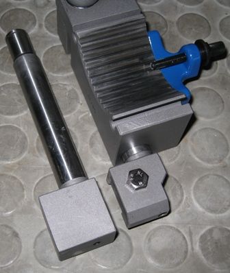

        There is a thread on this subject, but so old and buried that my last post on that went the way of the wind..

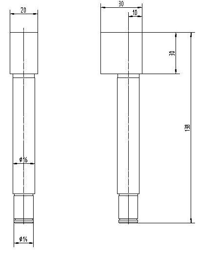

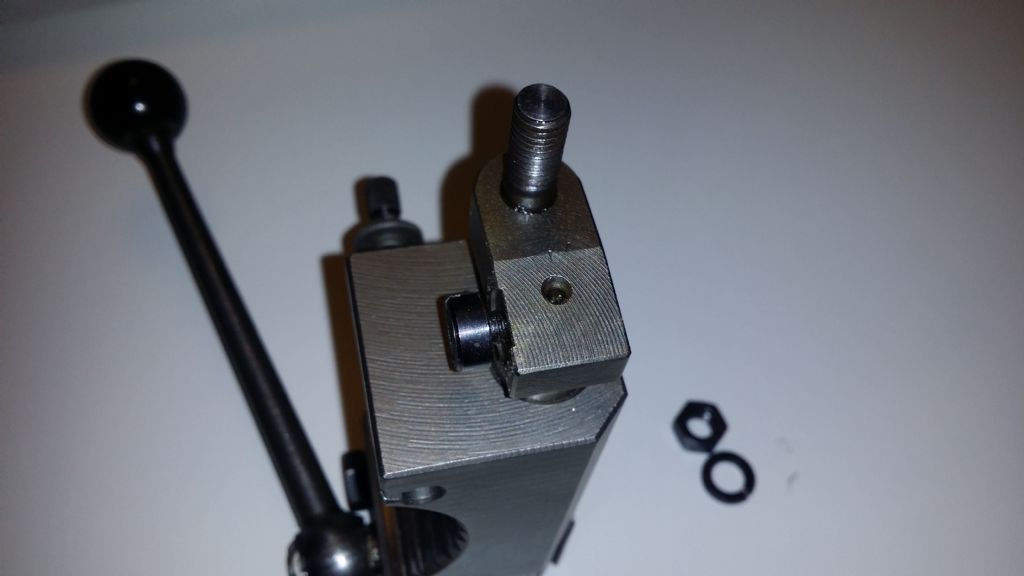

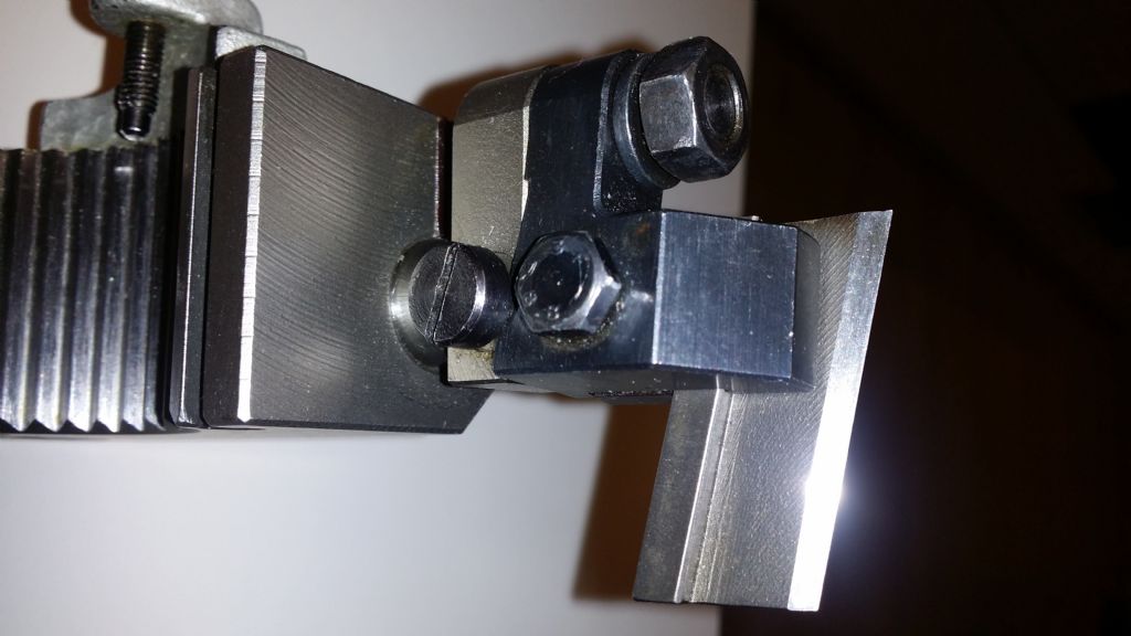

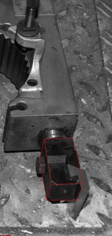

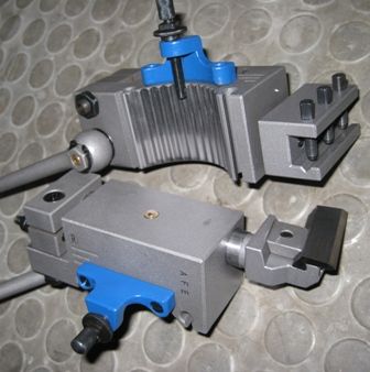

        I have purchased a bunch of Mulitfix toolholders from Create Tool including the retracting threading toolholder, which uses KOMET inserts. I had a hard time finding inserts, in fact could not, and Nina at Create Tool obliged my request to make me a modified tool shaft I could self machine to take standard threading inserts.
        Some folk simply sawed the head off the standard holder and welded on a head from a normal threading tool holder, but that did not seem so great..
        I sent her this, indicating that the red block should be a solid block, un-hardened, so I could machine it.
        She sent back this drawing which I accepted and that is what they made for me – I took 2 and will modify for suitable inserts soon.

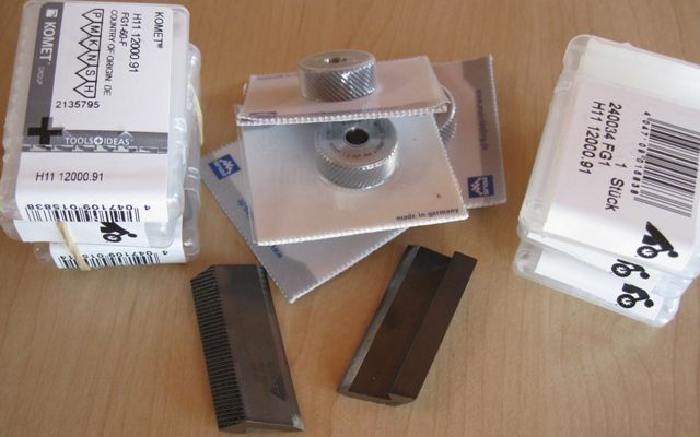

        And Then….I found a well priced, very quick source for KOMET threading inserts, and other bits, in Germany – Hoffmann Group ( I think they are in the UK as well?) 5 Day delivery from order to my door in Namibia! Takes 8 days for something from neighbouring South Africa..
        I suppose I have to make the usual statement – not associated or have any interests in Create Tool nor Hoffmann, but both were utterly professional, went out of their way to help, responded right away – recommended!

            Nice. I would very much appreciate you letting me know your contact in Hoffmann as I want to find out if ACME 29° inserts are available. I have been told that they used to be and have seen them for sale in the USA but it was not ecomonical for me to source a small quantity. Please PM me if you don't want to post the details publicly.

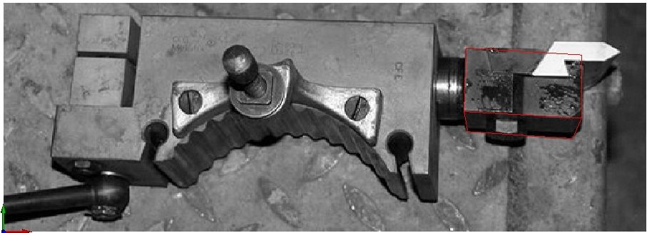

            I have purchased my komet fg 1 and fg 2 inserts from ebay.de. 55° HSS, 60° HSS, and trapezoidal sizes all come up for sale regularly, and 60° (brazed) carbide do occasionally. Most of the time the seller only posts to Germany but I have found if you write to them first they are happy to post internationally.
            My AFE has a different design insert holder to the Swiss originals. It is removable from the shaft and it can also be adjusted to the helix angle of the thread being cut.
            On the to do list is to make a replacement removable part that takes inserts. I have no idea who made this version the only marking it has is "Made in West Germany". Does anyone know? I have seen komet threading tool holders that have this same design so have wondered if it was a komet item. I would like to get a B sized version and knowing who made it may help the search. Please also let me know who your contact in create tools is as I am thinking about ordering some oversized tool holder blanks.

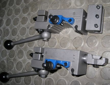

                        Create tool does not keep the threading holders 'on the shelf' – they make them up to order, within 2 weeks.
                        The holders are coded AFE ( External) and AFI ( Internal), A indicating size.

                            Not sure how much more definitive the 'story' can be – From Create Tool
                            I purchased one size A , external threading holder, complete with normal slide-shaft KOMET insert holder – Type AFE.
                            I also purchased one size A, internal threading holder, which as is typical of these, takes normal internal threading bars, ie, like a boring bar but with IR style inserts.
                            The 'modification' is just a swappable slide shaft with the end un-machined ( No KOMET fitting) so I can machine to take ER16 (or smaller) type inserts.
                            The other toolholders I purchased are a mix of the standard holder for square/rectangular cross section cutting tools and the boring bar holder – A holder with a V base and also some V inserts that slip into the V of the holder, allowing use of small diameter boring bars.

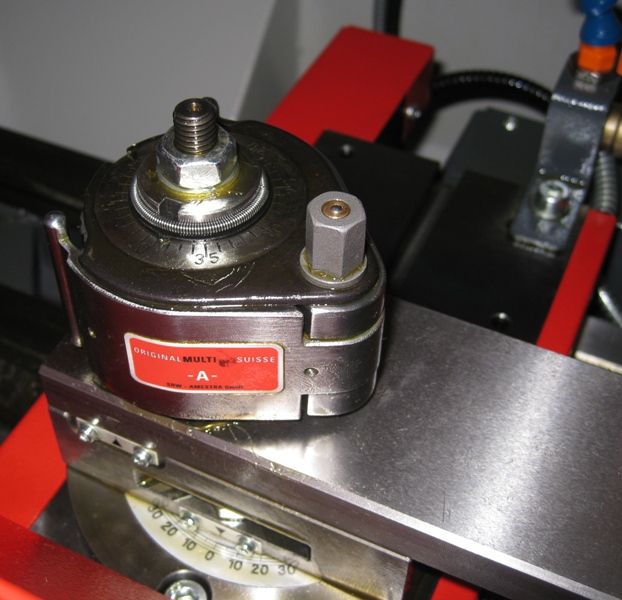

                            All these items fit my 'original' Multi Suisse tool post perfectly. Or at least the toolpost is labelled as such..
                            A chat with the African Regional Sales Rep at Top-Maschinen ( AXA folk) reveals ..
                            The Chinese holders will not fit our toolposts, and vise-versa, because the Chinese cannot maintain the tolerances of the product in manufacture….????
                            Will not say anything more! Sounds like a bit of nonsense to me. The implication is that they should fit, but sometimes do and sometimes don't due to poor tolerance control…But when when I asked if the designs are the same, or are there any fundamental structure deltas, the chap avoided answering , so I am not sure what the issue is. Maybe they had made changes to avoid proprietary issues? So the internet gossip is fueled even by the supplier..

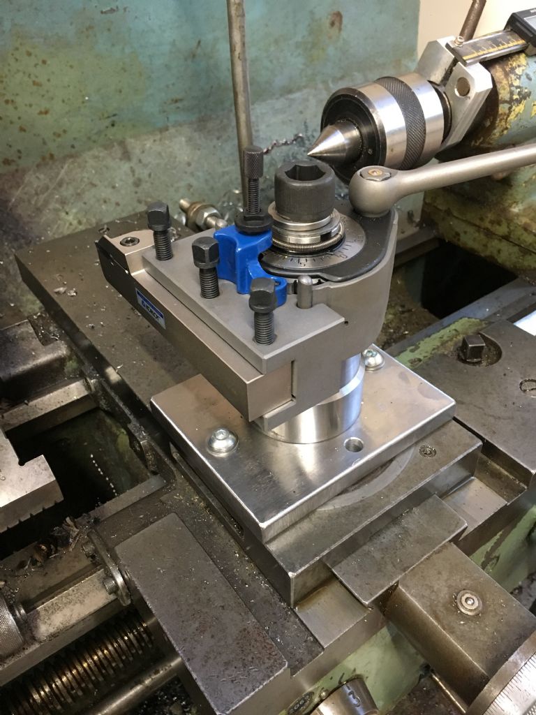

                              Dunno if you saw my post the other day but I recently made up a pillar to mount the Multifix directly to the cross slide, thus eliminating the top slide. I have yet to determine if any increased rigidity more than offsets the loss of the ability to cut at an angle but t seemed like a good idea at the time.
                              Fitted
                              Murray

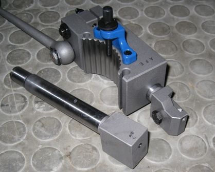

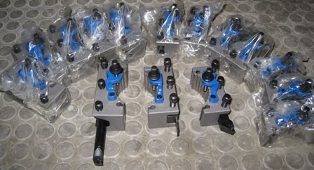

                                My Multifix tool holders all arrived from Create tools, and I am very happy with the goods. All fit the Swiss original tool post just fine, workmanship and quality is very good indeed. The blank shaft s for external retractable threading tool holders came out very well indeed. ready to be machined to take standard threading (ER) inserts.
                                Size A, and enough to keep the EMCO 14D happy..
                                A happy Chappy..
                                Joe
                                The blank shaft/holder
