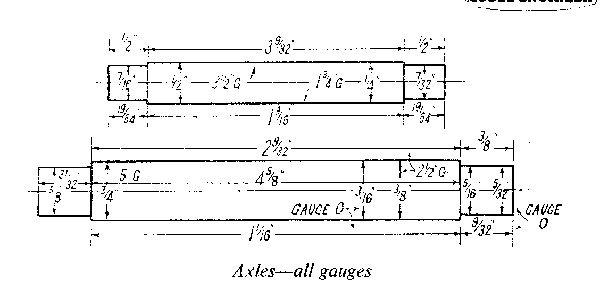

        Purely out of interest have a look at the following drawing from the description of LBSC's Netta where the axles for gauge O, gauge 1, 2½", 3½" and 5" are all shown together.

          That looks to be very bad practice to me, very confusing and open to mistakes.
          Normally you would assign each dimension a letter, and then tabulate them in a chart on the drawing for each alternative size.

            Probably comes from the days when the machine shop planer would strike out the dimensions not required, so that there was only one set left.

              Confusing at first blush but ok once you work his system out. I guess you were expected to have a modicum of initiative in those days compared with modern practice.

                    Provided parts were fitted to each other, would there be any need to measure more accurately than the 64ths divisions of a rule? Until recently the only way I would have been able to set the lengths of those axles would have been with a surface gauge and a 4R rule
                    Just because we can buy instruments graduated to 0.001mm doesn't mean we have to (or that the measurement will be that accurate). I spent a large part of my career explaining to engineers that specifying unnecessarily tight tolerances wastes time and generates an excess of either scrap products or concession notes, adding to the cost without benefiting the customer.

                        As far as limits and fits are concerned, back then, certainly in my 50 years of draaughting BS or ISO standards were rarely used. Some companies used the Newall system but most older engineering companies, and a lot of these were established around 1900m had established their own standards which they continued to work with until they needed to standardise. The reason for standardisation was the decline of the "make all" factory, where the raw materials went in one end and the finished goods came out the other with no subcontracting. Since, probably the second world war, industry changed and manufacturers did what they did best and let some one else make the other bits. So now we have drawings with all the information on to make a fully interchangeable part so that everybody who reads it has the same information without query.

                          The practice shown in the drawing in Nick's post may have had more to do with magazine publishing of the time than general engineering practice. LBSC may have had some editorial pressure to produce more bang for the buck and get more data for a wider audience on fewer costly pages. In different biographical accounts of LBSC there are some references to his interactions with the editors of various magazines he wrote for.
                          I personally would find it distracting to work to such drawings but as Hopper said you soon work out which set of dims is the one for your gauge / scale. It would not take long to circle the pertinent dims on each drawing as you went, or maybe make your own dimensioned sketch. This is akin to making your own CAD files these days to weed out as many errors as possible from long-published model engineering drawings still circulating.
                          As to fractions, I expect LBSC wrote to the wider audience of working people and trades people as well as the aristocracy of the time. The average guy could probably afford a fractional 6" steel rule but maybe not a micrometer or a slide rule to do decimal conversions. LBSC also published instructions to use commonly available items as substitutes for costly engineering tools – like setting valves to "the thickness of a tram ticket" spacing, or "use a bicycle spoke". His main point was that anyone could build a people hauling live steam locomotive if they really wanted to, and his articles were intended to teach anyone of any social position (that could afford the magazines he published in, that is) to do it.

                            I'd not be too worried by multiple dimensions as long as they are coherent and reasonable easy to follow: as others say, simply highlight the relevant ones, or make a copy with them alone.
                            More to the point is having drawings without errors! I wonder how many projects have come to grief over that.

                                              I agree with your comments above. The drawing in the opening post is one of the most diabolical pieces of rubbish I have seen. Ignoring any standards, they are to a certain extent irrelevant, the purpose of a drawing is to provide with clarity and without any ambiguity all the information required to manufacture or assemble an item. Initiative has never been a requirement for reading drawings. Another Interesting point, having spent 40 years working as a Design Engineer ending up as Chief Designer in industry, I had never come across the term 'bare' until I looked at the drawings for my Aspinall. I had to Google it to make sure I understood the context!

                                                I'm sure publishing to a hobby audience had far more to do with it than engineering best practice!
                                                Model Engineering Plans are often eccentric by professional standards, for all sorts of reasons. They range between excellent and downright misleading. Using the same drawing to redimension similar parts is asking for trouble in manufacturing, but not a bad idea for economy minded hobbyists wanting to build the same engine in different scales. It does require the hobbyist to be wide-awake though!
                                                I never trust hobby plans entirely, and always do sanity checks before making anything. Safer to assume model engineering plans are flawed than to blindly trust them! The check might be a basic sketch, or a full 2d CAD redraw to confirm many dimensions, or modelling whole parts and assemblies in 3D CAD. 3D Modelling is useful because it often suggests how parts might be machined for real, as well as confirming their shape and dimensions. (In a sense 3D CAD modelling really makes parts, rather than representing them 2D on paper, which is error prone.)
                                                In my limited experience sanity checking reveals fairly quickly how good or bad the plan is. Although cluttered the PottyMill plan I found on the internet proved sound, as was Stewart Hart's properly laid out original I came across much later. Same can't be said of some of the plans in old ME's, where the number of question marks often suggest a full review is necessary! Mistakes are fairly common, more difficult are missing dimensions and reference points, and parts that can't possibly fit together. LBSC plans are inconsistent, ranging from crystal clear – the famous words and music – to unsatisfactory outlines, probably never built, and perhaps only published as suggestions rather than practical designs. To be fair to amateur plans, draughtsmanship isn't an easy profession, and drawing offices usually cross-checked and reviewed everything with a team, corrected mistakes promptly, and applied proper version control. More work than most of us have time for.
