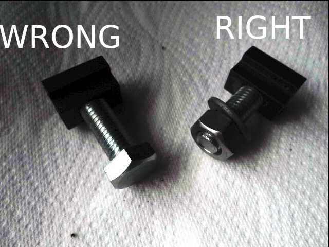

                        I use the "wrong" system a lot with hex bolts, but they are made a specific length to fit properly

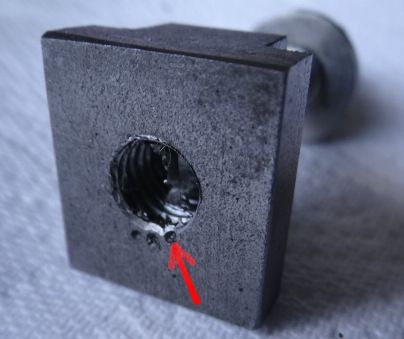

                          Tee nuts are not tapped fully all the way through. Use a taper tap and only allow the tap to cut a partial depth thread at the bottom, check that a stud tightens before passing out of the bottom. This will prevent you from jacking the tee nut up and locking it into the underside of the tee slot.

                                      Or tap all the way through because it's easier and then upset the bottom of the thread with a centre-punch. Good opportunity for hammering.
                                      Same reason as Howard explains – to prevent the stud screwing all the way through the T-nut and jacking accidentally.

                                          I have a Warco WM14 and the slots take the head of a 10mm bolt very nicely. I just slide the bolt in upside down and use the nuts and washer on the top of both vice and angle plate.
                                          Seems to work very well. I do have a lot of home made tee nuts.

                                              While noting that RB is a bit late to the party (see first reply), I often use a bolt – but only where appropriate or needs must. Sometimes with sufficient washers to ensure compliance, sometimes screwed in firmly (then backed off by a couple or three threads) then using TWO spanners (or spanner and allen key) to tighten the nut for clamping purposes.
                                              Using only studs should avoid beginners breaking out T-slots.
                                              All my home-made T-nuts are staked, to prevent any bolt or stud threading through. I like the idea of only tapping at full depth part way though the nut, but a better method might be to make a completely blind thread with a ground off plug tap?
