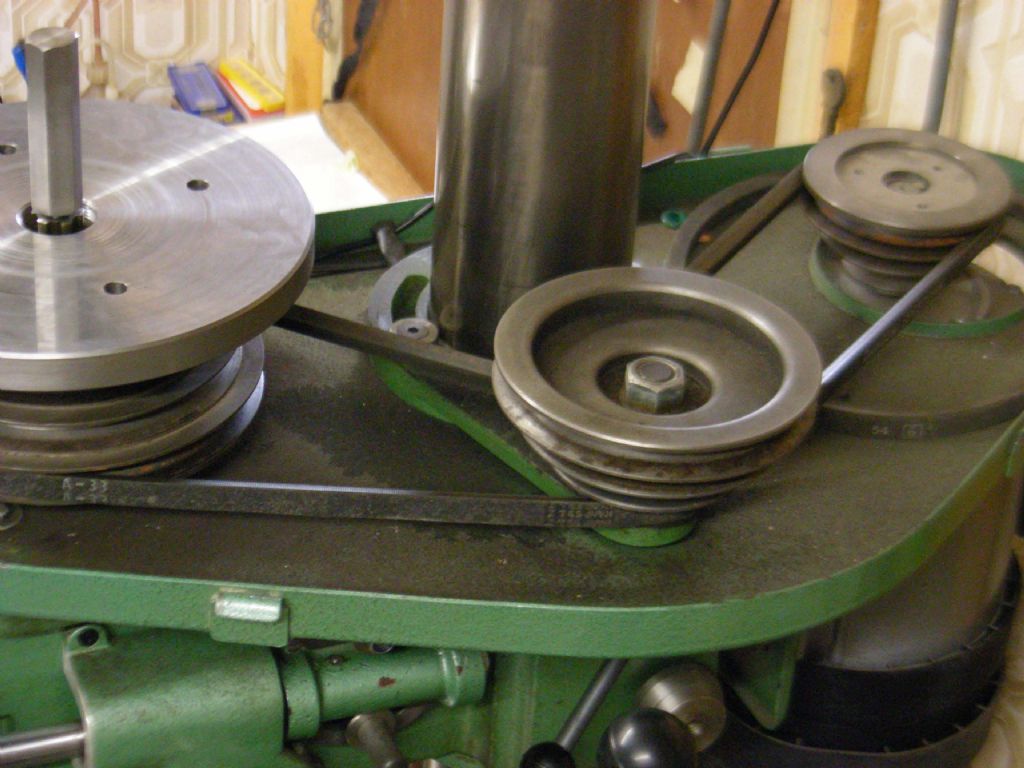

                  I have a Warco mill/drill. To change from the top speed range to the lowest there is a need to remove the motor to intermediate belt and the intermediate to quill pulley belt. The motor /intermediate is made easier by slackening off the motor tension screw allowing that belt to go slack. However, the other belt is a right pig as you have to slacken off a couple of bearing hub bolts, swing the intermediate pulley arm which slackens the belt.
                  Consequently, I use a small tyre lever to prise the belt off of the large pulley (Whichever that may be). To be on the safe side, isolate the machine first, as it is all to easy to have an accident!
                  Because it is such a pain in the posterior, I added 2 extra pulleys to the motor and intermediates. This gives me the full range of speeds without having to remove any belts, just move them up and down. I did have to modify the belt cover some what, but it still protects the operator.

                    I once had a drill with the intermediate pulley but it always floated and the tension for both belts was applied by the motor adjustment. It doesn’t seem to make sense to fix the intermediate pulley.

                      Pity you weren't on the design team Mike !

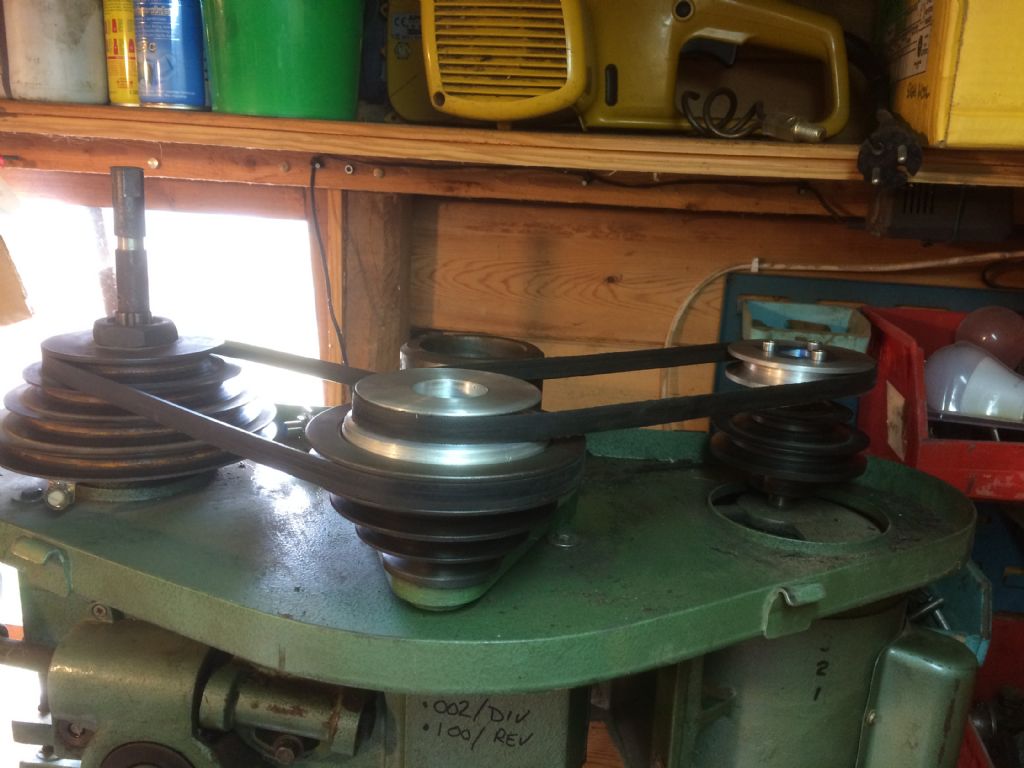

                          Speedy Builder5:
                          I have same machine and, like Mike Poole have the intermediate set to float:
                          I am running from a VFD and don't change often change pulleys
                          Also visible in the photo is my self-extracting draw bar and flywheel on the quill pulley; the latter is very useful for rotating the spindle by hand.

                                  On my Tauco drill with a new motor, yes the belt is jus a fraction too small, the motor mounting bars are fully up to the hilt and there's no adjustment.

                                    Looking at the pics, there does not seem to be a quick-release for the tension on that old machine.
                                    Take care, if the belt is too short – it may be over-loading the bearings.
