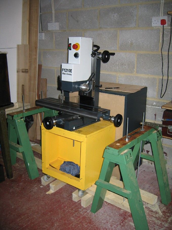

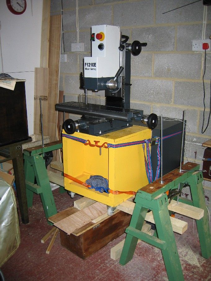

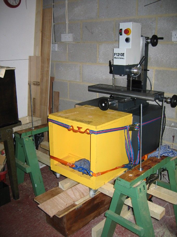

                    I lifted my milling machine by myself. I had a long think about the job and came to the following conclusions:
                    1. Get four friends to help to manually lift it on to the milling machine table. May be quick but expensive afterwards down the pub. Also if things go wrong you may lose a friend or two.
                    2. Hire a small crane or engine hoist thingy. You do not know what you are going, time is limited and you do not of the condition of the lifting straps. Also access was very limited.
                    3. Jack it up into place.
                    I chose the latter. I already had a very robust little wooden table on casters. The mill was slid out of the delivery van and onto the table. It was then bolted to the table. The milling machine table was put in position and bolted to the floor. The wooden table with mill was lifted using two wooden beams, two saw horses and 10mm studding, nuts and large diameter washers. The wooden table was strapped to the milling machine table for peace of mind. Eventually the mill was slid onto its table.
                    It took most of a day.
                    You need to plan everything very carefully before doing such a job. The one thing on your side is time. If you do not like the look of things you can stop and think.
                    A friend moved an old Colchester lathe out of his workshop (an old bomb shelter), up a flight of eight steps and 20 yards across his garden by himself. Next day he did the reverse with his new lathe. While not being a millwright he did work closely with them at work. When asked what he used the answer was knowledge, rollers, stakes, block and tackle and shear legs.
                    All the best with the move.
                    JA
                    Edited By JA on 27/06/2023 13:55:22
