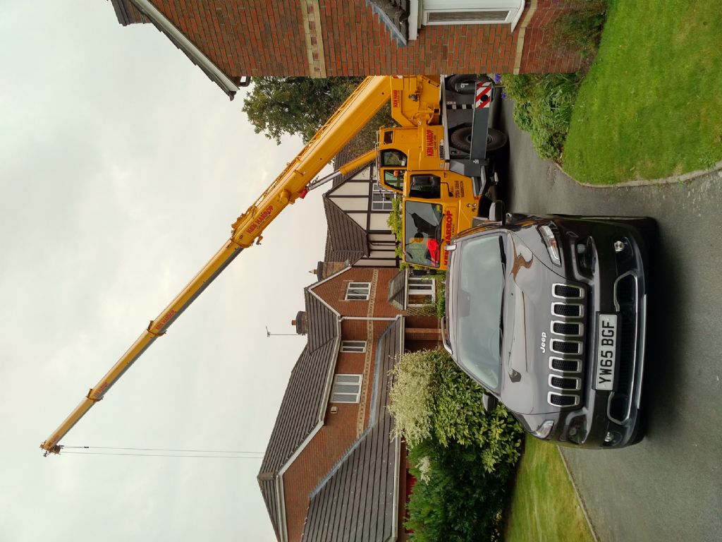

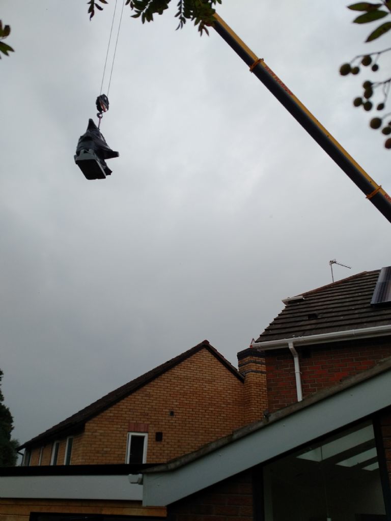

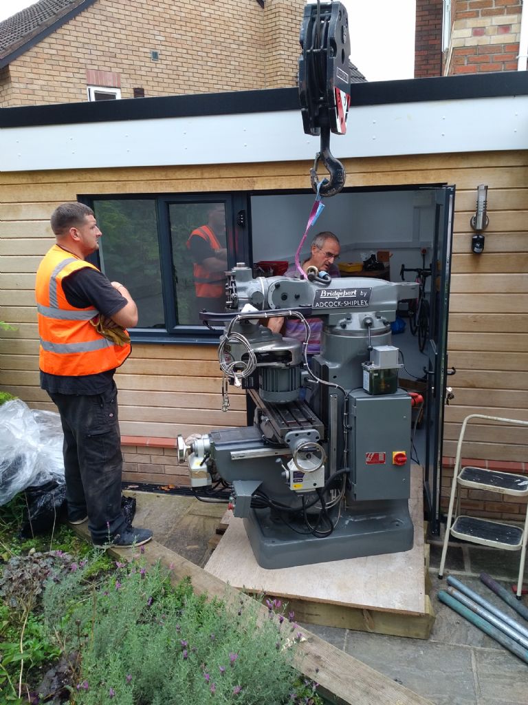

      My Bridgeport came in to my back garden workshop over the house with the help of a 35 Ton crane. The crane operators were fantastic, putting the machine down at the workshop door with tremendous precision.

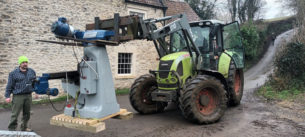

                Thanks to everyone for your input. After reading some of your stories I've had another think. One of the local farmers has agreed to lift it off the trailer for me so I don't need to slide it down the ramp anymore!
