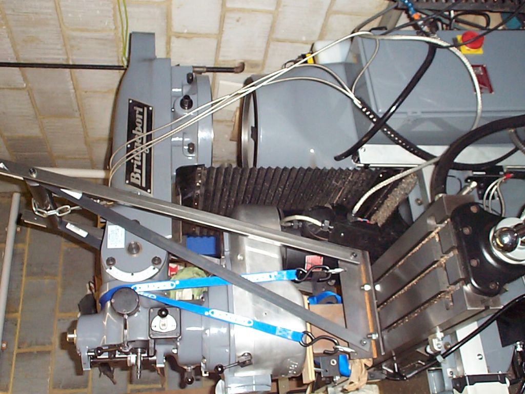

                      BpT Frame
                      Yes definately invert head and lower table. I made a frame with wheels to widen. Bpt bolted down (you can see the 4 holes) When in place the wheels were removed and replaced with screw down mounts to level machine.
                      Next pic shows "crane" used to lift head (still inverted) to fit raising block.
                      Edited By KWIL on 10/01/2022 14:07:25

                        Bpt Head lift

                        colin hamilton
                          @colinhamilton16803
                          Posted by KWIL on 10/01/2022 14:04:10:
                          BpT Frame
                          That is the rolls Royce of solutions!! Thanks for sharing
                          #579592
                          colin hamilton
                            @colinhamilton16803
                            Posted by KWIL on 10/01/2022 14:06:52:
                            Bpt Head lift
                            Is the mill lacking in height?

                              KWIL
                                @kwil
                                Colin,
                                I just needed extra "daylight" for what I wanted to machine. Hence the raising block added an extra 6"
