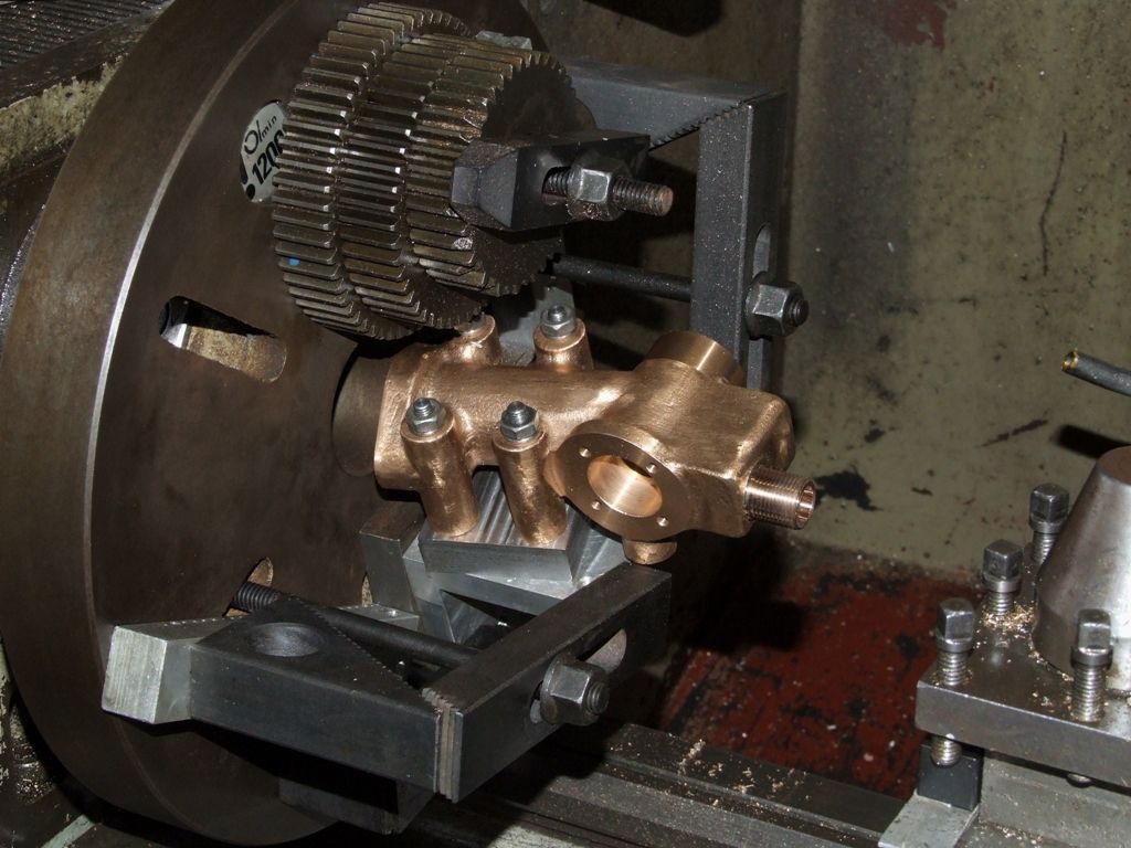

                Nothing wrong with normal clamps and blocks, or anything else for that matter, provided the setup is thought through in terms of what might move under cutting forces. You'll not be running fast, no more than low hundreds of rpm. Here are some examples:

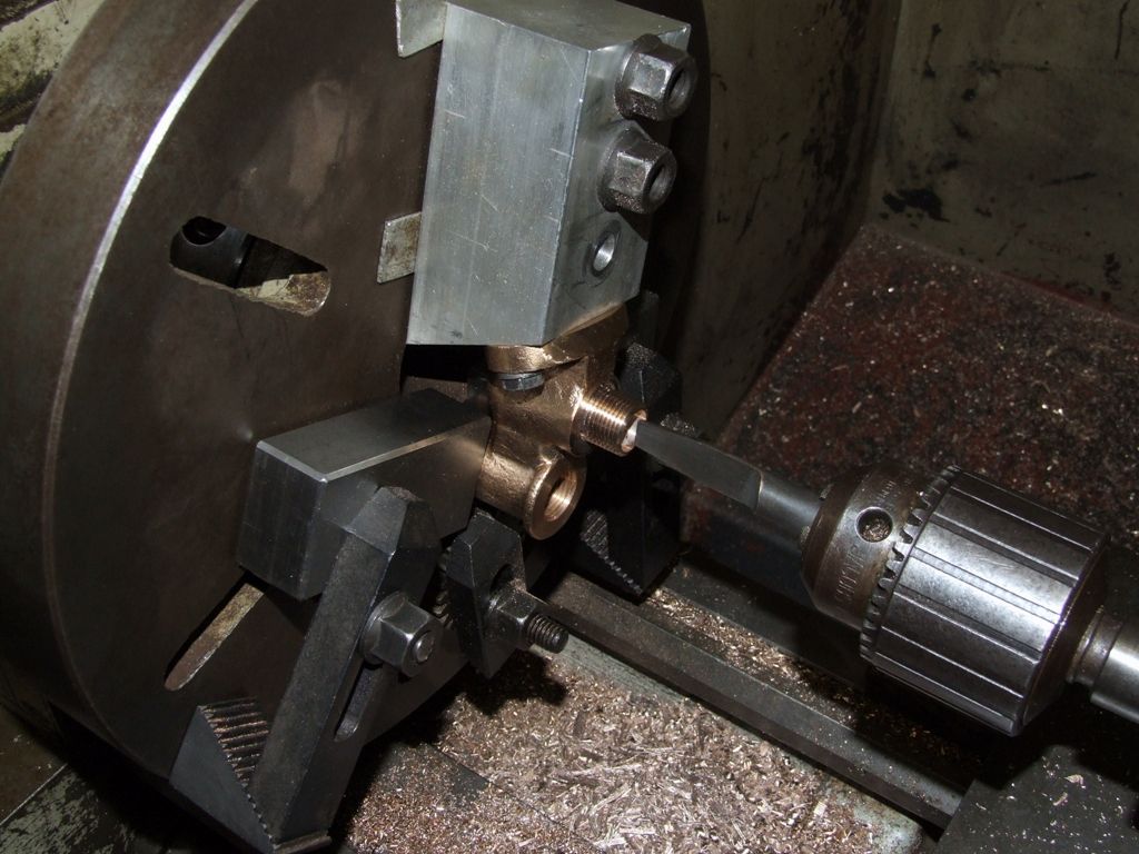

                    Definitely not, large faceplates are not cheap! I use existing slots, but if needed I'll make a smaller plate, or block, to hold the part:

                          If you do make some clamps like the ones Cringle shows then either slot them for the stud or make then so that the distance from stud to jacking screw is longer than the distance from work to jacking screw as this ensures you get more clamping force where it is needed. Also put the bolt/screw head against the faceplate having turned off any code numbers first as it's less likely to mark the faceplate. One thing I did do on mine was to drill the mounting stud holes all the way through and tap them, so you het a few extra options for fixings.
                          Although I have used both this type of clamp and the stepped block type on the lathe the ones with jack screws are safer of things come loose as they will all stay attached to the faceplate unlike the step blocks that could fly off. I also find them a bit easier when setting up on the vertical face of the faceplate as the blocks can drop! always worth having a board on the lathe bed when setting up work on the faceplate.
                          One of the problems with smaller lathes of the imported variety is that the flange mount that they use means the slots can't extend that far towards the centre so either a separate plate to fix to the faceplate with CSK screws or for a job like this ply or MDF would work as it's only a small cut on a 65mm dia aluminium part.
                          The part in question from Cringle's thread

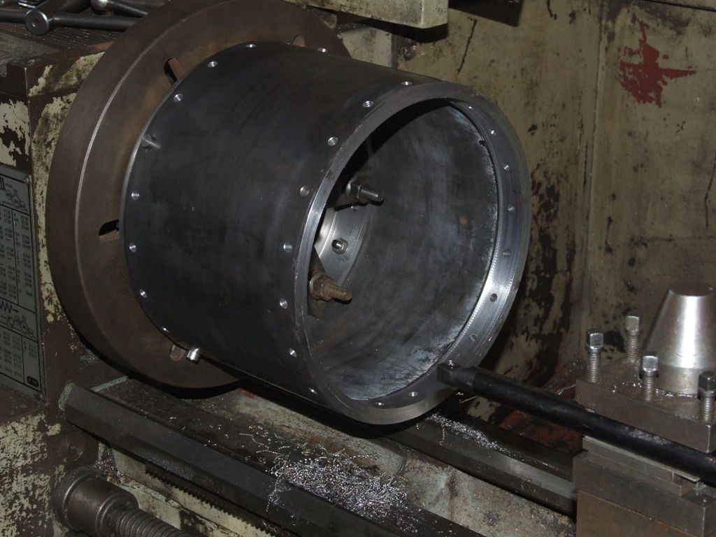

                                    I have seen faceplates that look like a swiss cheese with holes all over which will put the plate out of balance at least, and weaken it significantly at worst. One solution I have often used to the awkward shapes/jobs with holes in inconvenient places problem is to bolt an old brake disc to your faceplate, once you've given that a light skim it will run true and you can drill holes anywhere, even weld brackets to it if necessary- brake discs are made from Meehanite which welds OK with MIG, never tried any other process for this.
                                    You can see a brake disc being used in this photo.
