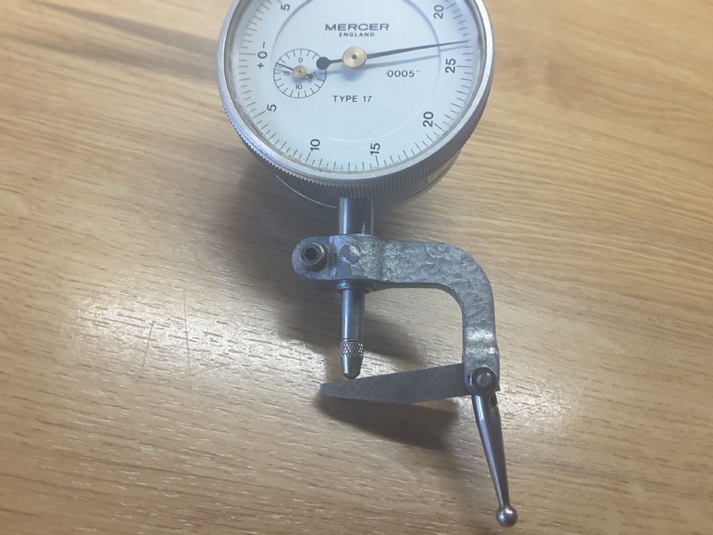

                      #524062
                      David George 1
                        @davidgeorge1
                        I have a simple adaptor which allows you to check slots etc have a look. It is as far as I know from Mercer.
                        David
