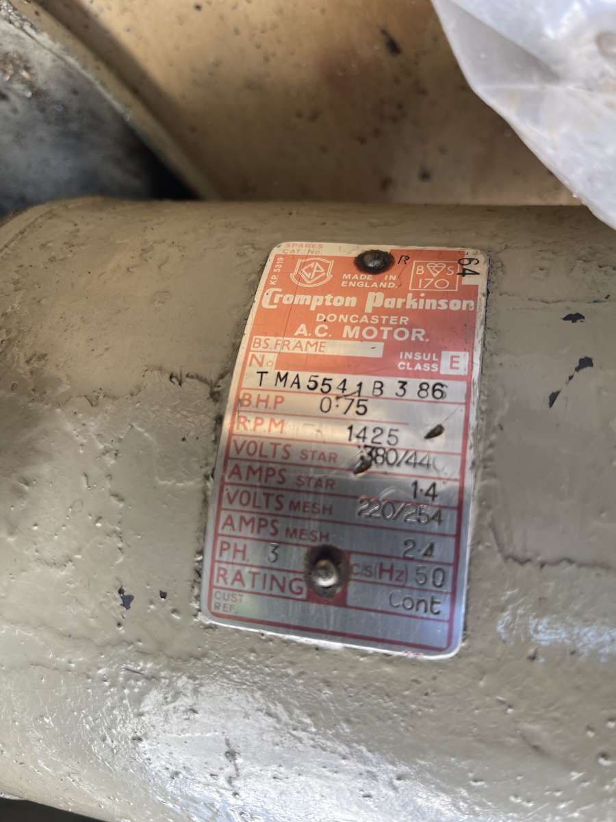

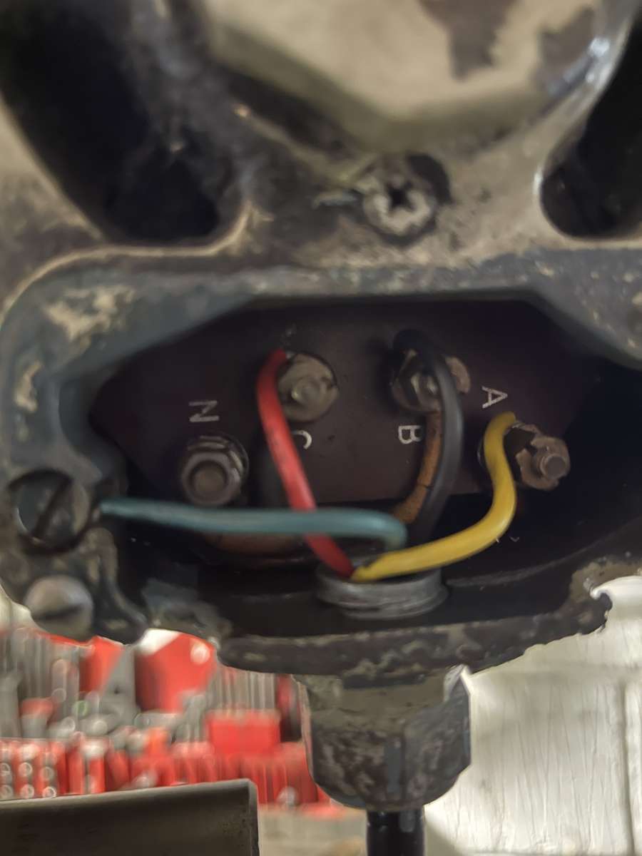

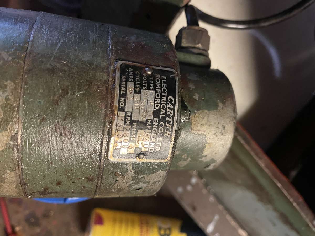

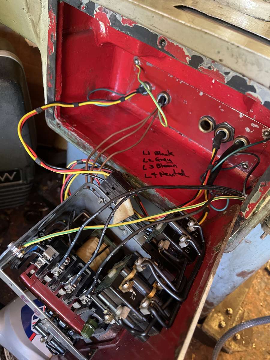

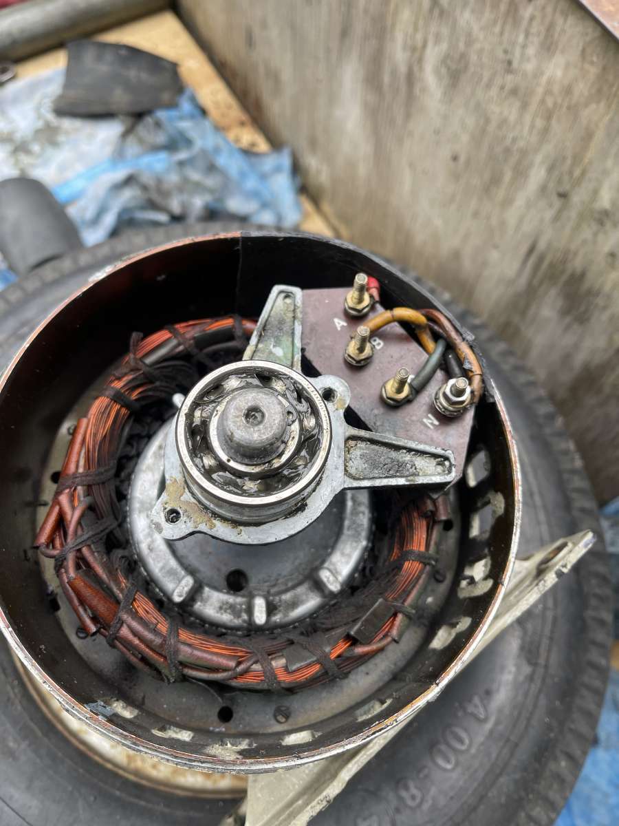

                Hopefully the magic smoke can be avoided, here’s some photos of the vertical motor & the original connections in the control panel marked up A B & C

                  Hard to see in the picture of the motor. Is the brown wire going from B to N? It looks like the yellow earth wire is going to A and the Blue phase is on the chassis! Perhaps the previous owner was colour blind or suicidal.
                  #737478

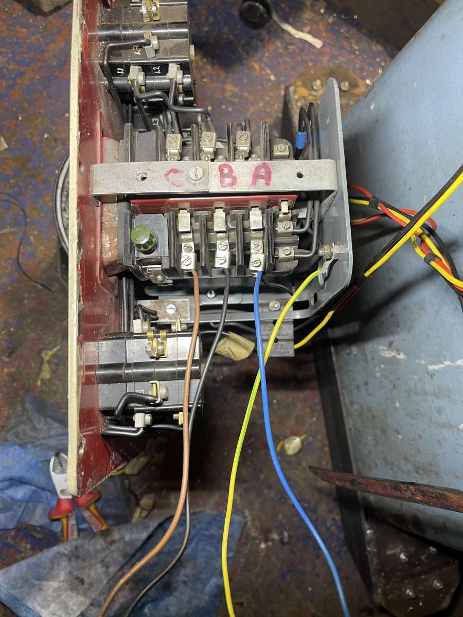

                  45chop
                    @45chop
                    5C744E91-3C38-4BA9-AD2C-17A714B6528E
                    #737484
                    45chop
                      @45chop
                      I think this is star configuration

                        EEEK!
                        Your motor connections are A, B, C for the three phases and N for the neutral, star point.
                        Maybe consider pulling new wires through the conduit in the current, post 2004 standard colours.
                        Pre 1977 flexible cables used red, yellow and blue for phases 1,2,3 respectively and black for the neutral, star point, connection. Earth was solid green.
                        Post 2004 flexible cables use brown, black, grey for phases 1,2,3 respectively with blue for the neutral, star point, connection. Earth is green and yellow.
                        These days if I were putting that converter into service I’d buy myself some 4 or 5 core cable in the correct modern colour codes and replace both the converter output cable and the machine wiring. By modern standards the old Motorun output cable colours are seriously confusing.
                        Having (finally) gotten out of the minimal change bodger habit my practice for the last 20 odd years has been to use 5 way commando plugs at each end of a modern colour code, steel braid re-enforced, flexible connecting cable. Internal machine wire is either old style 3 red for phases, black for neutral and green for earth or re-done in current colours.
                        Not a fan of loose boxes with a fixed cable to the machine.
                        Clive

                          Thanks Clive, So the Motorun I have is already correctly wired with Grey, Black, Brown, Blue and earth in a 5 way commando plug.
                          Grey is the ‘wild leg’, black and brown are the two phases and blue for the Neutral ?
                          Unfortunately I’m still confused as in, does it now matter in how the Grey, Black & Brown connect to A, B & C ?
                          #737503
                          Clive Foster
                            @clivefoster55965
                            Objectively no because the motor input connections are effectively the same because each goes to one end of a motor winding and the other ends are connected together at the star point.
                            In practice I’d stick with the phase 1, 2 , 3 conventions and connect :-
                            Brown to A – as phase 1
                            Black to B  – as phase 2
                            Grey to C   – as phase 3
                            which should leave the motor running the correct way. Interchange any two phase wires if it runs backwards.
                            I have multiple machines so sticking with the convention removes one potential source of confusion if I need to do any electrical stuff. Not such an issue with only one machine.
                            Clive

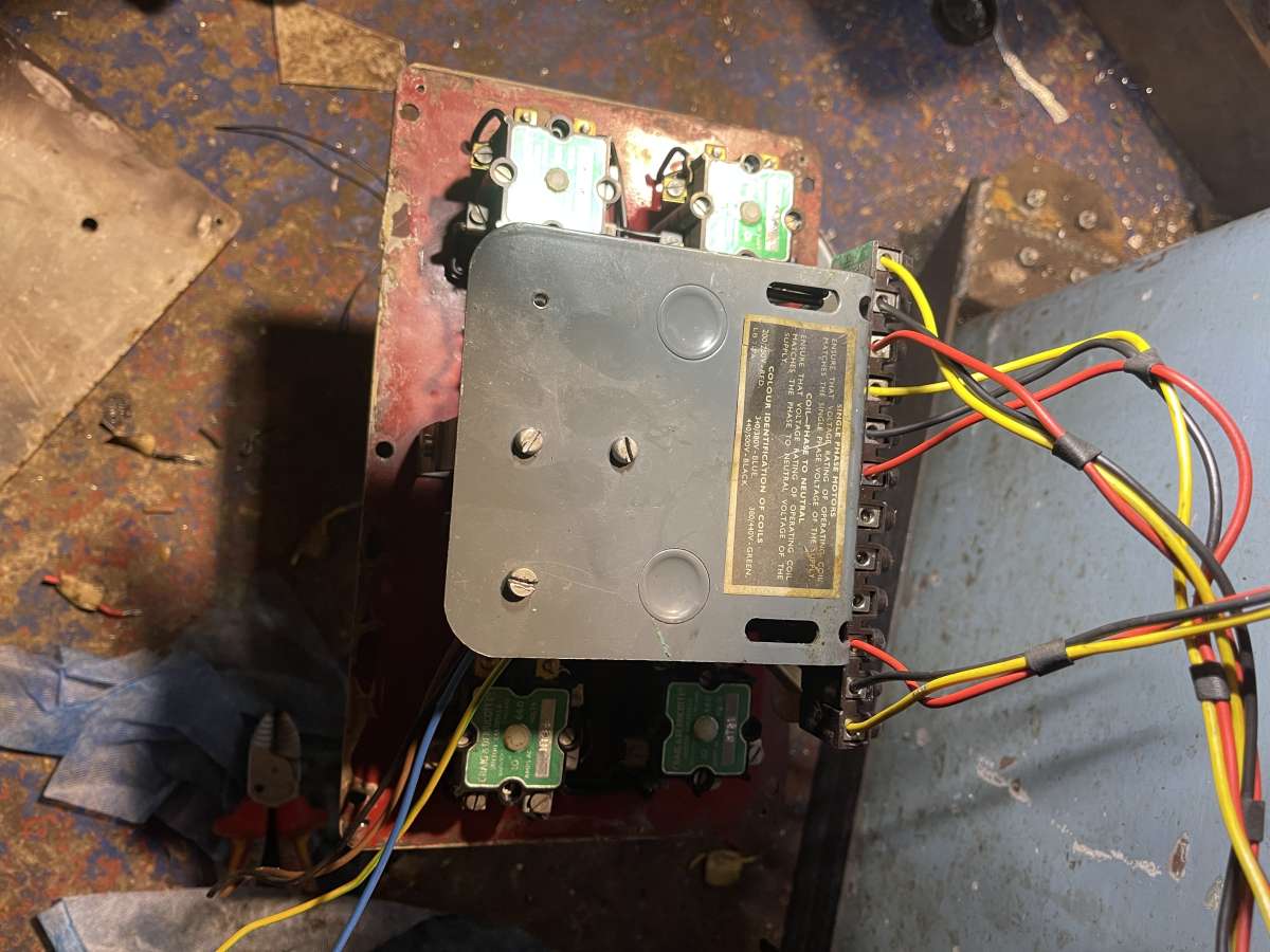

                            #737740
                            45chop
                              @45chop
                              D4A14233-0943-4E23-A5F9-BA9B1F8DC8D31151F8BF-D7C4-411F-8D26-31FEA60EDFAFBA60F4BD-BAC4-40EB-9AF0-7F7BEC75B777Update, not quite there, powered up that I know of, as in the inverter clunks and hums but pushing the contact switch on the control panel doesn’t hold down
                              #737750
                              45chop
                                @45chop

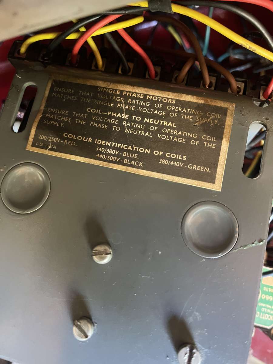

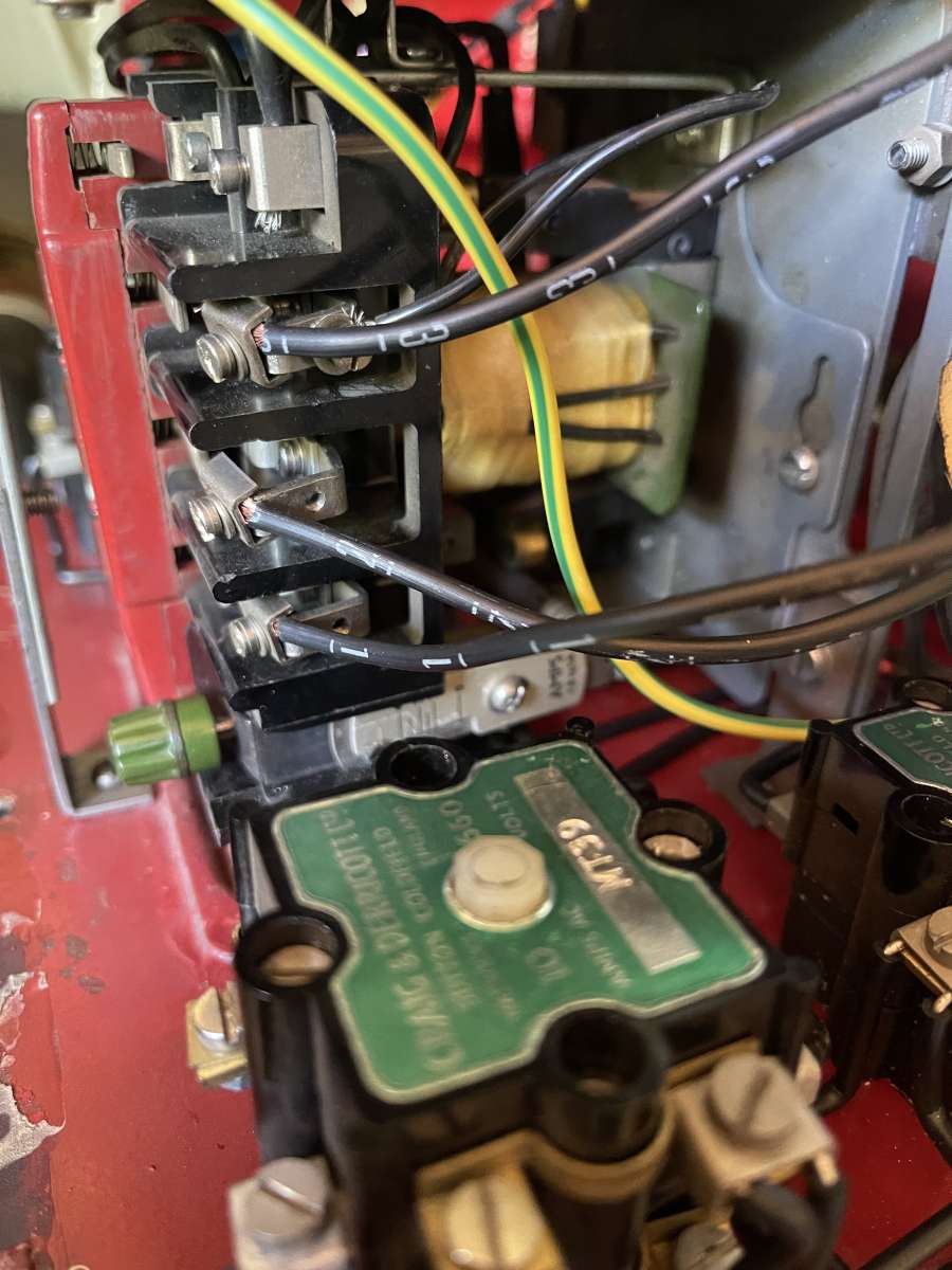

                                Another update, it is working now but the contact coil vibrates, occasionally holds and the motor runs but occasionally won’t hold, switching from overhead to horizontal motor sometimes starts it.

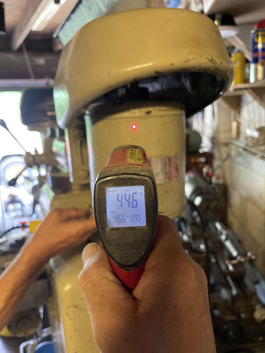

                                #737759
                                45chop
                                  @45chop

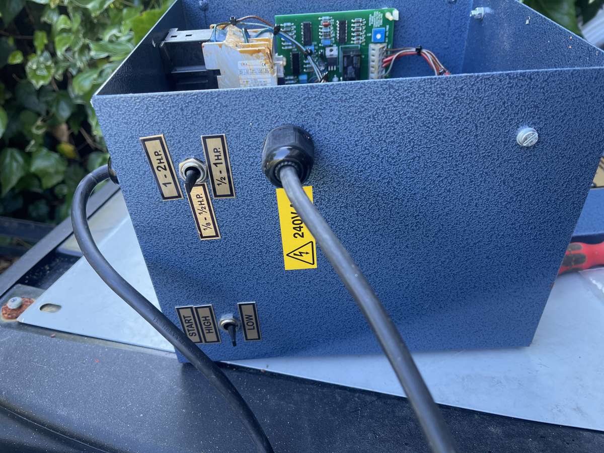

                                  5 minutes running, is it too warm or normal 5661B1B9-80DA-48B9-B8C8-EFA0946363E2
                                  #737765
                                  Clive Foster
                                    @clivefoster55965
                                    On a day like this that temperature isn’t too bad but things don’t sound really right.
                                    Unfortunately I don’t have a circuit for the Motorun unit, or any other commercial one for that matter. Back when I was into such things I hovered up a lot of data from the internet of varying dubiousness but no clear fault finding guides.
                                    When you say contactor buzzing presumably you mean the ones on the machine.?
                                    Your Motorun unit is much newer than mine. Mine simply had big switch to turn it on, no contactor inside just as voltage sensing relay to disconnect the additional capacitor needed for start up.
                                    If it has a contactor inside to do the on/off duties it should be completely reliable.
                                    The relay or contactor used to control the start capacitor should tun on briefly as the motor runs up then release.
                                    Machine contactor chattering is generally due to insufficient coil voltage. Verify voltage and make sure its operating coil goes directly to the mains fed phase, both when operated by the ON button and when running. As I understand things its best to hold the on button down until things come up to speed.
                                    Not problem I ever had.
                                    Lumpy running is due to phase voltage and angle imbalance. You need to find the best switch setting for the additional capacitors used to help create the “wild” leg. As I recall things the best switch setting on mine was rarely what the label and motor rating implied.
                                    The DIY folk tend to advise simple experimentation.
                                    Check the phase voltages supplied to the motor. You should be able to find a switch setting that makes them reasonably close. Never the same.
                                    As I said mine annoyed me sufficiently that it got converted to a rotary style with a permanently connected motor. Much better behaved.
                                    I’ll have look through my literature later tonight when the weather has cooled enough to restore normal brain functions to see if I’ve got anything useful. As I recall it the Transwave folk have some useful stuff on line. Unfortunately most of what comes up on search is American and they do it a bit differently.
                                    Clive

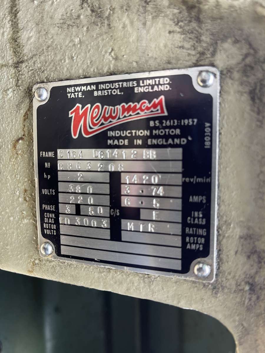

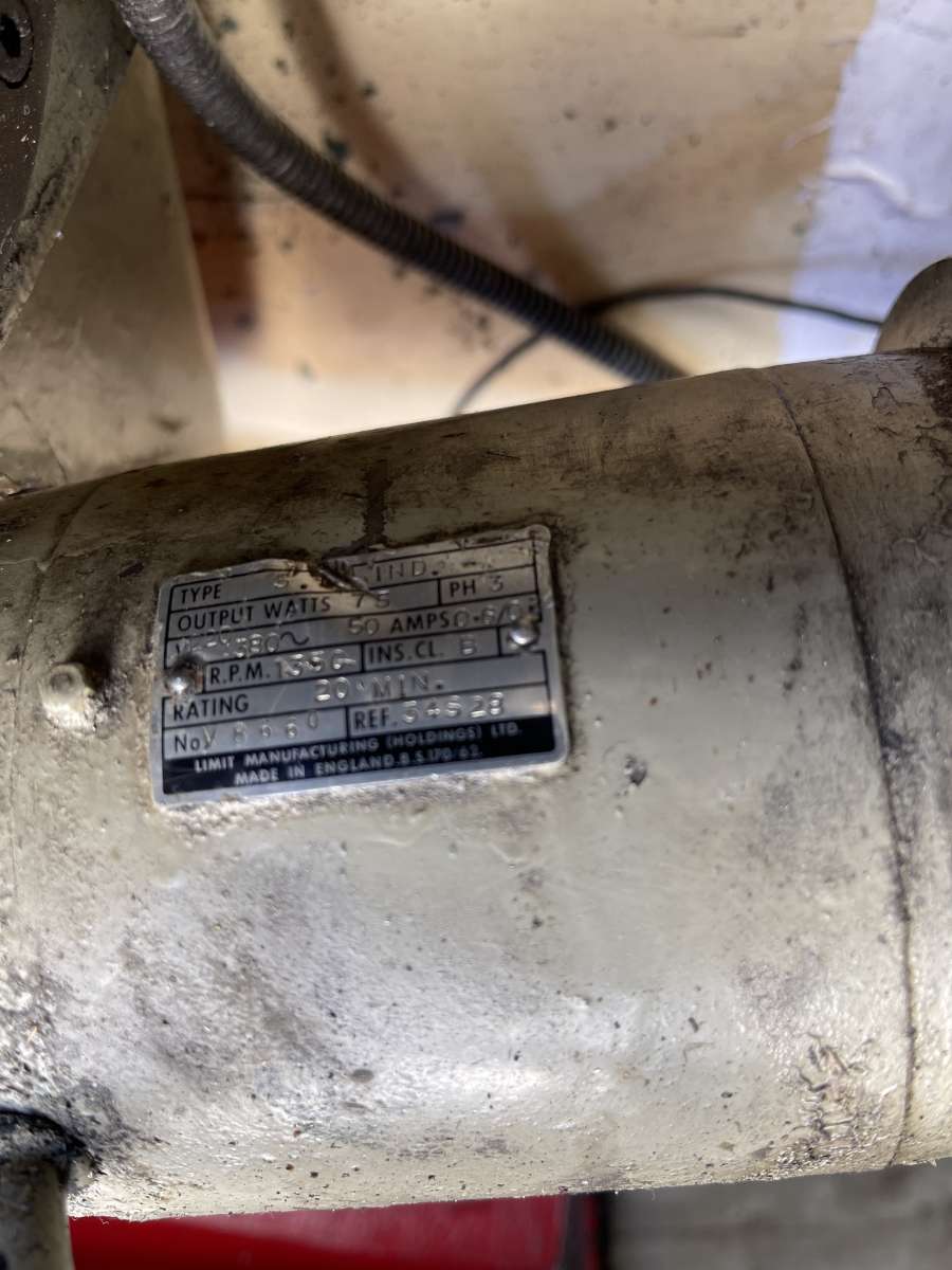

                                        Just a guess because I’m having difficulty relating the wiring in the photos to what I understand of 3-phase motors!   The plates suggest three 3-phase motors.   Two of them support star or delta connection, but the little one (coolant pump), may be star only.   Is it possible the mill is wired in Star, and is intended to run connected to a 440V supply?  At least one photo suggests star, but maybe it becomes delta behind the scenes.
                                        If star, the static converter won’t provide enough oomph to reliably start and run the motors, because a static converter is typically limited to 240 across phases, and further disadvantaged because 2 phases are firmly locked at the wrong angle, whilst the third is faking it!  Although fiddling with the switches generally fools the motor into starting OK, the arrangement is far from perfect, and may not be ‘good enough’.   This is why folk spend the extra money on a pony motor, which does a better job of faking the 3rd phase, and why VFDs are so popular.  The 3 phases output by a VFD are much closer to the real thing than static or rotary converters.
                                        Not much evidence of it, but another possibility is the electrics are set-up to start the motor in star and then and then switch to run in delta.  Unlikely, but that too would bemuse a static converter!
                                        Is the multi-meter able to measure capacitance?   The capacitors used in static converters take a hammering and don’t last forever.  Not unlikely in a second-hand unit that one or more of them is no longer up to spec, in which case the converter may not be able to match to the motor(s).   Symptoms as listed by 45chop, including overheating.   Cure, identify and replace low-capacity capacitors.   If more than one is faulty in an ancient converter, probably wise to replace all of them.
                                        Going back to the star/delta uncertainty, knowing how the mill was connected before purchase might help.   Wired industrially to 440 3-phase, or run from a static converter, or what?
                                        If it were me, I’d trace the entire circuit, paying particular attention to the motor windings.   If they’re star wired, the fix is to reconnect in delta.

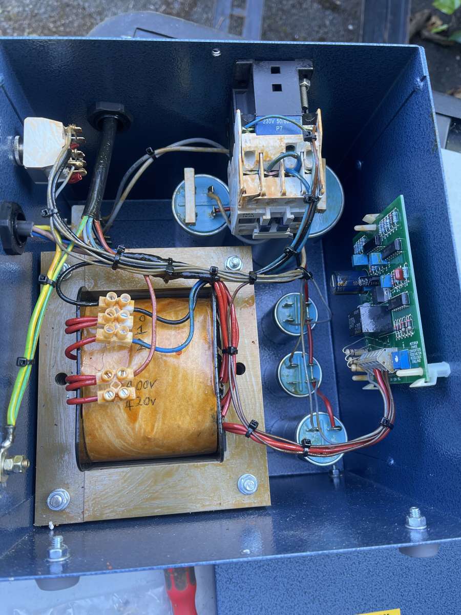

                                          Hi Clive, buzzing/chattering from the control panel contacter coil. There appears to be a spring loaded adjustment, which when set at it’s loosest position (4amps) allows the motor to start with the least buzzing/chattering.0E53B8D9-6209-4532-99BC-11134440CA9C
                                          #737796
                                          Clive Foster
                                            @clivefoster55965

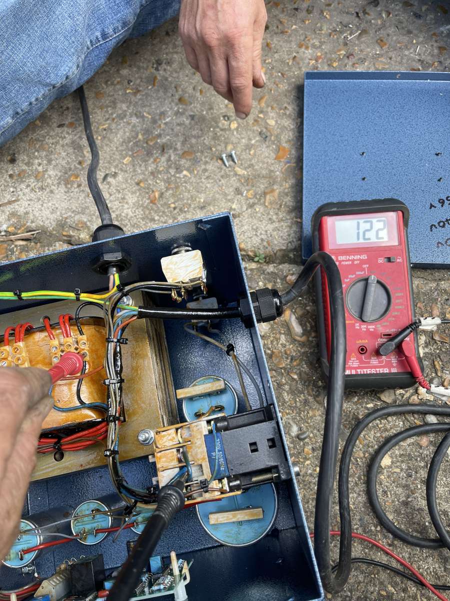

                                            The Motorun static converter has an autotransformer converting the 220 volts mains to 440 volts so that it can be used on star connected motors.
                                            Mine worked fine except that I was never happy about the phase voltage imbalances.
                                            45chop
                                            That spring loaded knob is the overload setting. There is a bimetallic temperature sensitive switch device in the output power feeds. If the motor draws too much current the bimetallic switch heats up and breaks the coil circuit causing the contactor to release and turn the motor off before it gets damaged. Generally take a couple of seconds to react so the short term high start up current goes through OK.
                                            As you have it wound up to maximum there is clearly far too much current going through on one, or more, phases during start up.
                                            I’d try disconnecting the motor after the contactor and see if it operates OK on its own. This will confirm that the coil is correctly connected to the mains fed (via the auto transformer) phases.
                                            My money is on the phase currents being seriously out of balance due to incorrect capacitor values.
                                            Clive

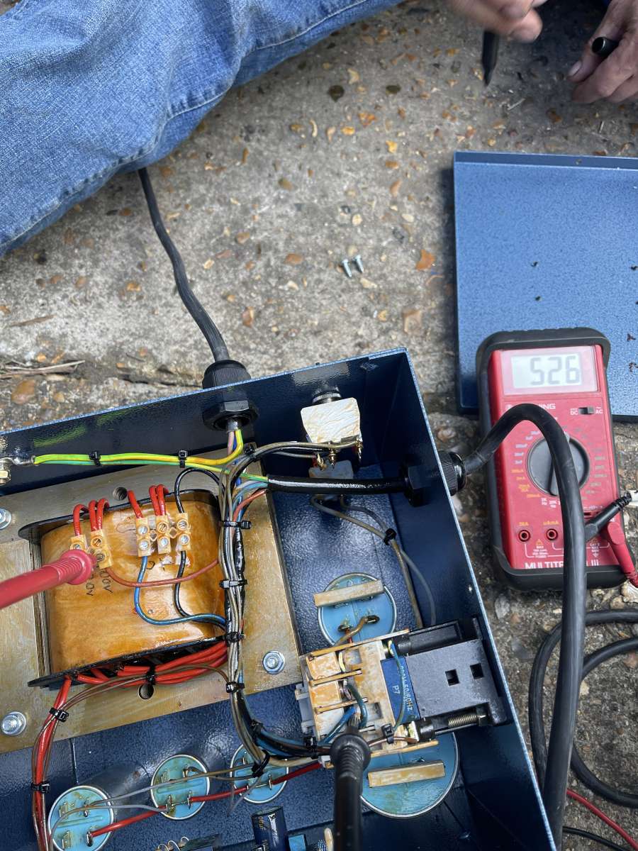

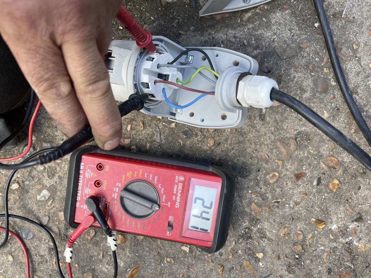

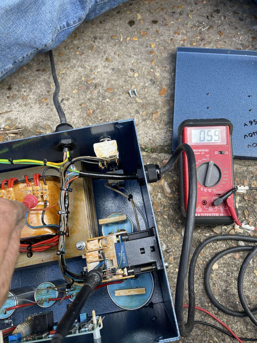

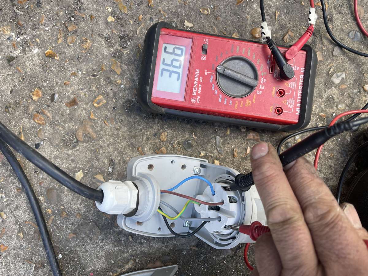

                                            45chop
                                              @45chop

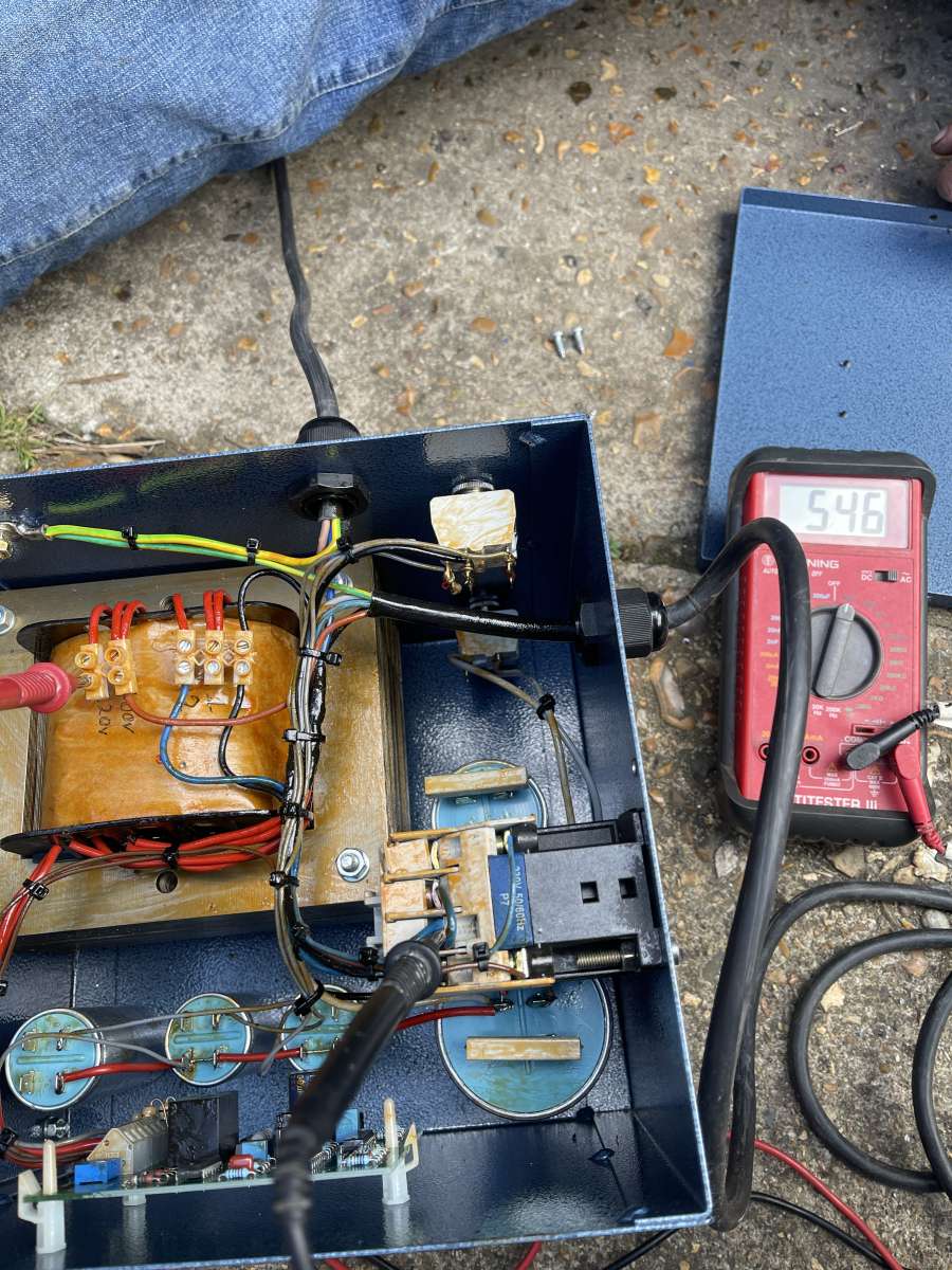

                                              Hi Clive,

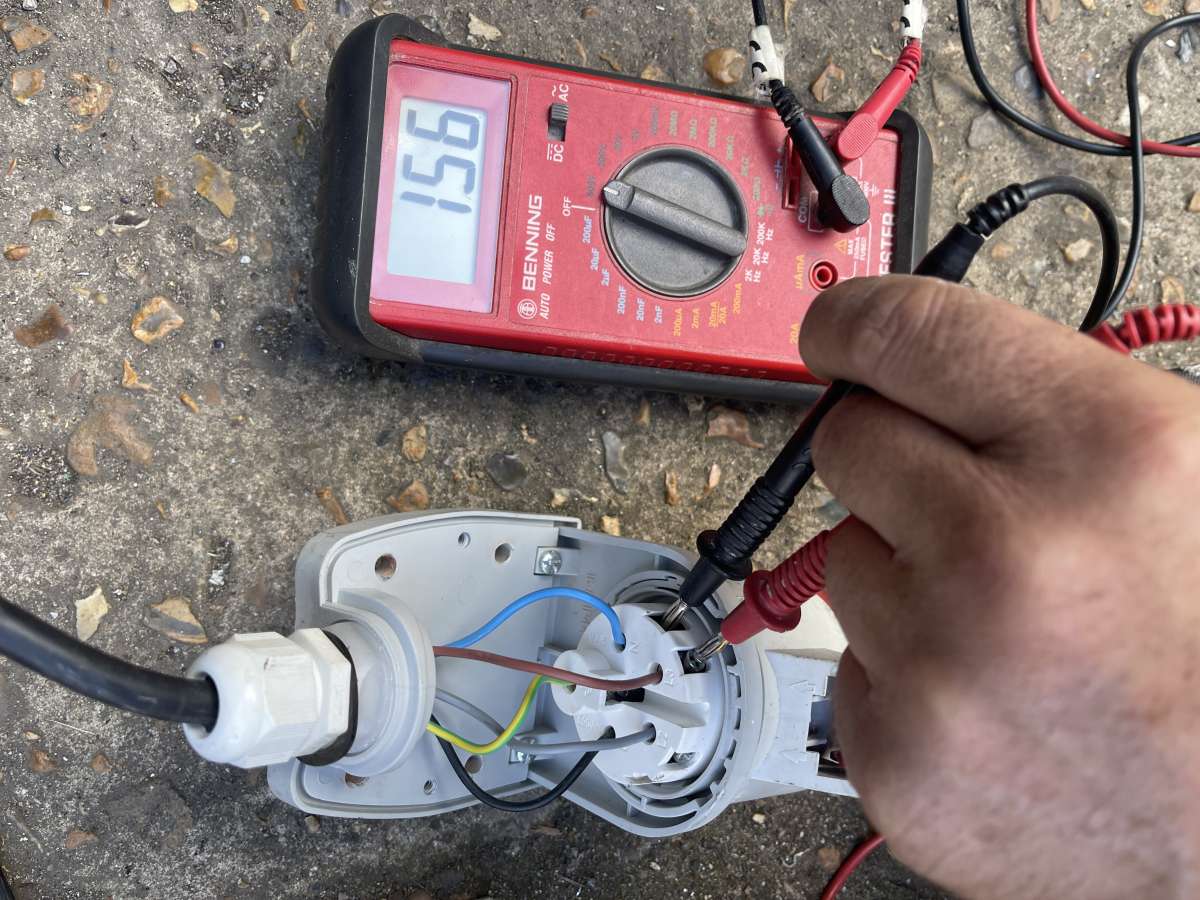

                                              Is there anyway of measuring those voltages ? When I measured the output on the plug, I got what seemed to me some odd readings but then, I really don’t know about 3 phase.A80CFF21-EA86-4A6A-BDB7-C01191B90A395C013D38-B097-48A5-A18F-E039176D06ED1107E189-FDAB-4307-8F52-2B5ACE7FA407
                                              #737806
                                              Clive Foster
                                                @clivefoster55965
                                                Result, sort of.
                                                The wild leg is way, way out of balance.

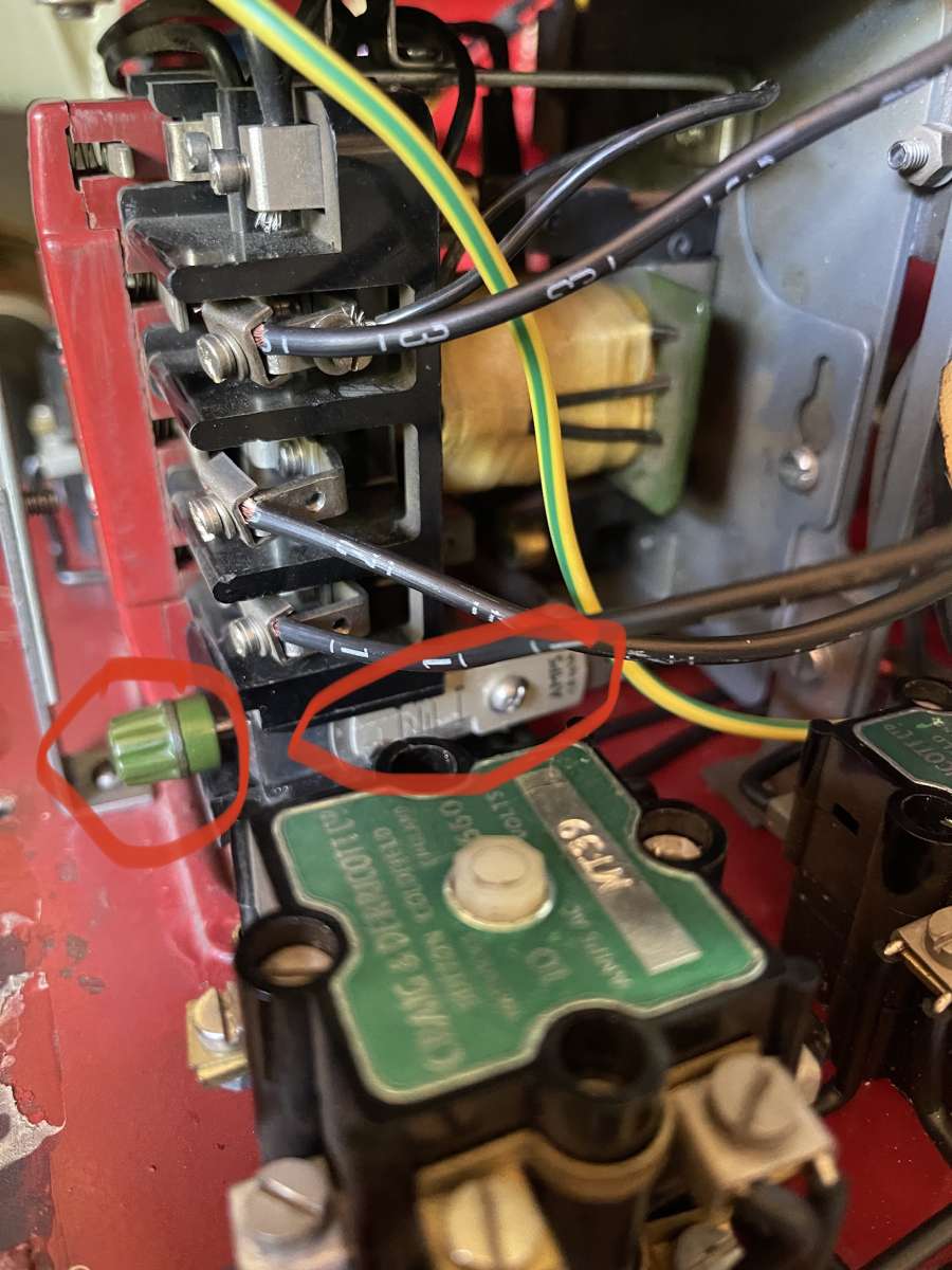

                                                I notice from one of your earlier pictures that the wires from the contactor to motor are marked 1, 2, 3 which helps identify the phases
                                                To recap :-
                                                Brown is phase 1 which should align with wire numbered 1
                                                Black is phase 2 which should align with wire numbered 2
                                                Grey is phase 3 which should align with wire numbered 3
                                                Blue is the neutral which your machine doesn’t use so shouldn’t be connected anywhere. Take it to the commando plug but nothing on socket.
                                                In an earlier picture you have blue going to one contactor connection. So you have 2 phases and neutral on the contactor not 3 phases.
                                                Replace the blue with the grey wire and all should be well.
                                                When its running you should see around 200 to 240 volts between any pair of the phase wires ie :- brown, block , grey
                                                Clive
                                                #737820
                                                45chop
                                                  @45chop
                                                  Hi Clive,
                                                  Incredibly, I’ve managed to get the polar opposite of your suggestion ! The earlier photos with blue wire is as I purchased the machine and definitely hasn’t helped me in the slightest. I have terminated the neutral where it enters the control panel. I’ll try swapping out the order of the Brown, Black & Grey tomorrow, I’ll also reset the thermal cut out back down to 3 1/2. If I do find the voltage measurements across the coils to be wildly out of kilter,  what would the preferred course of action be ? I’ve read a little bit about 3 phase VFD, would that be likely to work or will I need to go down the route of a rotary inverter conversion ?

                                                    Clive is right about the adjustable knob, it is the overload protection and should be set to the motor Full Load Amps as per the data plate on the motor. Neutral is not used in this application so leave unconnected. Brushes and Commutator ? I thought this was an induction motor ? Good Luck. Noel.

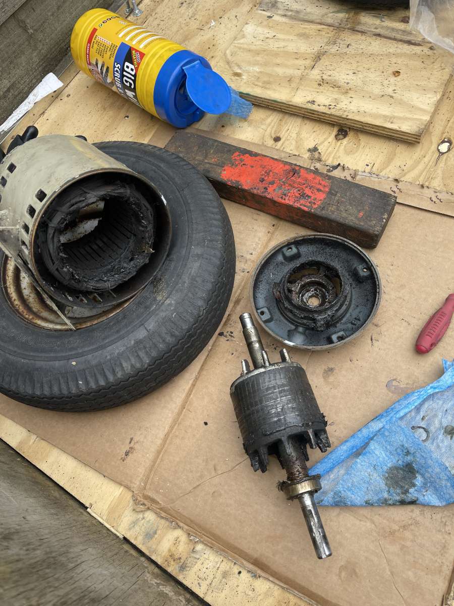

                                                    #738479

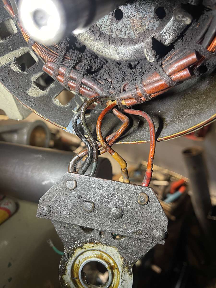

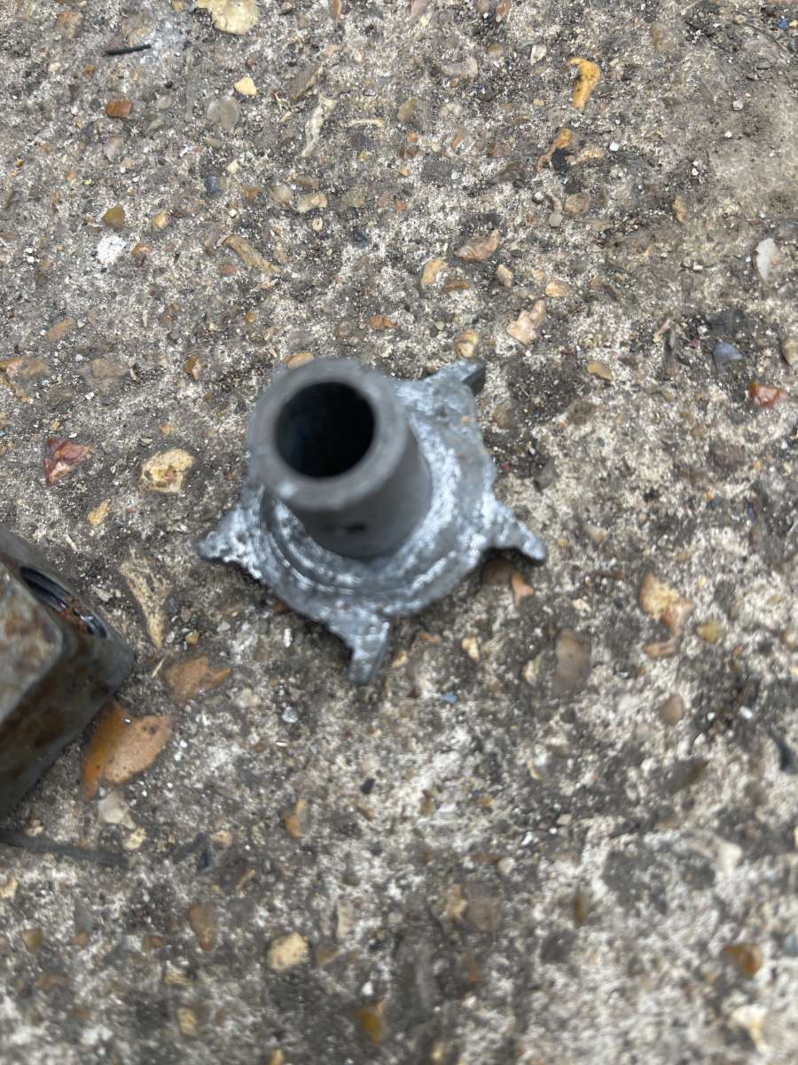

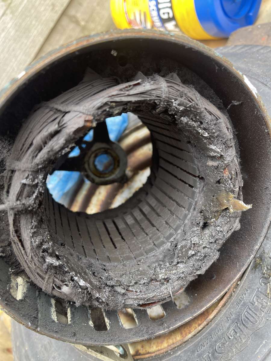

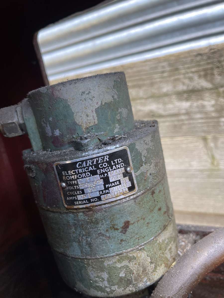

                                                    45chop
                                                      @45chop

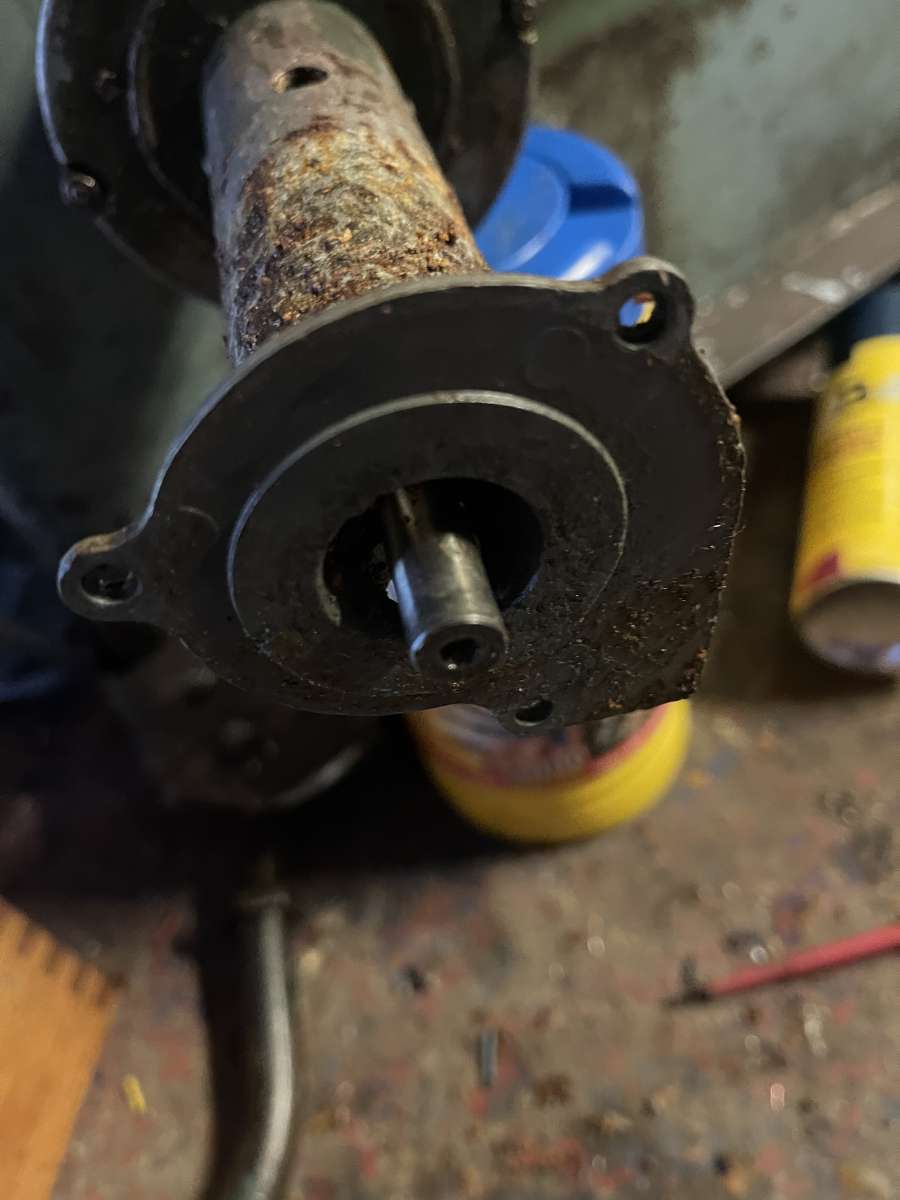

                                                      Did a little bit more work today, motor was filthy. Coolant pump impeller has rotted through and won’t lift the coolant more than  a foot. 2E089A6D-F133-4F2F-B849-AD385870BD8B9275FC30-6C66-4F62-BC8D-9278251183A984C7782D-CF2F-4180-A90B-E22FCD2CAEF31265F987-D463-425E-B74E-A4FA276493A9706D07E3-5AF1-40CE-9D0A-3F59E52DDD2B2D370136-0F27-4E92-A3D9-46F60B7533B8
