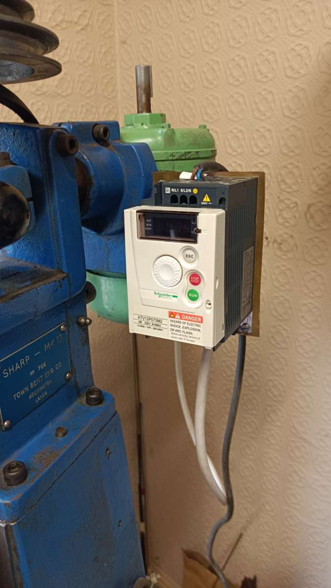

                                  #727805
                                  chrismac
                                    @chrismac
                                    I already have a 900W 2 pole 3 phase motor with a spindle speed of 2850.   I have now fitted a Schneider ATV12 750W controller which, with the current pulley system and no belt shifting, gives me 200 – 3860 RPM at the spindle with the motor RPM reaching 3000.   I intend to remove the two belt pulley system and use just a single belt from the mptor to the spindle.  Fortunately I have a digital tachometer with an optical sensor so measuring RPM is easy, just a piece of tape sticking out from the rim of the pulley.  So now I have a conversion chart for reading on controller to spindle speed.
                                    Schneider-controller
                                    I like the warning notice on the controller, ‘Hazard of electric shock, explosion or arc flash’!
                                    Again, many thanks for all your help.  Chris
                                    #727835
                                    Robert Atkinson 2
                                      @robertatkinson2
                                      Hi Chris,
                                      You need to get the VFD into an enclosure or you will see arc flash when (not if) a bit for swarf hits the wrong bit.
                                      The unsupported cables are poor too.
                                      Robert
                                      #727907
                                      chrismac
                                        @chrismac
                                        A suitable ventilated enclosure will be fitted once the DRO display is incorporated into it.  Ditto cable shortening and tidying.   If I decide to use an RJ45 remote display then the ATV12 can be hidden if not then the front panel must be exposed.
