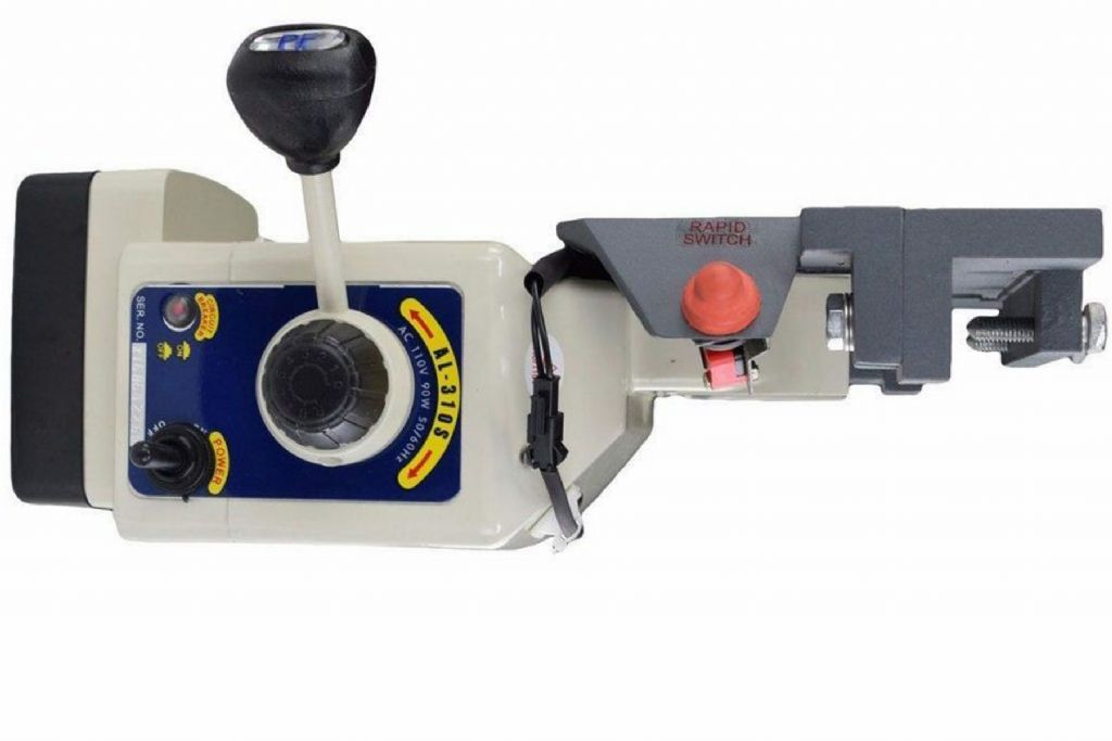

                You could adapt a power feed unit for a milling machine. Mains powered, forward and reverse function and variable speed. Do a Google search on the web and ebay for suppliers.
                Paul.
