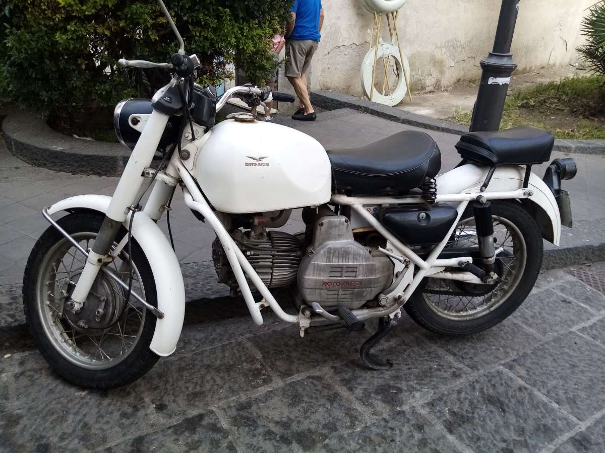

                            Just to honour the title of this ‘Topic’ … Let me present this [spotted by a friend on his recent visit to Sicily]:
                            IMG_20240529_172254
                            We are both intrigued by the presence of a life-belt, at least 2km from water … but the bike is a gem, for sure.

                              ^^ Very nice. Cute little 2LS front brake and all.And that dicky seat…

                                  I always fancied a Moto-Guzzi Falcon except for the final model like the one shown. It did take safety a bit far. Doubt if many were hurt by the exposed flywheel.
