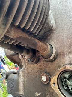

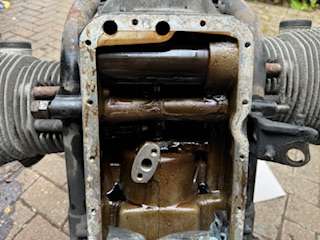

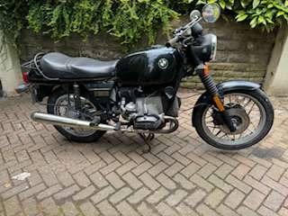

                                          Decided i wanted another bike after a period of not having one so looked around for a airhead bmw found this one fairly local
                                          IMG_5954
                                          It started and ran sounding very nice everything electrical seems to work but the clutch was stuck to the flywheel and no amount of bumping the bike in gear with clutch lever pulled in would free it off
                                          I did want a project so stripping it down was the answer within 6 hours of getting it home it was stripped to its component parts..it looks a lot rougher in bits..its only done 35,000 miles and its a 1984 bike …i think its spent its life outside.
                                          one issue the engine and transmission is held into the frame with only 2 studs one came out easily the other no way i had to cut through the stud at both sides…luckily theres a 6mm spacer between the frame and block but now how to remove the stud
                                          IMG_6028IMG_6029
                                          This stud goes through the sump
                                          IMG_5986
                                          Any bright ideas on how to get this out?

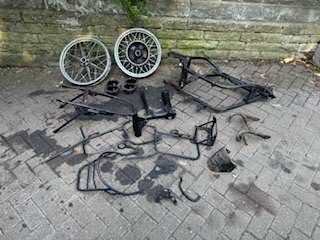

                                          took lots of parts today to be blasted and powder coated
                                          IMG_6022
                                          #737187

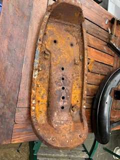

                                            Have you ever seen a rustier seat base?
                                            IMG_6018

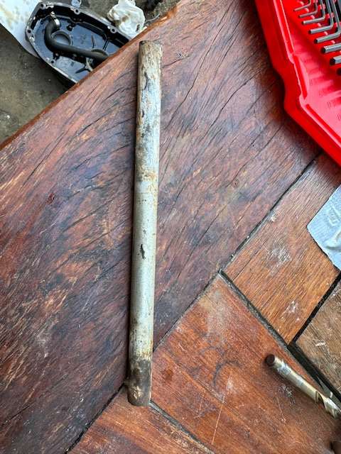

                                            And rusty pushrod tubes
                                            IMG_6029

                                              Looks like a nice old bike. I have an 81 R100RS and had a few other Airheads over the years. The Achilles heel seems to be the transmissions, especially if left unused in a wet environment and moisture gets into the oils. Gearbox and bevel drive bearings get rust on them and chop out quickly under load. Some of the bearings are BMW only specials and you have to pay the BMW price! So it is worth changing the gearbox, driveshaft and bevel oils annually or every 5000 km with the engine oil. And seal up around where the speedo cable enters the gearbox with Silastic and put a zip tie around the rubber boot to stop water running down there.
                                              Rusty seat base is standard for some reason. Maybe they did not paint them from the factory?
                                              Removing the corroded in stud across the engine will probably need heat from a propane torch and blast it with releasing fluid of your choice a few times, then a drift and hammer.
                                              Likewise, if you get to changing transmission bearings etc, heat the cases to 100C with a propane torch so the races fall in and out without wearing out the hole they fit in. Ditto wheel bearings.
                                              Lots of good Airhead sites on the net with plenty of info if you look around. Qute a community of enthusiasts worldwide and a massive accumulated knowledge base.

                                                I was thinking about a sash clamp across the engine pushing on the stud and a socket at the other end to allow the stud to exit then as hopper says warming the stud tunnel…how hot can i get the tunnel without affecting the integrity of the rest of the engine?
                                                and plus gas liberally applied to the ends of the stud
                                                #737244
                                                Circlip
                                                  @circlip
                                                  Cut centre of stud out of crankcase and using hydraulic fluid and a valve compressor push  the stubs out individually. Trying to push out with a sash cramp or similar over the whole width of the case is going to risk  a new crankcase. Heat and fluid works wonders. Copper slip to replace is good. Electrolytic corrosion is a pain.
                                                  Regards  ian.
                                                  #737251
                                                  Hopper
                                                    @hopper
                                                    Generally, impact will work better than a steady clamping force. Hammer and drift should do it. You can heat the casing to 100C safe enough (AKA spit-sizzling hot.)  Gearbox and bevel casings can go up to 200C if you have a tight bearing etc, so I think 100C is pretty conservative. Probably won’t need that much as the ally will expand a lot faster than the steel stud. Sometimes a few heating and cooling cycles plus blasting with release oil etc will help to break the layer of corrosion loose that is jamming it up.
                                                    If worse comes to worst, you could try drilling out the stud from either end. Not fully, but a good sized hole down the middle can sometimes relieve the pressure on the OD and let things break lose.
                                                    #737291
                                                    Ian Parkin
                                                      @ianparkin39383

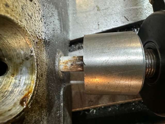

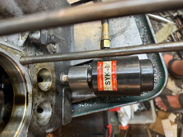

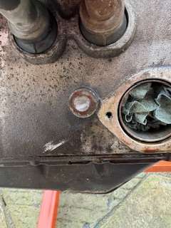

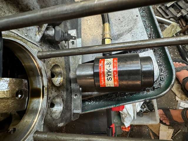

                                                      IMG_6035IMG_6036IMG_6034IMG_6033Well its out after too many hours messing around
                                                      i had tried drilling with a hand held drill but its a tough stud and even my cobalt drills didn’t want to work..
                                                      so i manoeuvred it into the workshop and installed on the big drill press and drilled (with difficulty) a 8.5mm hole and tapped that m10 then i have a hydraulic cylinder for a metal punch kit and i made adapters to suit everything.
                                                      it was very hard work but it eventually gave way.then i put a length of all thread in and pulled it out..its 7 inches long and fought every step of teh way…
                                                    Viewing 25 posts - 1,076 through 1,100 (of 1,161 total)
