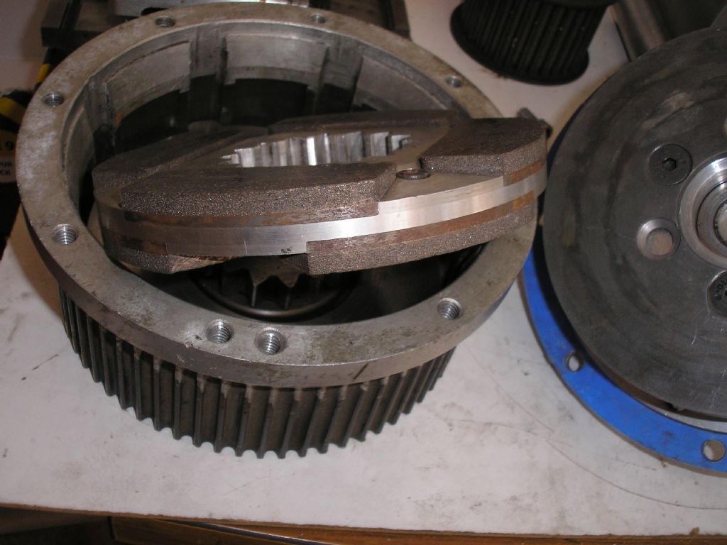

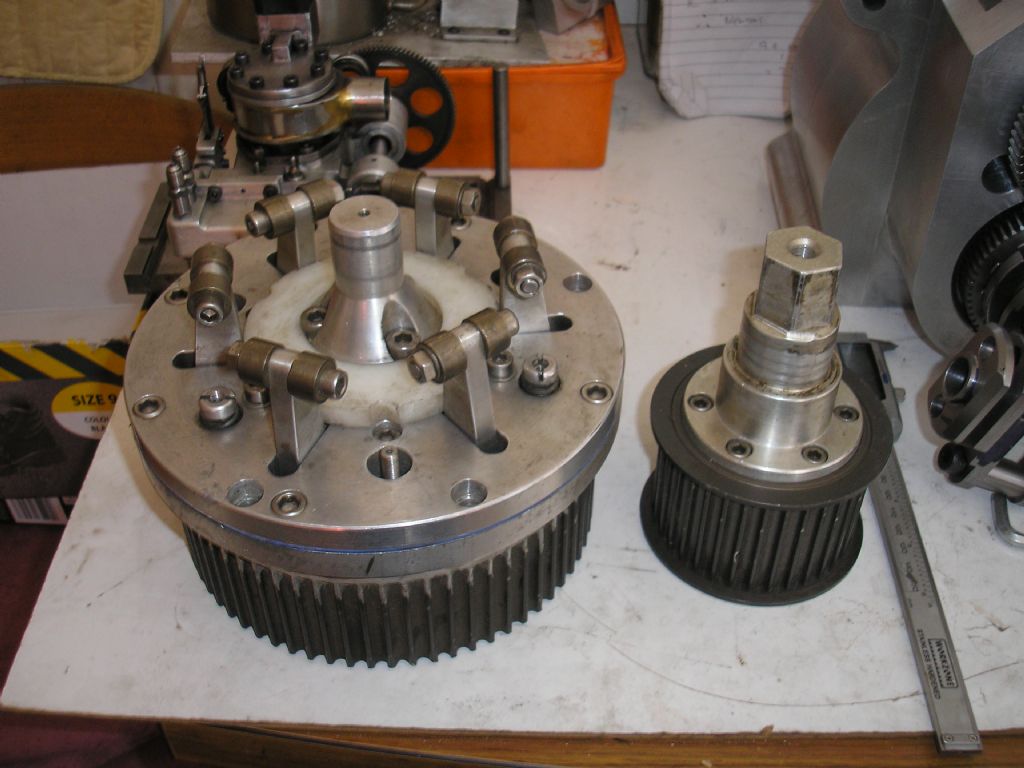

                              #420758
                              Windy
                                @windy30762
                                At the July Top-speed Elvington speed attempts was given a centrifugal clutch for my project by my steam rocket friend.
                                I may not use it but it has given me ideas for my own design this one has a wide toothed belt drive that I will not use.
                                Looks like brake pads have been used for the friction plate.
                                Have been on the web for friction materials to make my own friction plates but most seem to be just offering a lining service.
                                Anyone know where I can buy just the material I would prefer bonding but will probably rivet the linings.
                                Could just do cheque book engineering and have a custom one made but that is not my scene.

                                    Thats a weird looking friction plate.
                                    Last time i looked inside a high hp centrifugal clutch i seem to remember multi plates and springs.
                                    Yours has 5 or 6 springs but how many plates?

                                      Posted by thaiguzzi on 25/07/2019 06:05:23:
                                      I was given the clutch to consider for my project I don't think mine will be a high HP machine like the machine the clutch was used on .
                                      The springs do not push the pressure plate onto the linings but hold it clear. A combination of the centrifugal bob weights and the holding springs decide rpm the clutch engages.
                                      As a test I run it on the lathe and it all seemed to work.
                                      Will consider a few more friction discs etc.there are a few friction materials to choose one has an aggressive engagement others more gradual.
                                      I was wanting a centrifugal clutch the one they use on smaller engines don't seem suitable.
                                      A variable speed transmission I would have liked instead but too much transmission loss.

                                        Those friction discs look a bit like sintered bronze, but if they are used dry, they are probably based on sintered metal brake pads.
                                        #420990
                                        Windy
                                          @windy30762
                                          They are not sintered bronze but are based on car brake pads.
                                          An acquaintance who was a brake tester at Mintex and is still involved in the car rally scene said they look like a pad he has fitted to many cars.
                                          Will check with him as I think there rear Escort pads that have been machined to fit

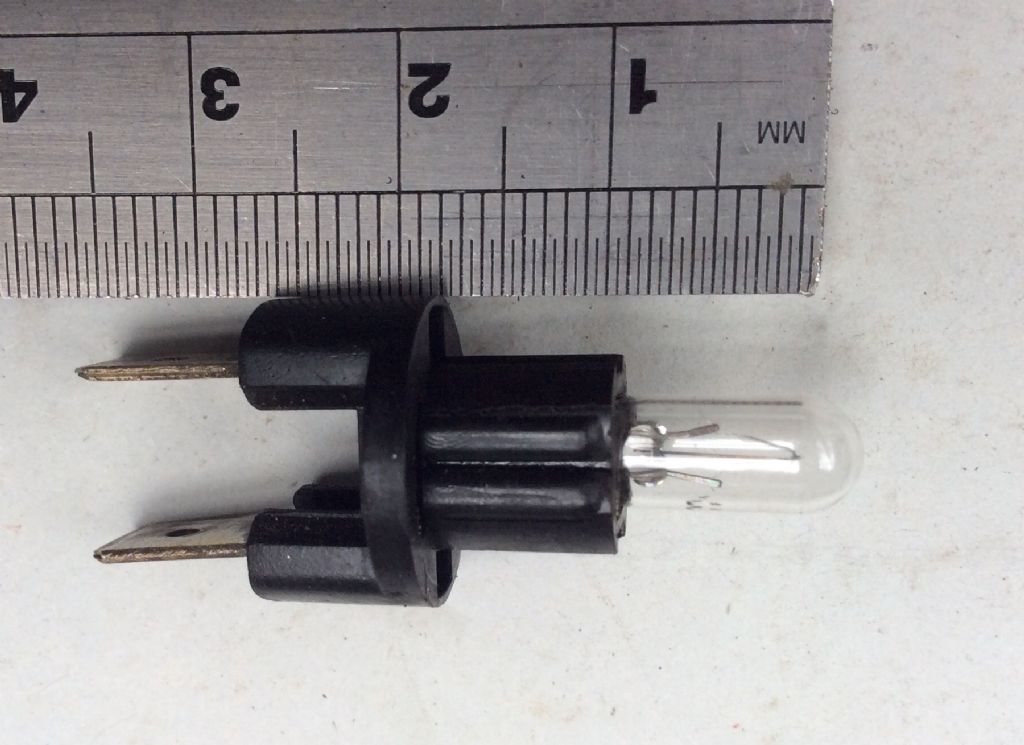

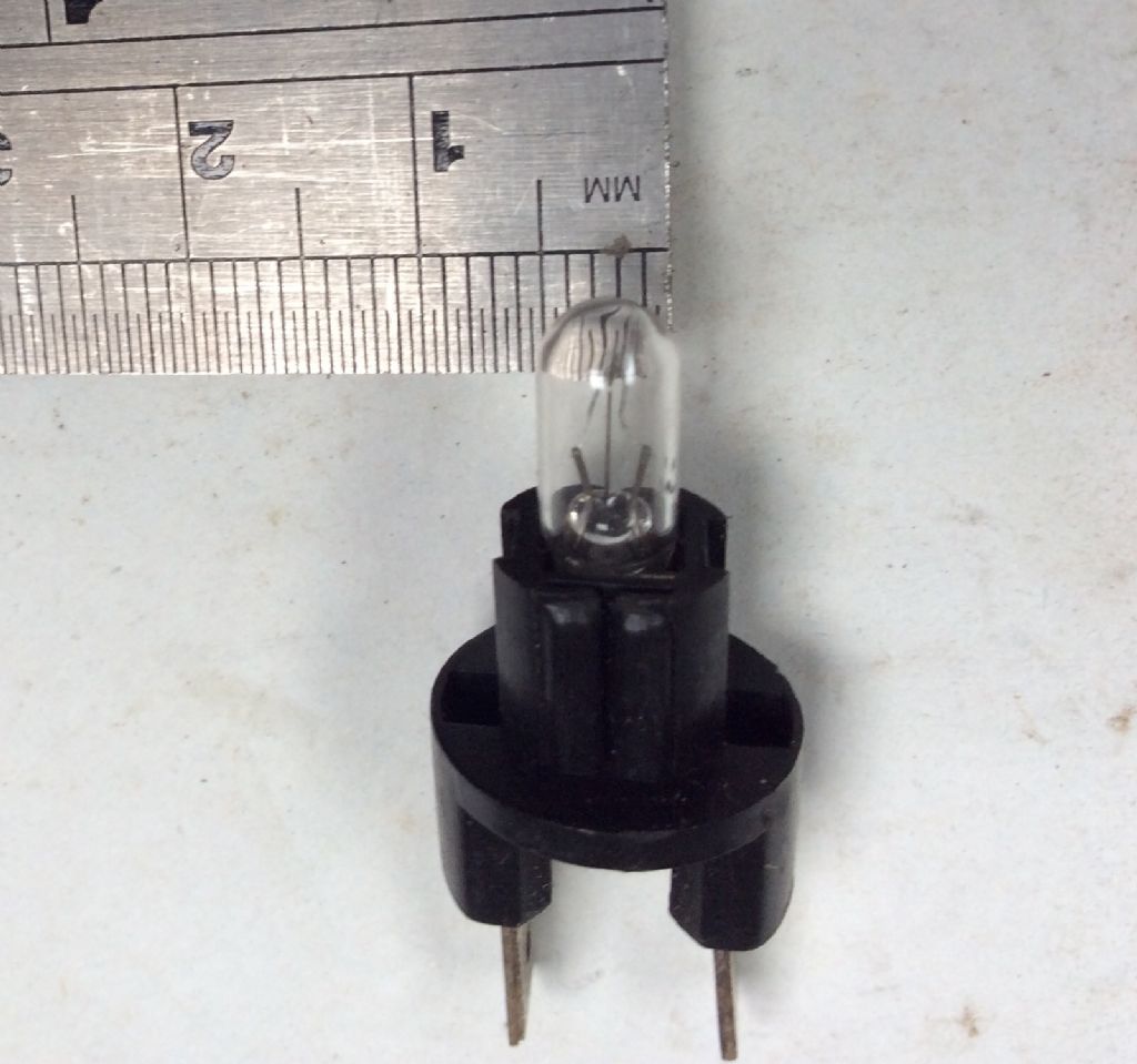

                                            .bulb 3.jpgHi Members,
                                            I'm tidying up a Moto Morini 250 twin at the moment. There is a small indicator/warning light bulb missing and I have been unable to find a supplier. The bulb is one of the wedge or capless ones but is smaller than the usual ones. It is only 5.25mm diam. and overall length is 18.75mm. The actual bulbous part is 11.5mm long.
                                            It is 6Volt.
                                            Does anyone know a supplier?
                                            Would the LED bulbs that are becoming popular work in the 6 Volt system? bulb 2.jpg

                                              I don't know if this is any help, but Rapid Electronics sell a T5 wedge-based lamp 6 volt 1 watt (order code 57-6819) and a 6 volt 0.5 watt ( order code 57-6804).
                                              The dimensions are close to what you quote. Have a look and see what you think.

                                                Hi Neil, I have had a look and that is just what I need.
                                                Many thanks for your help and quick reply. Much appreciated!.
