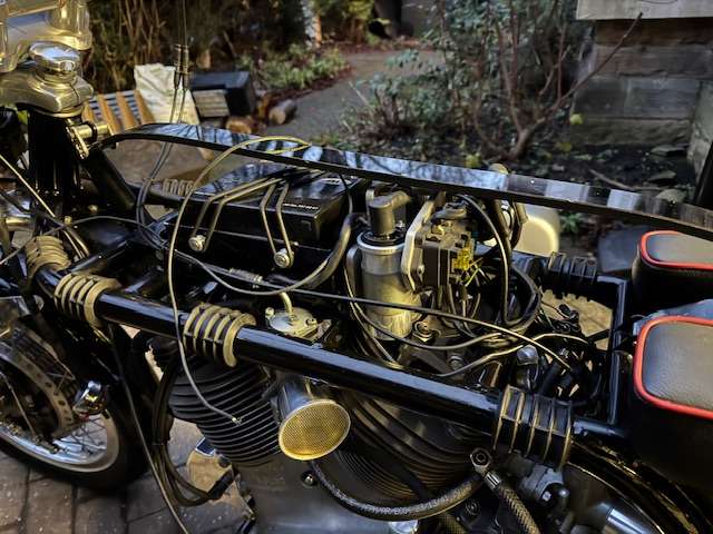

                                The space under the tank is a bit limited and it’s always had a lithium battery fitted and Alton gen and electric start..
                                  That looks interesting; I missed your earlier post saying what engine it had, so I hadn’t considered electric start.
                                  I was thinking Nimbus straight four.

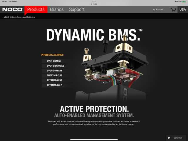

                                        After fitting the noco battery just to see how well it turns the engine over…it certainly does
                                        the web site shows this as what’s in the battery…so hopefully it will be ok on my Alton generator

                                          best of luck with that and let us know in the future as it will be of interest to more than a few of us.

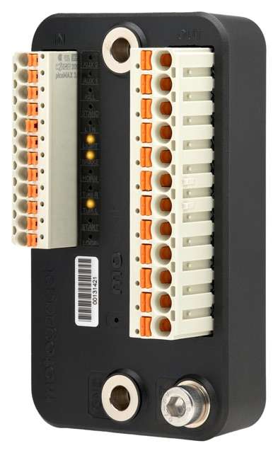

                                            My plan is also to fit (its on its way) a motogadget MO system to keep wiring neat and out of the way..
                                            has anyone used one of those? Only worry its on top of a 1000cc air cooled engine under the fuel tank as is the battery

                                                This like a small PLC for motorbikes theres one thickish cable from the battery to that lower 6mm allen cap bolt then all the inputs are switched to earth by push to make pushbuttons all the outputs are positive so one wire to each item..and then onto earth..so indicators ,lights, stops light,starter,power to ignition,horn.
                                                the handlebar controls which i have 5 buttons are sent to a little gadget so only one wire from the handlebars needs to go to the unit
                                                it connects to a smartphone so when you come close to the bike its unlocks then you can start it etc…walk away after the ride and it locks and sets the alarm also it handles all fuse duty’s

                                                I also fitted a new noco battery slightly bigger than what was fitted and a led headlight and led indicators
                                                the moto gadget unit allows you to program all the parameters of all the system easily via the phone app. Like how long the indicators flash and how the brake lights work..

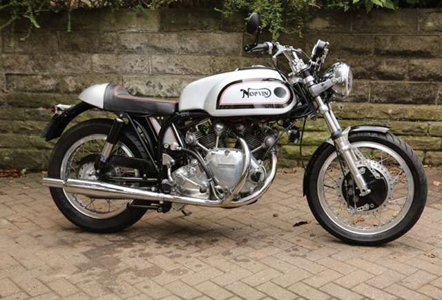

                                                here’s the bike finished for now IANP1379

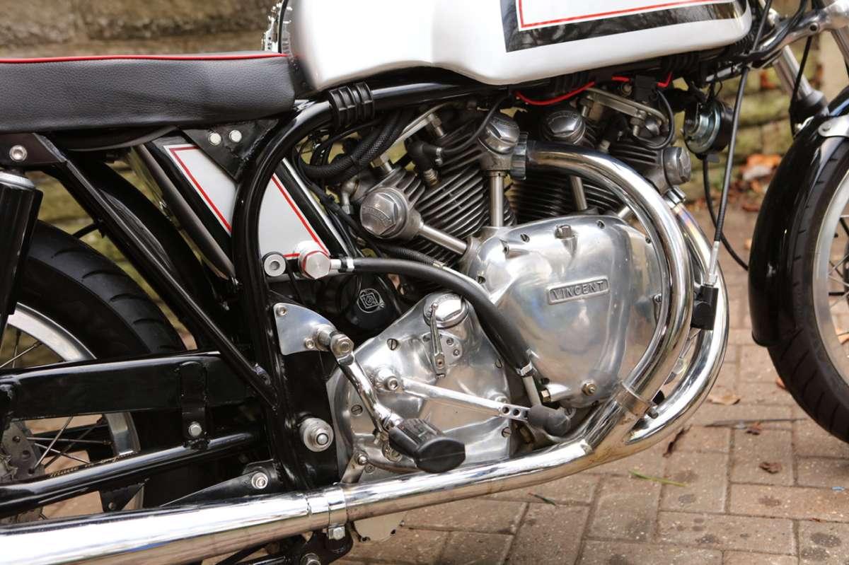

                                                      A pic of the main attraction ( to me at least)
