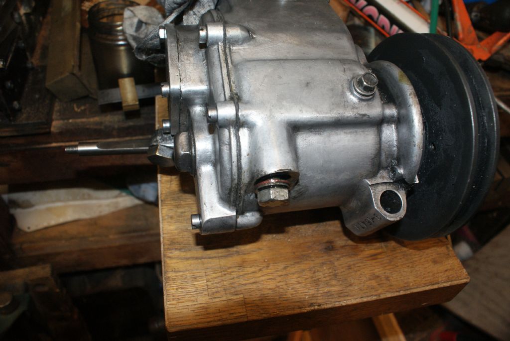

                      malcolm hollins
                        @malcolmhollins96641
                        I removed the gearbox from the mill and I was going drain the oil from it.
                        I undid a bolt that was on the bottom of the gearbox thinking it was the drain plug.
                        The bolt was unscrewed a little but it became very loose I tried to tighten it up again but it does not want to rethread .
                        When the gearbox is back in the Mill this loose bolt would be at the top of it so oil or grease might not leak from it.
                        I think it would require the gearbox to be stripped done in order to get the bolt tight again. I have no experience of doing this.

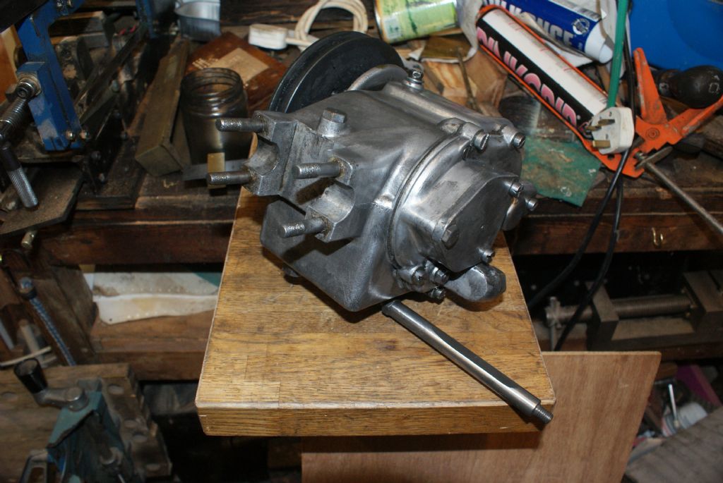

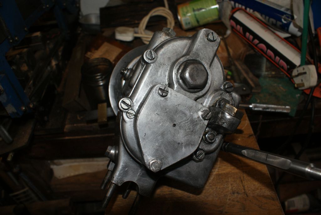

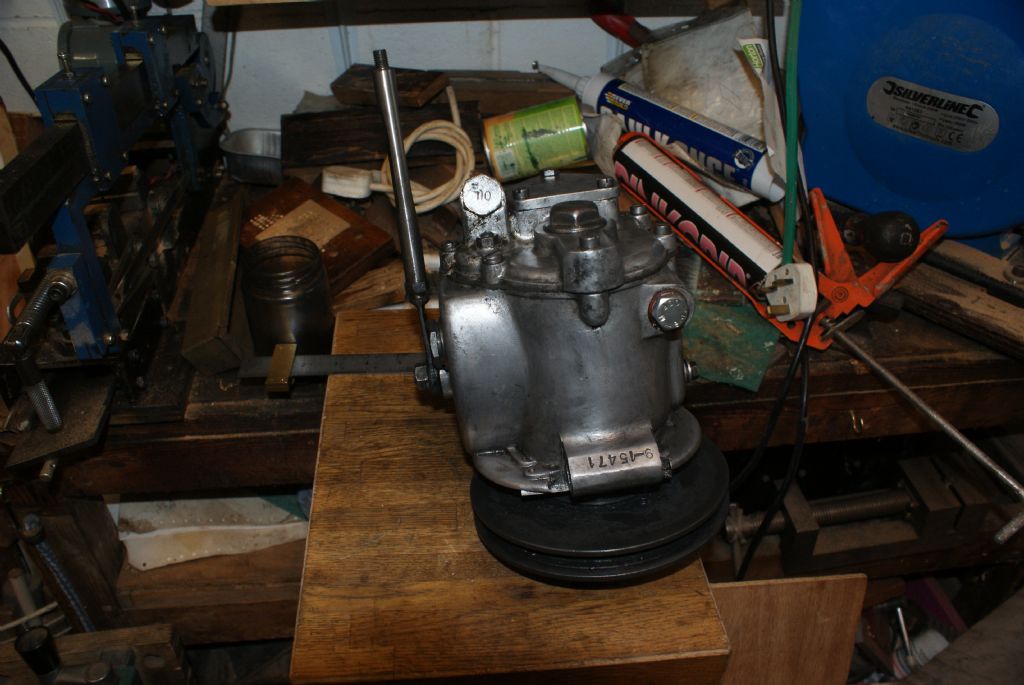

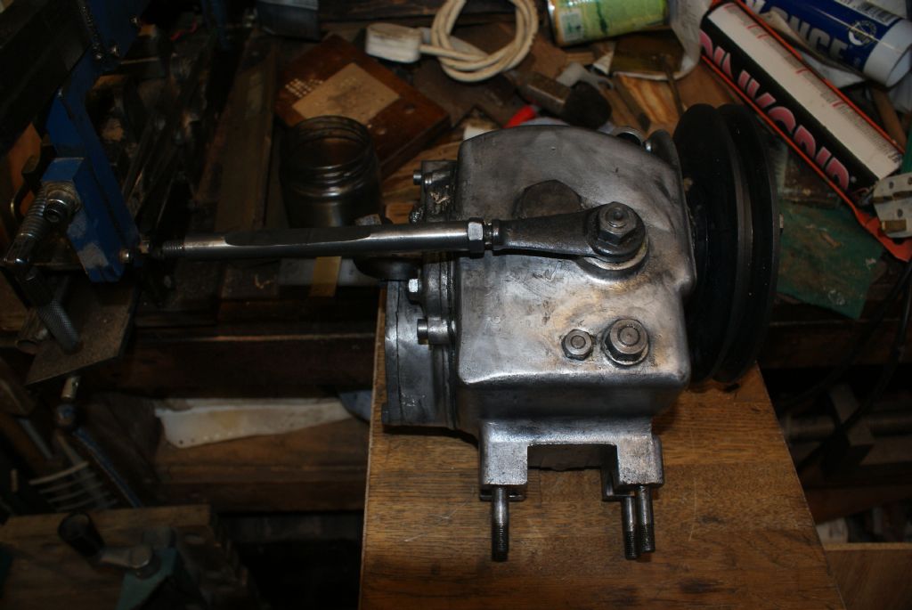

                          #584579
                          malcolm hollins
                            dsc04847.jpgdsc04845.jpgdsc04844.jpgHere are some phots of the gearbox and the Boltdsc04848.jpg
                            #584582
                            malcolm hollins
                              What is involved in removing the End Plate.

                                  #584588
                                  Hopper
                                    @hopper
                                    It looks suspiciouisly like the 250 Velo gearbox in this "how to rebuild" article that might be of help
                                    **LINK**
                                    #584592
                                    Hopper
                                      @hopper
                                      This looks pretty similar too but has more detail **LINK**
                                      If you google around for Velocette 350 MAC or 250 MOV there is a wealth of info out there, and new spare parts to by the look of it.

                                        #584619
                                        malcolm hollins
                                          The loose bolt has 8.8 M GSF on it.
                                          There is the number 9-15471 (From Hopper's link I think it is a pre war MAC)
                                          The gear lever returns to is normal position after changing gear.
                                          I read Hoppers link on the gearbox which was very good if you know all about them which I don't.
                                          Can I remove the outer screws only to remove the cover to get to the other end of the loose bolt?
                                          #584621
                                            Posted by malcolm hollins on 08/02/2022 14:54:54:
                                            dont know
                                            That merits investigation
                                            #584690

                                                #584697
                                                  Posted by noel shelley on 09/02/2022 00:38:14:
                                                  8.8 sounds like a metric …
                                                  Hence my comment
                                                  #584698
                                                  Hopper
                                                    @hopper
                                                    Looking at the links I posted, it looks like the loose bolt is just something that has been jammed in there to blank off the hole where the clutch cable originally went in. So it's a metric thread jammed into a BSW/F hole and has stripped the thread is why it won't come out or go in. So no need to open the gearbox to tighten it.
                                                    You will have to try to work it out by levering in the gap with a screwdriver while unscrewing it. Then put it back in place with some epoxy resin to stop the oil coming out if the gearbox is mounted sideways as you said.
                                                    #584699
                                                    Hopper
                                                      @hopper
                                                      PS Unless that loose bolt is now used as the filler plug? In which case, nix the epoxy.
