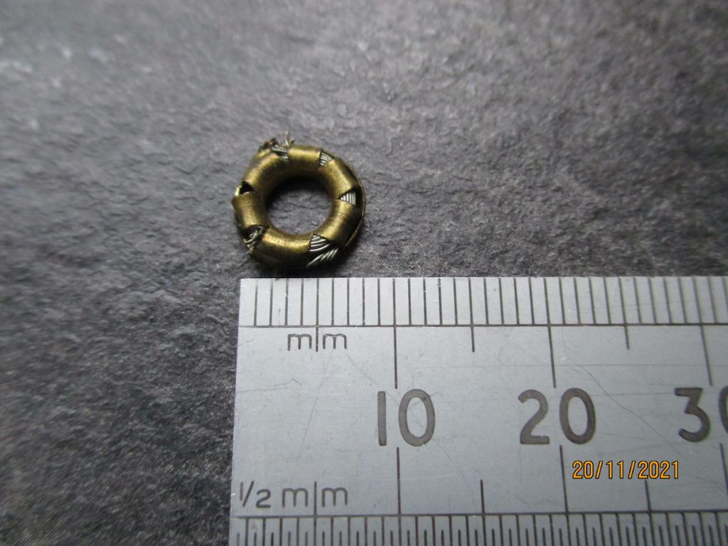

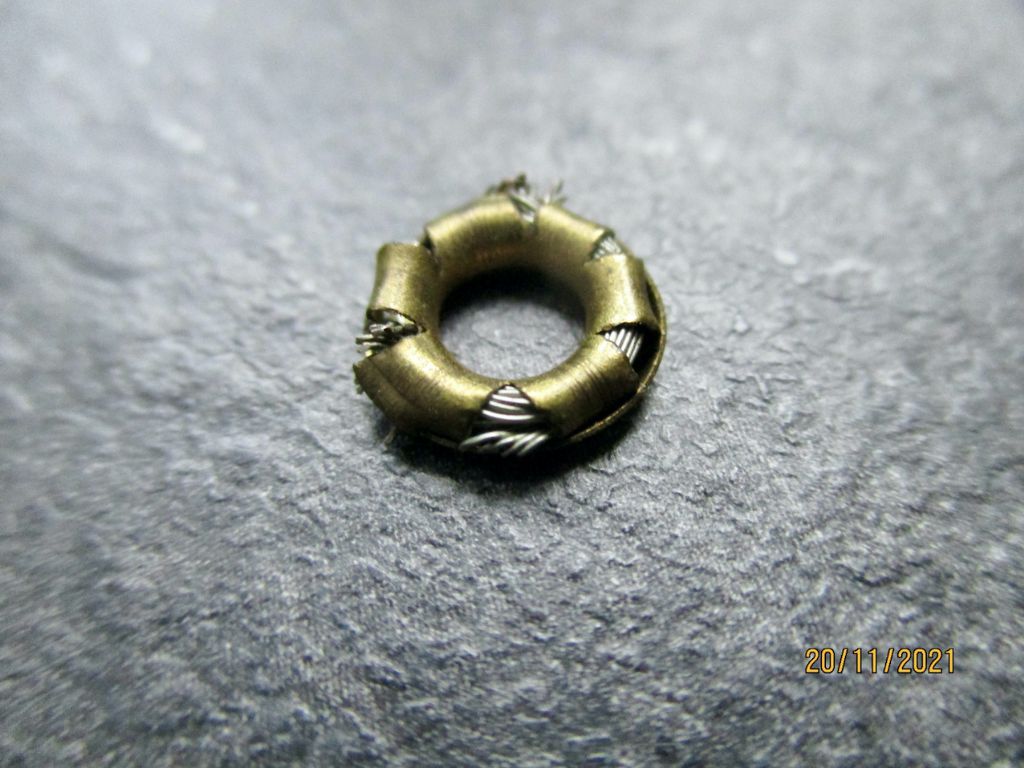

      Hello,
      I'm currently rewiring a Kennedy Hexacut saw and I need some help identifying and sourcing the brass eyelet/crimps used to terminate the motor winding to the on/off switch. Please see attached photos, hopefully!
      I searched the internet but can't find any info on these crimps, they must be obsolete. I have tried to use normal crimps but the switch cover won't fit on to the motor casing due to the size of the crimps and I'd also like to keep it original if possible.
      Any info would be helpful
      Thanks in advance

          Hi there,
          Your photo looks a bit, I emphasise 'a bit', like a Ross-Courtney termination.
          I use them in the terminal chamber of the motor on my ML7. They have the advantage of not having a tail like the modern crimps but they also have the disadvantage of being, apparently, extinct!!!!
          If you locate a source, fill your own requirements before blowing the gaff!!!!!!!!

          peak4
            @peak4
            As far as I'm aware, they are no longer available.
            See this thread for the solution I used when I had a similar problem.
            https://www.model-engineer.co.uk/forums/postings.asp?th=128186
            The previous photos in the album show the process.
            https://www.model-engineer.co.uk/albums/member_album.asp?a=45271

            Bountyboy
              @bountyboy
              Thanks for the replies and links to other posts. I thought they maybe obsolete but I like the idea of the shoe eyelets, I think I'll look into this.

                Chris Gunn
                  @chrisgunn36534
                  BB, Presumably you only have a few to do, so try annealing them, and then bend back the tabs, refit the new wire, and tap the tabs back down again with a punch, and then give them a final nip in the vice. You cannot get more original than that.

                  Bountyboy
                    @bountyboy
                    Thanks for all your help. I going to buy a shoe eyelet repair kit and give it a go.

                      Ex contributor
                        @mgnbuk
                        I recall this type of cable terminal from the works where I started my apprenticeship, but have not seen them since & didn't know what they were called to look them up.
                        Seems that Ross Courntney ceased trading around 2001. These seem to offer an alternative means to the same end for quite a bit less than the vintagecarparts items.

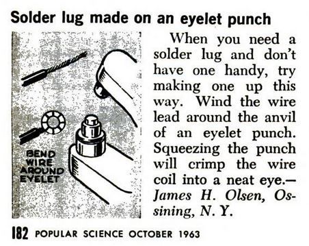

                            Bit late, and others have already described basically the same process, but I just came across this in an old issue of Popular Science magazine…
                            Rob
