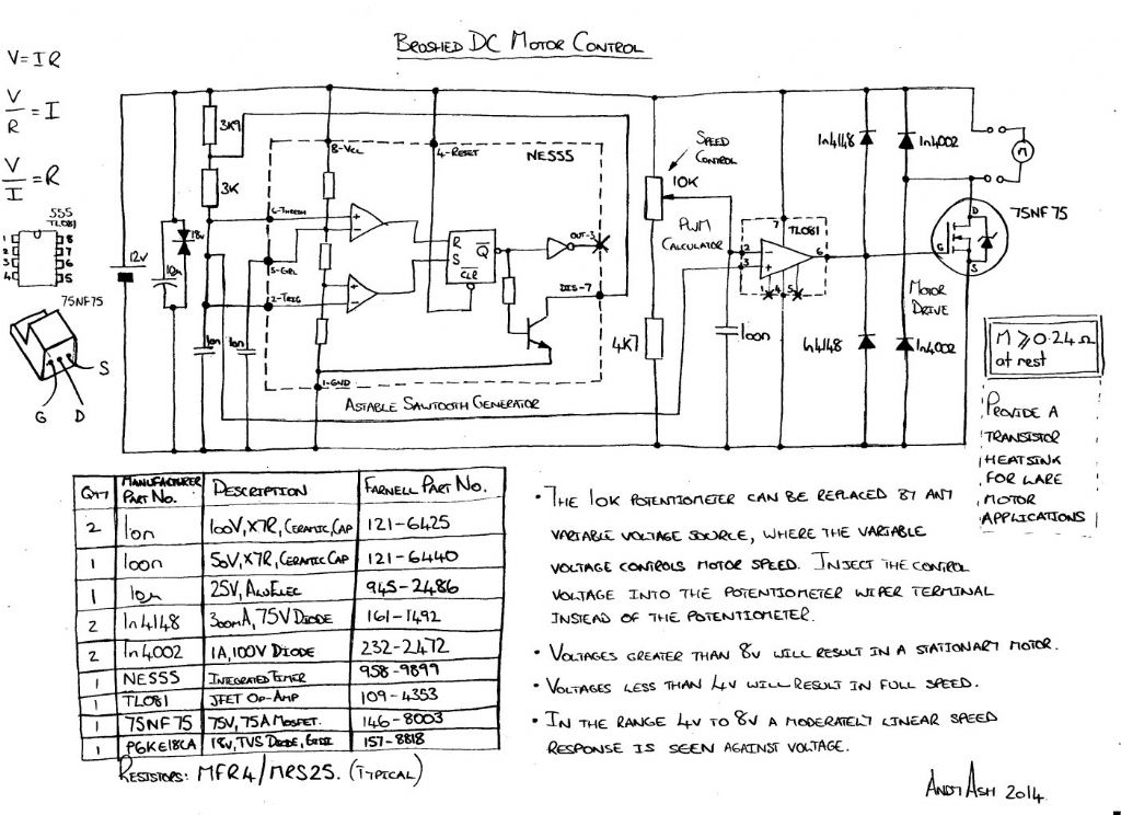

        A couple of weeks back there was a thread here all about electronics. In particular motor control. Various schemes were discussed but a common suggestion was that something like an Arduino could be used to generate PWM to control a motor. Understandably, many model engineers are not very keen to enter the electronics realm, let alone software. Vive la difference!
        Over the years I have seen many threads talking about inverters and reversing switches for single and three phase motors. Sometimes I have been frightened by some of the things that I have read. This is especially because high power switchgear is not a good place to do learning. Often, fault finding and problems are posted. You know that if you were there in person it would be a simple fix, but without your own eyes and ears it is just too hard to diagnose. Often it seems that posters want to know which colour wires to connect, as if there is some universal standard. I wish there were.
        I wanted to put up a really simple speed controller, that anyone could have a go at, in complete safety. One which could still be useful if needed. What I'm going to post might create a fire if you get it wrong, but it cant shock you so badly that you will be unable to put the fire out! Look on the bright side, I say!!
        Actually this controller can be quite powerful. It runs from a 12V supply and is rated for at least 50amps. That gives you 600watts, nearly 1hp. You might find a motor to do that from 12V, but you're less likely to find a power supply which will deliver 50amps. My recommendation is to use a car battery as an accumulator, and set it up with a trickle charger. In the workshop environment you can drape your 12V power cable across a machine tool and not worry too much about electric shocks. Perhaps it could be good for gear hobbing or tool post grinding. It doesn't even have to be a motor, it could be a heater or anything really. That's up to you. Do use cables which are up to the job! If you don't they'll get hot and melt.

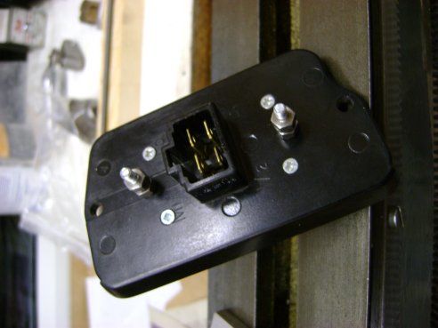

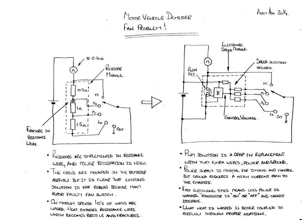

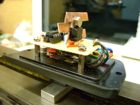

        The reason I did this thing was that I remembered my demister fan in the car had not been working properly for ages. The two slow speeds didn't work, but the fastest and the next fastest did. I had a good idea that it was the dropper resistors that had failed. I also had the idea that I could make a speed controller to replace the resistors. The picture below shows the faulty resistance wire.
        The module has three resistors chained and tapped. The diagram below shows the electrical arrangement.
        The resistors project into the airflow from the fan. It's a great idea, the fan cools the resistors that control its speed….. The problem is that the resistors make more heat when the fan goes slowly, and so cools less. They could have rated them properly in design, but evidently they didn't.
        The great advantage of a PWM speed controller is that it is much more efficient than resistors. With the resistor scheme, perhaps the motor runs at half speed. The effective resistance of the running motor is the same as the dropper resistor. Half the energy goes to the motor, half to the resistor. I measured the running current on the next to fastest speed and found 9 amps. That's 40 watts of power wasted to go at half speed. The heat has to go somewhere and that is why the resistors burn out, as so many people find. Hot in the airflow, the resistor wire oxidises readily and becomes brittle. Cars vibrate and demister fans fail regularly.
        #148333
        Andy Ash
          @andyash24902
          With the PWM scheme the transistor is either on, or off. When on, its resistance is just a few milliohms. When off it is tens of megohms. In both situations the transistor cannot dissipate any power as heat. The only time it can actually make heat is during switching. It switches so fast that this is very little of the overall time.
          By varying the relative quantity of time the motor is switched on, against the time that it is off, the overall amount of electricity that passes through can be varied. This works especially well on a motor. Much of the energy that is in a motor is stored magnetically. The magnetic field in the motor can act like an electrical spring. As the transistor switches on and off the magnetic field takes up the electrical slack keeping the motor revolving.

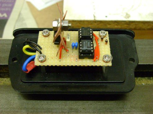

          The diagram above shows the solution I devised as a drop in replacement for the resistor module that failed. It needed new power supply connections because the old resistor block had no active electronics. I just drilled some holes through the bakelite plate and used 4BA screws, nuts and washers. I pulled the new power supply out of the car wiring loom. The ground is a screw into the car chassis, and the power comes from the battery side of the fan motor.

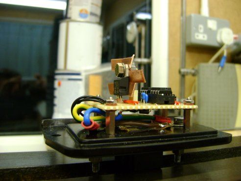

          The existing connections to the fan switch were reused. The airflow continues to provide cooling for the transistor. It turns out not to be needed. The transistor doesn't even get barely warm.
          The solution uses a 555 timer to generate a saw tooth waveform with a voltage between 4 and 8 volts. The Op-Amp compares the speed control voltage with the 555 timer saw tooth generating a variable pulse width square wave with fixed frequency. Normally one might use a comparator to do the voltage comparison. Here I used an Op-Amp. The transistor has a high gate capacitance. It needs to be driven high and low. If it isn’t the gate voltage dwells at an intermediate voltage. When so, the transistor dissipates power as heat. Comparators usually have open collector outputs and these require a pull-up resistor. Such a pull-up can only charge the transistor gate at a given rate, which causes the unwanted dwell. In this situation using an Op-Amp as a comparator is advantageous.
          That's pretty much it. The pictures show the final solution which I installed in the car this evening. If you need to find a good, powerful, cheap 12V motor, you could do much worse than go to a car scrap yard. This controller, using the components specified, should be capable of a 600W nominal motor. The fan in my car appears to be about 240W and that is just fine.
          The parts will cost pennies. Maybe you could try it and see how far you can make it go. The part numbers are all Farnell. I'd be interested to see anything that people might use it for. I don't know that I have time to support any problems that people have. Rest assured that if you make the circuit I drew, it will work. Mine certainly does. As usual, I had to find out the hard way, that it won't work if you make something different from the plan initially!!

            Hi Andy, Nice circuit, can I suggest that the control voltage that can be connected in place of the pot slider is limited with a 1K series resistor and a couple of 1N4148 diodes to supply rails, to keep the voltage on the TL081 input pin within its absolute maximum ratings (just in case). The TL081 has such a high input resistance that wires can pick up large transients from motors etc.

              That's a really good point Chris.
              As you say, if the control voltage comes from "somewhere else" there are no guarantees about limits.
              The TL081 won't be happy if the control voltage goes outside of the voltage rails, and this is true even if noise and transients cause the excursion on an otherwise compliant signal. The limiting resistor and diodes will give a good measure of protection.
              The TVS (transient voltage supressor) diode seems to be quite important. The design started out without one. The 555 has an 15 volt PSU limit. I popped a couple of them when I externally disconnected the power with the motor running. Obviously the timer operates quite close to its voltage limit and the extra "lump" from the stopping motor is too much.
              The TL081 has a +/- 18 volt (36 volt) limit and it never gave a problem in the same situation.
              With the TVS diode added the problem with the timer vanished.
              If you're going to do motor control with this circuit I would recommend the TVS diode strongly.

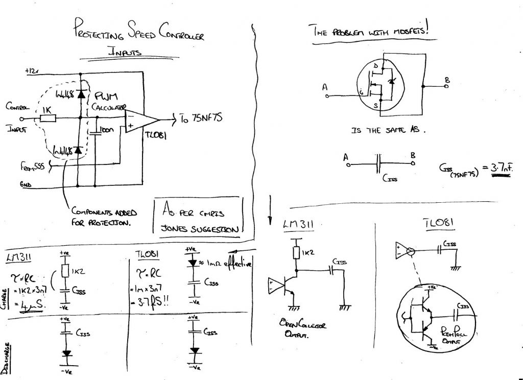

                    I did another diagram to assist the explanation;
                    It shows the extra components that you would want if you were introducing your control voltage from another circuit, rather than using the potentiometer shown in the schematic.
                    The other part of the diagram is an attempt to show why I decided to use the TL081 rather than a comparator like the LM311.
                    These big MOSFETs are really great at controlling lots of power from very simple low power circuits. But the problem with them is that they have very high gate capacitance for a transistor. I explained how they have a very low on resistance and a very high off resistance. This is really important to their ability to control big power from little circuits.
                    You just cant use them linearly.
                    If you have a transistor like this "half on", but all of the time, then in a 600 Watt circuit it will have to get rid of 300 Watts. That needs a heatsink with its own fan, perhaps the size of a couple of bags of sugar. If it is fully on 50% of the time, it still only passes half the power, it might only dissipate a single watt. Only a small heat sink is required.
                    The rate of change between on and off determines exactly how much heat the transistor will need to emit. The faster the better. With the pull up on the LM311 the time constant (the time to reach only 63% of the final value) is 4 microseconds.
                    The 555 timer is set up to give about 14KHz , you could go higher if you wanted. 4 microseconds is more than 5% of that cycle time, which is too slow.
                    The TL081 with its push pull outputs has a much lower output impedance. I've said on the diagram, nominally 1 milliohm, but it isn't that good. The exact value is debatable, but it will be much better than the 1k2 ohm pull up resistor.
                    If you had to use the LM311 then you would be better off using an external buffer made of transistors. Even then making normal bipolar transistors move out of saturation quickly is quite hard to do. I would probably recommend schottky diodes on the transistors. Perhaps better still a LS TTL buffer, but it is another chip.
                    Normally the TL081 would not be good to use for driving a capacitor directly. Especially using negative feedback. The datasheet for the TL081 warns against it. There would likely be stability problems and the amplifier would struggle to drive the capacitor. Certainly that would be true with a big capacitor tied directly to ground.
                    Here, although the gate capacitance is higher than we would like, it isn't *big* in electrical terms, and more importantly the amplifier is being used open loop. I think that is why it works out quite well.

                      I can't understand why you are using a 555 and a comparator when there is a standard 555 circuit that does speed control on its own (with an external MOSFET) available ready built on a pcb from Maplins.

                          There were a couple of reasons for doing this really John.
                          The first was that I had all the bits in my parts bin. The idea came when someone was asking about motor control on this site a couple of weeks back.
                          In between, I remembered the problem with my car and thought I could kill two birds with one stone!!!
                          I had to fit the thing on the back of the bit of bakelite so I guess I would have ruled out the idea of using a pre-made circuit. The truth of it is that you can get this kind of widget on e-bay, made freshly in Chinese tin shack, shipped around the world by airfreight.
                          I guess you could buy a two stroke diesel, or a tin plate steam engine, from china but nothing beats knowing and being able to make it yourself.
                          I suppose the final thing is that if you want to do something like this, especially closed loop speed control, you would have to combine different circuits to control the motor. If the only option is an open loop speed controller from maplin, then the box you put it all in is getting quite big. That's the thing with integration.
                          Maybe if I get time, I'll find a motor and make the hardware to do the full closed loop speed control. That, actually was the original thread that sparked my interest a few weeks back. The request was to have two motors running at the same variable speed from one controller, irrespective of load.
                          This isn't the whole deal I grant you, but it is a part of that, and at least I made a bit of a try.

                              When designing a MOSFET gate drive circuit the capacitance parameter Ciss is largely irrelevant. It is a small signal parameter, normally measured at 1MHz and zero gate voltage. What is important is Qg, the total gate charge. This parameter is the charge that needs to be injected into the gate to turn the device on, and reach a specified gate voltage. For the device specified the maximum Qg, for a gate voltage of 10V, is 160nC. But Q=CV so in an idealised world that gives an input of C=16nF.
                              Also Q=it, so if we need a gate charge of 160nC and we want to switch in 1µs then we need a current of 160mA for that microsecond. To turn the device on we need to drive that current into the gate, to turn the device off we need to pull that current out of the gate. The TL081 is a venerable device with a correspondingly old-fashioned datasheet, which makes it difficult to estimate the output current capability. However, there's no way it's going to supply anything like 160mA. There is a graph of peak output voltage versus load resistance in the datasheet, from which I estimate it would supply on the order of 20-30mA.
                              Switching speeds for power devices are determined by both 'static' losses and dynamic effects. For this simple circuit turn-off is more important than turn-on. At turn-on there is no current flowing, so little or no dissipation in the device. The main problem will be negative dv/dt on the drain. This will feed through the drain-gate capacitance and oppose the gate drive, trying to turn the device off. For turn-off, when substantial current may be flowing, there are several issues to consider. First, as has been stated, during turn-off current will be flowing as the voltage across the device rises, and this causes a 'resistive' loss in the device. For power devices this can be substantial (I'm talking here of devices switching hundreds of volts and hundreds or thousands of amps). During turn-off we also have two dynamic effects. First, the voltage on the drain is now rising, which when feed through the drain-gate capacitance will try and turn the device back on. When driving large power devices the gate is often taken negative to counteract this effect. Second, the drain current will be changing so we have di/dt effects creating voltages on the drain, according to the amount of inductance in the drain circuit. For power devices switching hundreds of amps per microsecond you don't need much inductance to get hundreds of volts. Even a few inches of wire will do.

                                  I do notice that you do not consider the shape of the voltage curve as the FET charges through a 1K2 pull-up resistor. I think the idea that most of the time to reach a target voltage occurs after the 63% time interval leads me to conclude there would likely be significant resistance effects during turn on using an open collector comparator.
                                  I've not done many sums for this. Actually, I didn't do any, but I'm not ashamed of that.
                                  The only thing I would say in contention with what you have said, is that your assesment and conclusions lead down the path of designs that use many more components than this one. I don't think that is any more the right answer than what I have suggested here, or the other alternative which might be a pre-designed mosfet driver chip.
                                  I didn't actually measure the edge speed. It looked fast enough on the scope, but my scope is a bit crap. I did decide before drawing it up that an LM211 which I have in my parts bin wasn't a good candidate. All I really know is that it didn't get hot and it doesn't seem to die no matter what I do now.
                                  I think someone ought to show if the LM311 makes any difference or not. I'm not going to, but I do think that it is easier to be critical than creative.
                                  I didn't do vibration and environmental testing, but I don't think that the original resistors got that kind of attention either. I am interested to see how long it lasts…. If you're nice to me I'll be honest about it!! smiley

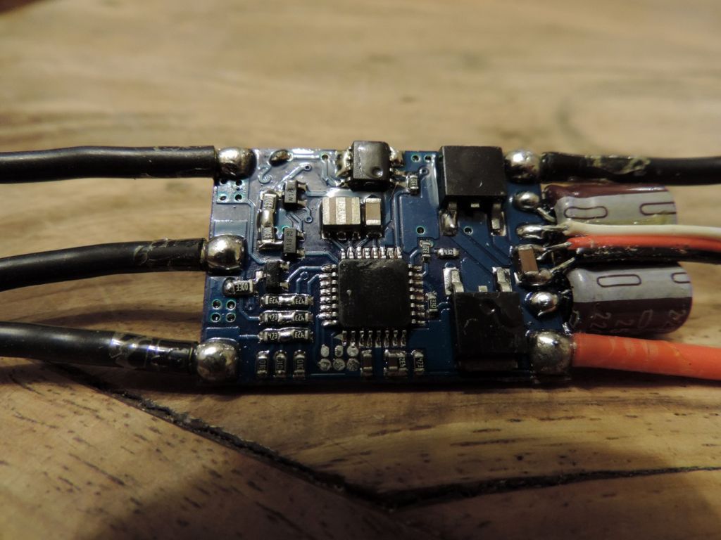

                                    I wouldn't fret
                                    Andy, there are 101 ways to skin a cat in electronics as much as engineering. Lots of folks have said 'just use a 555' but you are the first here to bother actually designing such a controller!

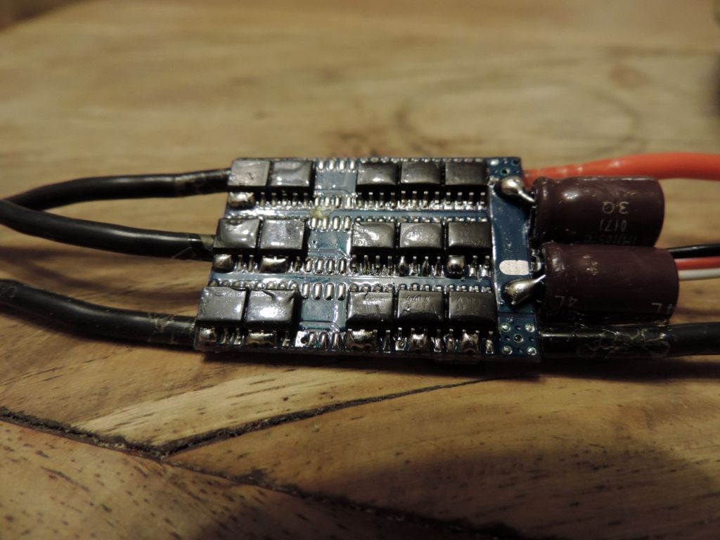

                                    My most recent motor controllers use an AVR microcontroller and logic-level FETs. I use heatsinks, but I suspect they are pointless.
                                    The ebay option isn't always ideal. Below are two pictures of a BLDC speed controller for a model multi-step hydroplane. It appears to have been soldered by a drunk gorilla in a straight jacket. Believe it or not, it works!

                                            Good job that this is only a heater application. After some time you can expect the mosfet leads to fracture. Putting an unsupported bit of copper on the mosfet makes matters considerably worse by increasing the mass and putting the resonant frequency closer to the peak range experienced in a vehicle. It does not take much to do the job properly, bolt or solder the mosfet to the board. Even a blob of epoxy around the leads will help a bit but firm fixing is better.
                                            The use of I.C. sockets is inadvisable in a vehicle especially if the assembly is bulkhead mounted. Sockets are a real liability, the only reason to use sockets is where the designer is unsure that the design is sound, it makes changing damaged devices easier. I would also point out that there is no parasitic prevention which is a real issue with unspecified loads, and some mosfets, it would cost a penny to place a 22 ohm resistor in the gate.

                                                @Neil Wyatt – Looks like a driver for a brushless three phase pm motor to me. My humble little circuit does nothing so bold. I was actually trying to eliminate the microcontroller so that might explain something. In the back of my mind I have a scheme for a three phase motor that doesn't involve a uController. The interesting thing is that the uC implementation for three phase drive is simpler than without the micro(unless you use transformers which are hard to obtain but could be home made). For the simple switching regulator it's the other way about; the uController DC switcher is more complicated. I actually wonder about using a five pin switching regulator in an SOT23-5 package as a variable speed controller for a small motor. Instead of two 8pin DIL chips and a transistor, it becomes one SOT.
                                                I guess if the components don't fall off, and the electrons can get through, it doesn't really matter what the smouldering looks like. I think perhaps if some of the pins are high current, it could be that the extra solder helps. Who knows, there's no schematic, so I'm just guessing.

                                                  @Billy Mills – I'll be honest it's a "knock it together" to put it into the car. I doubt that the car has more life than my dodgy speed controller. I said before that someone might want to use it for their purposes, but I've not described how to assemble it. You might put it in a box, or make a circuit board for it. You might pot it up and put it into your aerobatic demonstrator. That's up to you, but I do understand that you don't like the way I put mine together.

                                                  To my mind (however incorrect you feel I am) that is what is happening, and it is why the motor continues to rotate, even when loaded. For a given "on time" the initial current is higher when the motor is more greatly loaded. The changing magnetic field encourages the dynamic variation in current. The field stores energy like a spring. The spring relaxes differently depending on the loading. I suppose it depends on how one would view a motor. Perhaps it is a rotating mechanical thing with an electrical supply. On the other hand it might be a magnetic couple between an electrical and a mechanical system.
                                                  Edited By Andy Ash on 07/04/2014 21:22:48
                                                  Edited By Andy Ash on 07/04/2014 21:24:48
                                                  #149187
                                                  John Haine
                                                    @johnhaine32865
                                                    A dc motor run from a duty cycle speed controller keeps going between pulses because of its momentum, nothing to do with magnetic field. It generates a decreasing back emf as it slightly slows, so when the controller switches back on the current is as you say slightly higher than just before it switched off.
                                                    a triac controlling a motor is either fully on or off. When it's on all the applied volts is dropped across the motor except for a small drop a volt or so across the triac, so only a small power is dissipated in the device. When it's off the current is just a small leakage and all the volts is dropped across the triac so again the power dissipated is small. So the size of the heat sink is not that dependent on the controllable load.

                                                      Yes Andy,
                                                      It's a cheap radio control BLDC speed controller, because I didn't want to cough up from an Mtroniks one or spend ages making one for something that will probably only get used once every year or so.
                                                      I found the datasheets for what I think are the mosfets, and the blobbed pins are commoned inside the chips. My guess is that they fail a check after the surface mount oven and go in a bin. Someone buys them up really cheap, blobs on solder then tests again. I might clean off the varnish and try a proper rework on the board – which will then cease to work.
