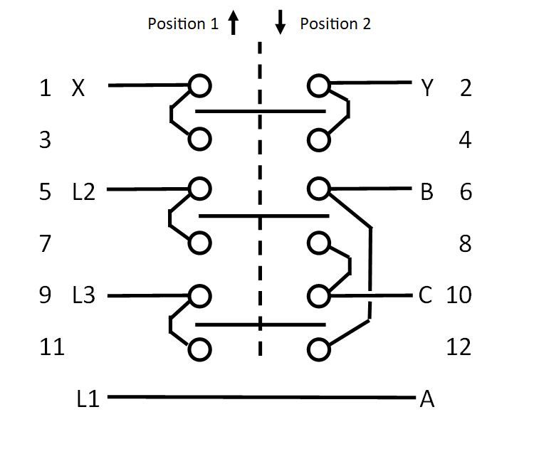

      Les Jones 1
        @lesjones1
        Reading through the thread again I notice you do have a contactor so here is a suggestion that would ensure the contactor dropped out when the switch passed through the middle off position.
        Connect L1 directly to A on the motor.
        Connect L2 to 6 and link 6 to 8.
        Connect B on the motor to 5 and link 5 to 11
        Connect L3 to 10 and link 10 to 12
        connect C on the motor to 7 and link 7 to 9
        Link 1 to 3 We will call this point X
        Link 2 to 4 We will call this point Y
        Break the feed to the contactor coil and connect the two ends of the break one to X and one to Y
        This will cause the contactor to drop out when the switch passes through the middle off position.
        You will then have to press the start button again after the switch has been set to either the forward or reverse positions.
        As you have a contactor all three phases will be disconnected from the motor when the switch is in the off position.
        Even if the switch is set to forward or reverse if the motor has been stopped with the stop button none of the phases will be connected to the motor. If you post the exiting wiring diagram and information on the contactor one of us will be able to tell you a suitable place to break the feed to the contactor coil.
        Les.

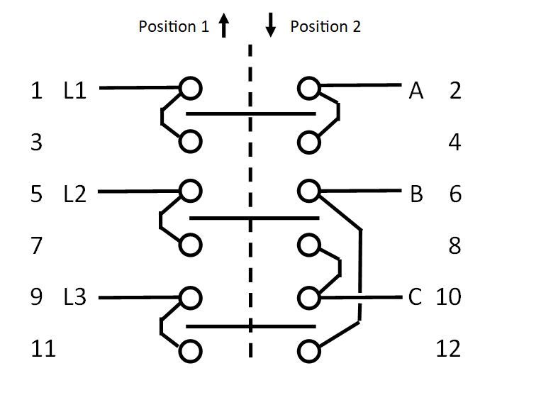

            Martin Connelly
              @martinconnelly55370
              This is the basic circuit that does not involve the contactor circuit.2021-01-24.jpg

                Me.
                  @me1
                  Wow Martin – Thanks- that is exactly what i needed – it is so much easier to understand when written down like that.
                  I can't thank you enough –
                  I wonder if you could do one with the other option with the It breaks the feed to the coil on the contactor as suggested by Les
                  #522306
                  Martin Connelly
                    This is the one where the top contacts are used to latch the contactor as described by Les. The contactor may have terminals just for this external latching with a link in place.

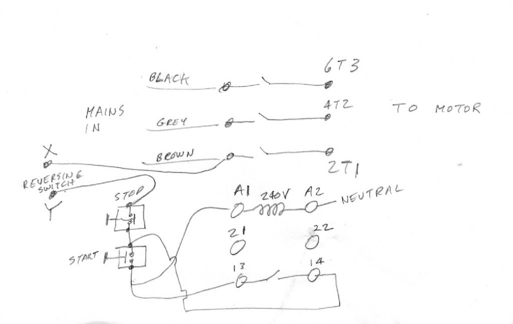

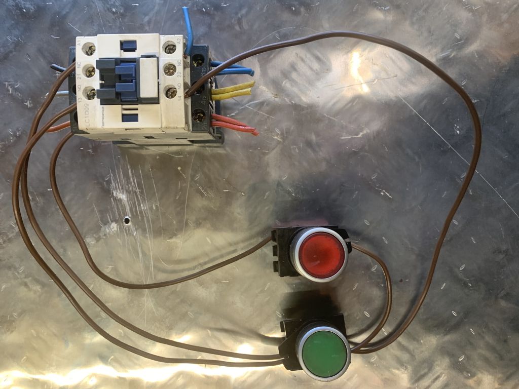

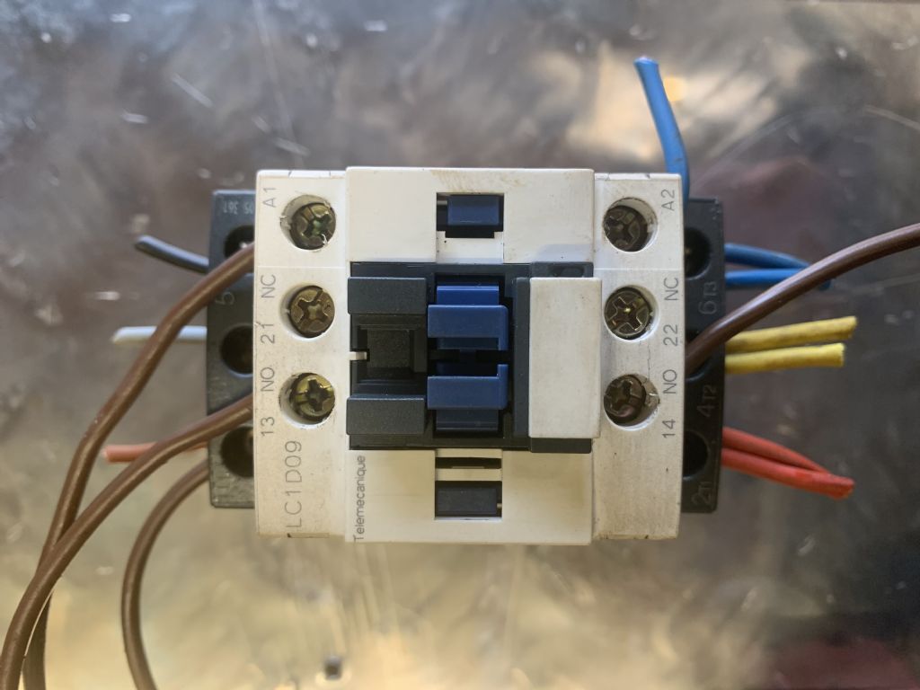

                      #524140
                      Me.
                        @me1
                        Two pictures of the contactor and switches as fitted to my Mill.
                        Brown Black and grey input from the mains at the top.
                        the 3 pairs of yellow blue and red are the feed to the two motors. Which I am fitting the new rotary switches too.
                        The brown leads go to two momentary switches the green one energizes the contactor and the red one turns it off.
                        The blue wire sticking out at right angles is the neutral.
                        Where do I need to break the leads to add my new switches as per Martins wiring diagram ( X – Y connection)
                        Or do I need to replace the momentary switches for something else.
                        #524171
                        Les Jones 1
                          @lesjones1
                          Here is a diagram of how I suggest adding the reversing switch.
                          Connect the reversing switch as in Martin's drawing posted at 16:13 on Jan 24th.
                          Remove the link wire between the bottom mains input (I can't read the marking on it.) and the stop button. Connect the point X on Martins diagram to bottom mains input terminal on the contactor, Connect Y on Martin's diagram to the connection on the stop button that you removed the link from.
                          Les.
