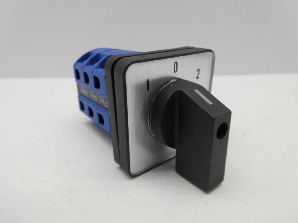

      I want to fit a new rotary 3 phase motor reverse switch to my Mill.
      Ive found a switch which is suitable but need advice on how to wire it.
      The switch is an on-off-on rotary with 12 positions.
      I have my 3 wires coming from the contactor, what goes where into the switch and what positions goes to the motor to enable it to run forward and then to reverse.

                This is the switch – sorry i meant 12 connections – the description in the blurb says its for a motor F&R switch. I just need to know what connections to use – The truth table indicates which connections make and brake but I can't work out what is what in layman's terms.s-l1600.jpg

                        J Hancock
                          @jhancock95746
                          Looks like a Blue Line switch.
                          Google 'Blue Line' , all the information you need is in their catalogue/ pdf page.

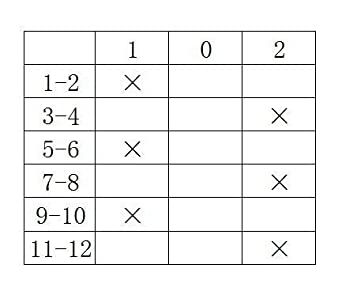

                                            For those that asked the truth table for the switchI want to use.

                                              So, L1 to Ter 2, link 1 & 3 to A
                                              L2 to Ter 6, link 5 & 11 to B
                                              L3 to Ter 10 link 7 & 9 to C Correct ? Noel.
                                              #522179
                                              Martin Connelly
                                                @martinconnelly55370
                                                You are close to correct but not all the way there. Connect L1 and link to 1 and 3, connect and link L2 to 5 and 7, connect and link L3 to 9 and 11.
                                                Connect and link A to 2 and 4, connect and link B to 6 and 12, connect and link C to 8 and 10.
                                                Check this out on a bench first with a meter or continuity tester first to be sure it works as expected. Make up the link wires (6 off) to join the terminals 1-3, 5-7, 9-11, 2-4, 6-12, 8-10,
                                                In position one note what L1, L2 and L3 connect to, and check for continuity or not between the L1, L2 and L3 positions. I would expect them to connect to A (2), B(6), C(10) respectively and no continuity between them.
                                                In position two repeat as above, I would expect them to connect to A(2), C(8), B(12) respectively and once again no continuity between them.
                                                In position 0 I would expect no continuity between any terminals except where linked.

                                                  From the truth table Noel's instructions will only work in position 1. (Post 23/01/21 at 23:33)
                                                  It needs the following three links adding. 2 to 4, 6 to 8, and 10 to 12.
